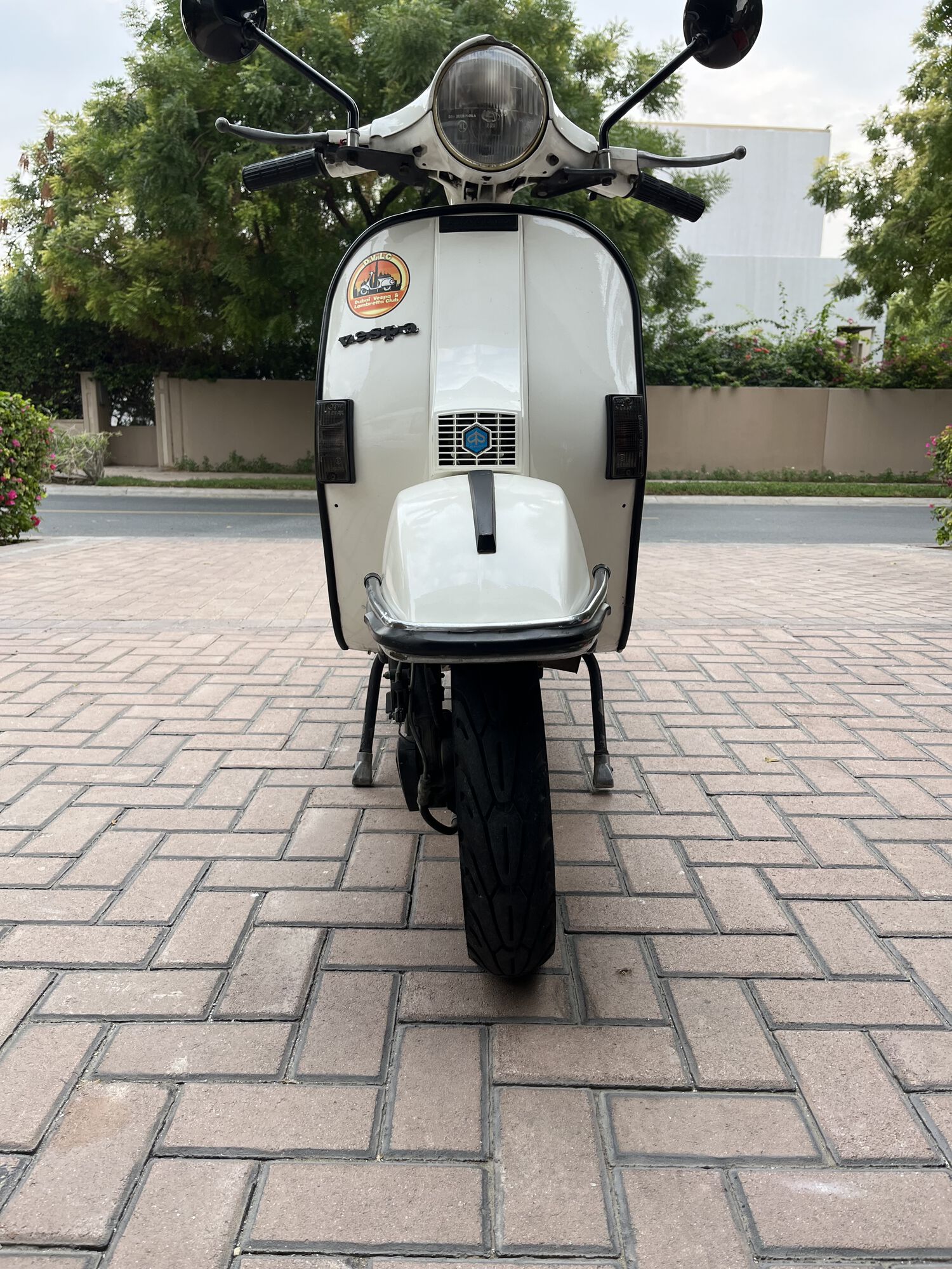

I was recently treated to my first 'off'. I luckily escaped with a few broken ribs. I am slowly getting fixed but now on to the scooter. The back wheel came off because a local mechanic didn't reinsert the split pin and the castle nut backed off. That caused me to vault over the handlebars.
I got the back wheel back on and have checked brakes etc and to the eye everything looks ok. However, I went for a short test run and all was not well. The front wheel is off centre and it looks like the steering column has bent. So a couple of questions.
1. Is this something which can be repaired? If so, how to do it and how easy is it?
2. Or do I need to replace the steering column. If so, new or 2nd hand?
I will do this myself for obvious reasons!
Thanks and HNY!

I'm guessing it is the fork that is bent, not the actually frame. But more pictures would help. Glad you are OK.

If it's not the frame that's bent and only the fork, replace, very difficult to impossible to straighten it back...

This. I'm going to guess it's the fork, unless there are wrinkles in the legshield or floorboards we can't see in that picture.
You'll also want to check distance from the seat to the fork to make sure it's not bent back. Someone else will have to give you the distance, though.
And if you want to know how to check frame straightness, I just did it over here with a laser level.

Thanks. There doesn't appear to be any damage to the frame although the top left of the leg shield appears a little bent as I hit the deck. I'll take a few more photos and post and will be sure to check out your thread.
If it is the fork, replace or realign?

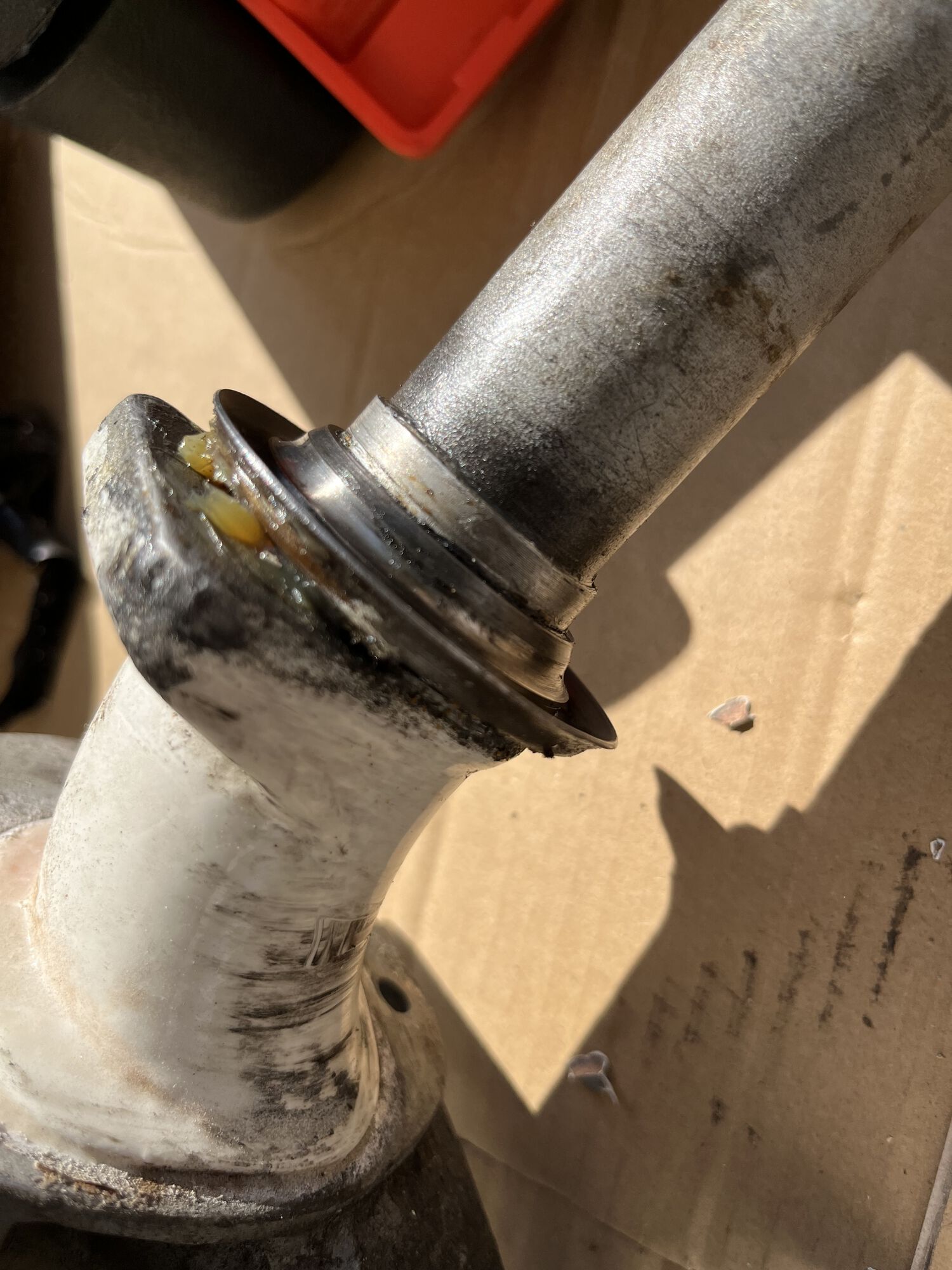

So NOS forks have turned up but come without the lower bearing cone and dust cover. How easy is it to remove from the old forks and install on the new? Or do I buy new.
What's the process for removal if it's possible?
What's the process for reinstallation without fancy tools?

I'd buy new, unless the bearing race is perfect, which is doubtful.
You can remove both by sliding a thin piece of metal (think old Bowie knife) under the dust ring and working it around, prying slightly all around until it comes off.

I agree with Qascooter, order a new one.
The race is thin to be reused, it is not expensive.
use a propane torch to heat the bearing race for a few minutes and then you can use QA's technique pretty easily.
The dust cover was considered a "wear part" due to the likelihood of damaging it in the removal process. It's a pretty common task, though, because you have to remove them to get the mudguard off on most Vespa's.
Personally, I'd also just buy new unless you have some sort of emotional attachment to the OG parts.

Thanks all. Surprisingly for this scooter they both came off with a little persuasion from a sharp screwdriver and actually look OK. New fork build next!
