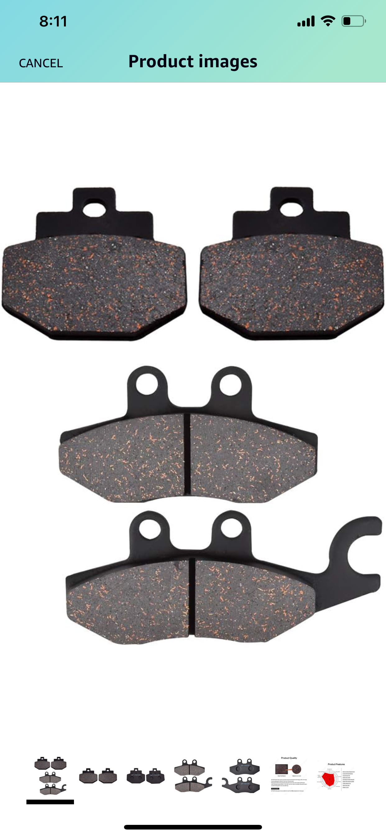

Hey everyone,
are these brake pads recommended ?
KYN Motorcycle Front Rear Brake Pads Organic Disc for Vespa GTS 300 ie (ABS Models) 2008-2020, GTS300 ie Super (ABS Models) 2008-2020 GTS300IE 2009 2010 2011 2012 2013 2014 2015 2016 2017 2018 2019 https://a.co/d/eoRwRFJ

First off, there's a good chance they failed Q&A at a manufacturer, and that's why they ended up on Amazon in the US.
63% of the buyers give the company five stars, so if you can't find cheaper brake pads to put on your Vespa GTS, these sound like they might fit, at least the front pads anyway.

Front pads fit and worked great Rear pads did not fit
By Ken on May 5, 2023.
Just kind of a get what you pay for item. Overall just cheap quality....
By EvansDad on June 1, 2023.
I should not have to pay to ship item back (to China) when it was not proper parts for the motorcycle description said it would fit.
By Dennis Glenn on August 16, 2023.
The pads I ordered didn't have any stick to them... do I apply heat or something to make it stick??????
By Izzie camargo on May 26, 2023.

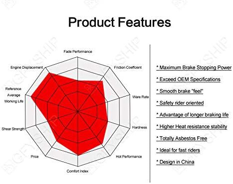

This chart shows something about either the product, or the effect of red drank on spiders.

I wouldn't in good conscience recommend those or put those on a bike, even if I was just flipping it for a quick buck.
OEM pads and decent aftermarkets from reputable sources are not that much money.
