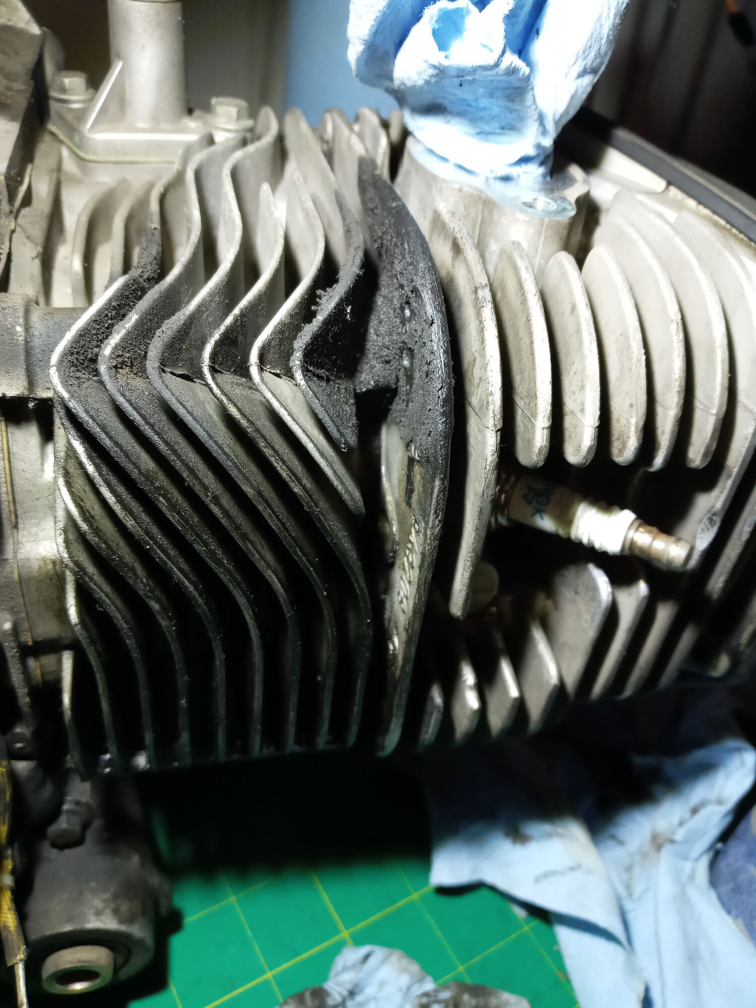

berto wrote:
And when I got the plastic shroud off the cylinder, thick caked on oil (is that what a leaky head gasket looks like on an air cooled bike?).
Most likely just the rocker cover.

greasy125 wrote:
usually it looks like the head gasket but it's actually the valve cover gasket, but either way cleaning all that up and refreshing isn't the craziest job. at the very least you have it cleaned up and you can ascertain where it is leaking from and make a plan of attack.
Photo attached. How does it look, gents?

that's likely schmoo from oil changes residual or some such from other leaky bits. give a poke around and see if you can find a source at the head itself. there should be a witness line...
Thanks, again. I couldn't find an obvious source. You're probably right on it just being years of schmoo, but there was quite a bit there. I opened it up anyways to be sure.
I did find a loose stud and a gouged cylinder mating surface, so maybe?
