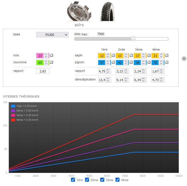

A great visual aid to gearing is this calculator - http://gearingcalc.free.fr/
Have a play around with it and see if you find it useful.
I find the short 4th with stock other gears is great, nice to have an even spread throughout without having to thrash it through any gear.
