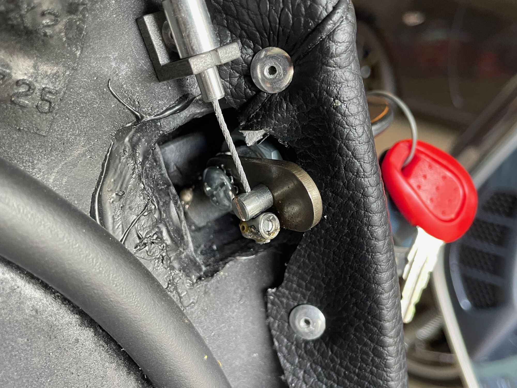

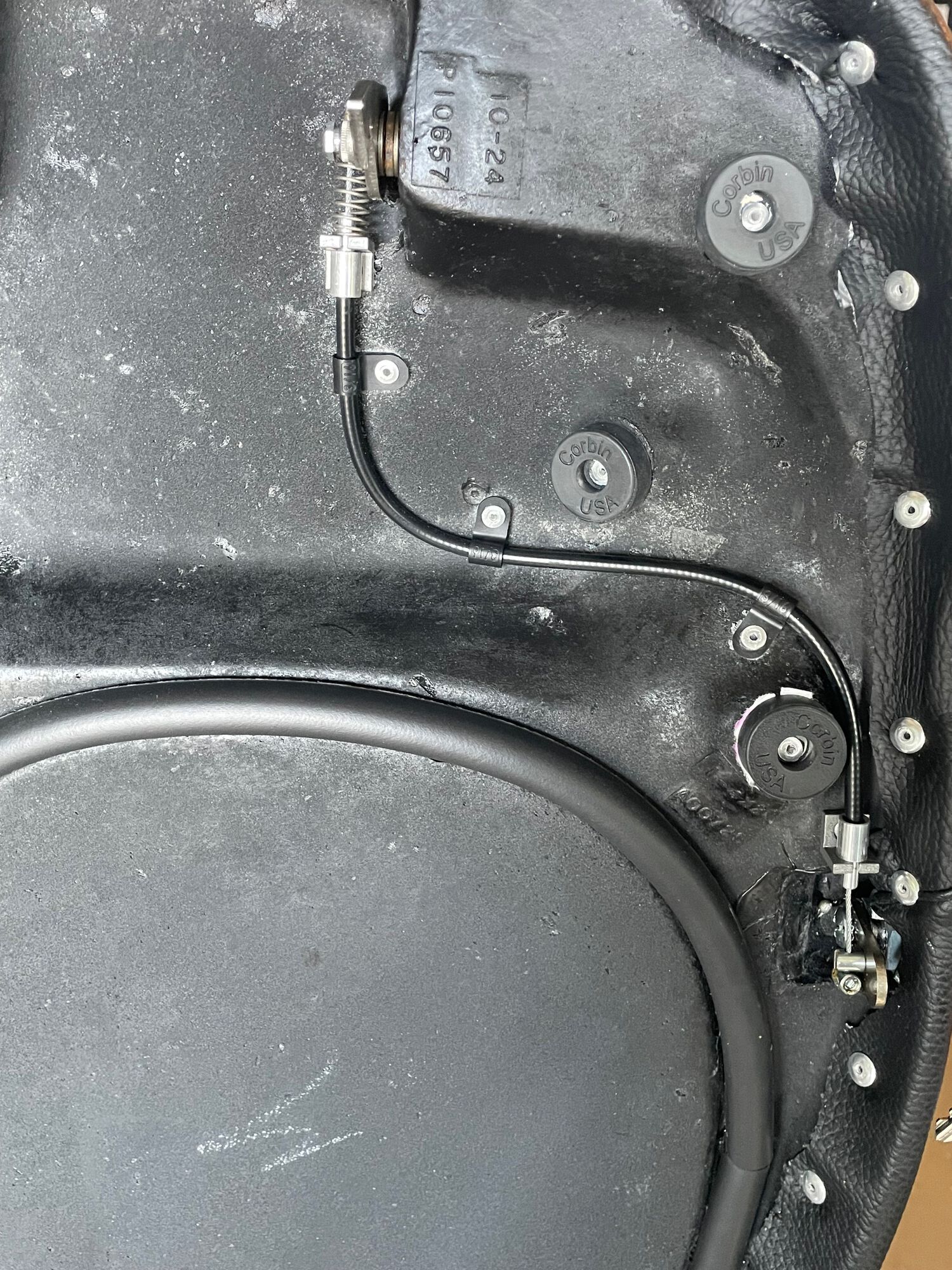

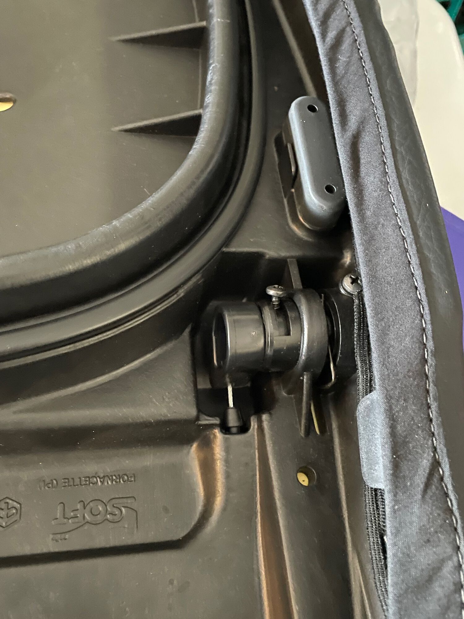

Not an ET4 but I have a Corbin on my LX150.
Corbin lock and cable
Corbin lock
Corbin lock
LX150 lock
LX150 lock

As you can see, these locks look a bit different. Plus, the Corbin has the lock on the right side vs the stock seat is on the left.
I would imagine you can call Corbin and get the locking hardware from them.

The ET4 Corbin seat is different. The lock mechanism looks to be the same one that is used on the stock seat. The key switch is directly connected by a lever to the latch.

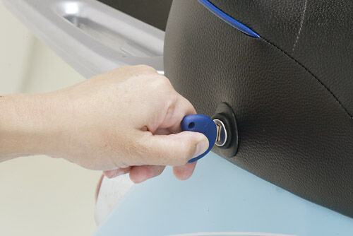

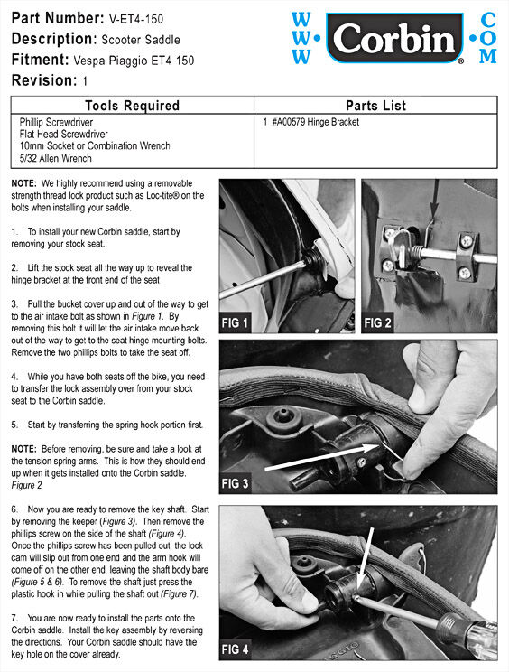

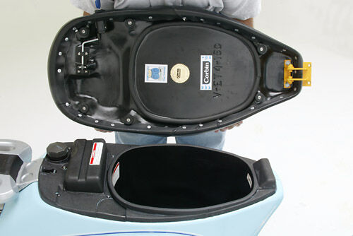

I had a rare good idea last night. I went to the Internet Archive wayback machine and looked at Corbin's website in late 2005. Lo and behold, there were photos and a manual. See the attached.
Manual Page 1
Manual Page 1
Manual Page 2
Manual Page 2
Photo 1
Photo 1
Photo 2
Photo 2
