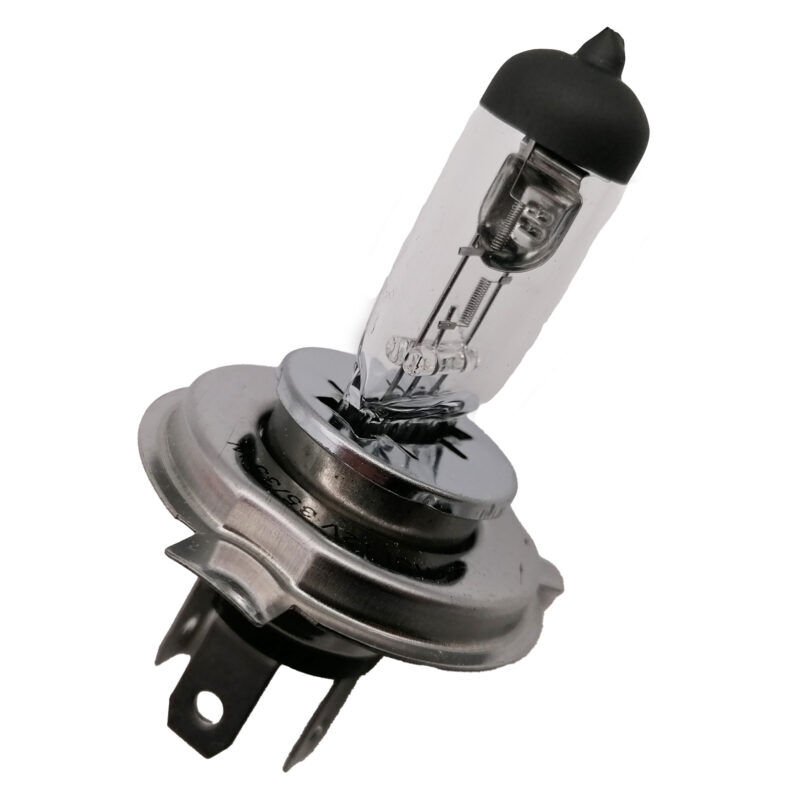

I think the LX has only one lamp in the headlight.
That lamp will have 2 filaments.
One dimmed filament for normal headlight and one undimmed for the main beam.
A lamp like this one:
The filament near the top with the dim cap is the dimmed one, the lower filament is undimmed.
The filament with the dim cap is broken. Simply replace the lamp by a new one of the correct type.
