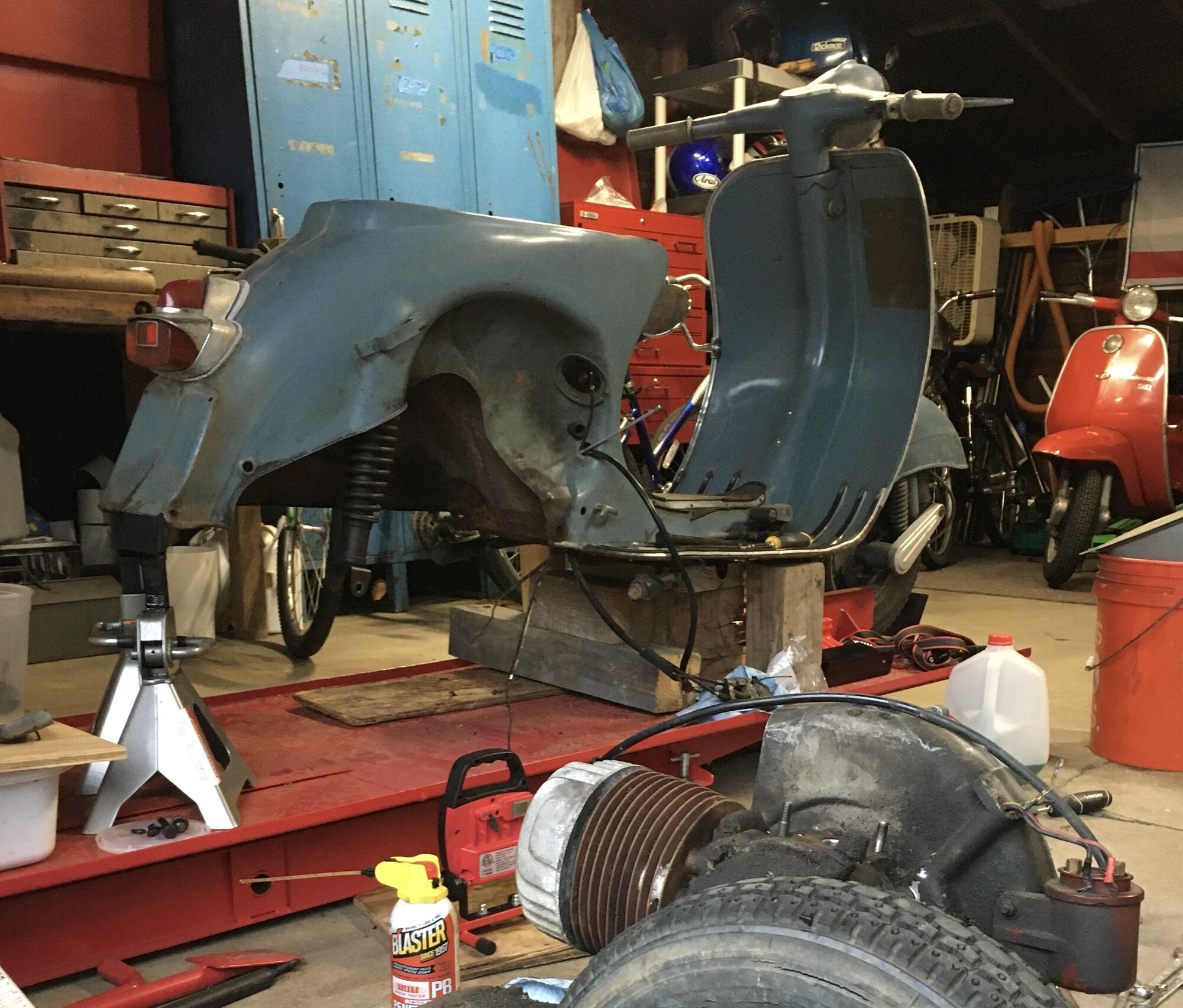

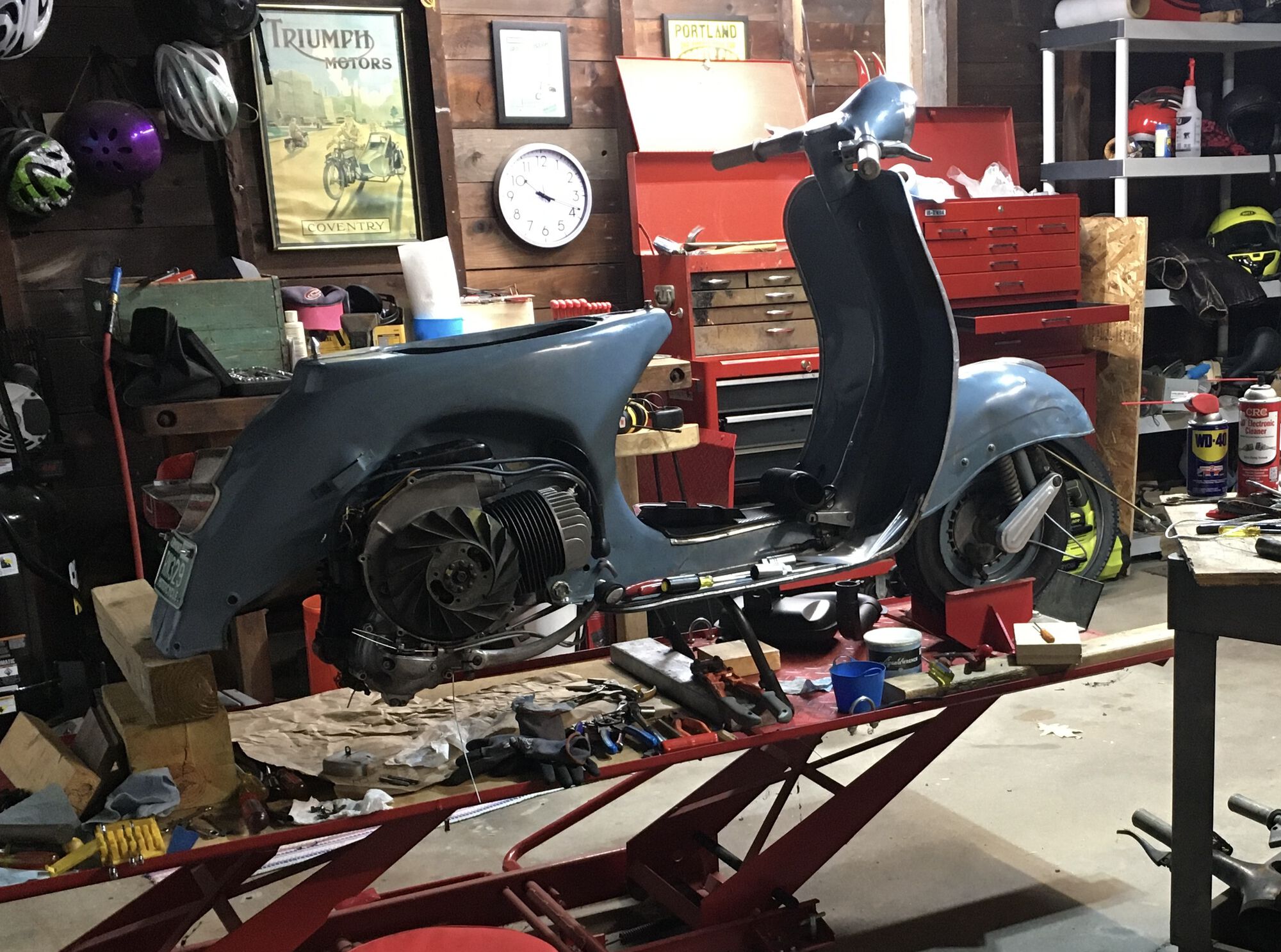

Personally I do like the reliability of a front wheel chock in addition to a pair of jack stands under the frame's rear end and sturdy blocks under the center area. Typical HF motorcycle lifts that have a chock are great in this regard, and you'd obviously have the front fork and wheel installed before stuffing the motor into the frame. Add some ratchet straps too.
I'd say, without a lift or table, just improvise with as many of the above components as you can utilize.
Pics are from a couple of restorations ago, and I'd recommend adding straps:
Motoral removal.
Motoral removal.
Just after reinstalling rebuilt motor.
