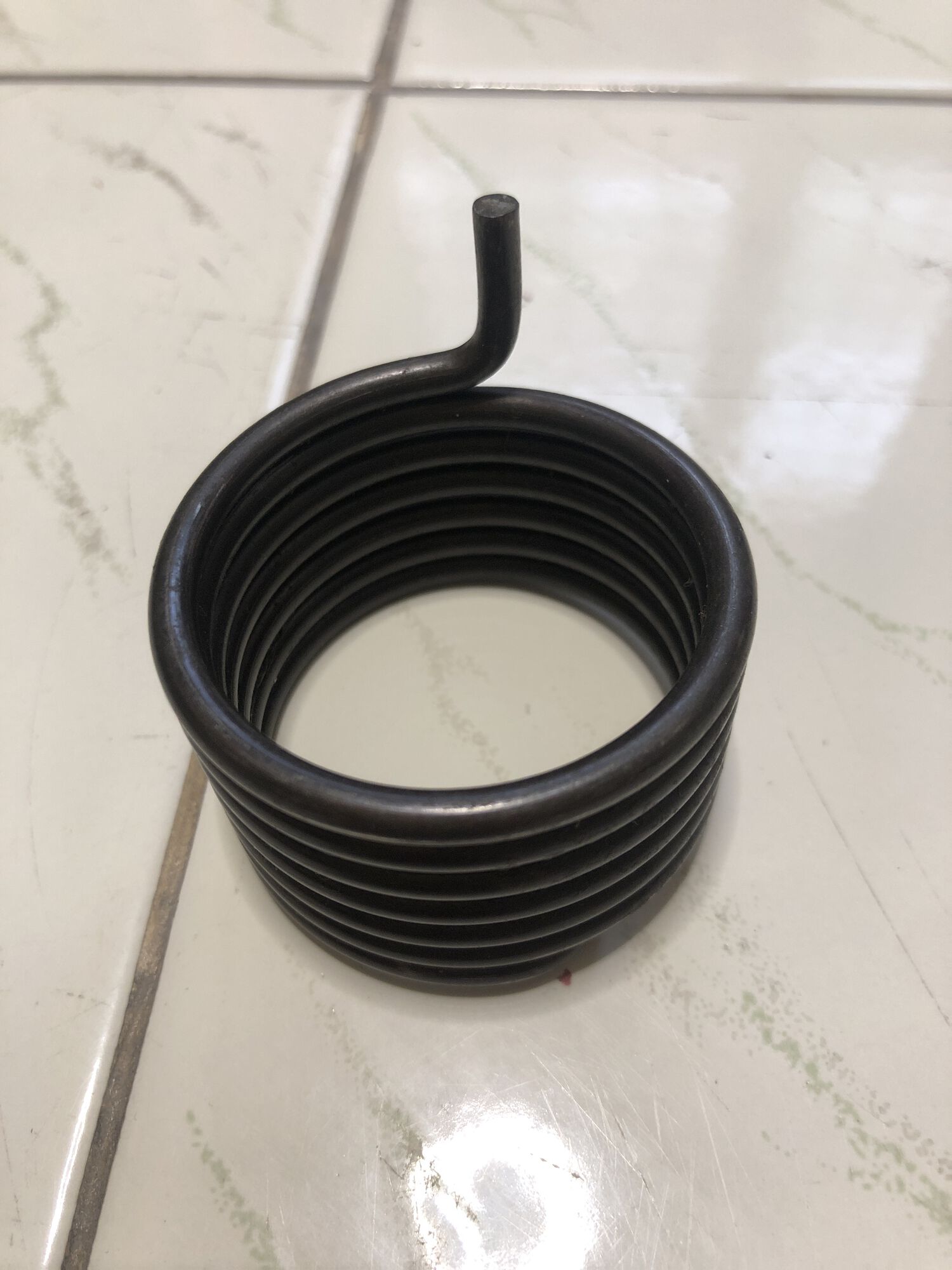

I only say this because I remember finding an NOS large frame spring from Peter Ricambi. I made the assumption that it would be a replacement for the SS180 spring, that was a bit ratty, I had in the engine. When it arrived, I realized it was wound in the opposite direction. I kept the tatty original and it's worked fine. My mechanic told me the NOS spring is for a PX. Now, I took his word that it's a PX spring, but that I'm not 100% sure of that. The photos are of the NOS spring which does not fit in an SS180 engine because it's wound in the opposite direction.
EDIT::Wait. I see now. I think I'm wrong on that. After looking online, I've realized the nos spring I have is not PX; it's for small frame. Duh.
So, I guess an SS or GS spring is the same as a PX, Sprint. All this time I didn't know it's for a small frame. Sorry for misleading.

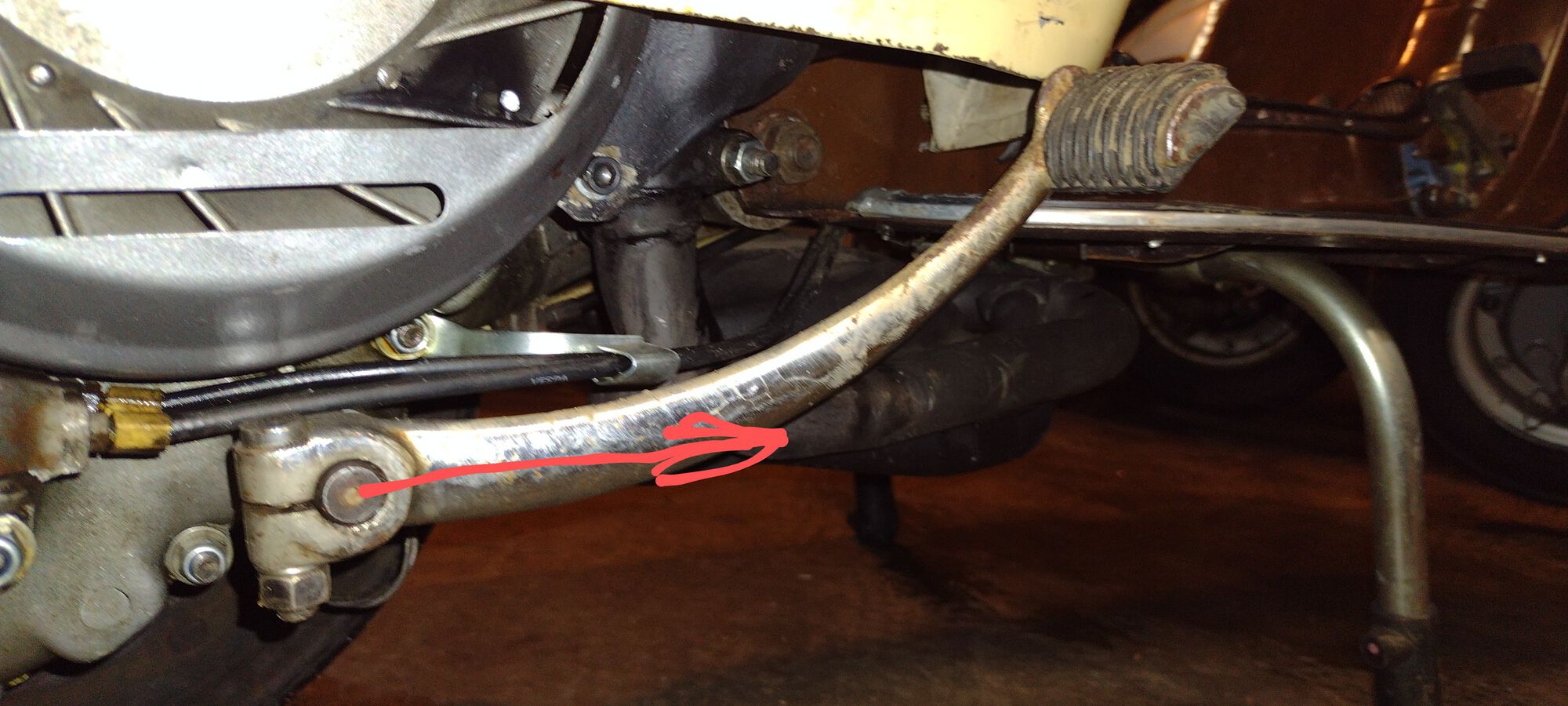

Here's the P style
- notice how a line thru the center of the spline pattern points to the sky.
Here's the P style - notice how a line thru the center of the spline pattern points to the sky.

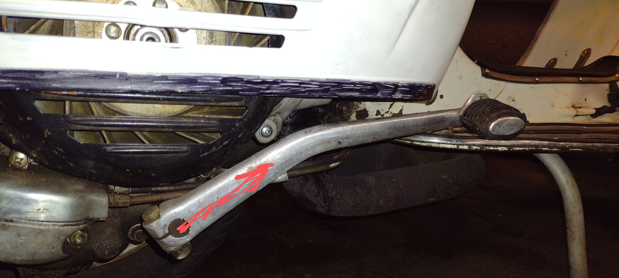

The original curved lever, that line thru the spine pattern is nearly parallel to the floor
