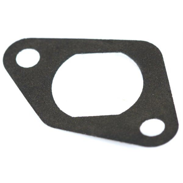

Motovista wrote:
Given that it's Piaggio, is this the same gasket as they use on the Beverly 350 with a new number? 847928 is that part number.
No, is round in center and biggest opening is used in the 2021 Beverly 400, the MP3 400 2020 and 2021, and the MP3 530 2022

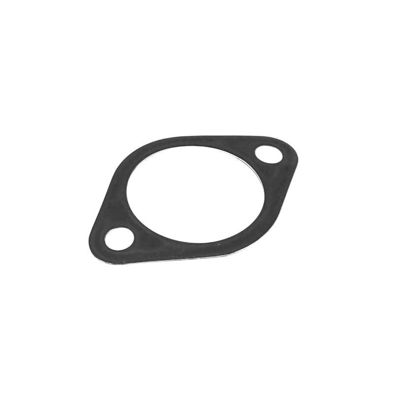

old as dirt wrote:
that looks like an exhaust manifold gasket
double check that part number
Agree that looks as a exhaust gasket but is for the Chain Support, see the next picture, the one below is the one that always was, the one above is the one I need, look at the shape

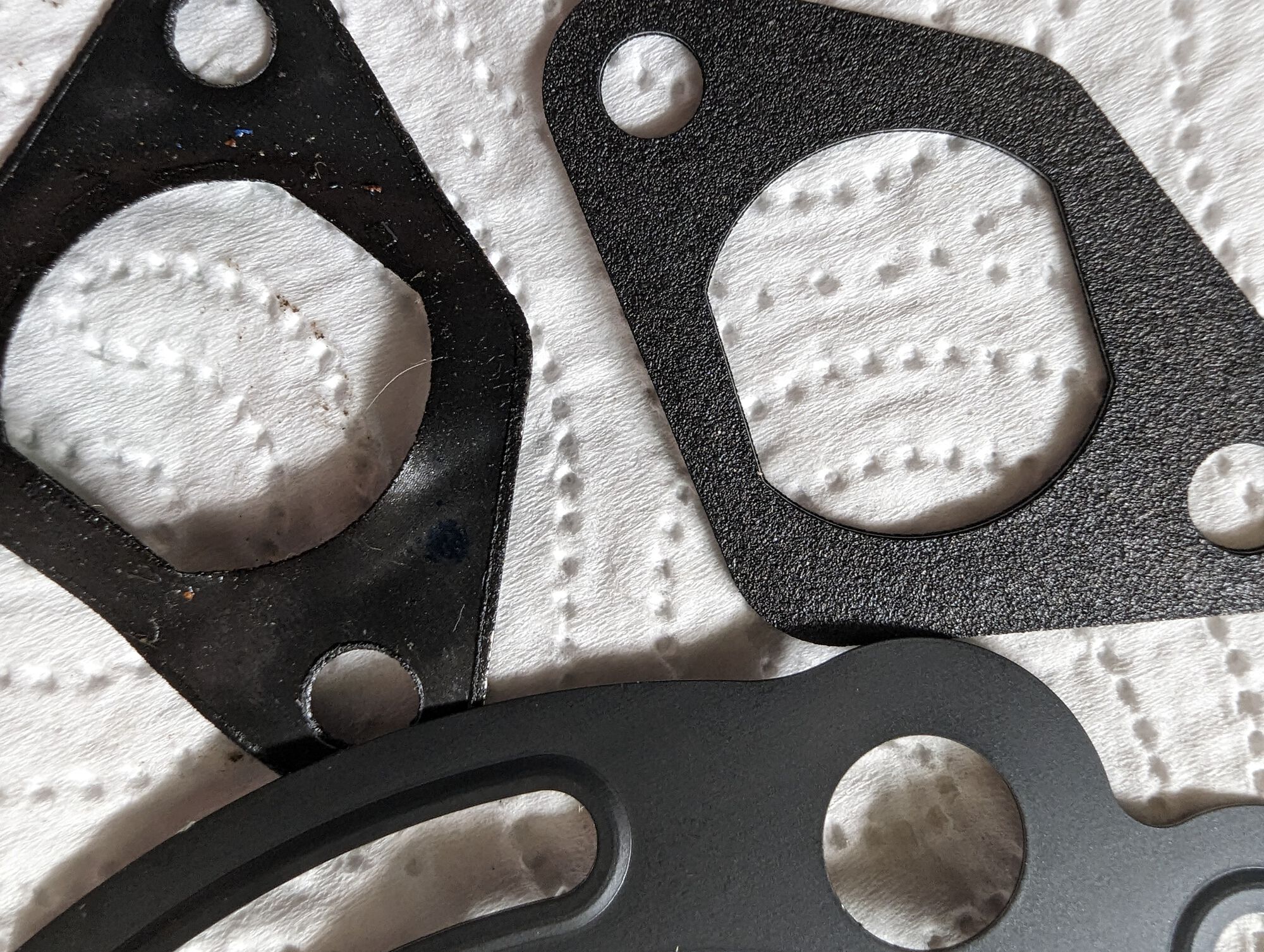

Posts: 8656
Posts: 8656
Not a high pressure location i think (use court summons for style) but Here are my measurements as promised
Gts300 rough measure (don't quote me):
Old and new head gasket .2mm and smooth.
Old chain gasket .2mm in the middle where squashed. rough around the edge where it sticks out about 1mm - about .3/.4mm there.
New chain gasket .5mm and coarse surface.
(All are metal).
