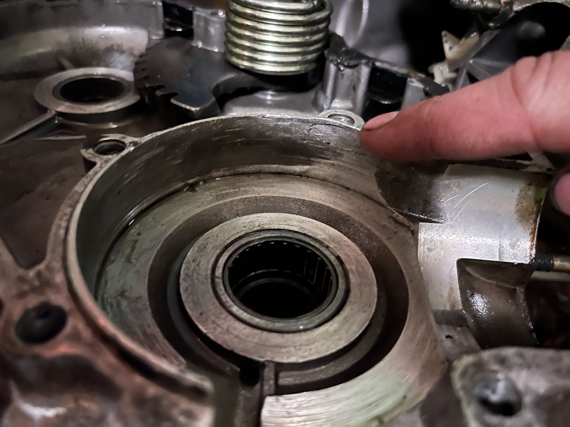

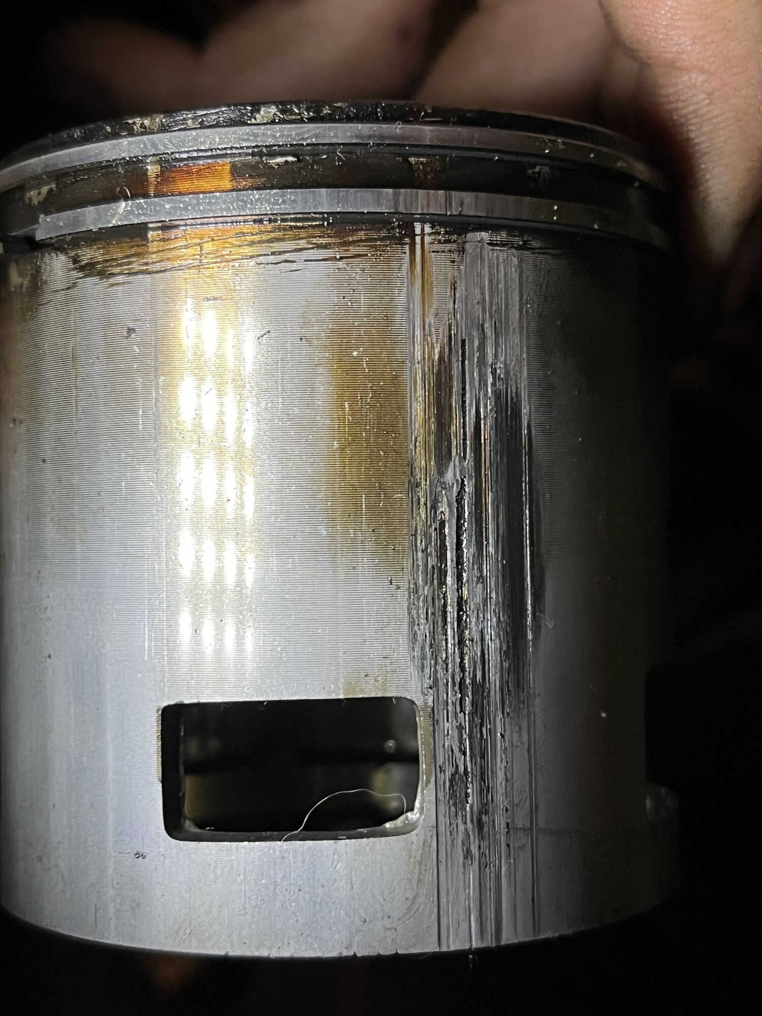

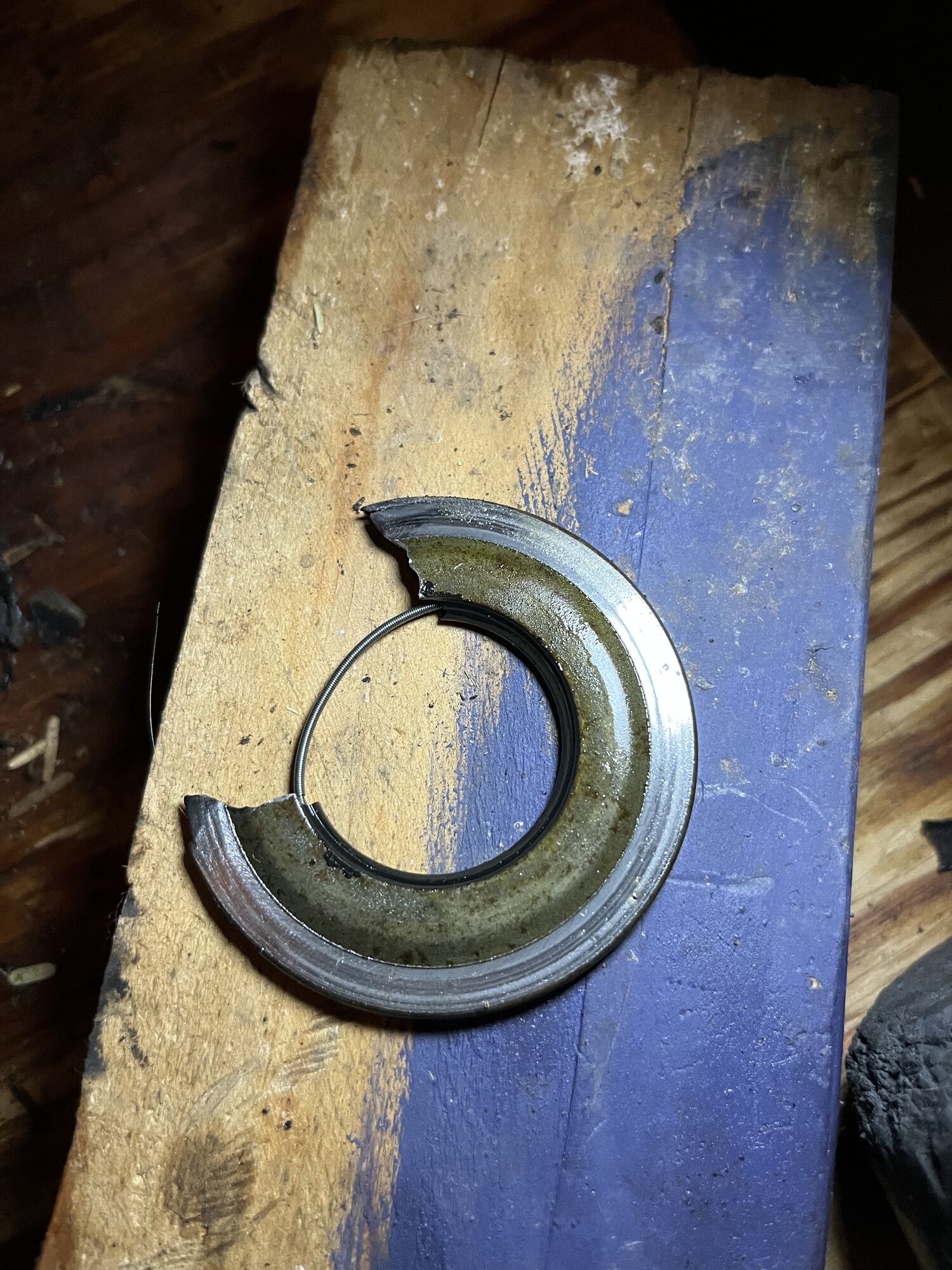

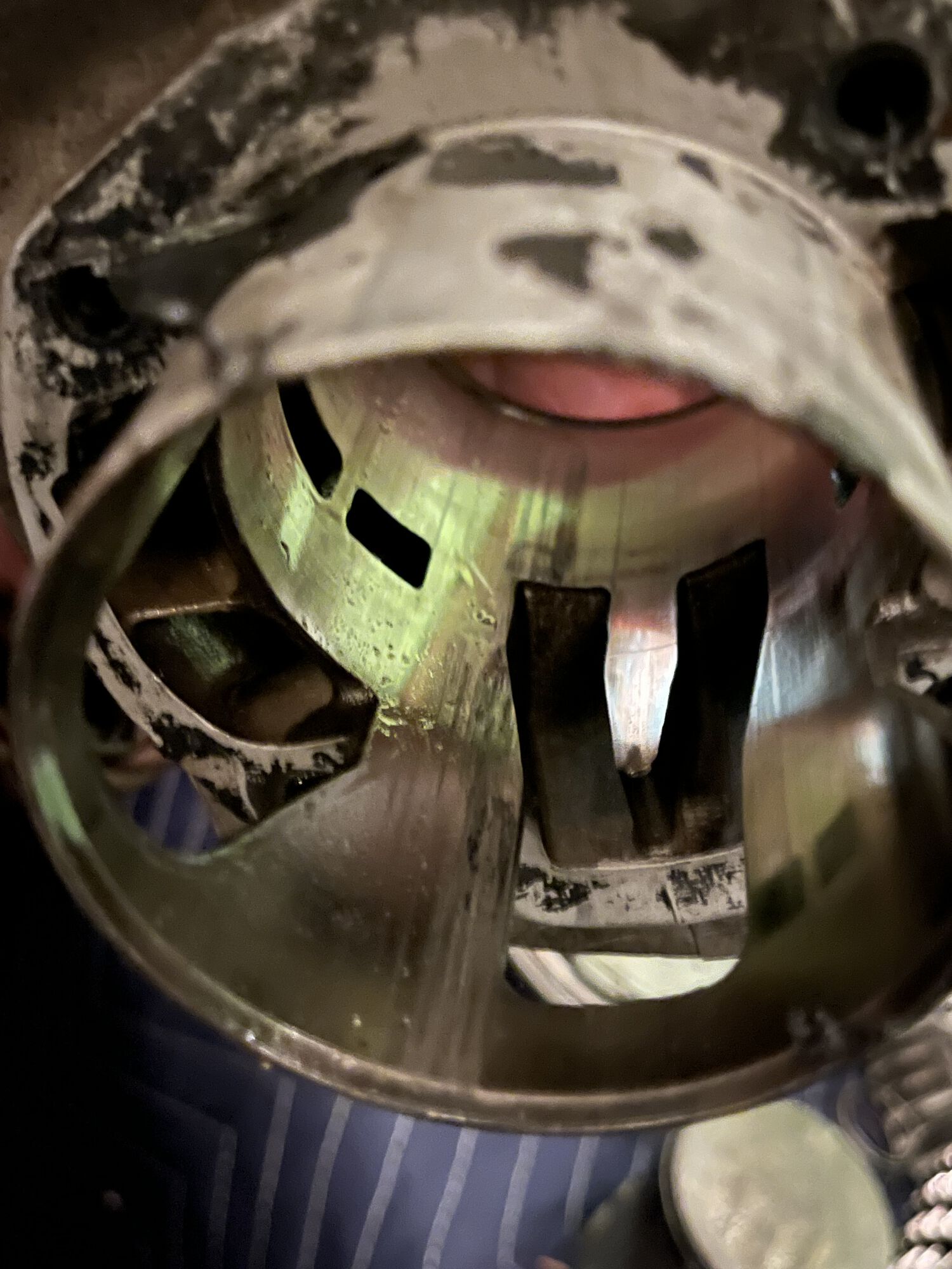

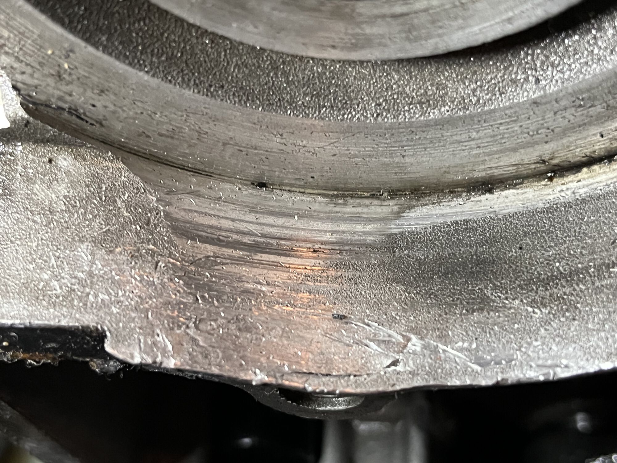

By doing a pressure test I learned there was a large air leak coming from the clutch side seal. So I cracked the cases and found the culprit, pictured. There also seems to be some damage to various adjacent engine parts, probably from when that chunk of seal buzzed through the case (but could be older, it has a pinasco cylinder and the cases have definitely been opened before - so much grey permatex!). Pictured is all the damage that seemed potentially serious, on the piston, cylinder, and a crack in the flywheel side case. The crack had permatex in it which makes me think it could be an old injury?
Anyways I'm wondering how you all would assess the damage/ what you'd recommend reusing vs replacing. I'm not trying to break the bank on anything, just get it back on the road... was hoping to just purchase a rebuild kit from scootermercato and leave it at that... alas.

The biggest problem is getting a clutch side seal to now stay in. When they have been run that long with a failed seal, the case wears. New seal will be a little loose. Might hold with loctite, might not.
Case crack is nowhere important. Cylinder scores look terminal.
A good opportunity to put back to total stock for the cost of a rebuild kit and used stock cylinder.

Further to Jack's comment, your biggest issue is possible damage to the clutch-side case half where the crank seal sits. A photo of that area would be instructive.

Can't get a good photo right now, but from my (beginners) inspection the clutch side seal seat seems pretty much unblemished. Or at least it doesnt have any dings in it, could be worn evenly all the way around I suppose.
I havn't gotten the bearing out yet, planning on replacing but it spins smoothly in there now. As does the crank which is out. Would a failure in either of these parts be noticable by eye or could it be pretty miniscule? Does the seal failure indicate other failures?

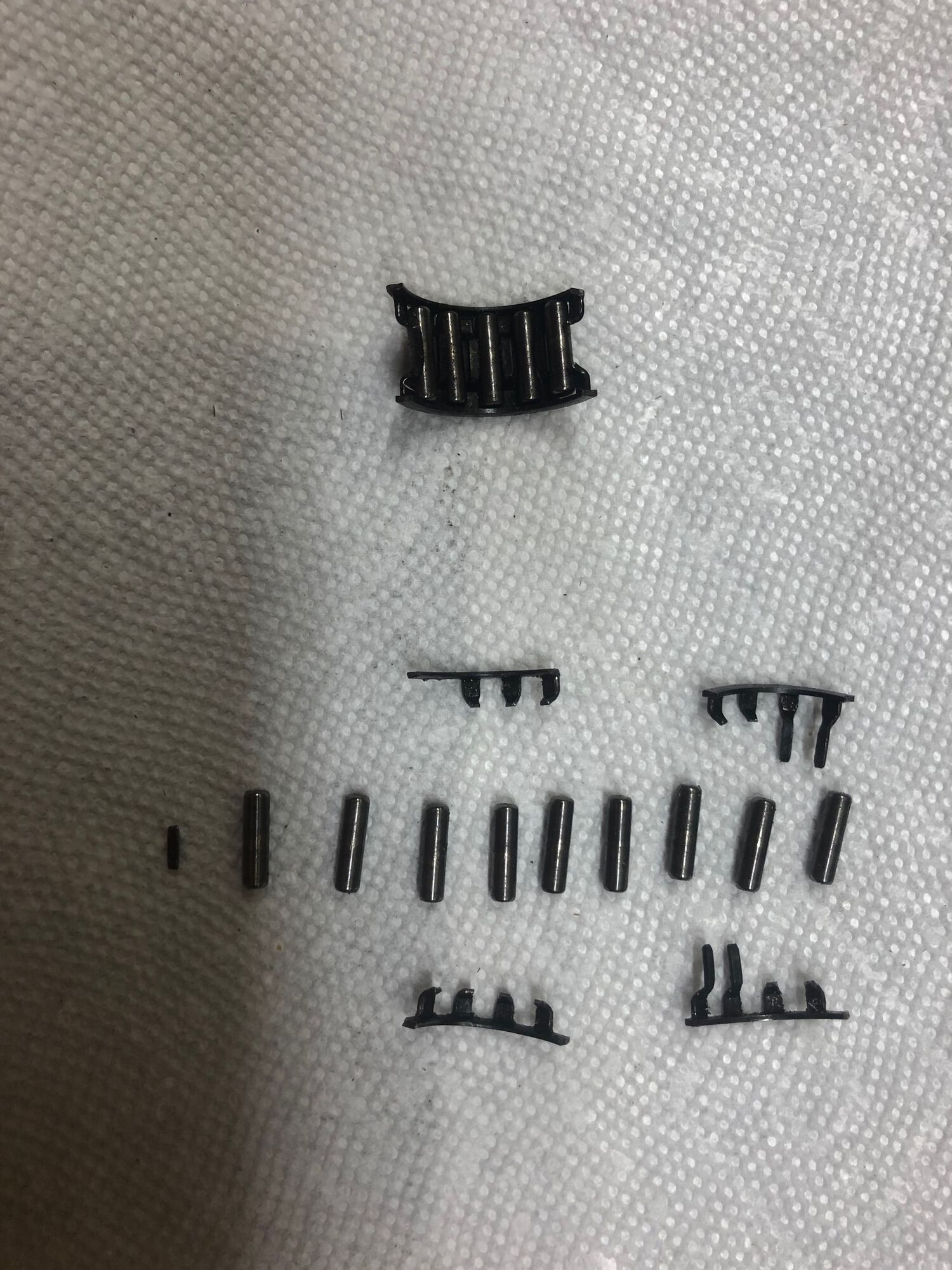

The classic etiology for an LML crankshaft fail is the lads at the factory pressed the cranks together with inadequate clearance between the webs and the big end bearing. That results in insufficient oil reaching the bearing, causing the bearing to overheat. The weak link inside the bearing is the bearing cage, which is just thin, stamped steel. Eventually, the excess heat causes the bearing cage to disintegrate, and fragments get sucked into the motor. From there, it is a crapshoot exactly what kind of havoc they will cause.
If I was you, I wouldn't spend too much time thinking about this. I would just determine if I still had an LML crank and, if yes, I would just replace it.
Also, I noticed the damaged clutch side seal was one of the rubber types. Stellas came with the metal type. Others may disagree, but my advice would be to go back to the metal type.

Anyways, I saw your pictures, that piston looks terrible in my opinion. The box of random parts that you gave me included the original cylinder and a cylinder head but not the piston and a crankshaft that has some resistance. I still have it if you want to re-use it but you will need at least the piston.
