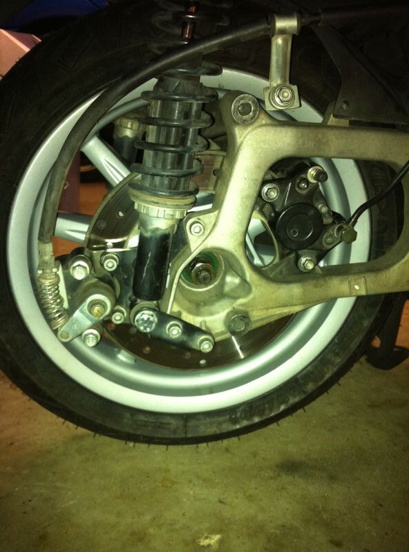

I changed my rear wheel from a 12" to a 14" rim, would rather ride around on a scooter tyre. It handles great and the rear tyre lasts for around 10,000 kms.
See this link 12" to 14" rear wheel on the 250[/quote]
Pic of 14" Piaggio rim
