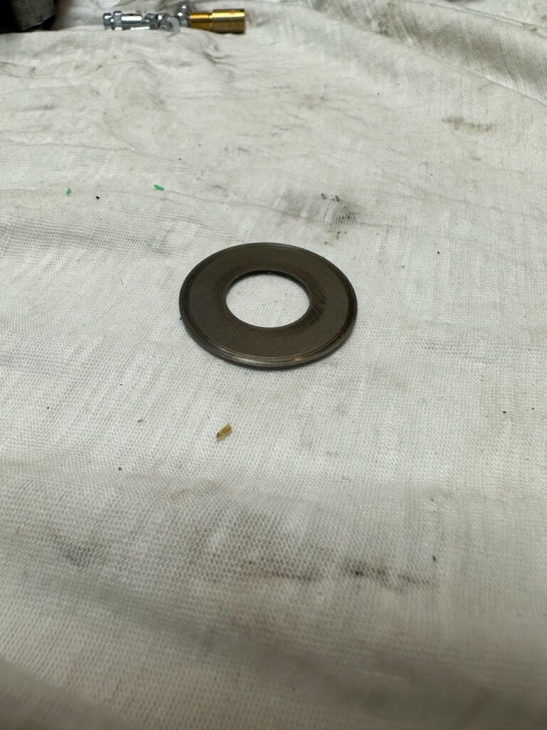

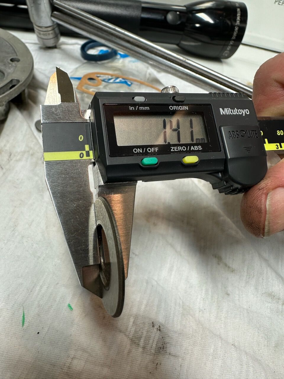

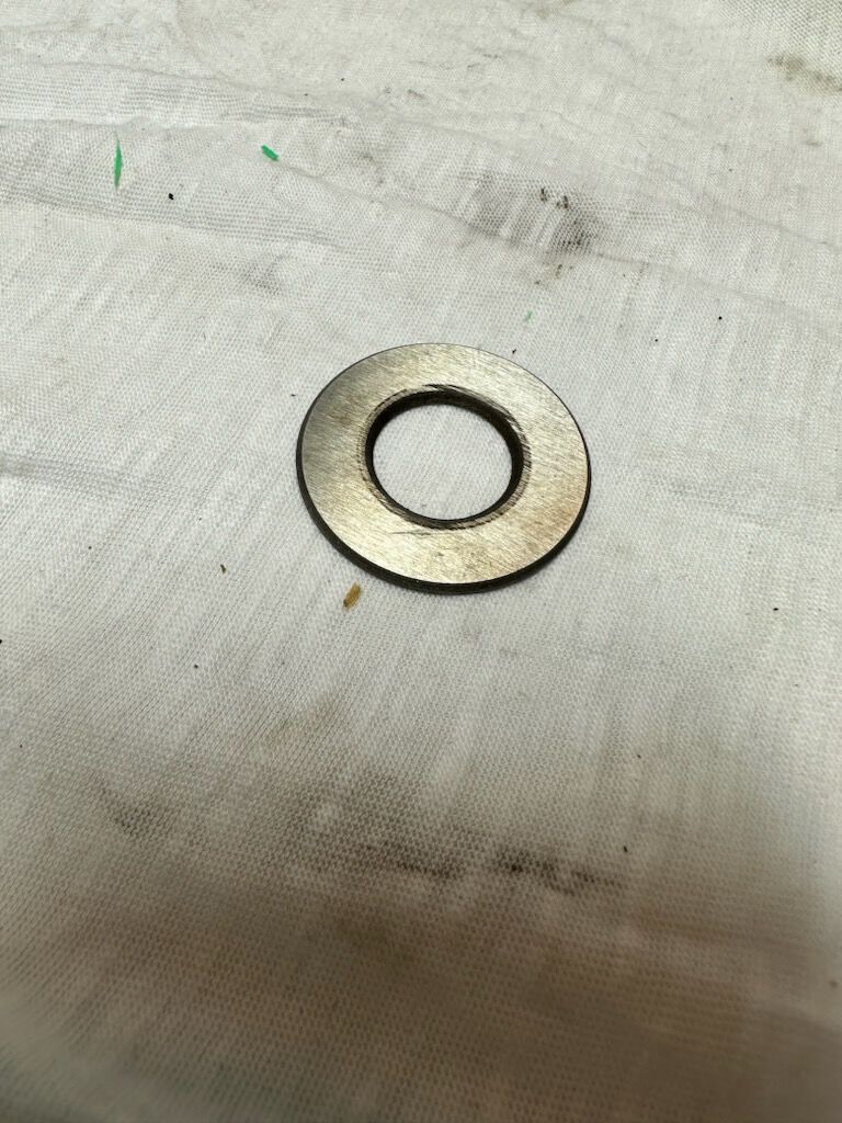

I finally got the motor together and back in the scoot. I was sweeping up the garage floor when I found this washer. It looks familiar but I can't recall where it belongs. Perhaps behind the clutch. HELP

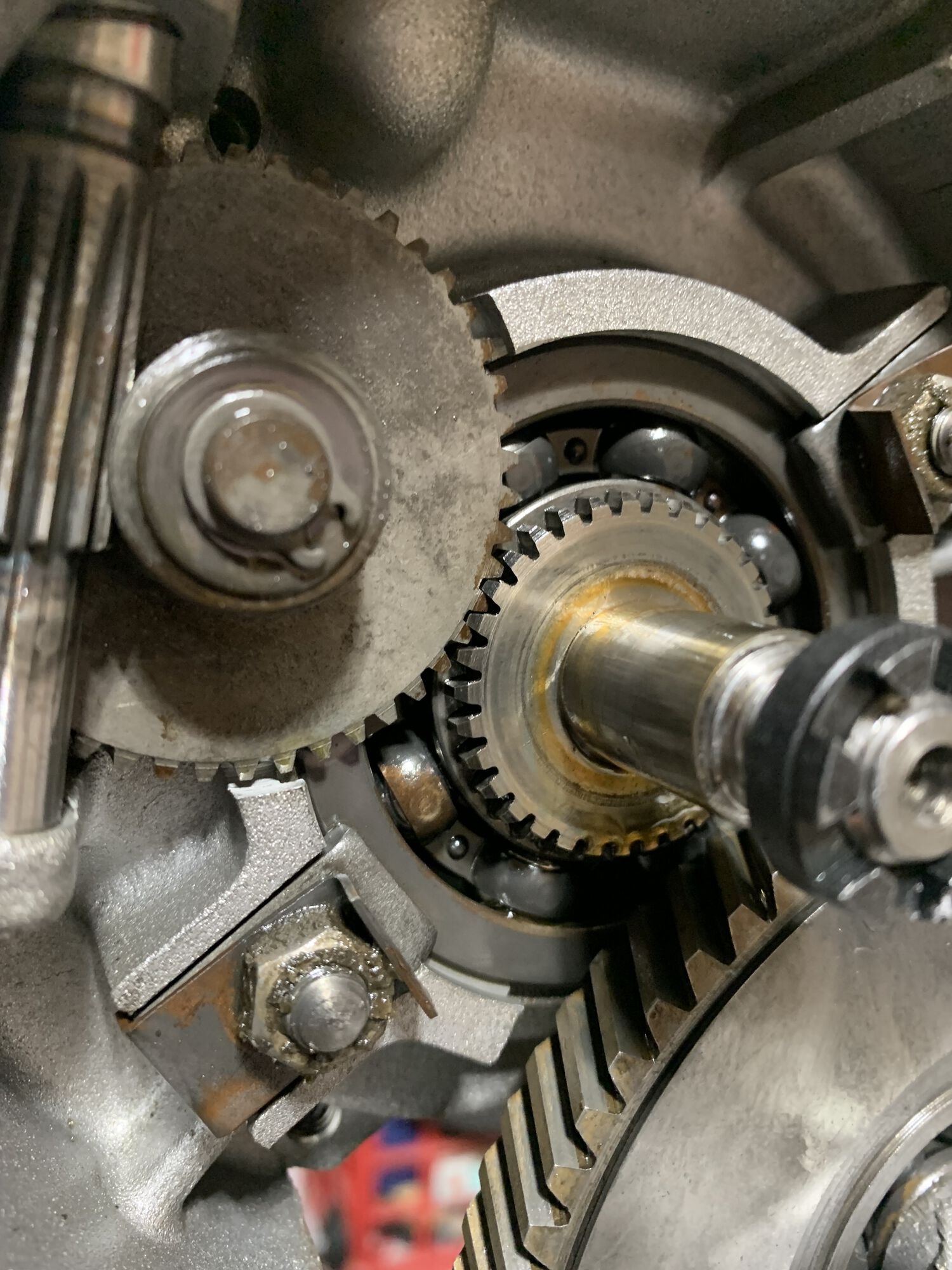

That looks like a spacer that goes behind the clutch if you delete the oil injection and oil injection gear behind the clutch.

Thanks Hec, you were right. Good thing the clutch can be serviced without removing the motor.

There should be a bevel on the ID, make sure it's in toward the flywheel, not out toward the clutch.
