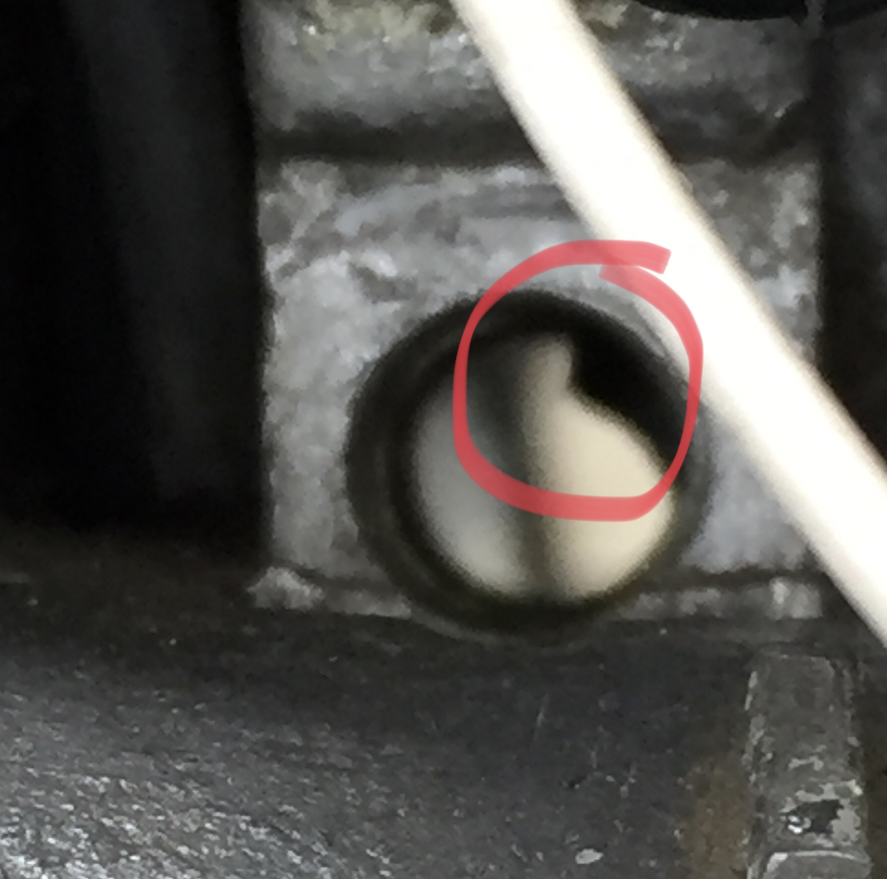

Hi all
I've recently rewired my scooter and took out the pinch bolt to loosen the headset to route things.
Everything is back together and I just need to tighten the headset to the fork but seems the headset is still a little too high so not lining up with the notch (see attachment)?
Is this a case of gently tapping with a rubber mallet or does it require more finesse - would hate to damage anything at this final hurdle.
Thanks so much!
Photo of pinch bolt misalignment
@mattt avatar
1977 Rally 200
Posts: 51
@mattt avatar
1977 Rally 200
Posts: 51
Worked it out!
Seems I'd tightened the ground/retainer plate inside the headset down too tightly when adding new ground wires.
Just loosened it a little and it all lined up again.
Glad I didn't try to convince it to fit with a mallet - haha
