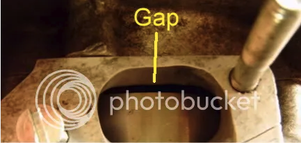

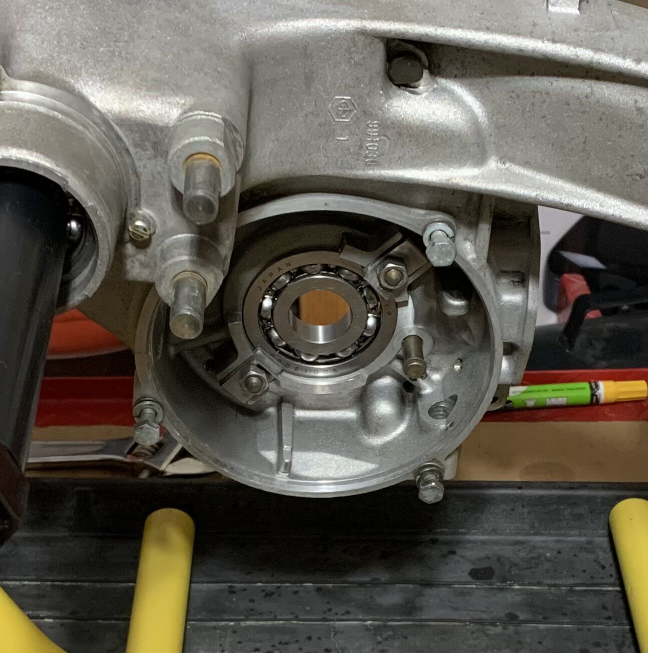

For some odd reason, I think it might be a slight gap at the crank/rotary pad area. I attached a pic from another posting for an example. What would the symptoms be with a gap like this?
Gap example 1
Gap example 1
Gap example 2
Gap example 2

Symptoms will be the one you're describing.
But the chances of starting the engine will be low though.
Won't be a good enough seal to create a vacuum to suck the air/fuel.
You can check by removing just the carb. You might be able to check just removing the throttle slide, but don't hold me on that, but that's what I would try.

yeah seems like your crank isn't centered, that's not going to be helpful at all

SDJohn, I was thinking the same thing. I always have trouble installing the crank bearings and putting the cases together. Takes me a few times after every teardown.
Any ideas on how to center the crank? It's hard for me to see since the seals hide the bearing insertion depth. And I am always concerned that the bearings will go too far onto the crank or not deep enough into the case. I swear I have see some sort of shims between the crank bearings and counter weight.
I don't know what engine you are working on. I can only speak about a P125X engine because that's what I have. With the snap-ring installed, I installed the clutch side bearing by freezing the bearing to -20 F and inserted into the heated engine case. The bearing basically dropped into the bore and only needed a love tap with a hammer to drive it home. I did use a SIP bearing drift.
I would think if your crankshaft wasn't centered, the Connecting rod would be binding as it wouldn't be centered either.
Hope this helps.
Hec

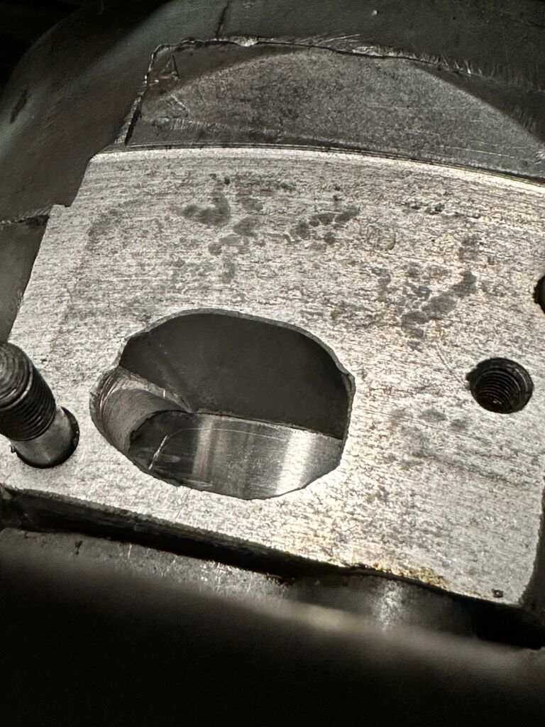

That inlet looks like it was ported for a reedvalve intake, maybe a Malossi by the look of the shape. What carb, intake etc are you using?
That's a huge gap. I think you're right. I'm surprised it runs at all.
OP, do you have any pics of the rotary pad from before you assembled the engine?

My gap is not that big nor is it ported for a reed valve. I used that pic from another post from another person as an example of what my issue might be. My rotary pad is in good shape, I am just concerned that there might be a gap since I had no way of ensuring the bearing was seated all the way in the case. I do not have any pics as that has not been an issue for the last few months. People are pointing toward timing, that is not my issue.

maybe you need to pull your carb and get us a look at the gap (or lack thereof) on your own engine, before we go racing off based on somebody else's picture.
Hec - he's got a VBB, so it's the old style with the brass races in the case, and the non-split bearing setup. At least I assume that it is.

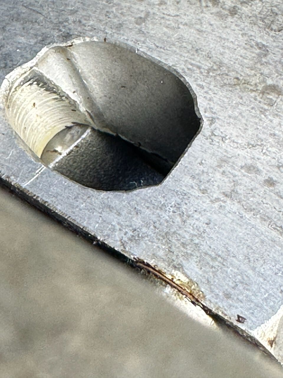

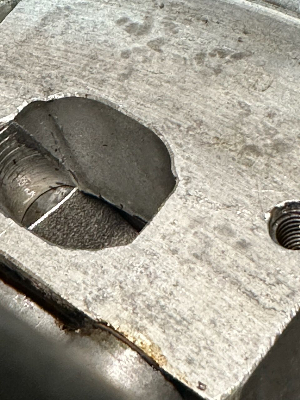

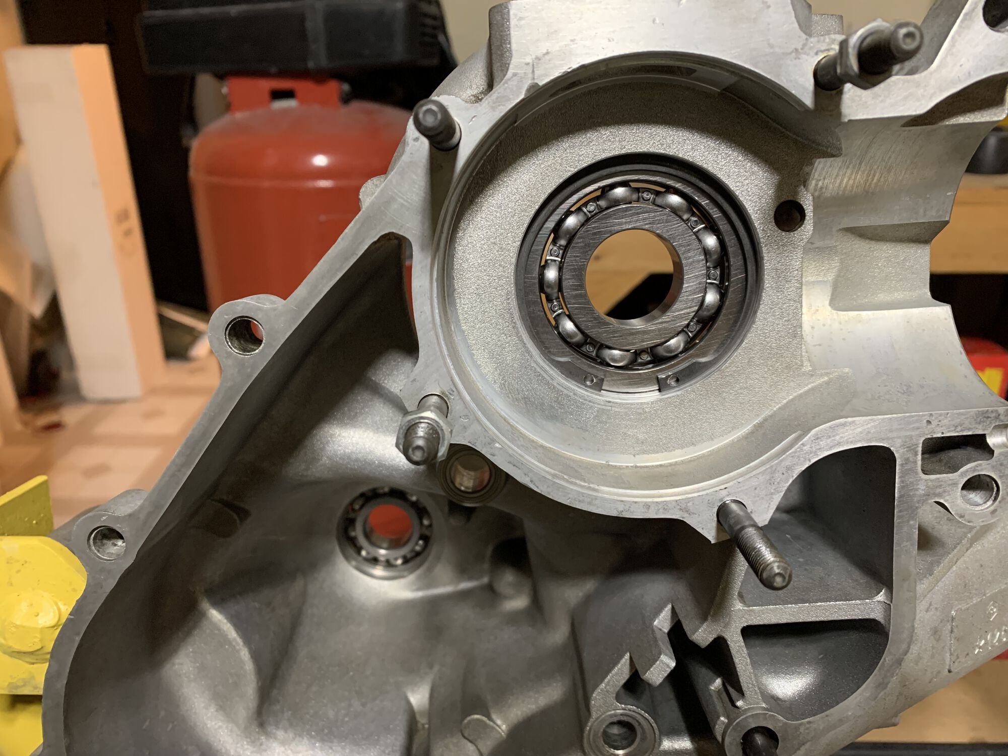

Ok People, I removed the carb and looked at the rotary valve area. Looks OK to me. The counter weight is a few millimeters under the rotary pad area. I guess that means the crank is centered and the bearings are seated all the way. The thinest feeler gauge I have is .152MM and I can't fit in anywhere in the area. So that now leaves more questions than answers. At least for me.
Pad 1
Pad 1
Pad 2
Pad 2
Pad 3
Pad 3

Position looks great… between rotary and crank too.
Problem is elsewhere.
I'd relook at carb/jetting/ignition.
What engine and parts is it?

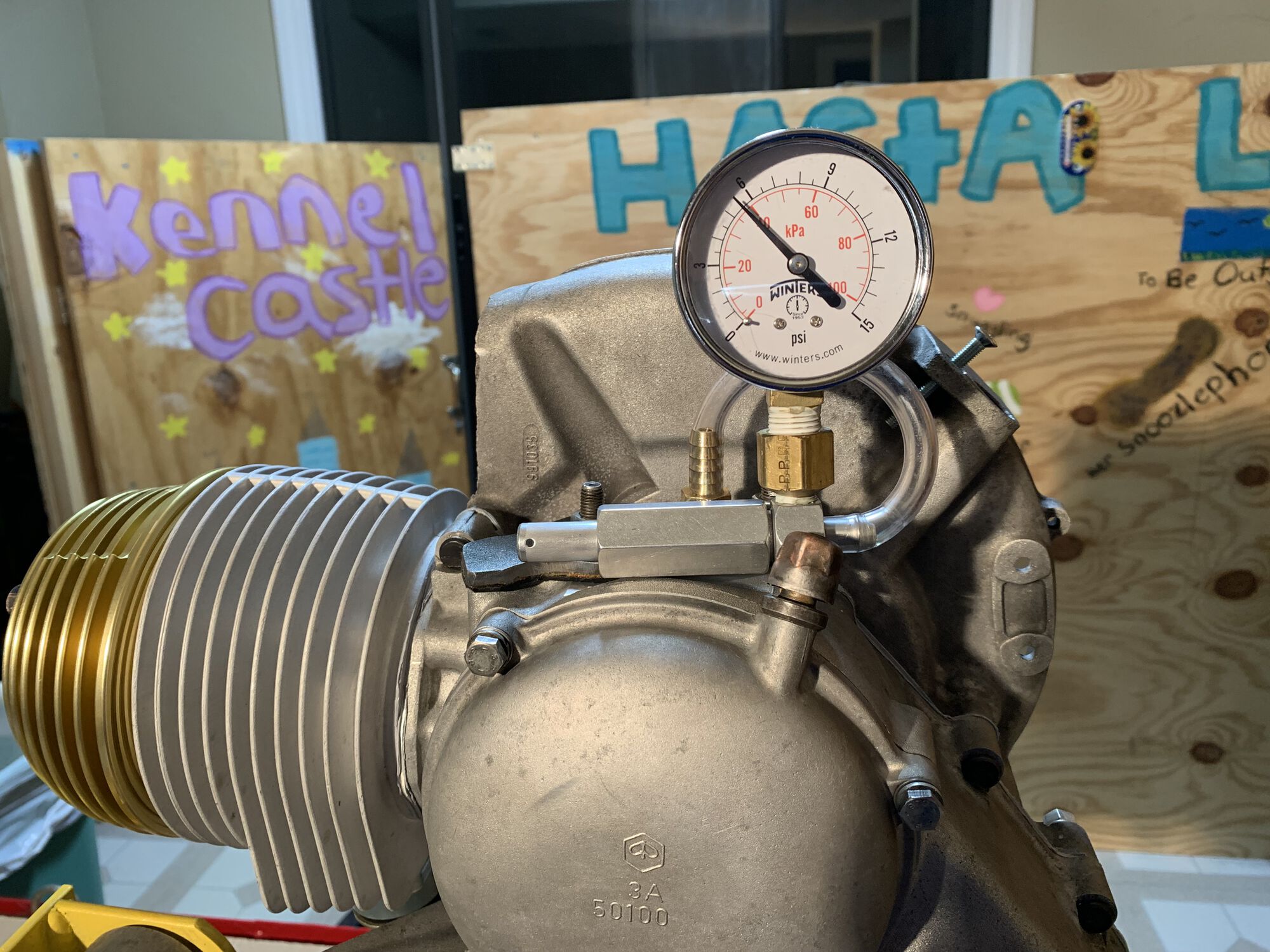

When you did your compression check, did you remember to do it with the throttle wide open? If you did it with the carb removed that would be ok too.
You should be able to remove the cylinder with the engine still in the scoot. You will have to remove the cylinder studs to do so. Take note of how much thread length of the cylinder studs is inserted into the case and which end of the stud is inserted into the case so you can replicate this on reassembly.
Before you do any more disassembly I would recommend that you do a pressure test on the engine to rule out any air leaks.
Good luck
Hec

chippieboy wrote:
Yes carb was off during the test. Dooley noted on the cylinder studs. As for pressure test, rubber plug in the exhaust port, homemade block-off plate for the carb & some sort of spark plug adapter to pump with gauge. Does anyone sell some sort of kit that you know of? Also, how much pressure and for how long of time?

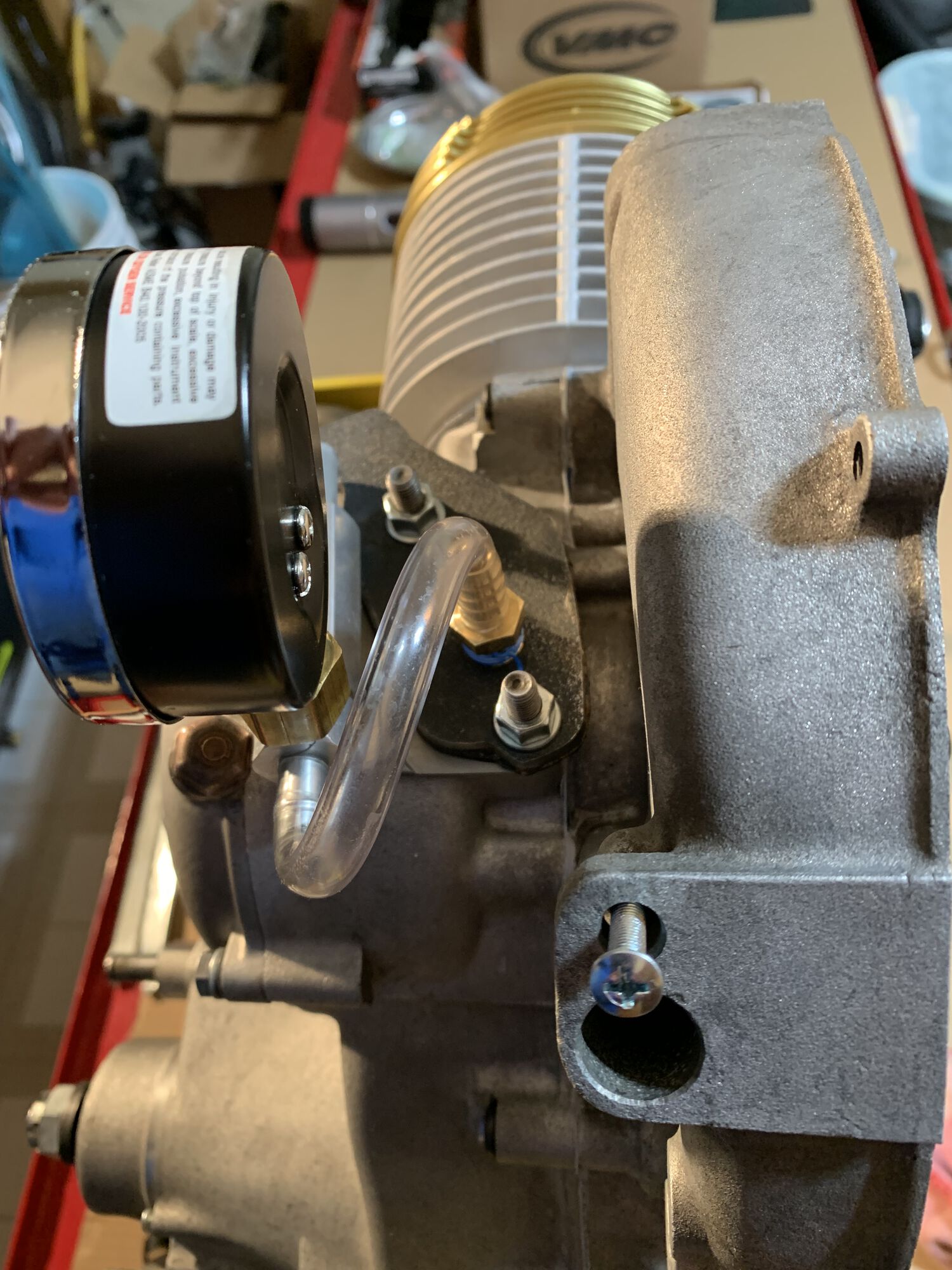

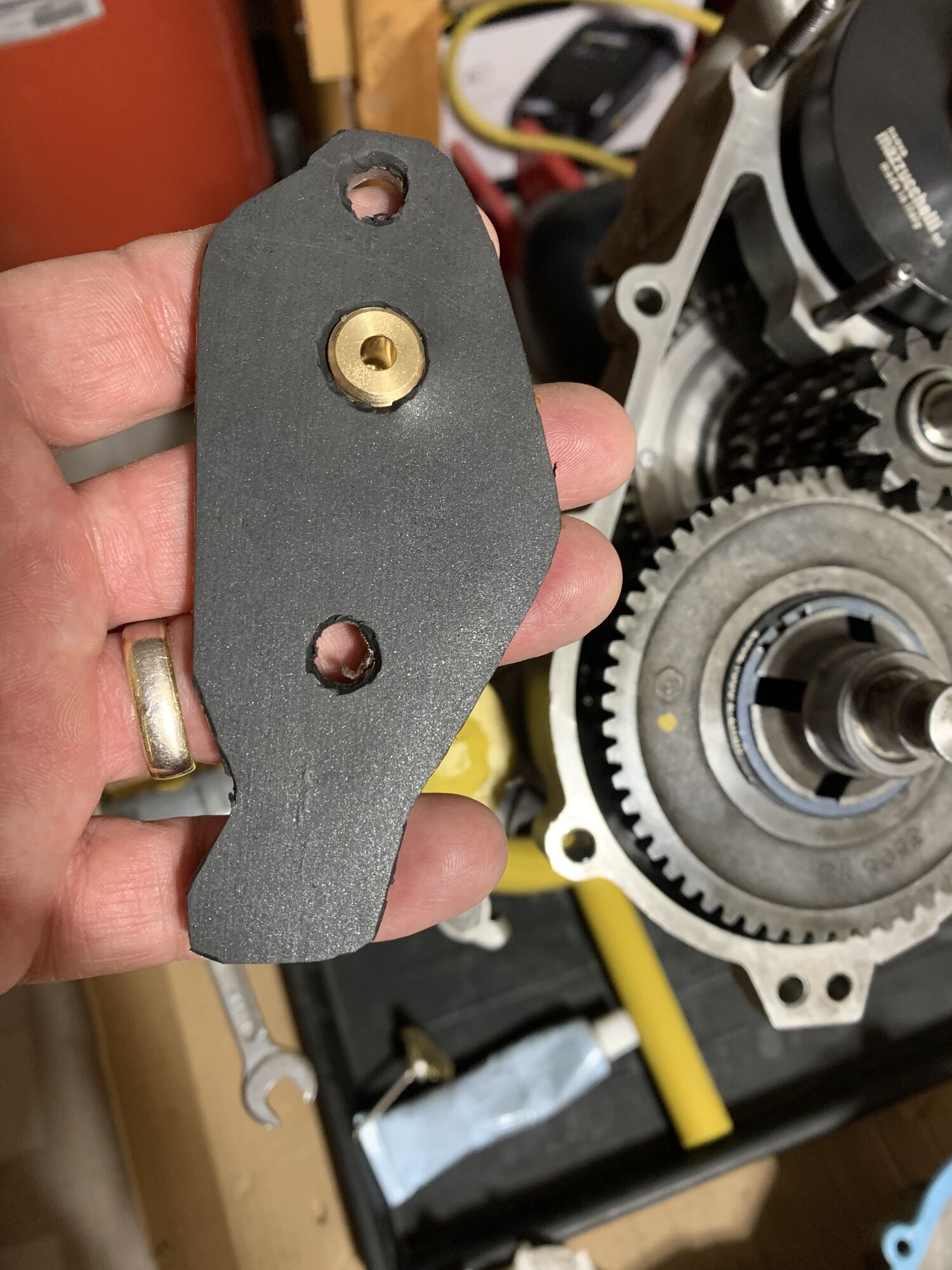

You should hold 5-6 PSI for at least a day. Here is my set up for pressure testing.
Hec
My set up for Pressure. testing
Intake block off plate
Hec
5 psi for 5 minutes is enough. More is just showing off 😉
