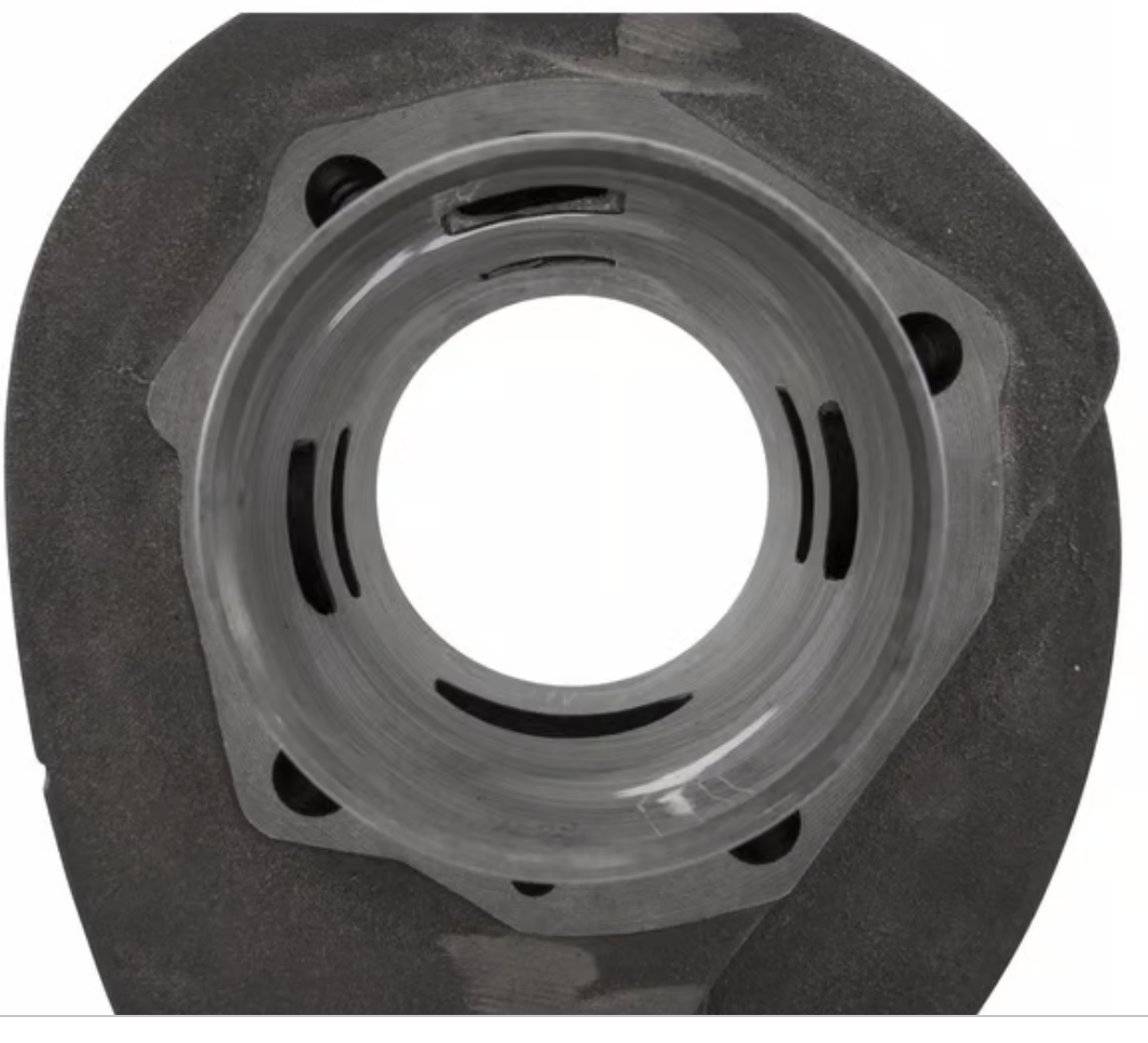

Looking forward to some more info on this:
https://www.sip-scootershop.com/en/product/cylinder-sip-200-cc_41470730
Looks like an alu version of stock, with just the boost port and two side(ish) ports forming five ports in the cylinder, and what is hopefully a good quality piston with thinner rings. The miniscule details specify a 57mm crank, so wonder what timing you'll get with a longer stroke? The ports look a bit rough.
Clearly not a performance play, but could be interesting for a stock+ kind of setup.

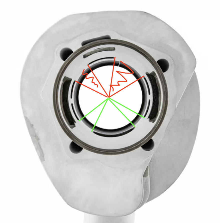

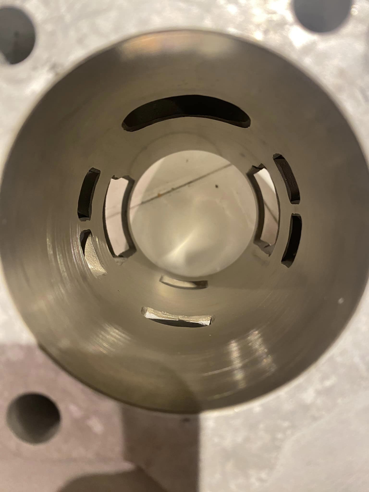

Nice to see they fixed the symmetry of the exhaust port between the main transfers, but then they went and put the boost port off center

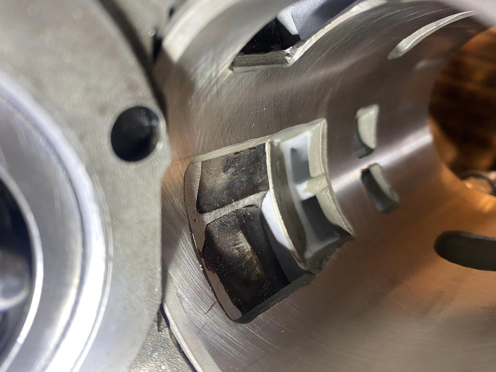

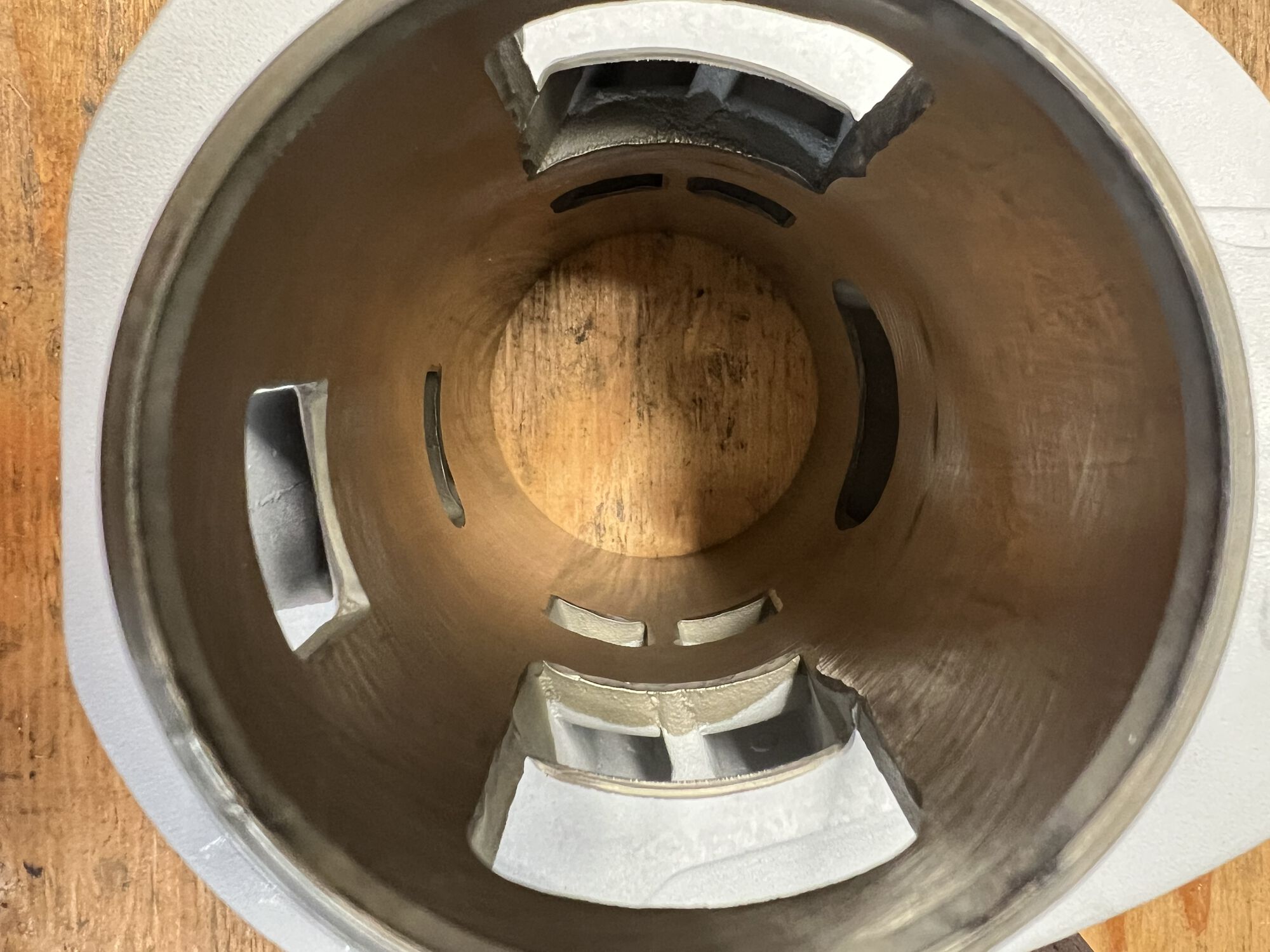

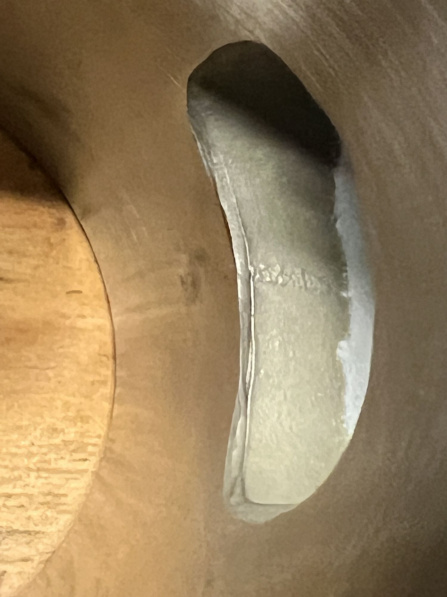

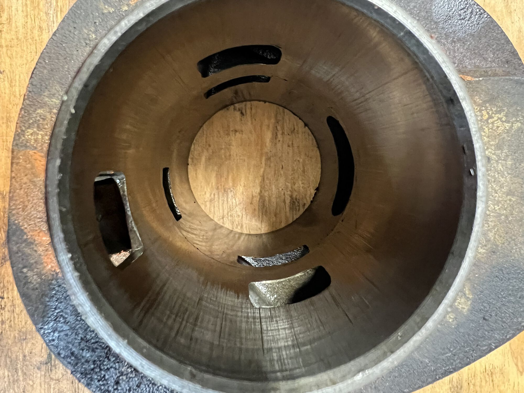

asymmetric ports.
I like this cylinder more than the stock and think it could rock with a GS piston.
edit: I also like that they kept it the stock bore.

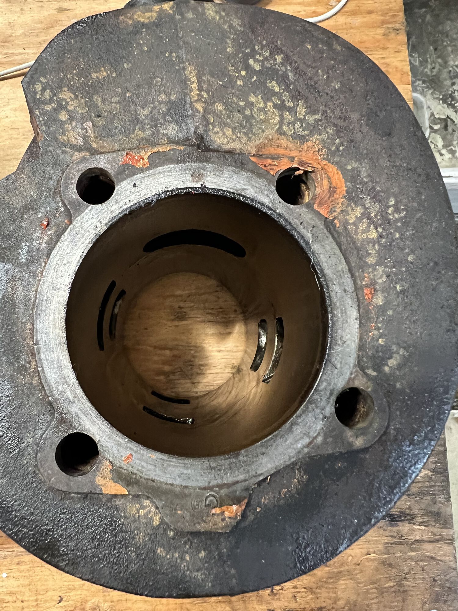

Stock Cylinder: note the unequal spacing between the edges of the exhaust port and the edges of the main transfer ports.

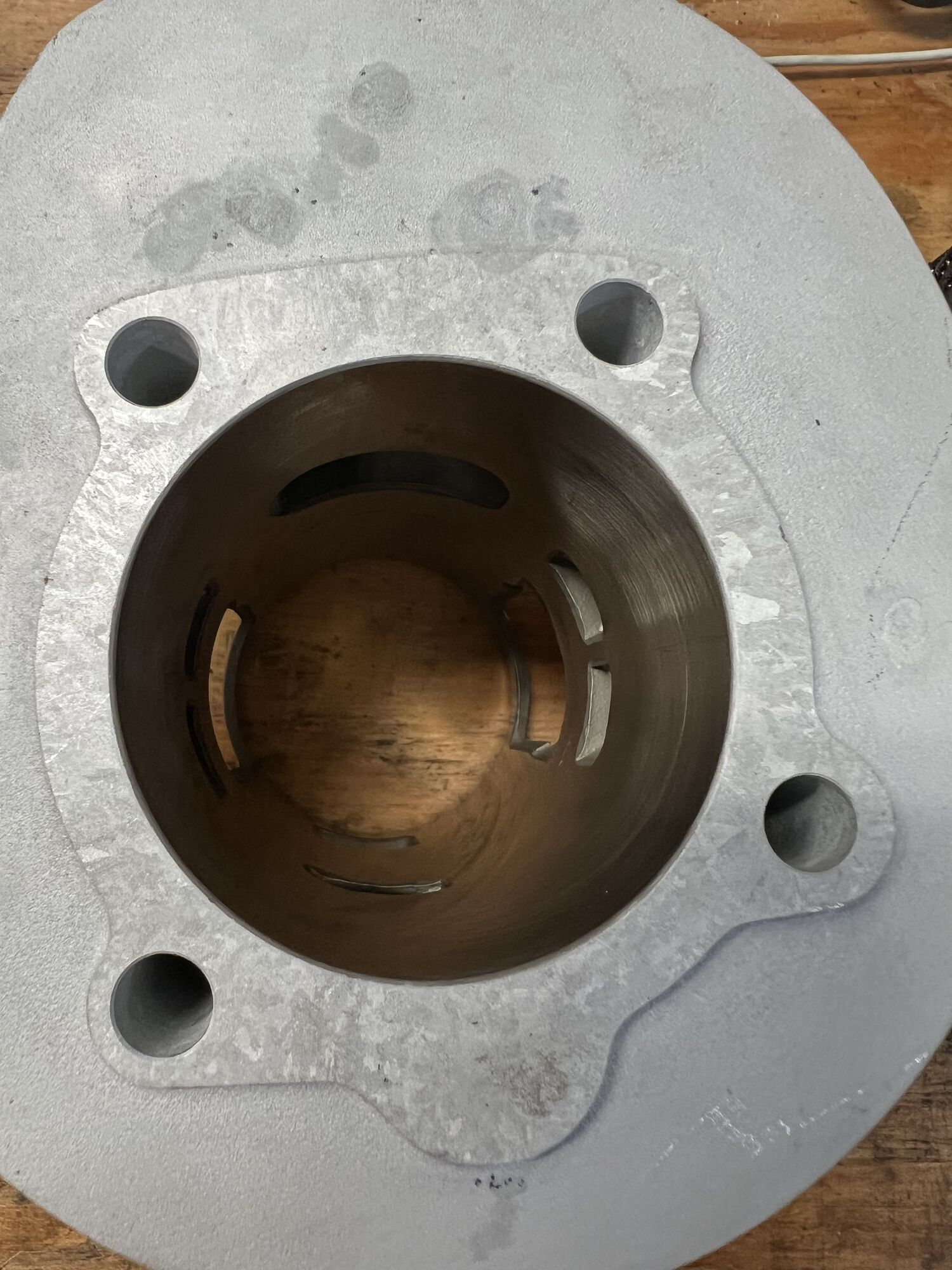

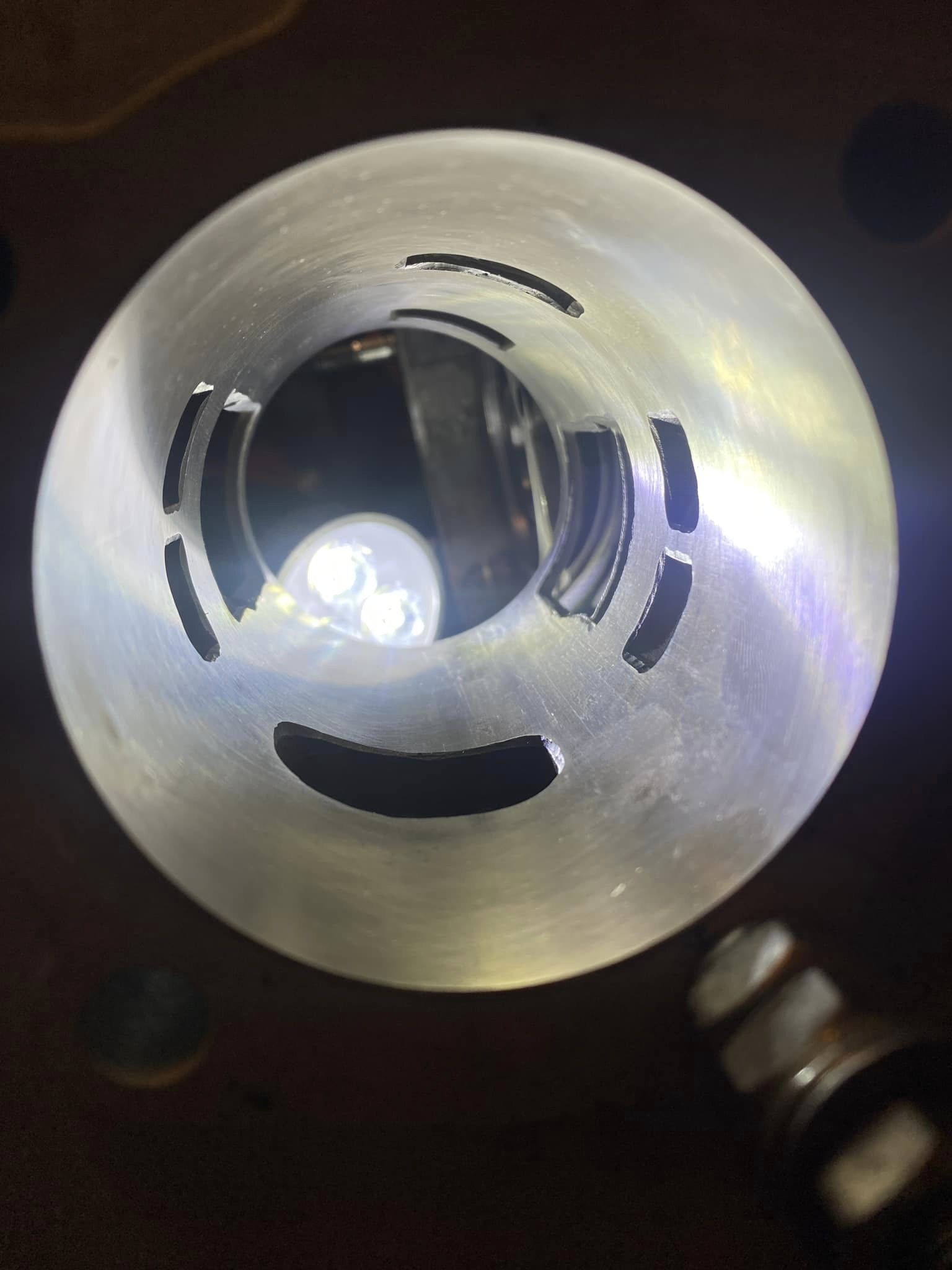

SIP Cylinder: note the equal spacing between the exhaust and main transfers :), but also note the unequal spacing between the main transfers and the boost port on the back wall :(

Can't tell if the transfers are bigger than the bore at the base of the cylinder.
Or if they're like the stock cylinder and only the boost port protrudes.
It's really hard to tell. The supplied gasket is like a stock one, so my assumption is that the side port protrusion is non-existent, and those little cut-outs at the base of the piston are feeding the side transfers. Therefore no mods on the case would be 'necessary', suiting people who wanted to keep their cases factory spec. but wanted an improved performance (and heat?) dynamic, whatever that looks like with this cylinder.

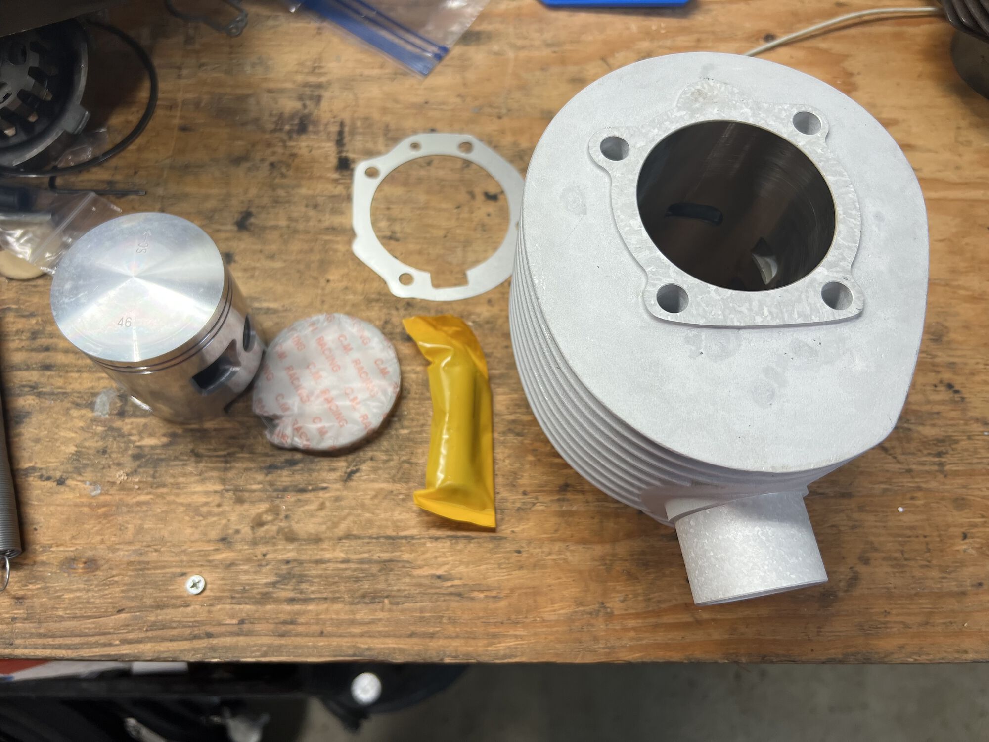

MJRally wrote:
You've got me sold! Finalizing my SIP order tomorrow and will order one. Probably be a week or so before I can get pics.

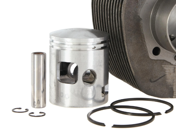

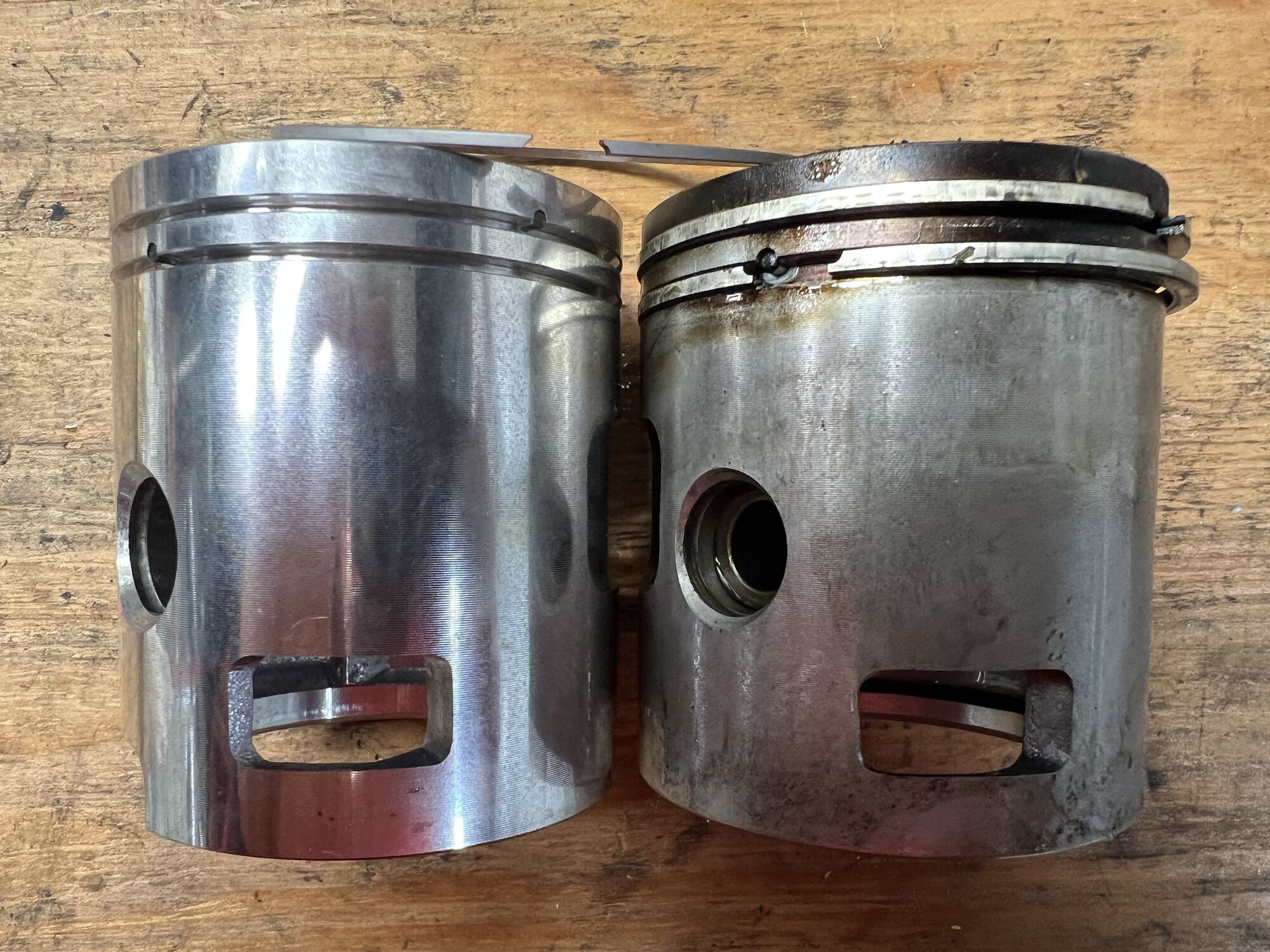

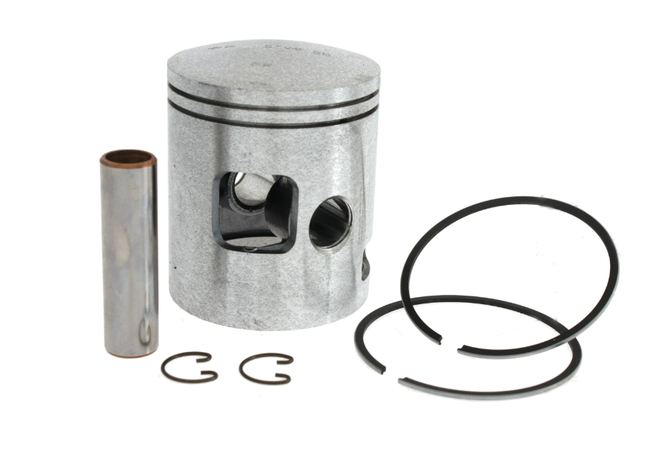

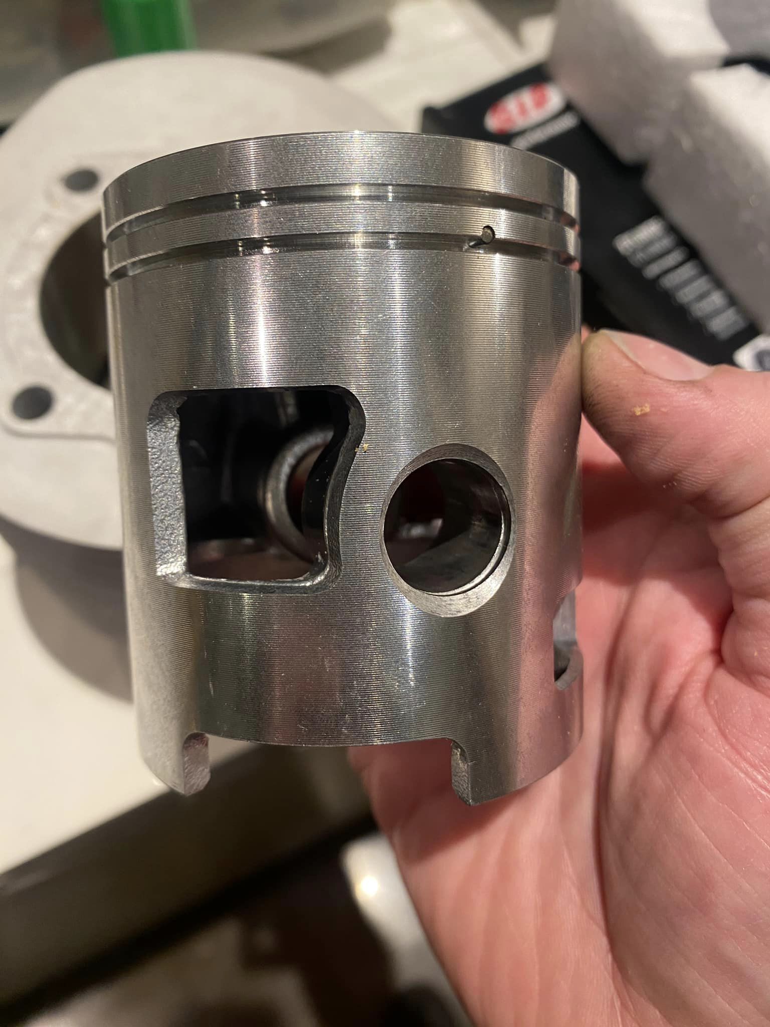

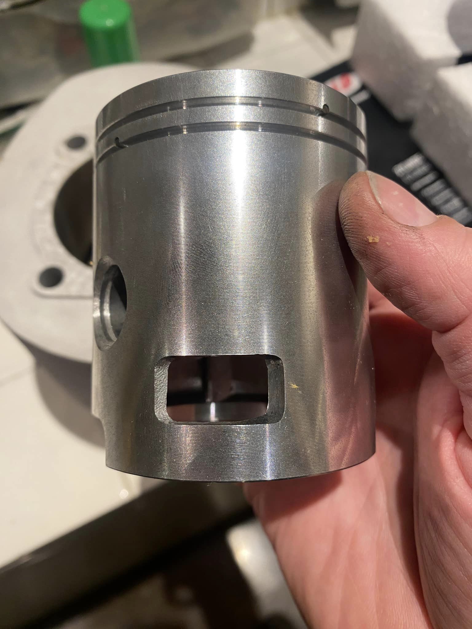

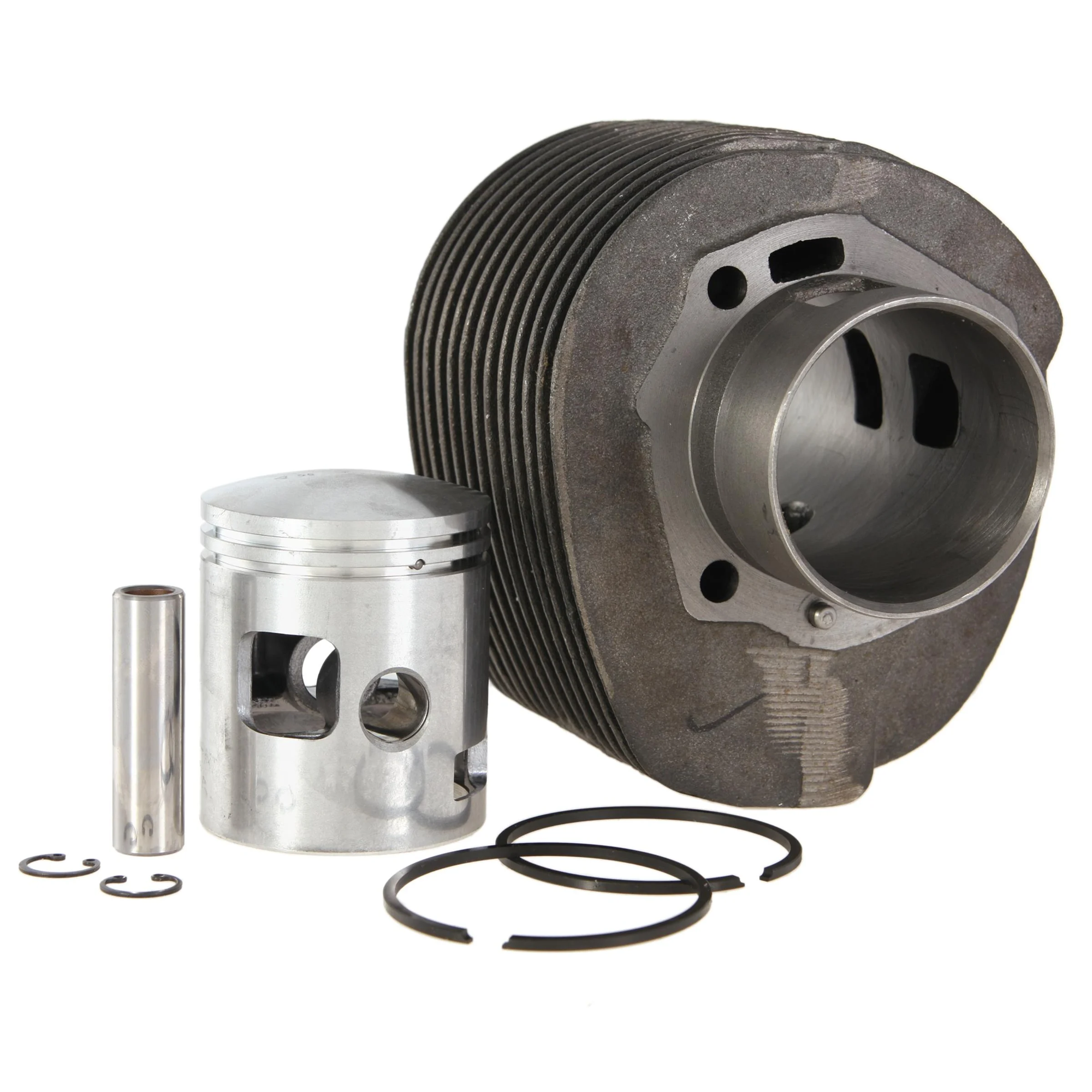

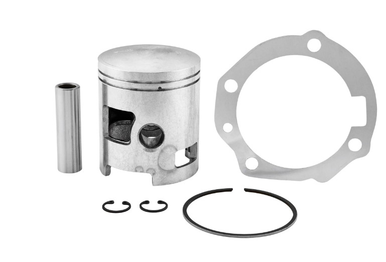

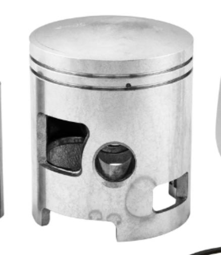

Me too almost, but do you think this is a GS piston?
SIP's aluminum cylinder piston.
It looks different...
SIP's aluminum cylinder piston. It looks different...

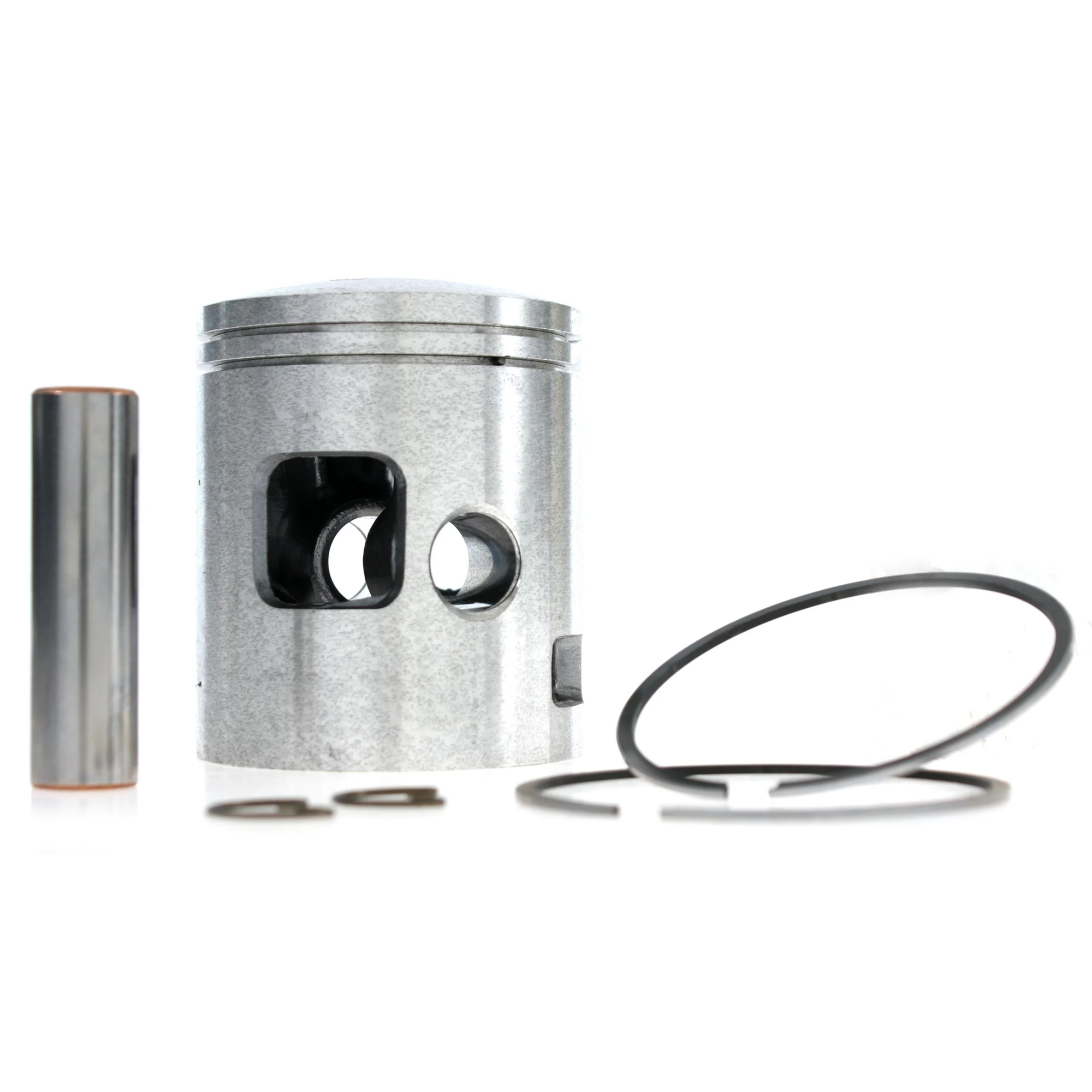

This is the GS piston that ships w/ the Serie Pro.

I just noticed the circlips in both those photos: neither of those are GS pistons. The Serie pro does come with a GS piston (or did years ago when O got one to keep as a spare) so likely just a mix up in the photo.
Posts: 10087
Posts: 10087
GS piston...
I don't think it's a brand? So maybe it's a style that's supposed to be like an original GS160 piston??? Please tell me more about the proper GS piston that came w/ your Serie Pro, and maybe share a pic. I know they have thinner rings, but what makes a piston a legit GS piston when it's made for a 200cc motor??
Edit: I was wrong, Grand Sport IS a brand, and their pistons have the round wire type wrist pin retainers as noted!
@safis avatar
Posts: 5166
@safis avatar
Posts: 5166
The Serie Pro shows two different pistons. Once again, SIP sucks…
https://www.sip-scootershop.com/en/product/cylinder-serie-pro-200-cc_41470700
Posts: 10087
Posts: 10087

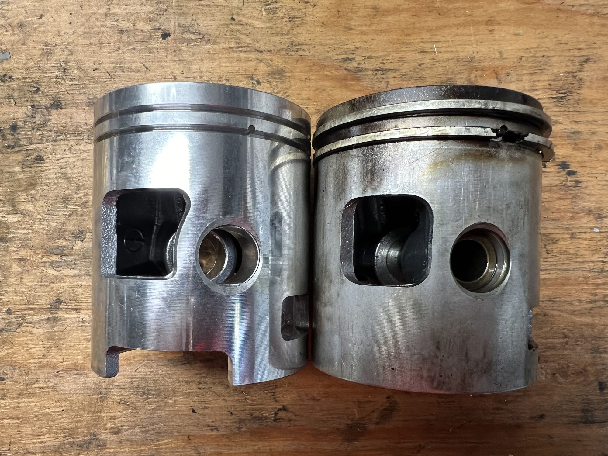

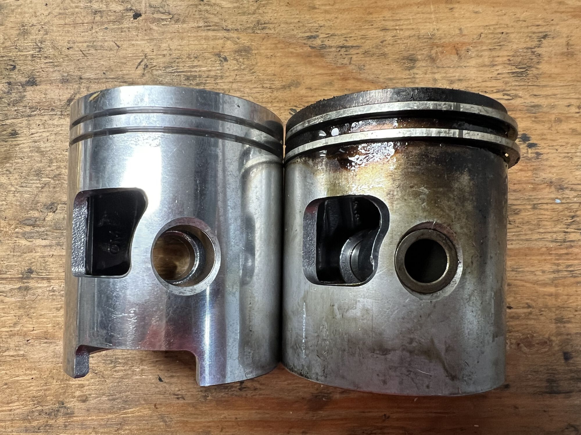

With all that said, the piston with this new kit looks to be more 'engineered' to mate with this new cylinder and if the port layout improvement already highlighted is any sign, then it seems that they've done a good job on the DESIGN end of things, now we find out how their quality control is in PRODUCTION. Somebody dare ask SIP who makes it?
If the piston is decent and the nicasil is too, I think I'm a likely buyer here, so I'll await first reports. Popcorn emoticon
I noticed that this piston might breathe just a bit better if these differences help as I'd expect:
1) the window by the wrist pin is slightly enlarged, probably same other side
2) the window for the center boost port definitely looks bigger
3) the notches at the bottom to match up w/ those big windows in the cylinder skirt
different than ALL the rest!

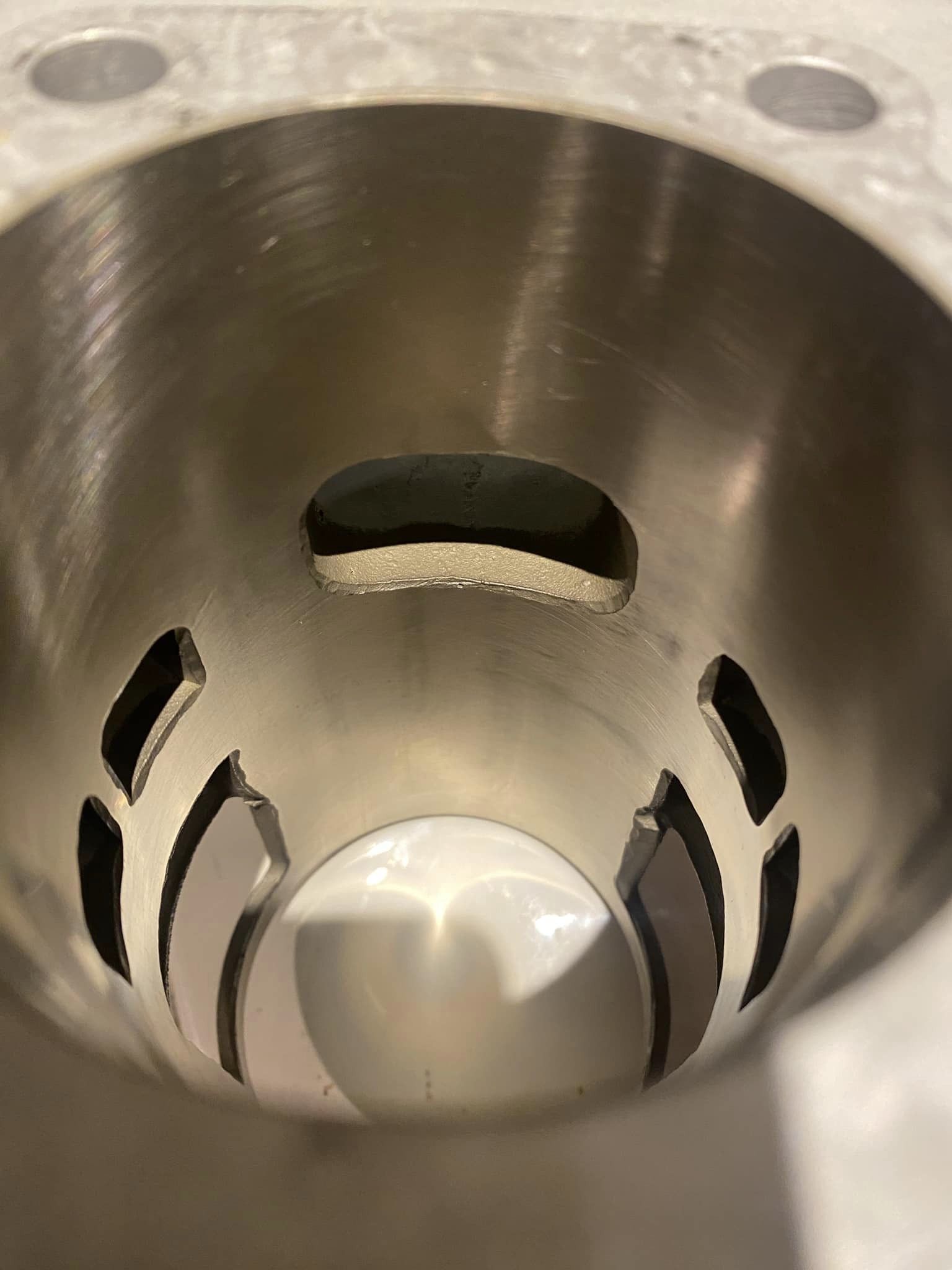

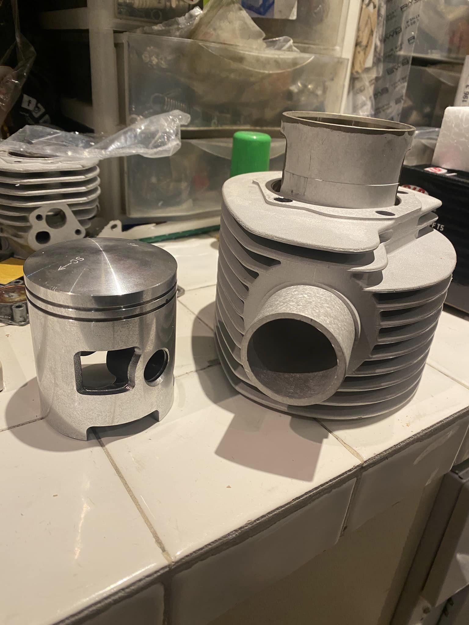

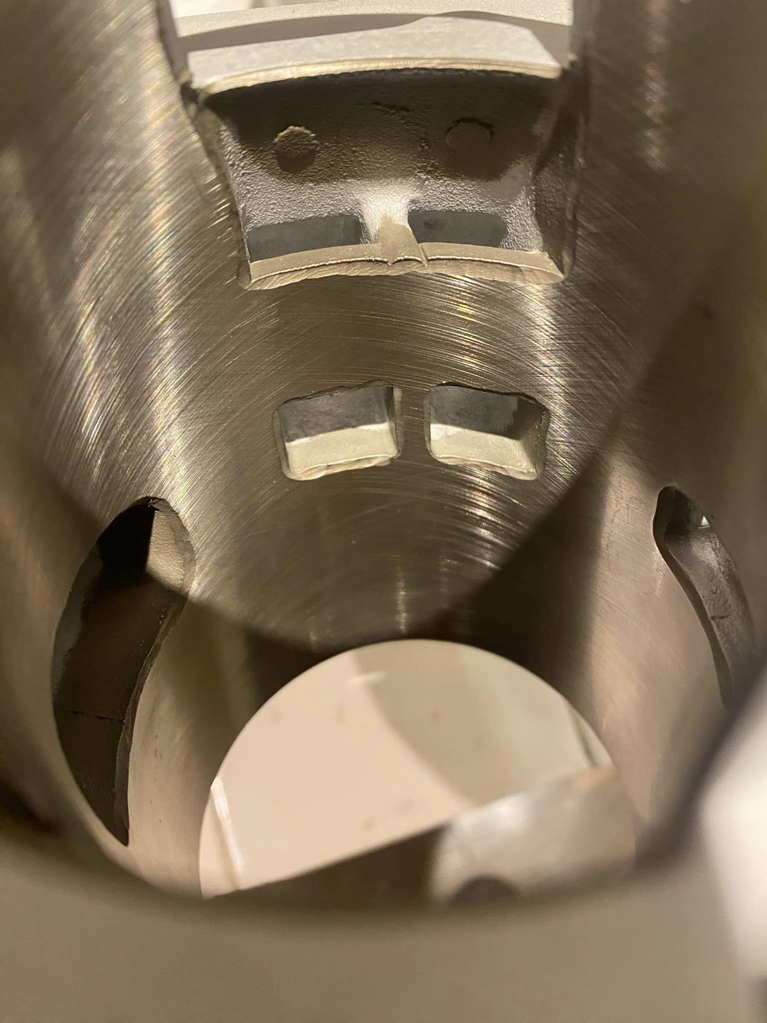

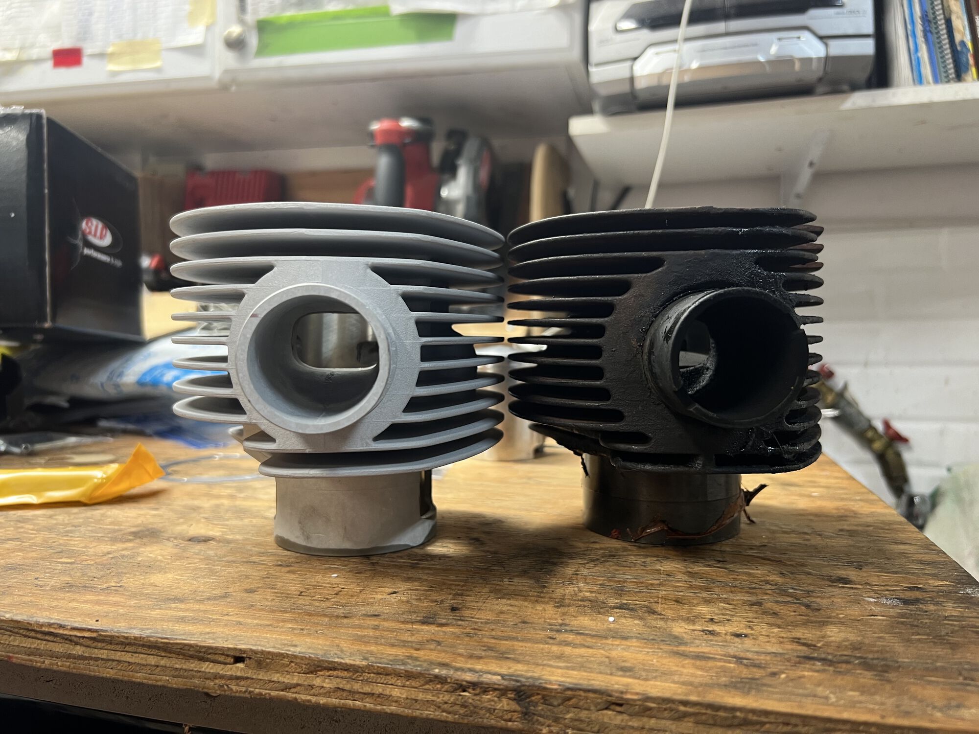

I touched the new SIP aluminum 200 kit in 66.5 mm. Something that seems to come from Asia. It's not very well finished, very poorly chamfered, but the architecture is interesting. It is a 5 transfers, with split main ones, of quite small section. The exhaust is centered in relation to the sides where originally this is not the case. The other side of the coin is the boost which is found in an asymmetrical position in relation to the laterals. We'll see if it works. The boost port opens almost at a right angle into the cylinder. Not great, that. The nikasil seems very thick and very resistant to grinding.
The piston is a near original with cutouts in the skirt to feed the low laterals into the crankcase. You still have to open these casings to fully enjoy them. Grand Sport type segments.
Overall it gives me the impression of being a good basis for working on it fiercely and extracting interesting potential from it. It seems unbreakable, especially at the piston level. We are far from the shitty pistons from Pinasco…
Lateral T:120
Boost port 110
E 168
Not bad….
So that's really ok. Some deburr to do, then bolt it on. With the low numbers the boost port is probably fine. And base transfers won't matter. Nicasil does look very thick.
Next thing is to know how it goes. I expect it will ride just like the iron cylinder but with more go to pull the 35 tooth. With the thin rings it will last forever. Merci.

Nice translation. Mind the transfert wall thickness. You are quickly outside....
My mate ordered Serie Pro kit for his PX200E.
Here how it looks:
In SIP-branded box

fastfrog wrote:
Been a while since I posted last time...
https://www.facebook.com/groups/107236579867807
Pardon for being devil's advocate here:
Could this be an iron or steel sleeve that was either pressed or cast into an aluminum cylinder??
11 cooling fins vs 13 fins of the original cast-iron cylinder. Cooling merits or demerits?? Malossi, Polini, Pinasco all have fewer than 13 fins but those are known Nikasil-plated, aluminum cylinders, which have fantastic heat transfer properties.
Seems the price is quite low, comparatively, to be an aluminum, Nikasil-plated cylinder, in my humble opinion.
Just trying to look at this with eyes wide open...
caveat emptor
photos below from the above FB post
@fastfrog avatar
PX125,200, T5, SS180,TS125 and some more...
Posts: 204
Location: Paris, Taxes!
@fastfrog avatar
Posts: 204
This is just an aluminum barrel nikasil coated. Half the price of a Malossi/Pinasco/etc... Could worth buying it.
PS: Gudgeon pin too big for the piston! Sounds strange but you'll need to find the rightly sized one elsewhere. The one fitted on a stock piston fits perfectly...

More photos to come
@mjrally avatar
Posts: 5353
@mjrally avatar
Posts: 5353
Matches the FB photos. Anyone have any questions?
Looking from the top
Bottom
Bottom
Thinner ring up top
Thinner ring up top
All ports chamfered
All ports chamfered
