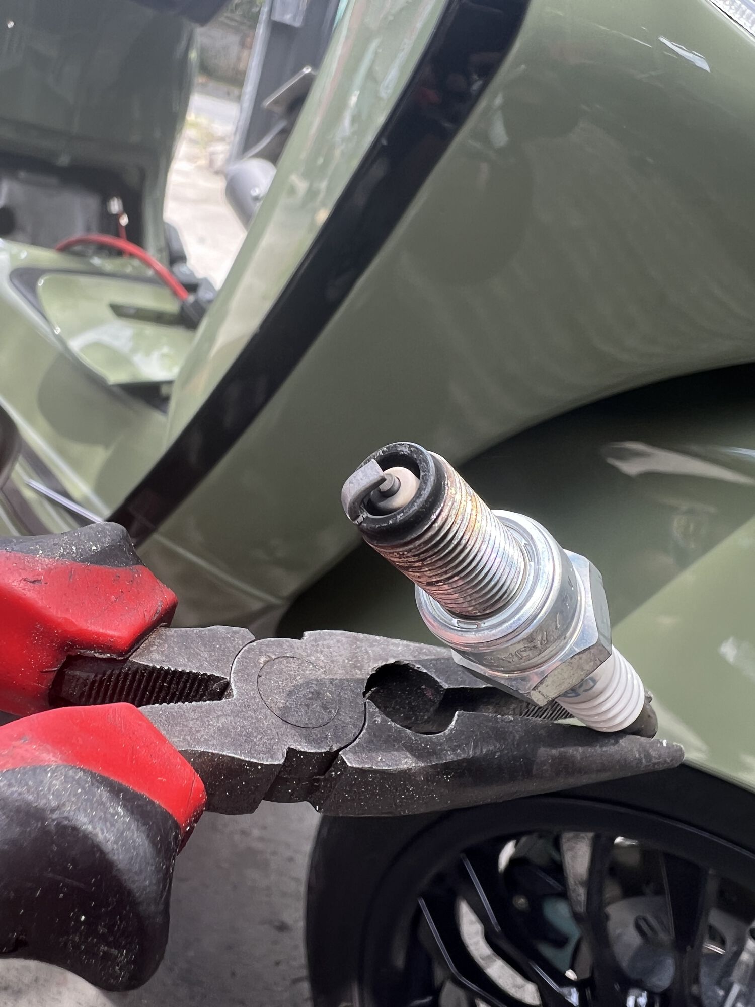

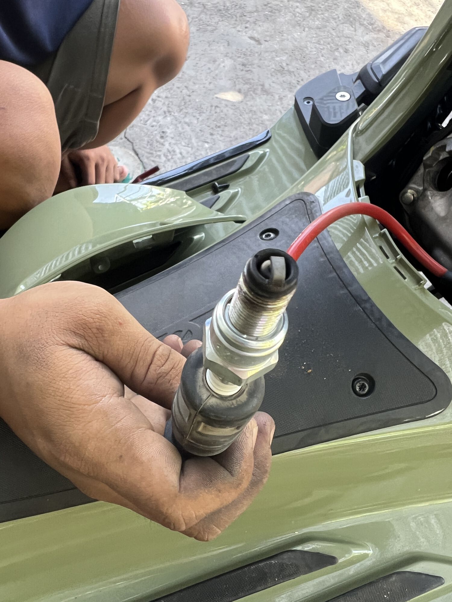

There you go:

I don't love the look of that plug, but it's not too awful. how's it look further on the insulator? which plug is that? it's obviously not a projected tip.

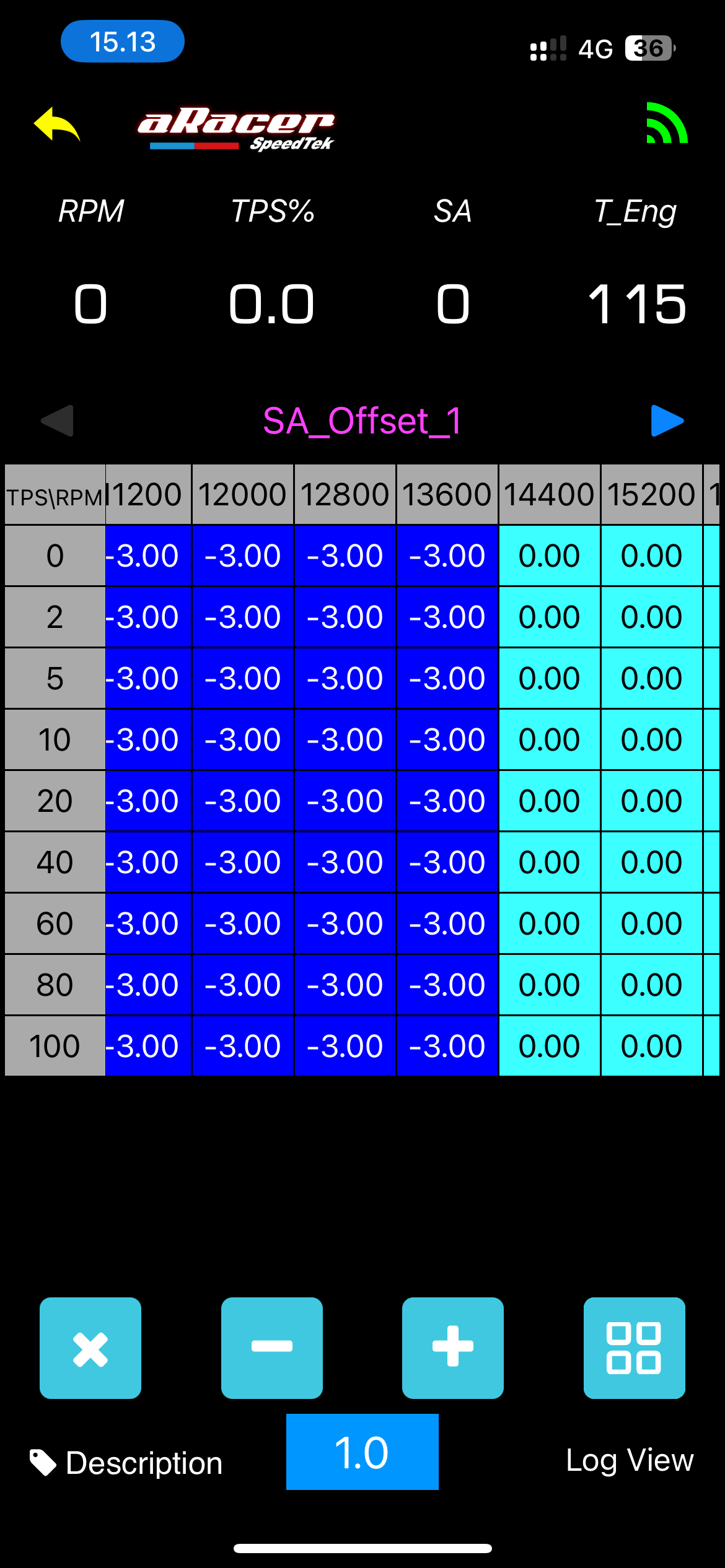

Due to the engine running hot yesterday, he advised me to set the engine timing to -3 in the Aracer settings, which should make the engine less hot; that might be the reason.

retarding the timing generally results in a hotter running engine.
partially from hotter exhaust temperatures and partially from needing additional fuel to maintain the same power level.

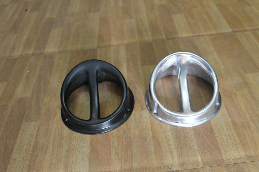

I'll give the air scoop a go and update everyone on the temperature difference afterward.

From the looks of that plug, you're probably in the 14.7-15.5 to one ratio range, or even higher.
You need to figure out what the air fuel ratio is when you are riding, and adjust the box so it's in the high twelves, low 13s to one ratio. Malossi and a lot of other companies, make devices that give you real time information about the air fuel ratio. This will cool the engine down.

For now, I switched the spark ignition back to 0 from -3, and looked at the spark plug again this morning.
The engine is still running quite warm (around 110 Celsius); I ordered an Airscoop, which I will install later this week.

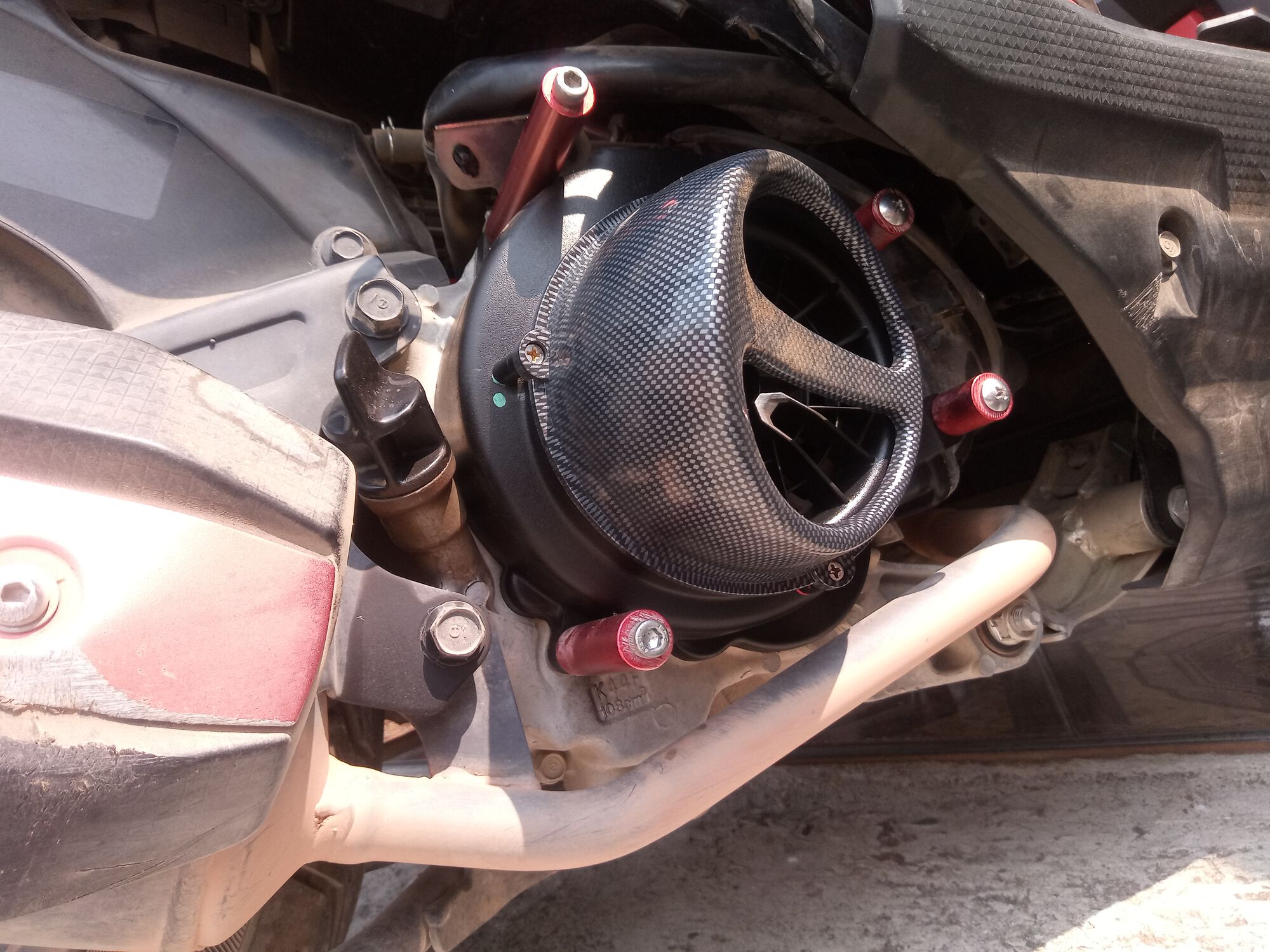

A GY6 scoop. I stuck one on my Honda.
I don't notice any significant difference by the "seat of the pants' method. I also installed an oil cooler.
