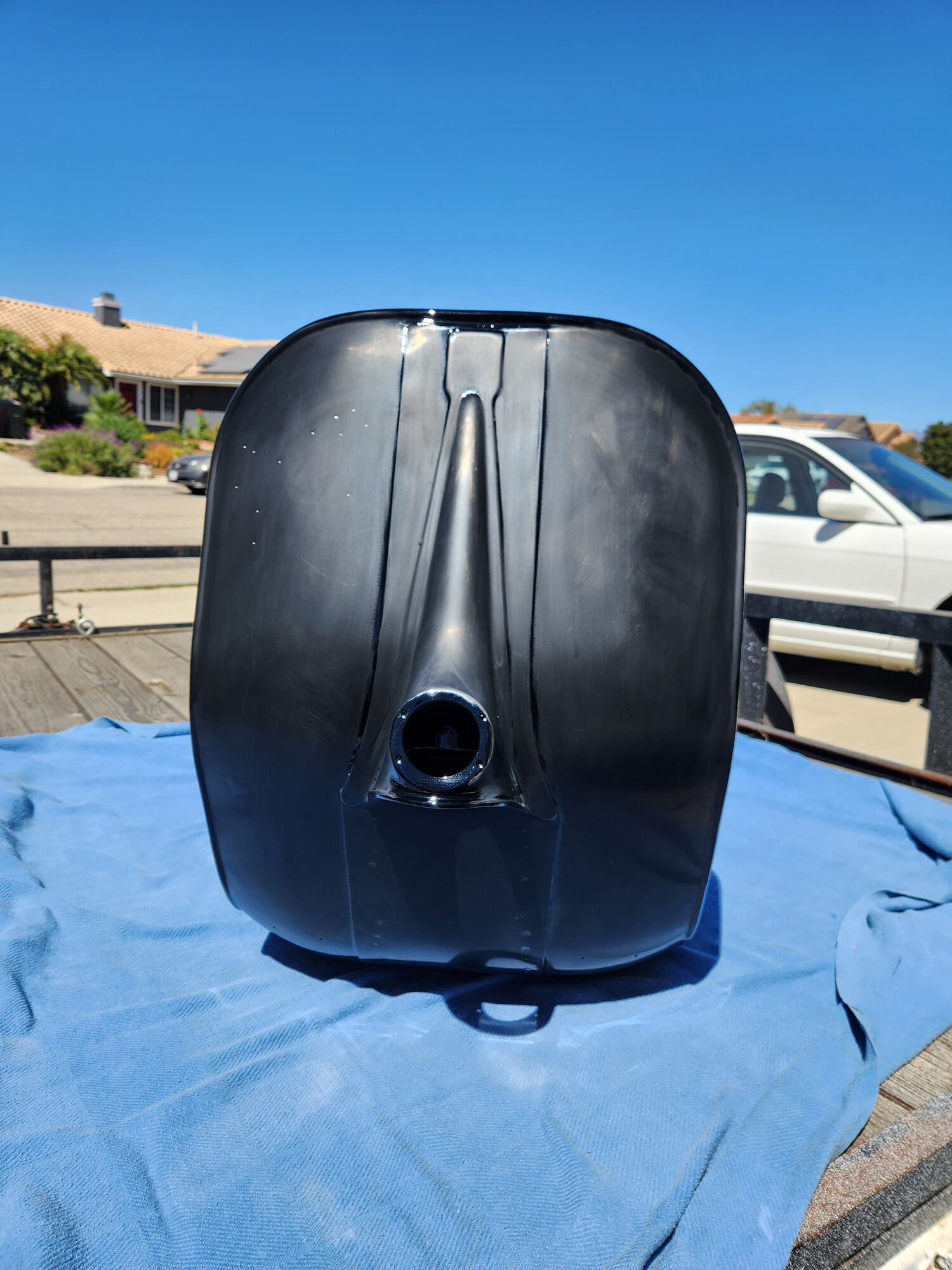

Birdsnest wrote:
Is that single stage?
If so, I am even more impressed.

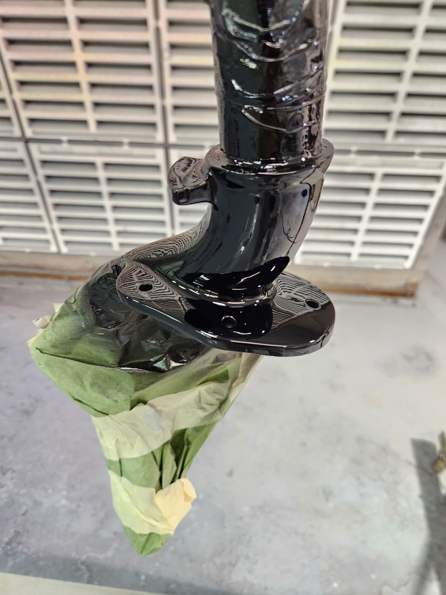

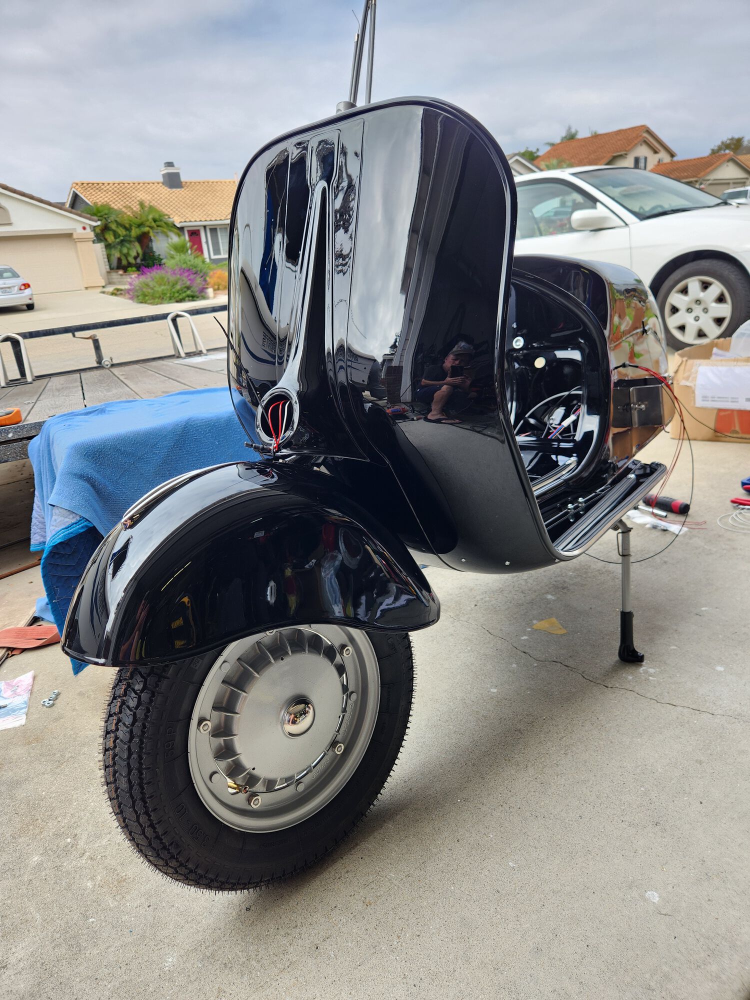

I did spray the rear wheelwell with single. It was pretty hot in the booth today. On the inside of the legshield and tunnel, the overspray drys really fast and leaves some funky spots. I'll need to sand and buff to come close to your SS paint job.
To be fair… Victor is a professional painter.
That is why my SS looks so solid. You sir are doing professional work. Excited to see the GS come together.

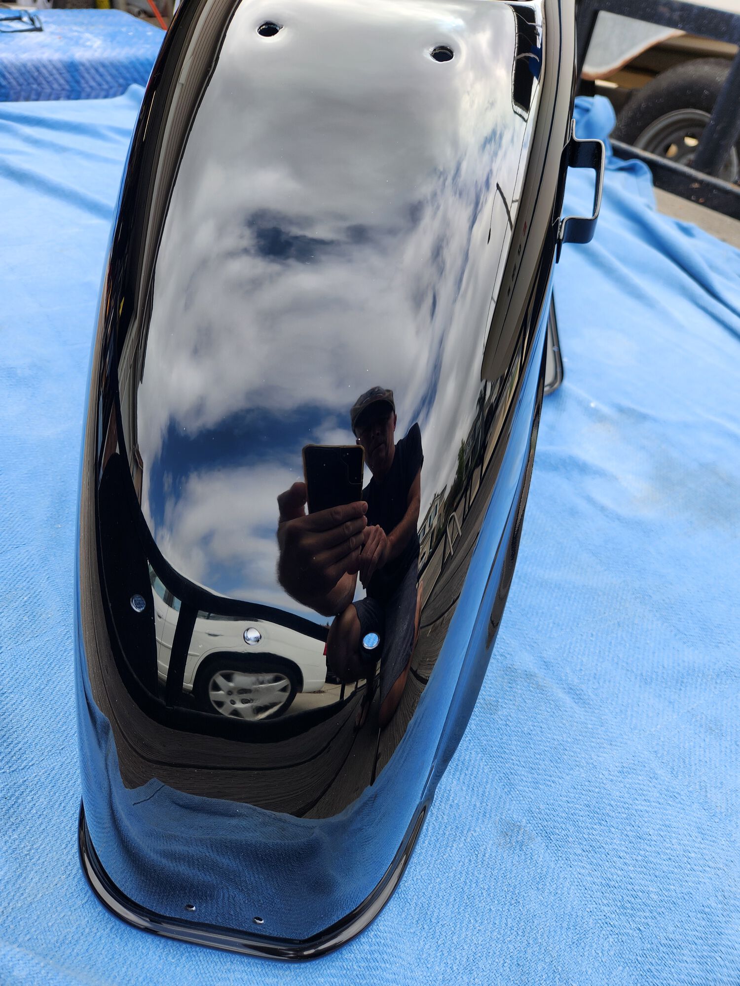

Holy guacamole Batman, that's some shiny beautiful black right there! Razz emoticon

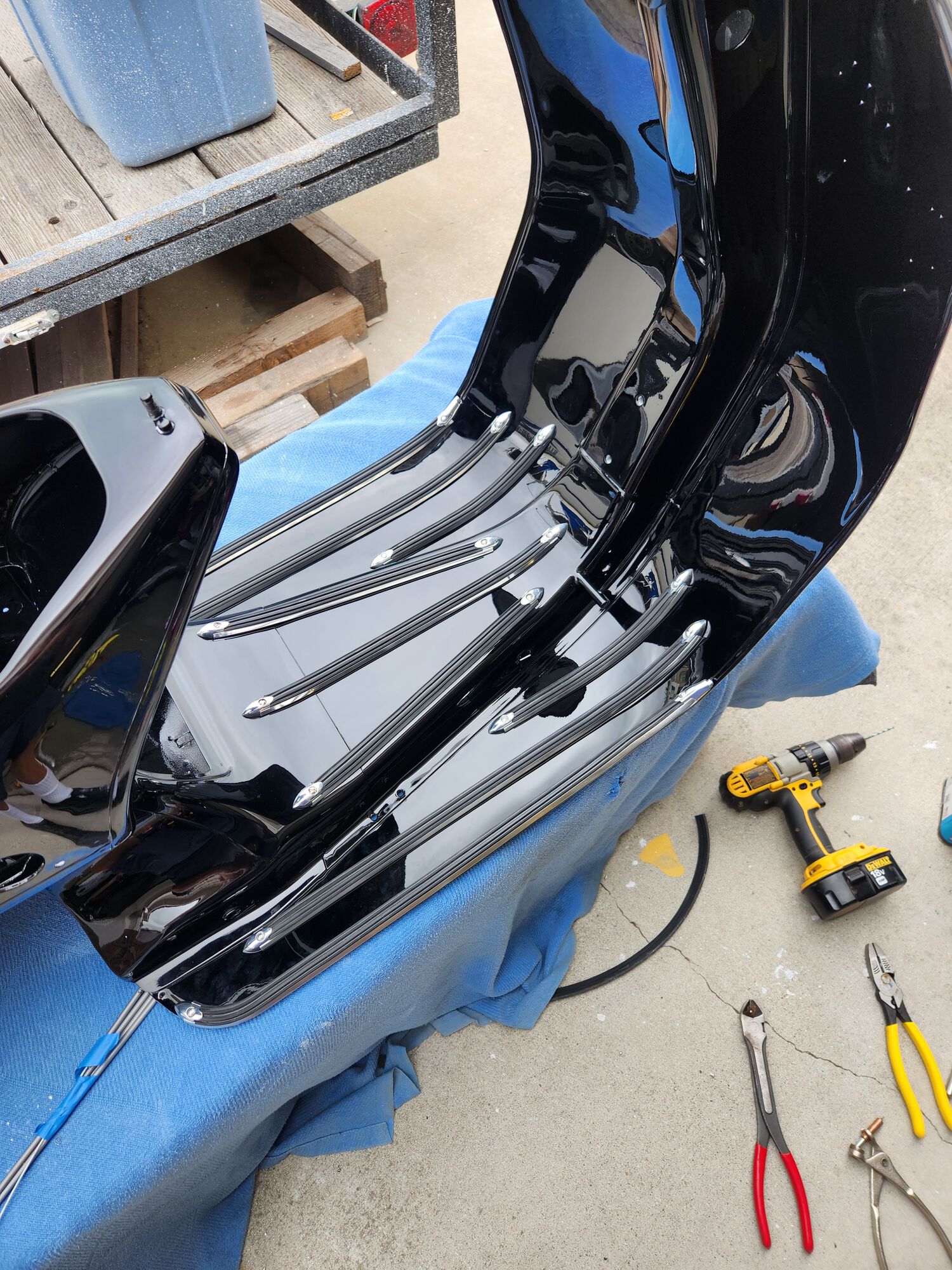

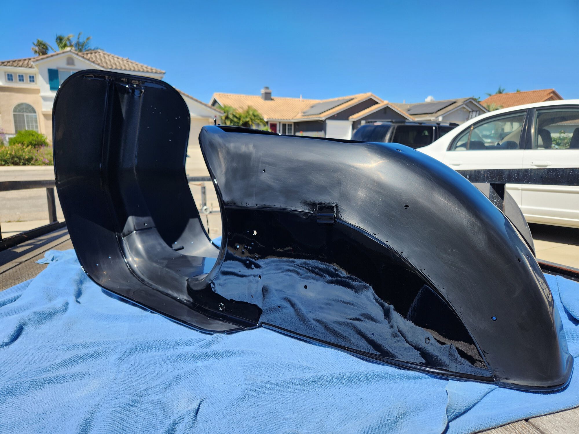

BajaRob wrote:
Started shooting clear and the gun got stuck against the rack and caused a couple runs on the front of the legshield.
lol…this sort of thing has happened to me a few different times when i was painting cars. VERY frustrating indeed! You did lay down some smoove paint. It looks very nice!

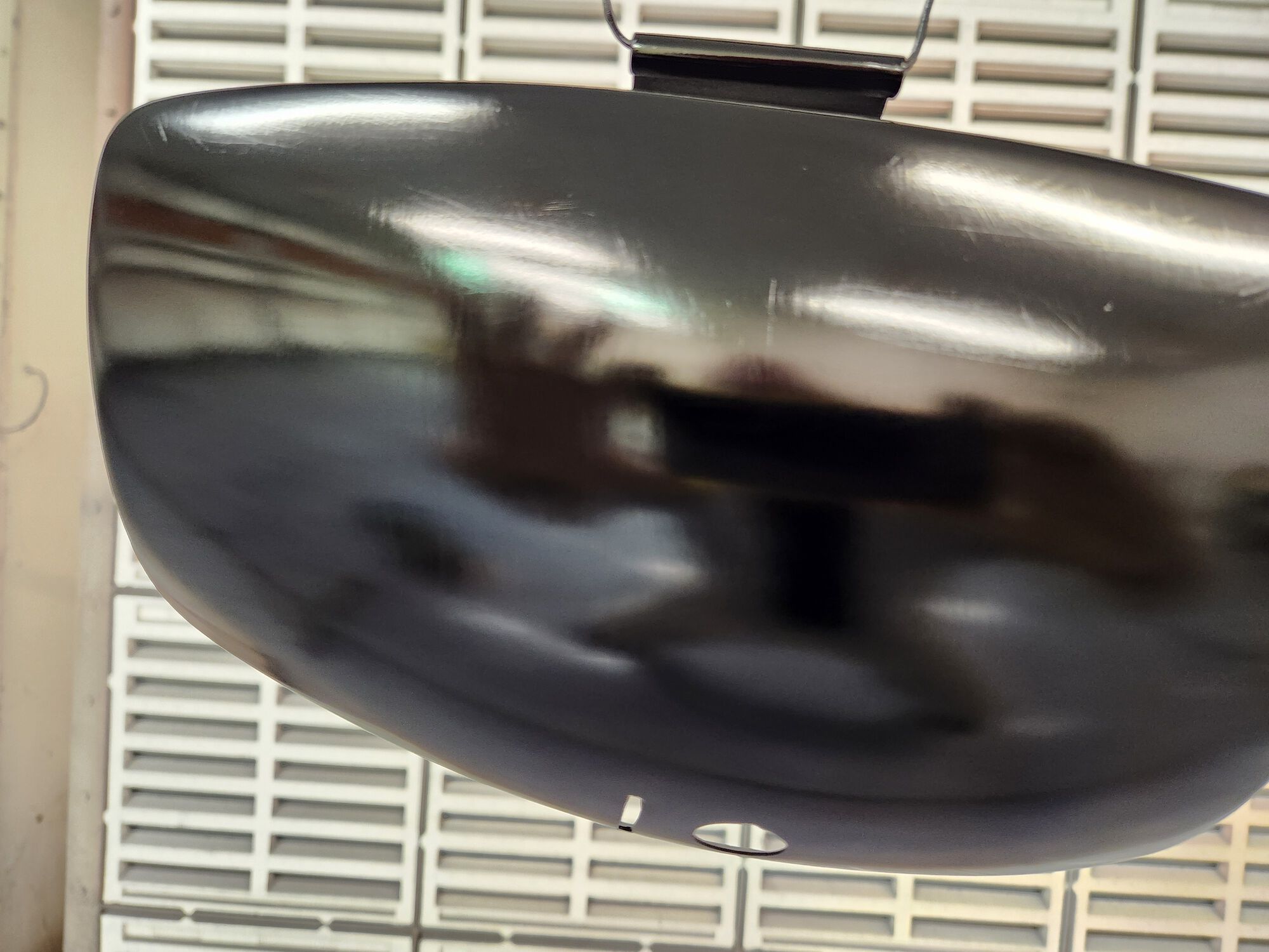

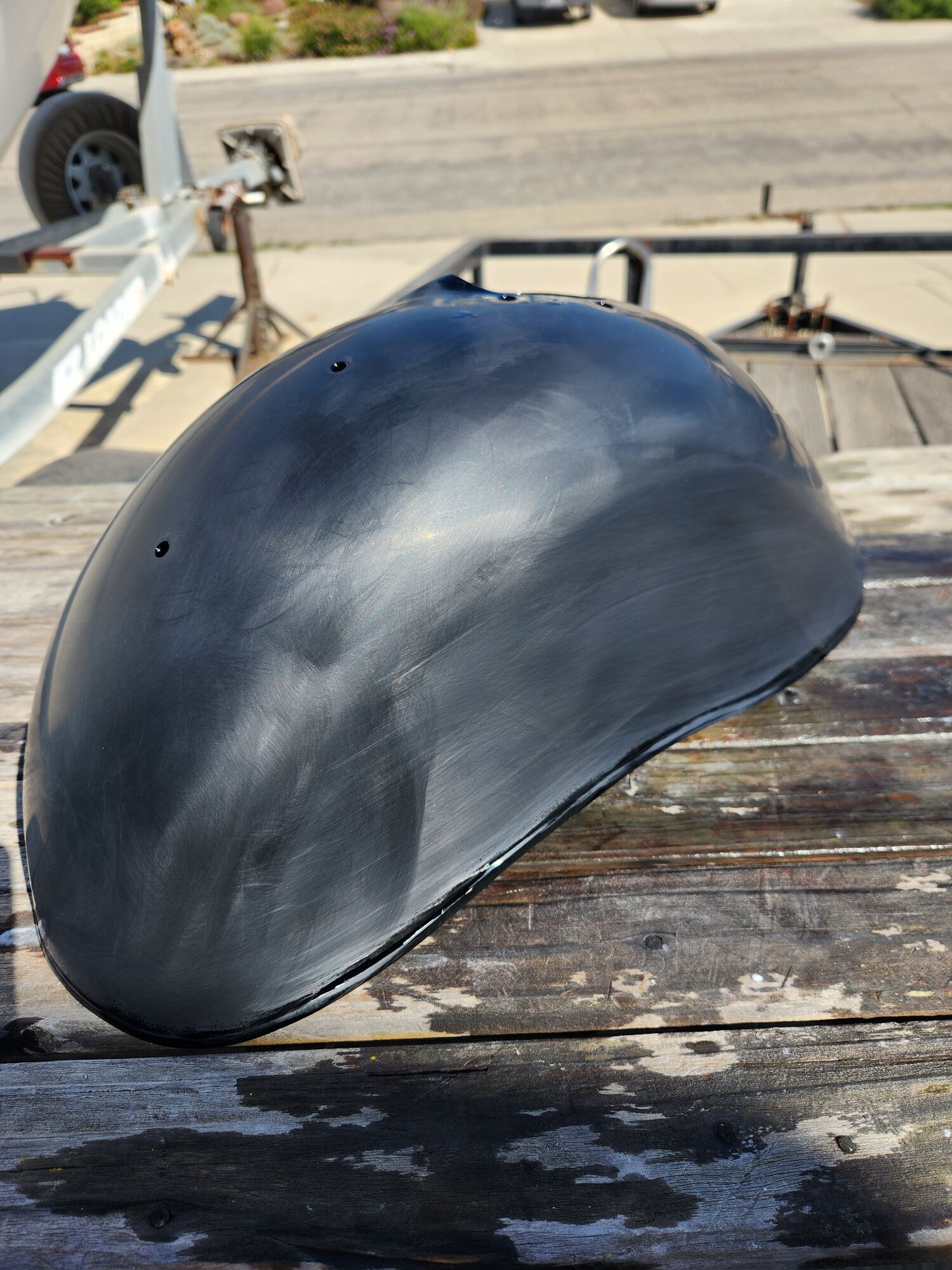

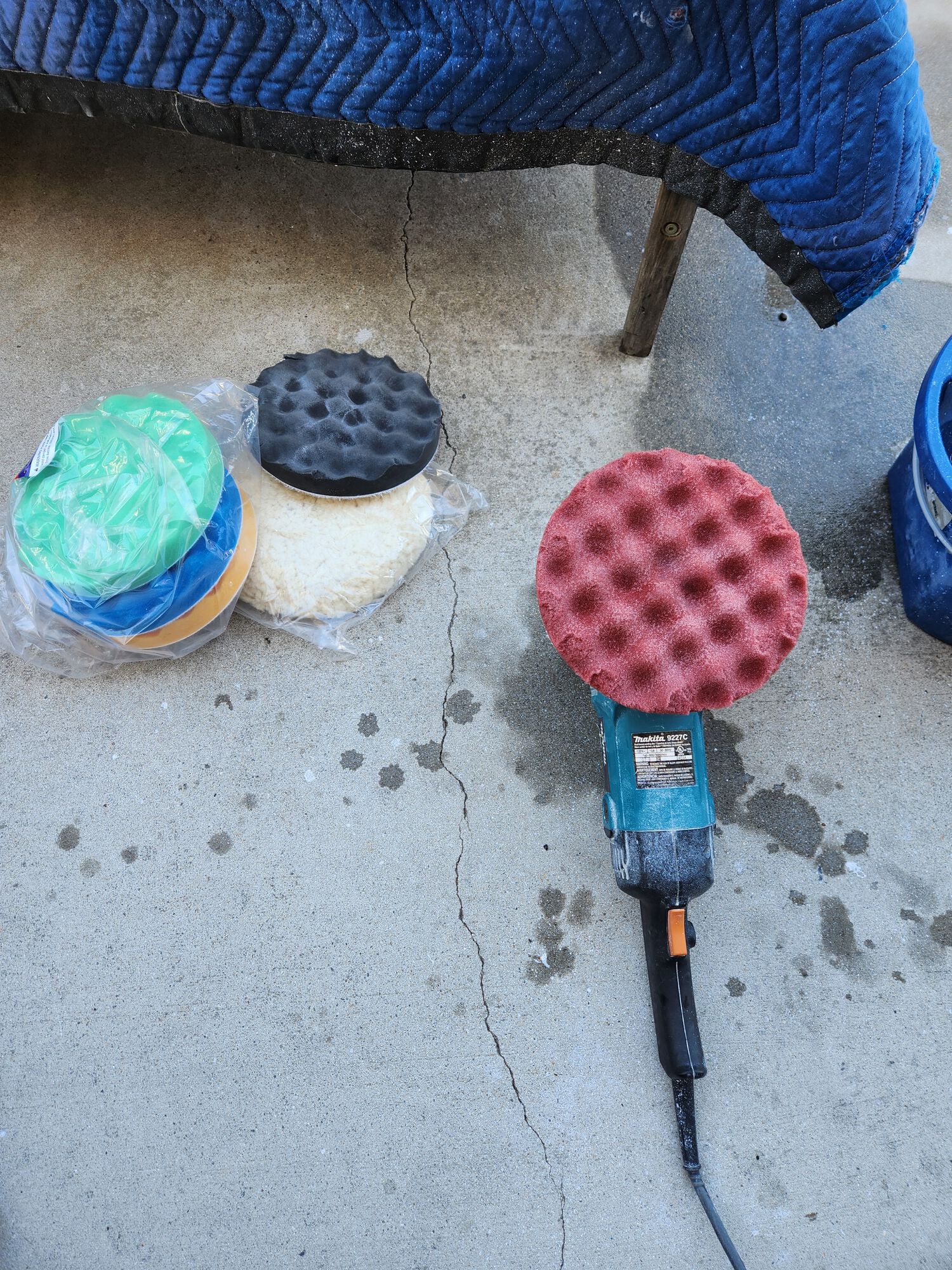

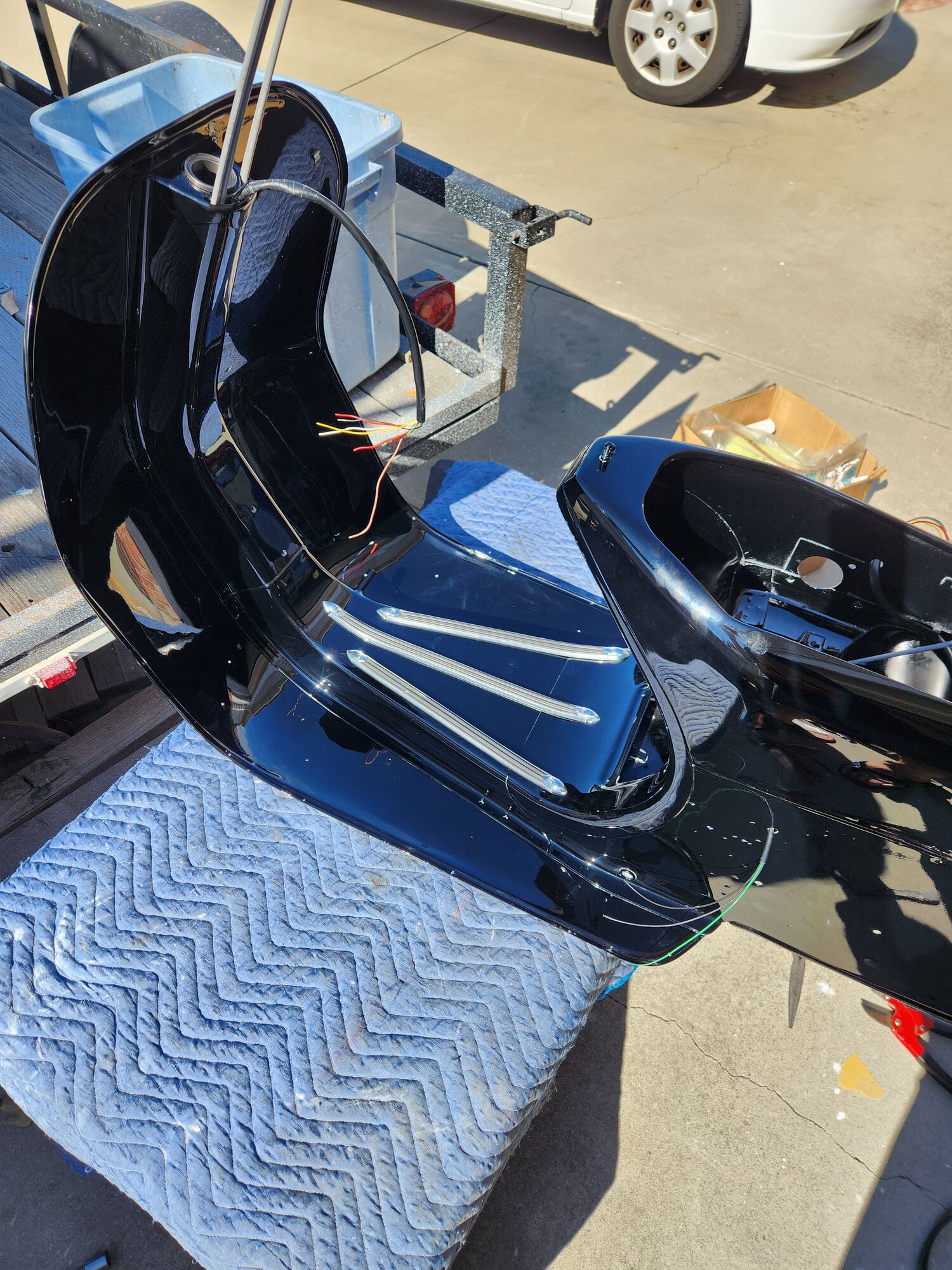

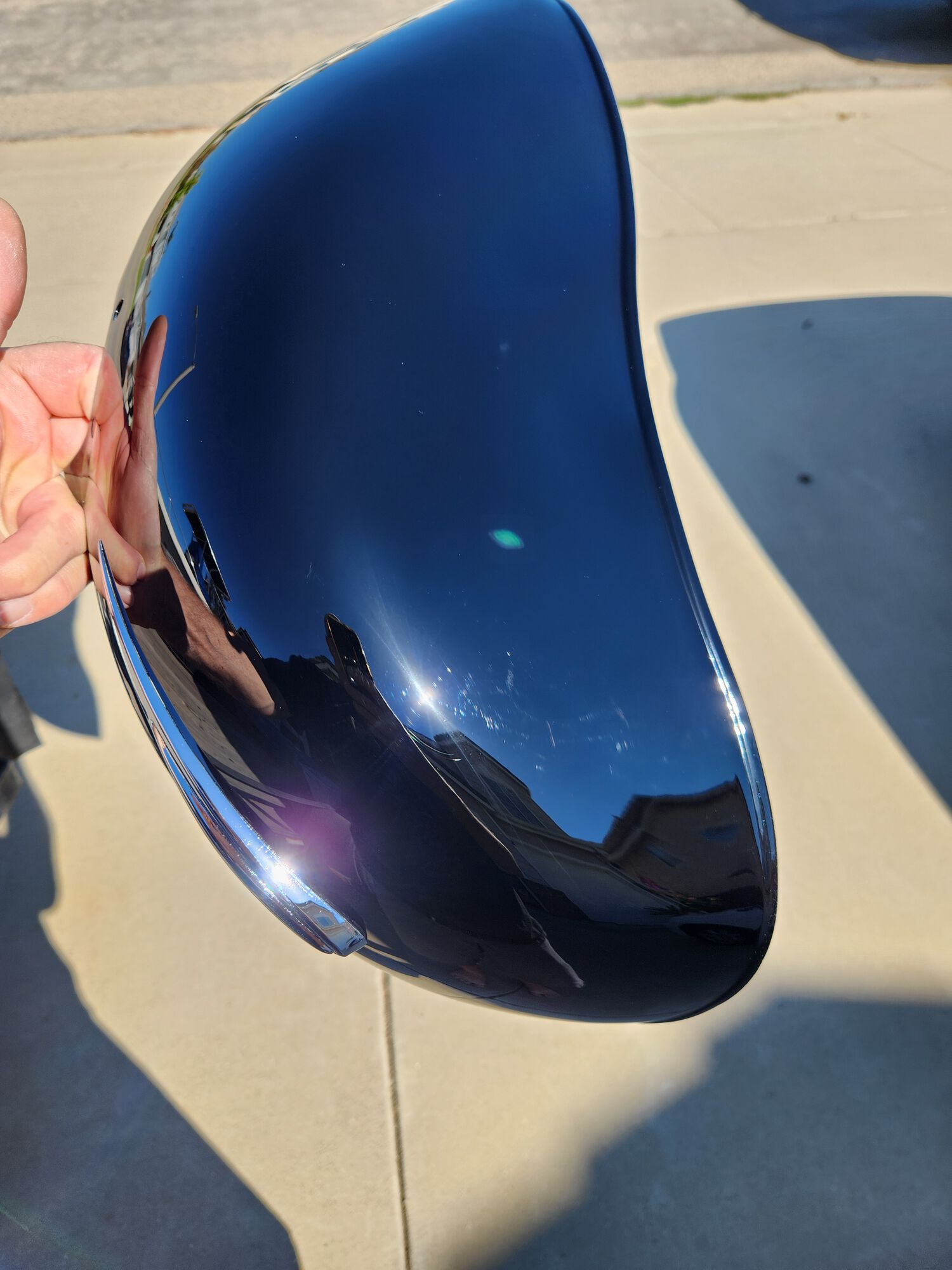

I had to update my technique for this black paint after seeing some sand scratches in the shade. Here are the compounds in order with corresponding pads after wet sanding using 2500. This wax I tried from Turtle Wax is really good stuff.

Rob, did you use the air polisher to achieve this ?! Is it rotary or dual ?
@bajarob avatar
Posts: 2212
Location: Ventura, CA
@bajarob avatar
Posts: 2212
Yes, that's my 3 inch rotary air buffer. The pads are four inch hook and loop style. My big electric buffer is rotary as well. It does a better job but without having the mudguard secured to something, it would fling it across my driveway. 🤣 Seems to be lots of inexpensive air buffers on the market these days.

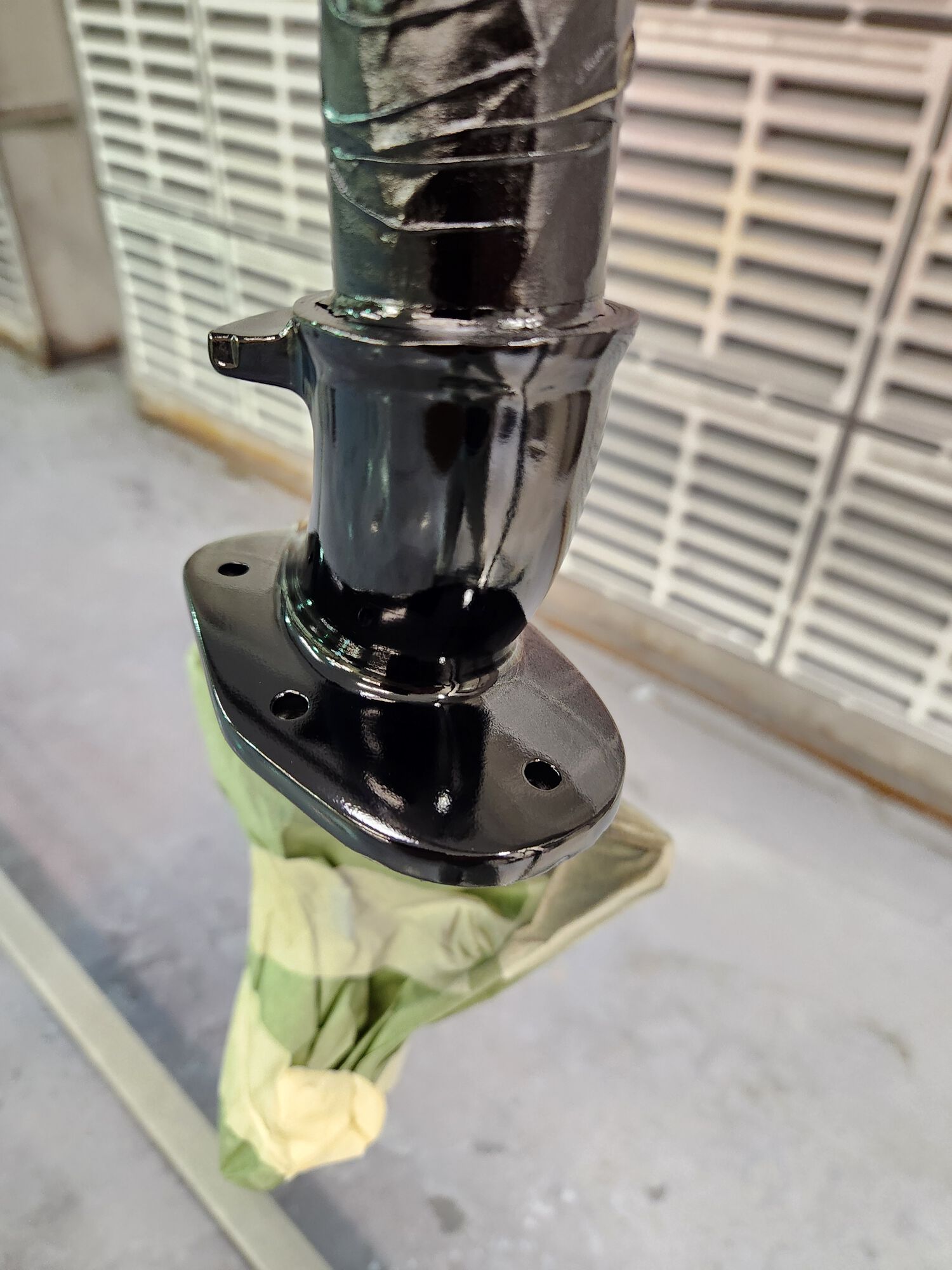

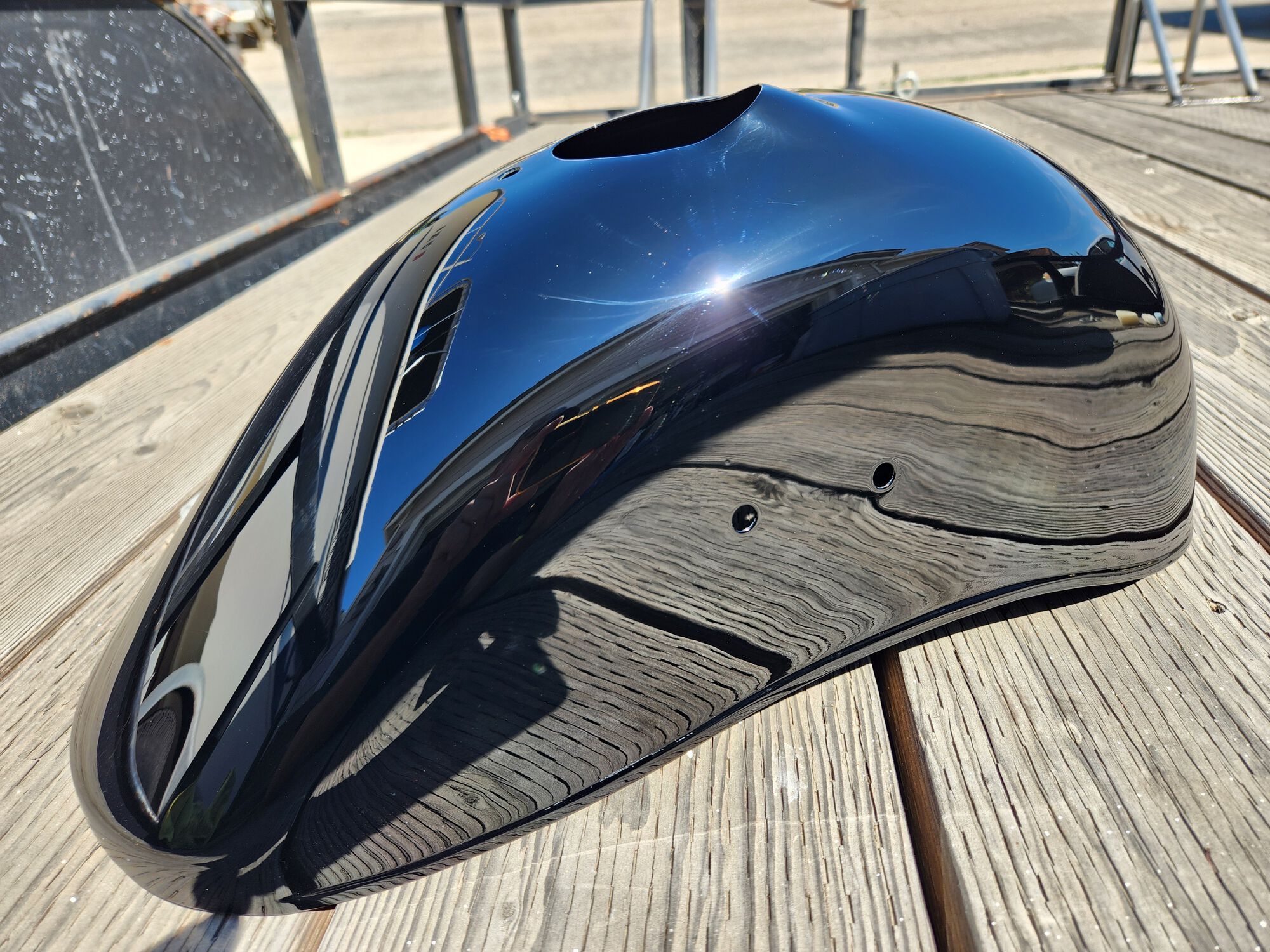

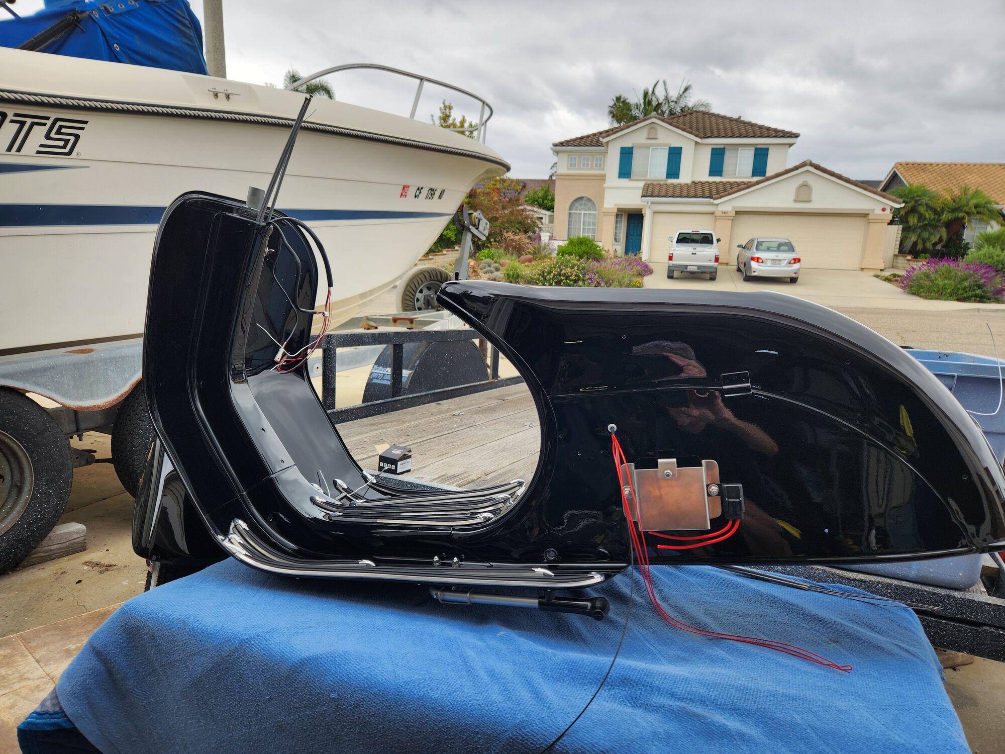

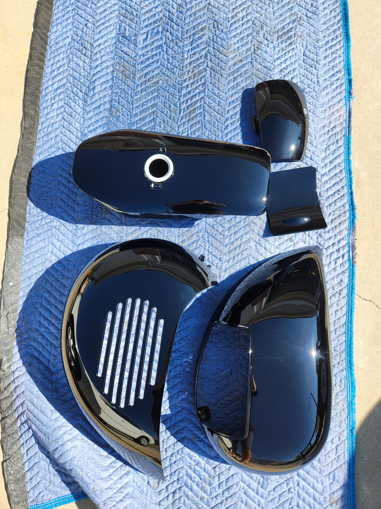

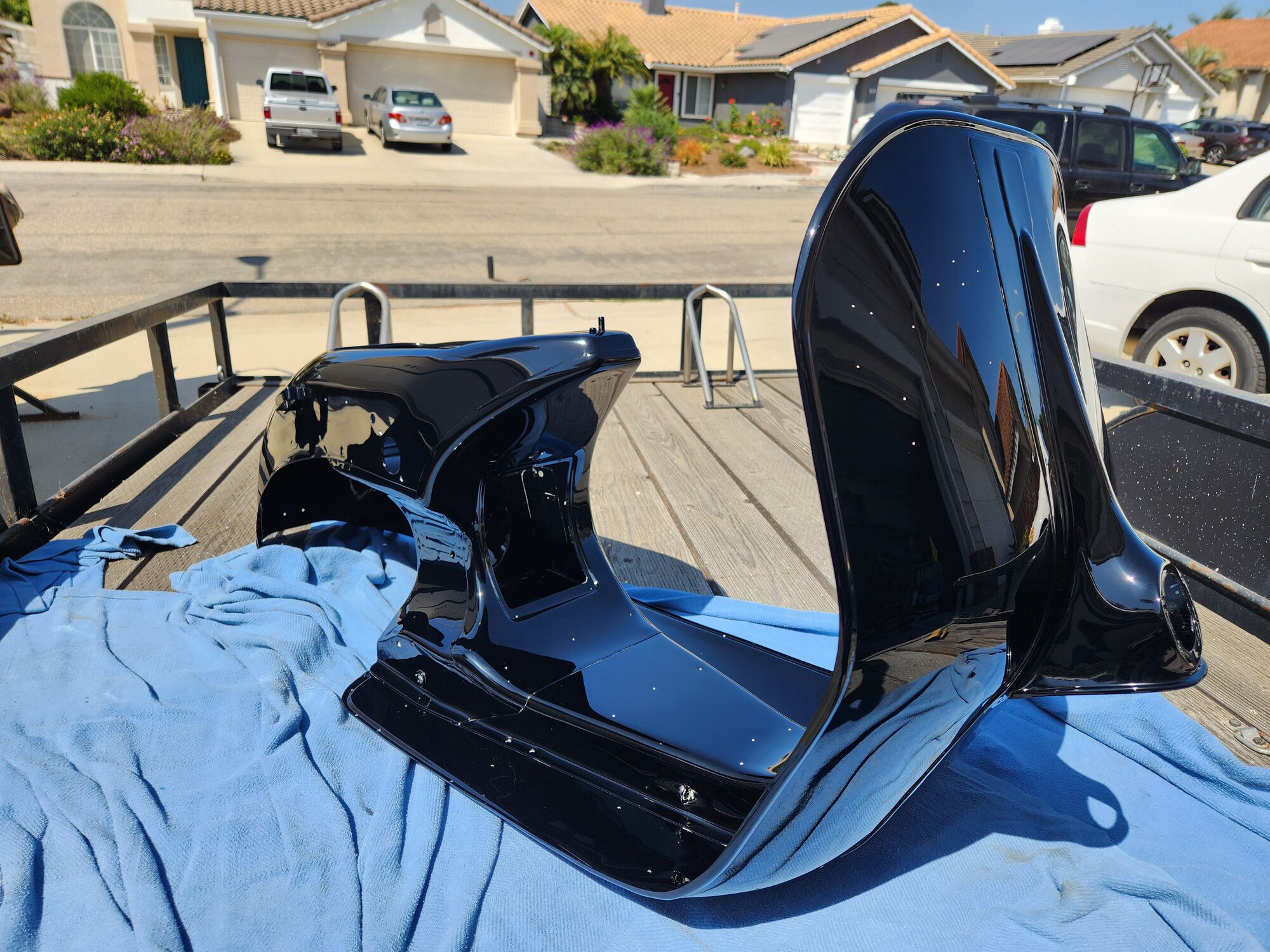

One more piece finished.

I need a lesson on how to polish paint.

Me three! It's a work of art!

Black Chrome

Hot damn man

Nicer than it came from the factory, for sure

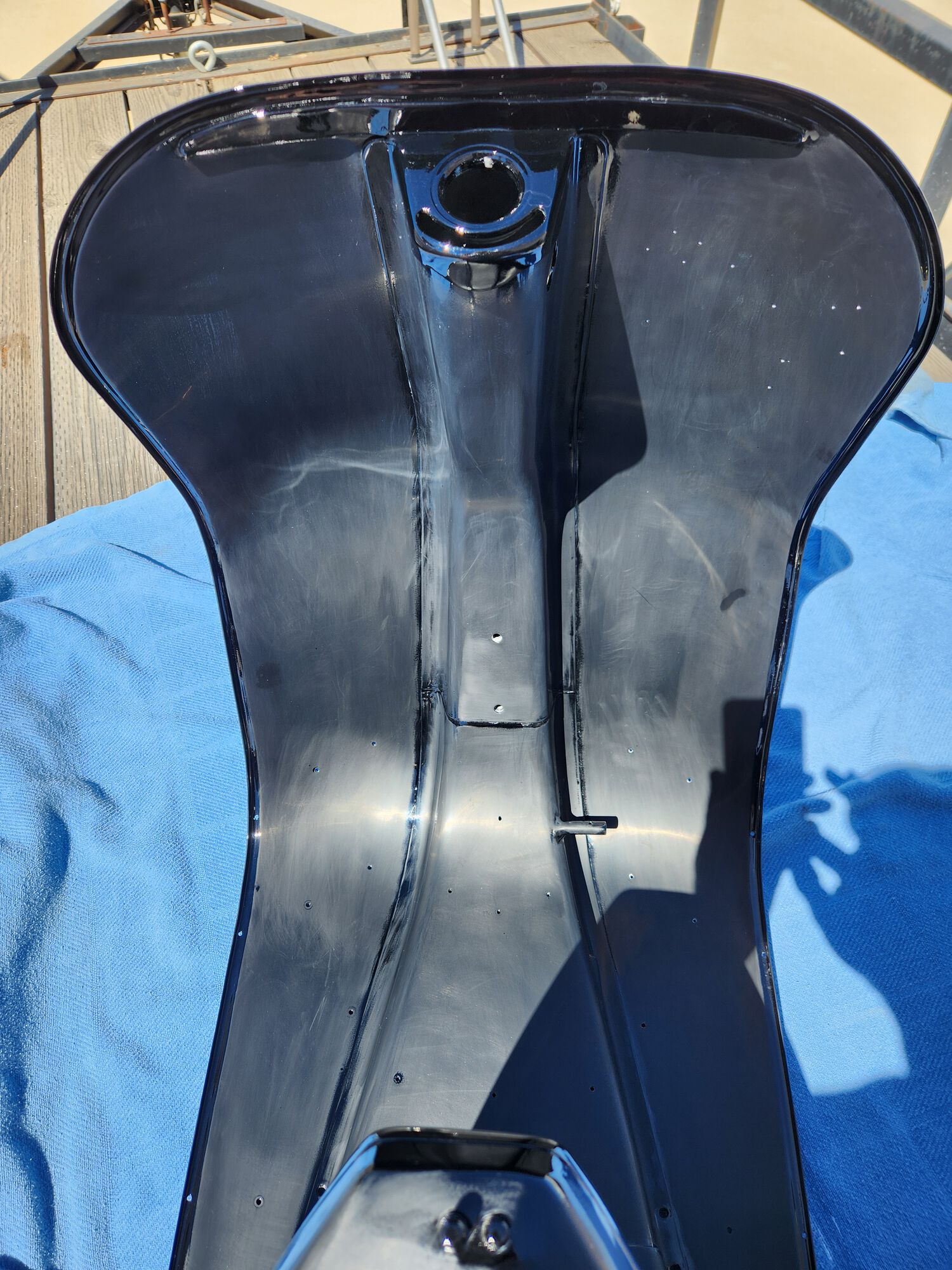

Hopefully the next pics will be all glossy and this frame will be ready for assembly.

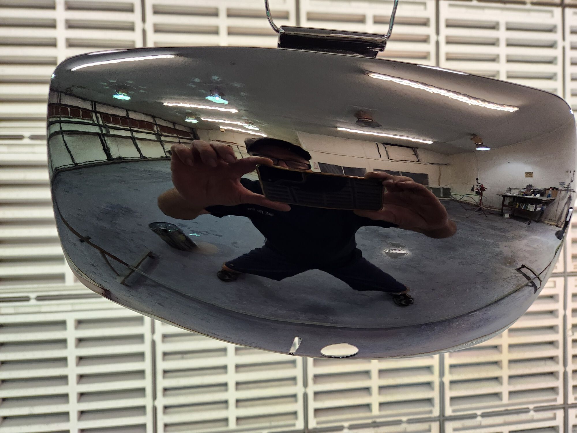

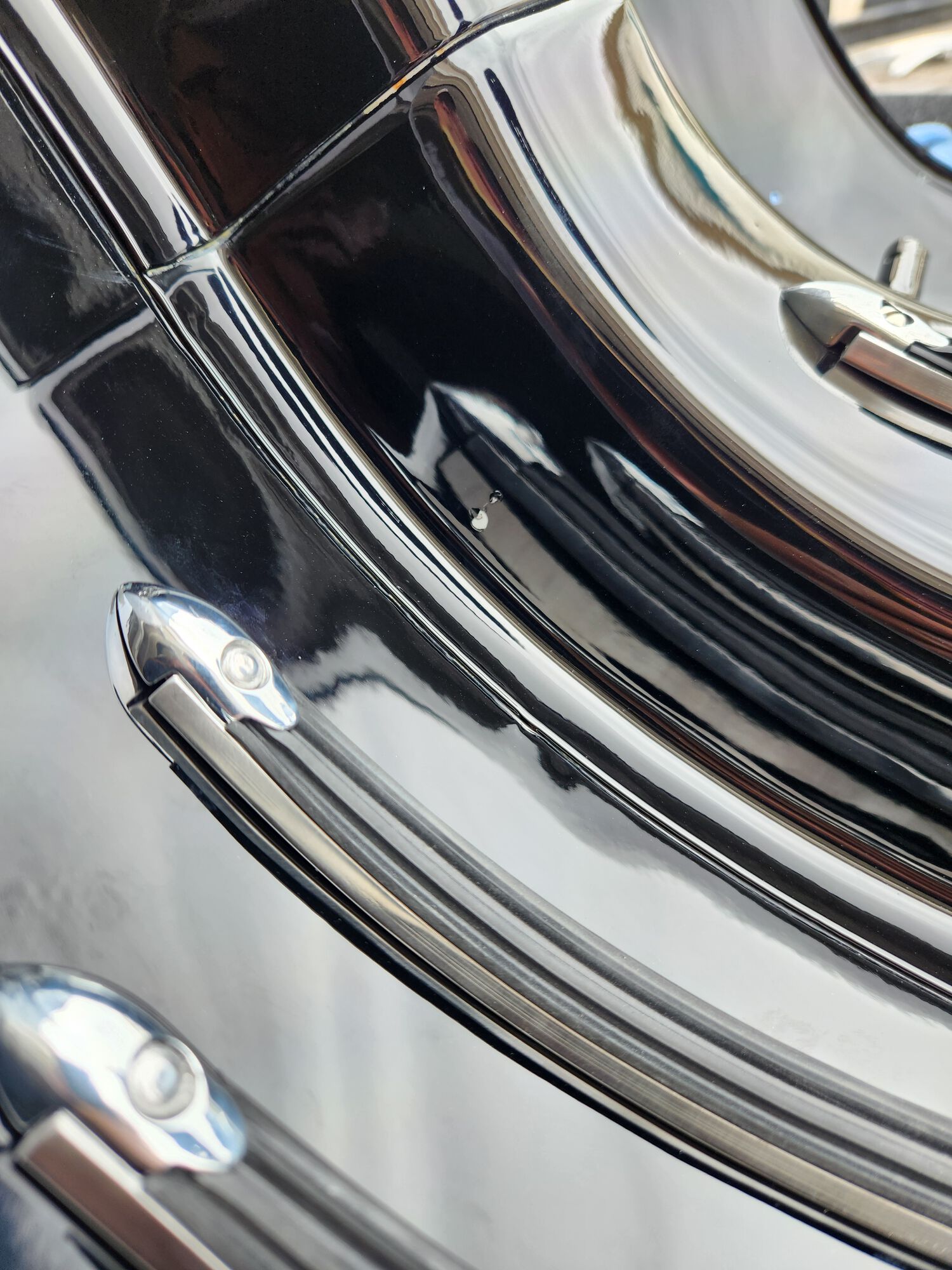

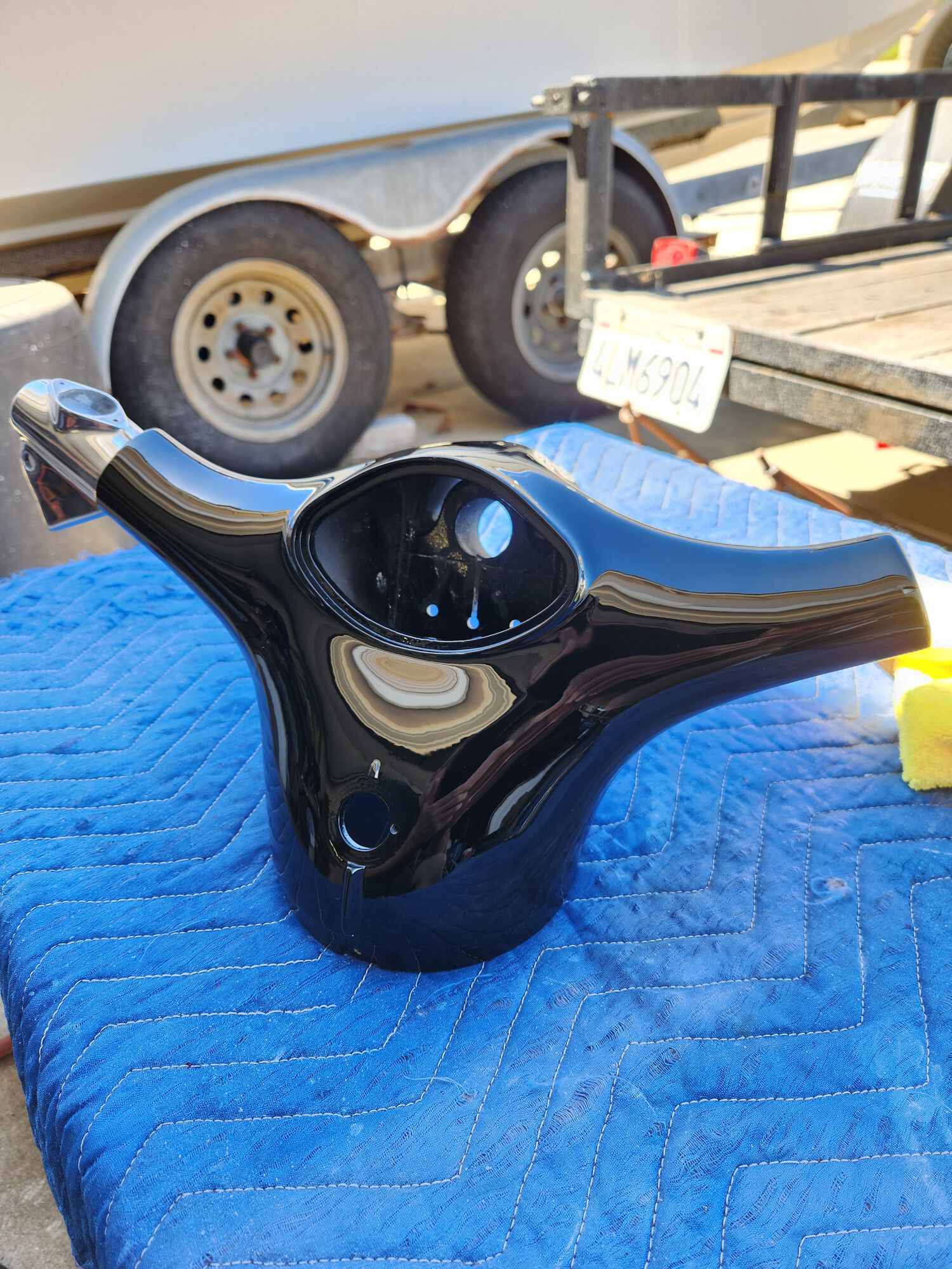

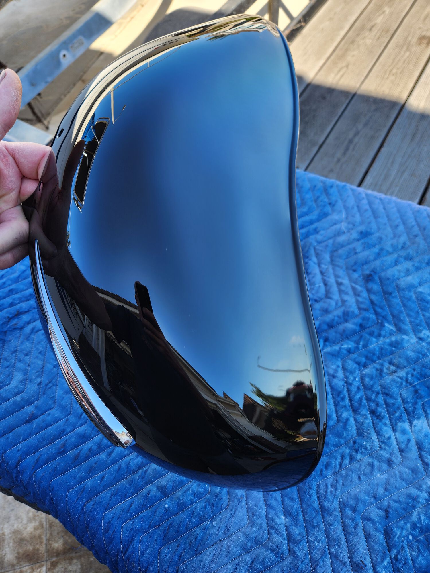

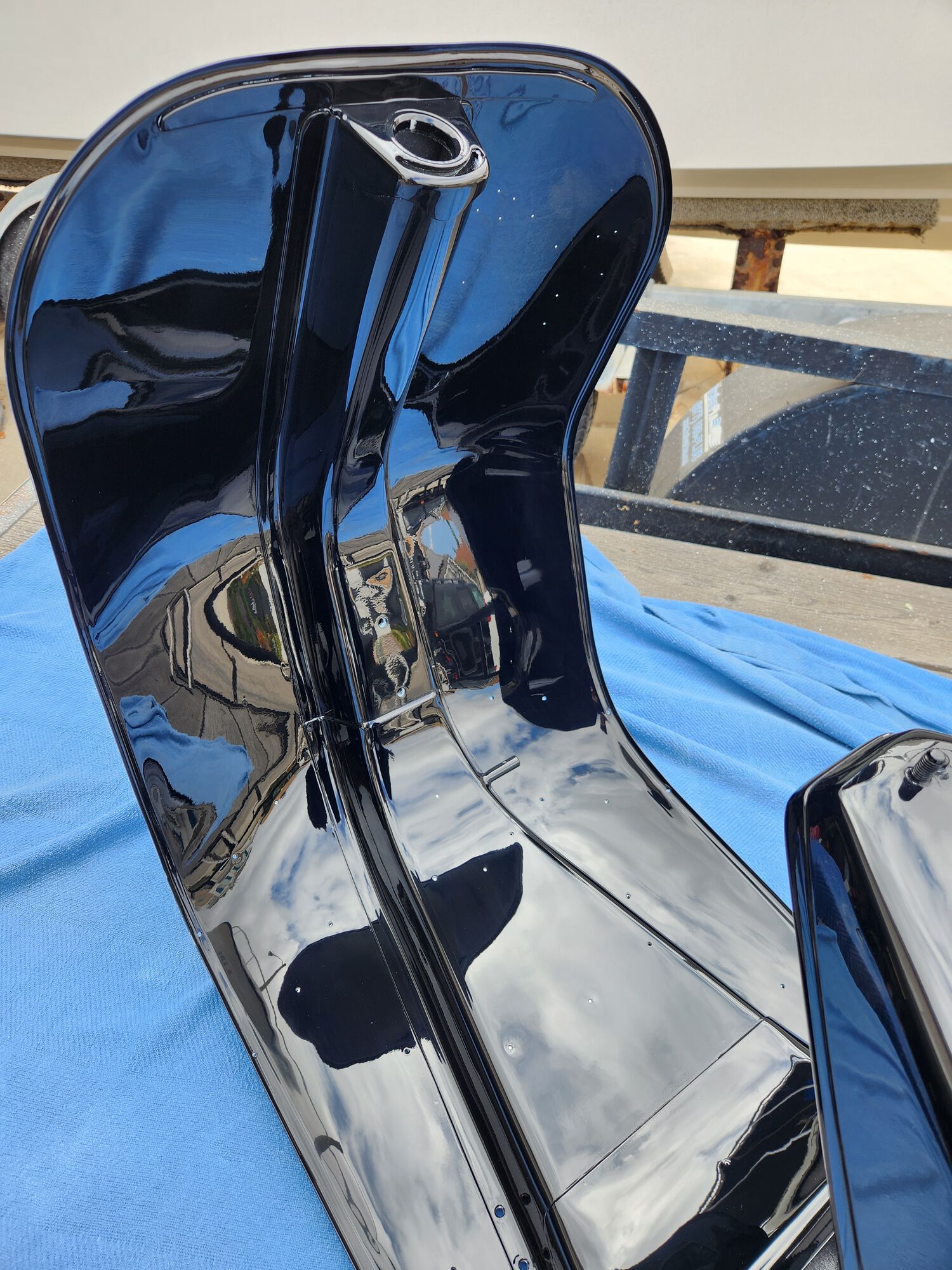

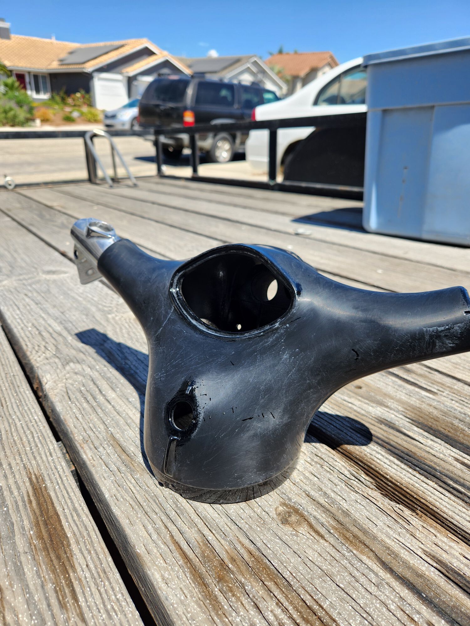

Here's a teaser. This is the first stage of polishing. Looking to get the swirl marks out tomorrow. I'm still not satisfied with the repair to the runs on the horncast so I'm thinking of spending more time on those.

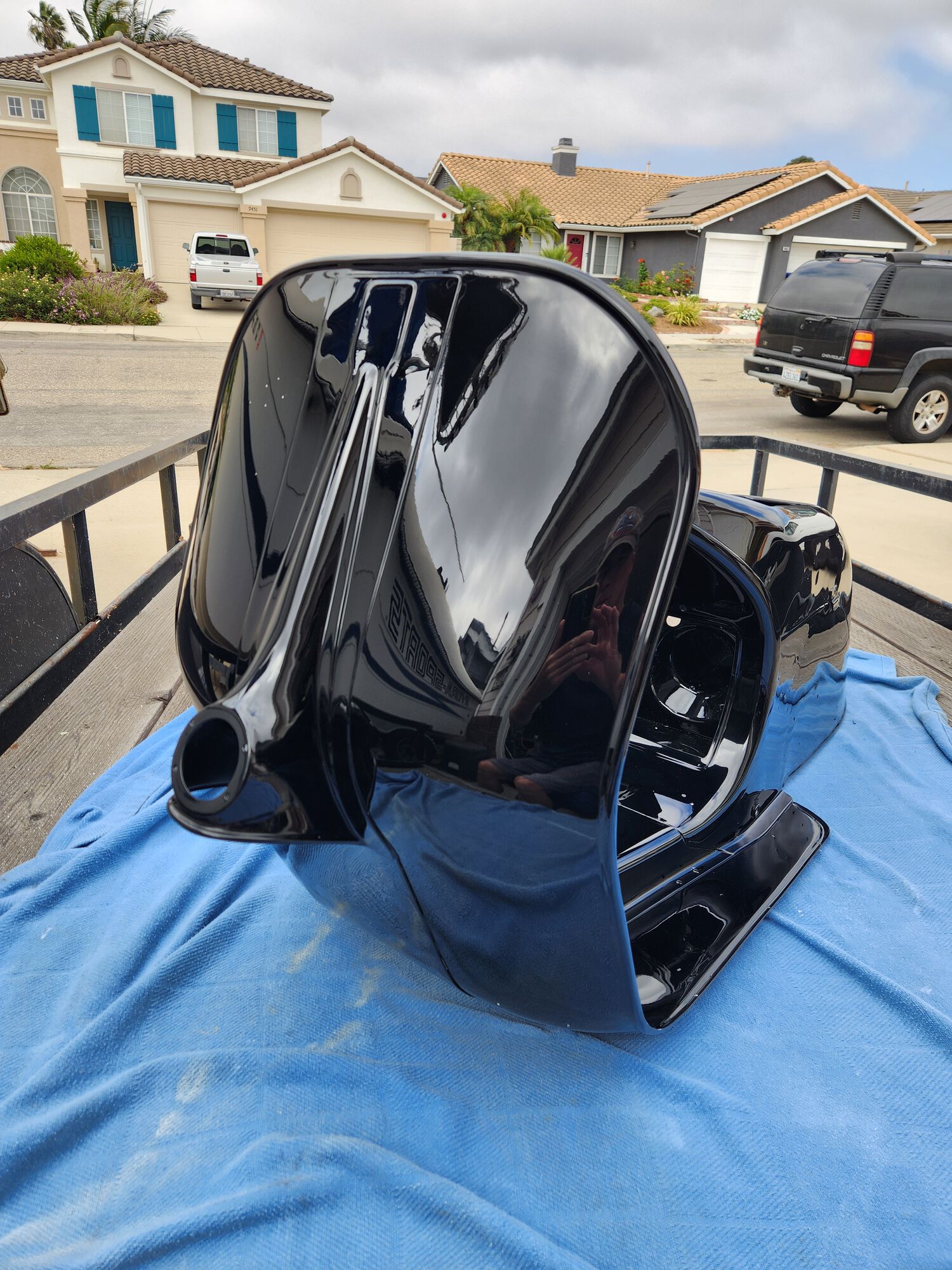

So far, I'm sticking with the original tube style with BGM tires Ray8 recommended. I'm planning on riding this sucker around Oregon, Ventura to Phoenix and a short dip into Baja. Still waiting on my SIP cylinder. I'll run stock until then.
