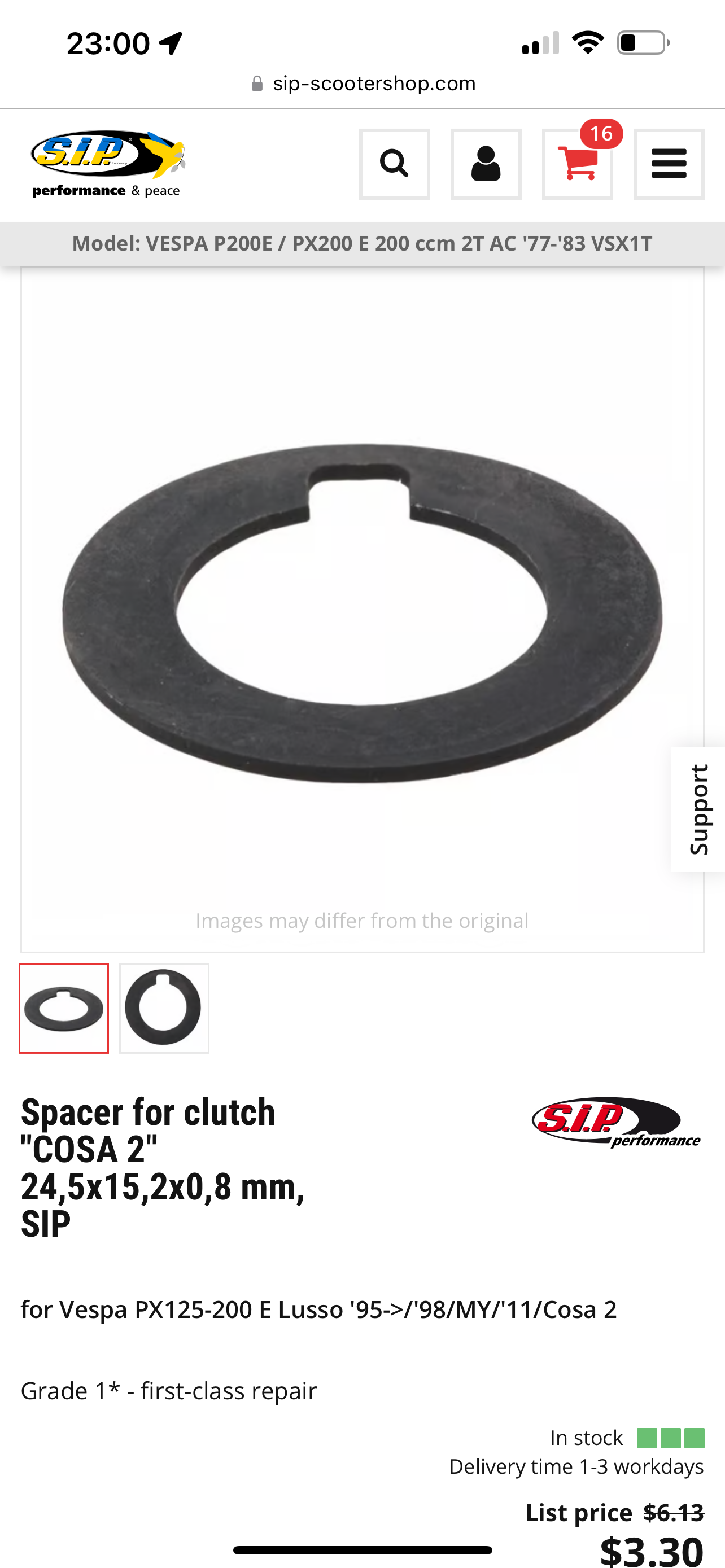

They talk about buying extra spacers for the crank. I know there's spacers if you remove the autolube but what about in addition? I'd like to keep the autolube but want to refresh the clutch on my P200. I read the original Piaggio Cosa clutches fit perfectly, but the reproductions had issues and need the spacers? Is that still the case with SIPs?

the idea with that added spacer is to allow a millimeter of difference between the baseplate and the clutch cog. If they are the same height, it causes problems. Rather this clutch needs it or not, you wouldn't know until you received the clutch and looked the drive gear area.

So you're saying if the clutch cog and the crank spacer are the same height, there will be problems? I was thinking the main problem was some kind of alignment issue between the clutch cog and the primary gear.

yes, the clutch cog and the clutch baseplate need to rotate independent of each other. if they are both contacting the clutch washer, that is a problem when pulling in your clutch lever. if you take a straightedge, and i'm not talking XXX, place it along the face of the clutch baseplate, the cog should not be touching.

About spacers.
On my engine I use this one.
On few other friends engines there is standard oil pump gear cogs.
Both works without any issues.

https://www.sip-scootershop.com/en/product/spacer-clutch-cosa-2-24-5x15-2x0-8-mm-sip_69821000
The spacer is to create a gap between the clutch centre and the cog. This gap should be > 0.5mm. If to small it will drag, if too big it will judder/crunch on pull away.
