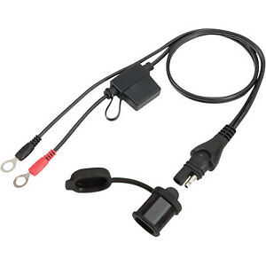

Seriously, though, many battery tenders come with pigtails just for that purpose, so, yes, it's been done.
'splain please, Lucy! "Pig Tails"??? A photo would be super helpful.

I personally installed an SAE plug 'pig tale' in my glovebox that makes this easy. Many people like to leave this hanging under the scoot but i don't because it would get torn off when I'm riding like this
To answer your question, a "pigtail" is a short piece of wire with ring terminals on on end that are left attached to the battery, and a connector that fits a battery tender on the other end. Actually, they wouldn't be good for jump-starting because the wires are too small and there's about a 10-Amp fuse in the circuit. But they're handy for connecting a battery charger. I'll leave the question of how to route the pigtail out of the battery compartment to another topic.

All excellent and informative responses. But:
a) I leave my scoot out on the street, do I don't see a battery tender in my future.
b) as someone pointed out, the pigtail wires are too thin for a jump, even if there wasn't a fuse in the line.

I bought sae connectors with 12# wire
https://www.amazon.com/gp/product/B09XM5NW7R/
I can use that for the tender or with a cord that plugs into a power point in a car for a jump start. Let the car battery charge the scooter battery for a couple of minutes before starting the bike.
https://www.amazon.com/Extractme-Cigarette-Lighter-Extension-Charging/dp/B08KZXXZ5M/

10awg or 2.5mm^2 is fine - use Anderson pole connectors (the 45A inserts are fine) and you're good for jump-starting. Lead the wires up and into the glovebox.
https://powerwerx.com/anderson-power-powerpole-sb-connectors#?specs=306
