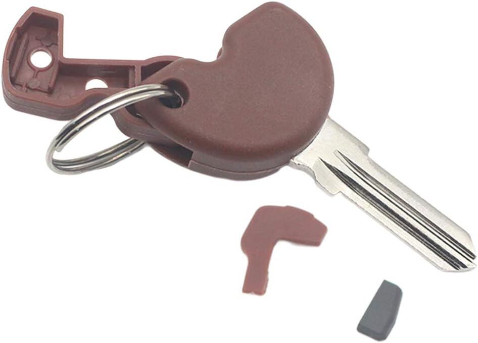

DiBiasio wrote:
I've been told that the electronic component in the duplicate key is only present on one side, not both like the original.
pic showing the chip in the master key. blue will be the same just non removable.
this is won't care about a 180 flip

since it is sometimes so sensitive to such a micro change of position of the chip when flipping 180, might be the aerial that is failing
Posts: 11455
Posts: 11455
Yeah. Ideally leave the key in the same orientation and flip the scoot 180° to check if it's the scoot or key.
