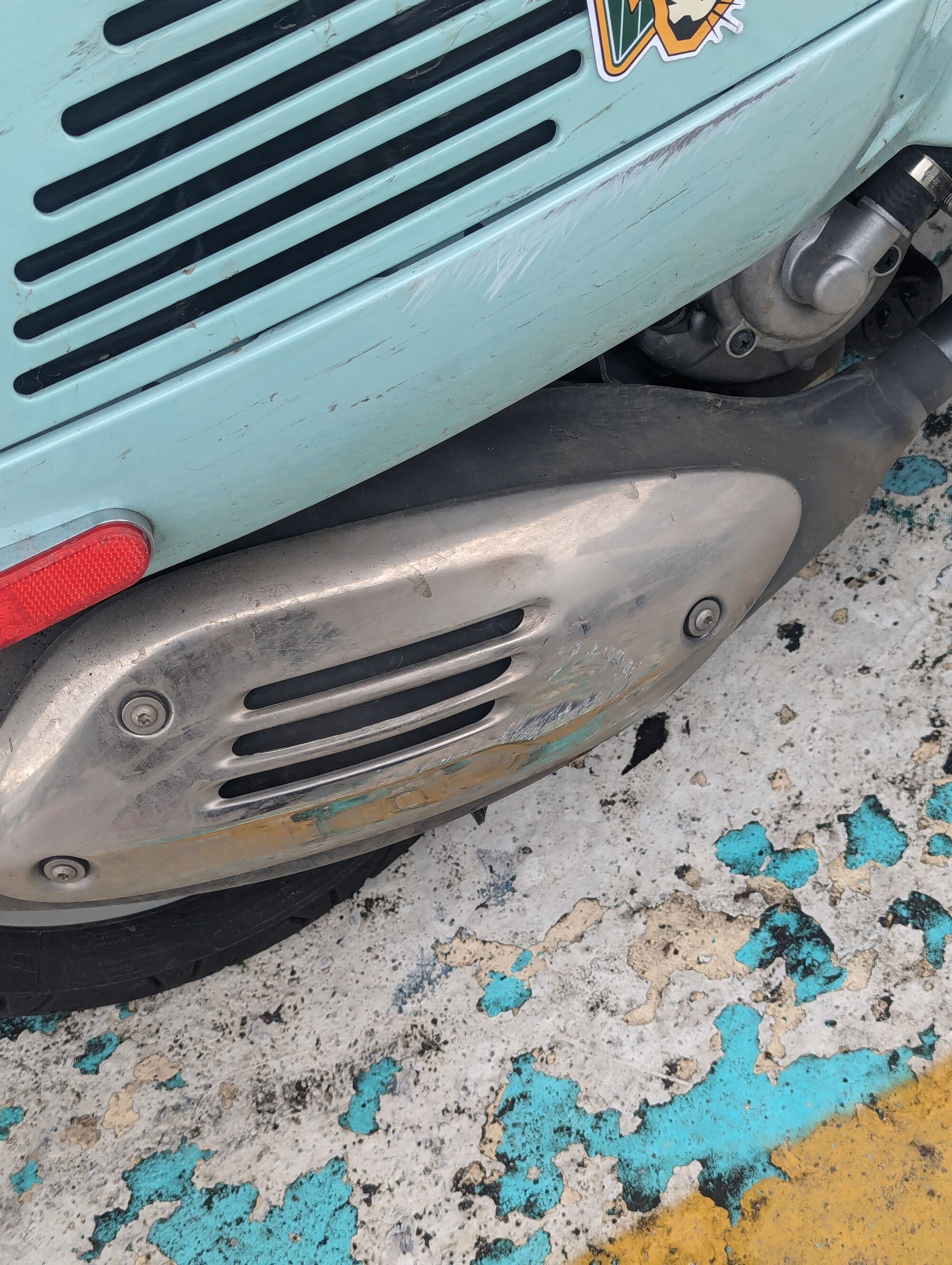

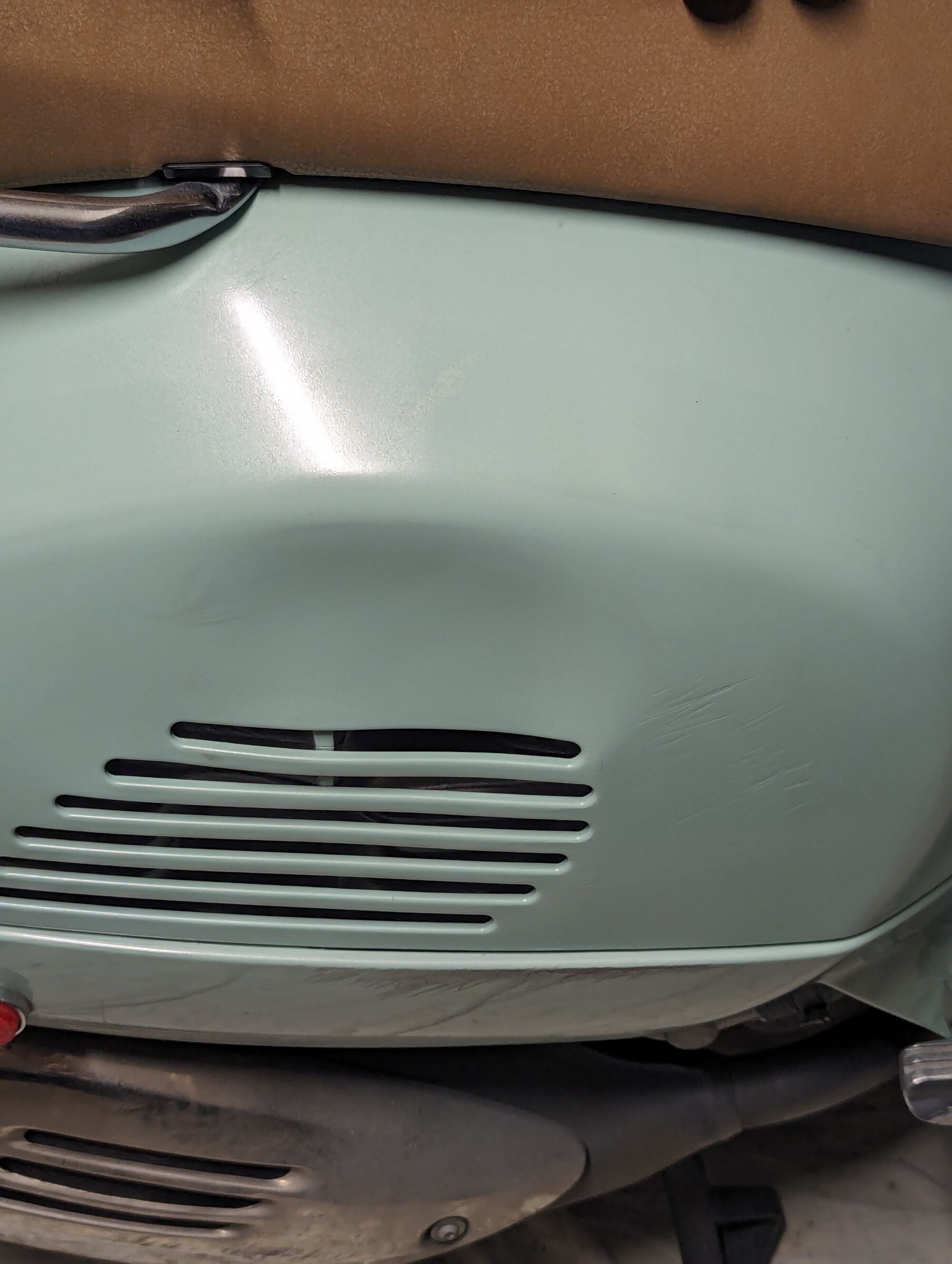

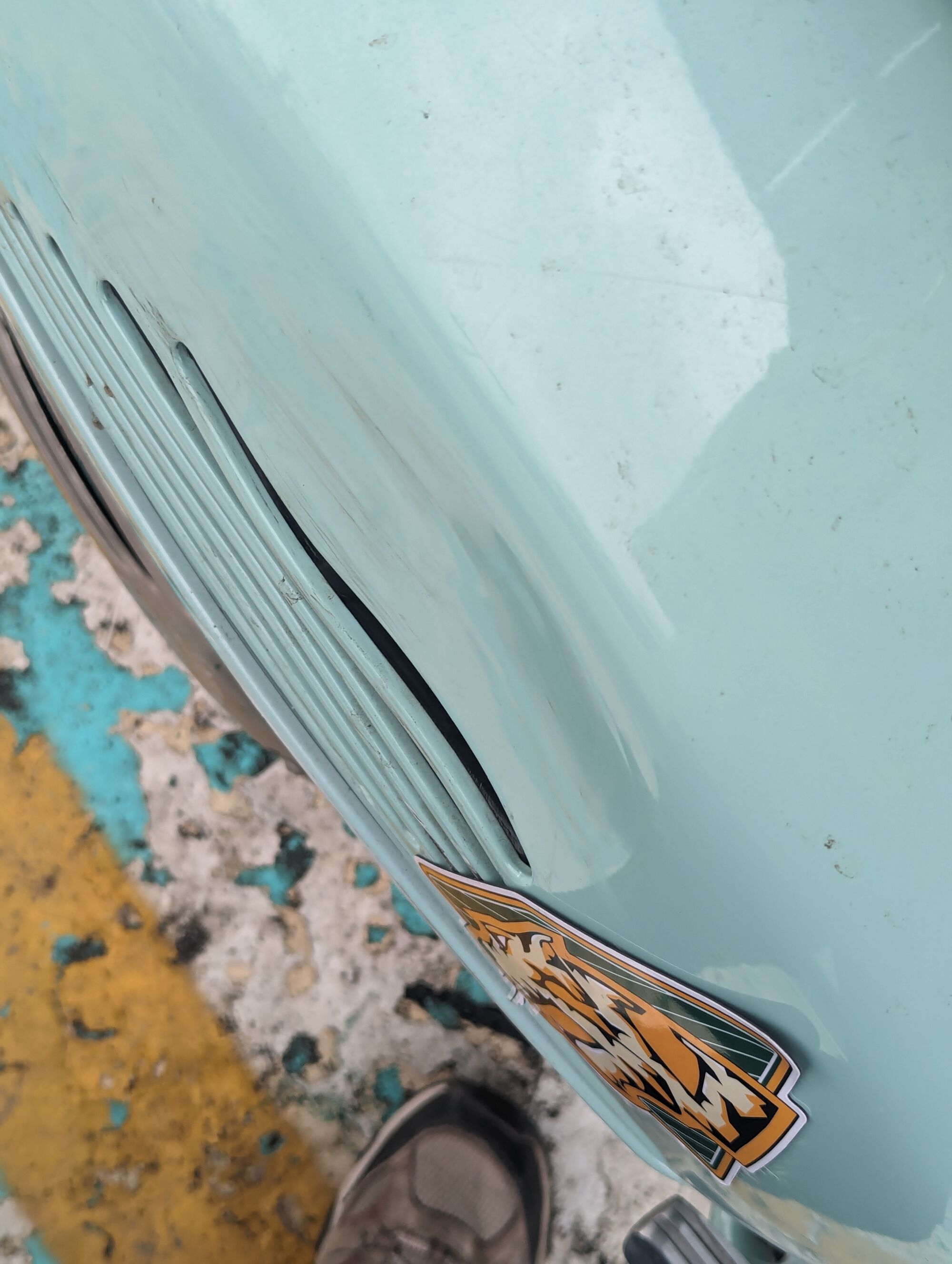

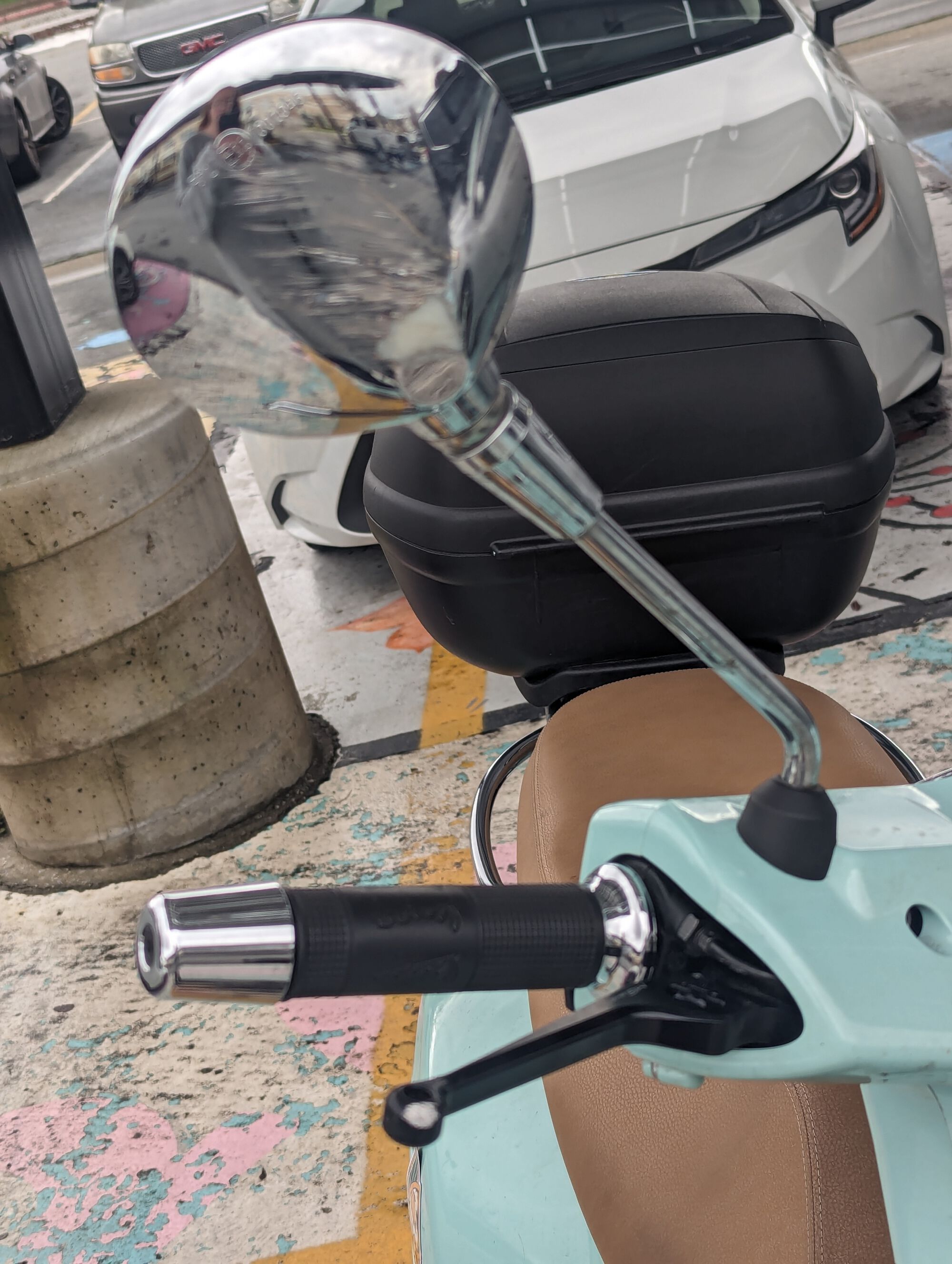

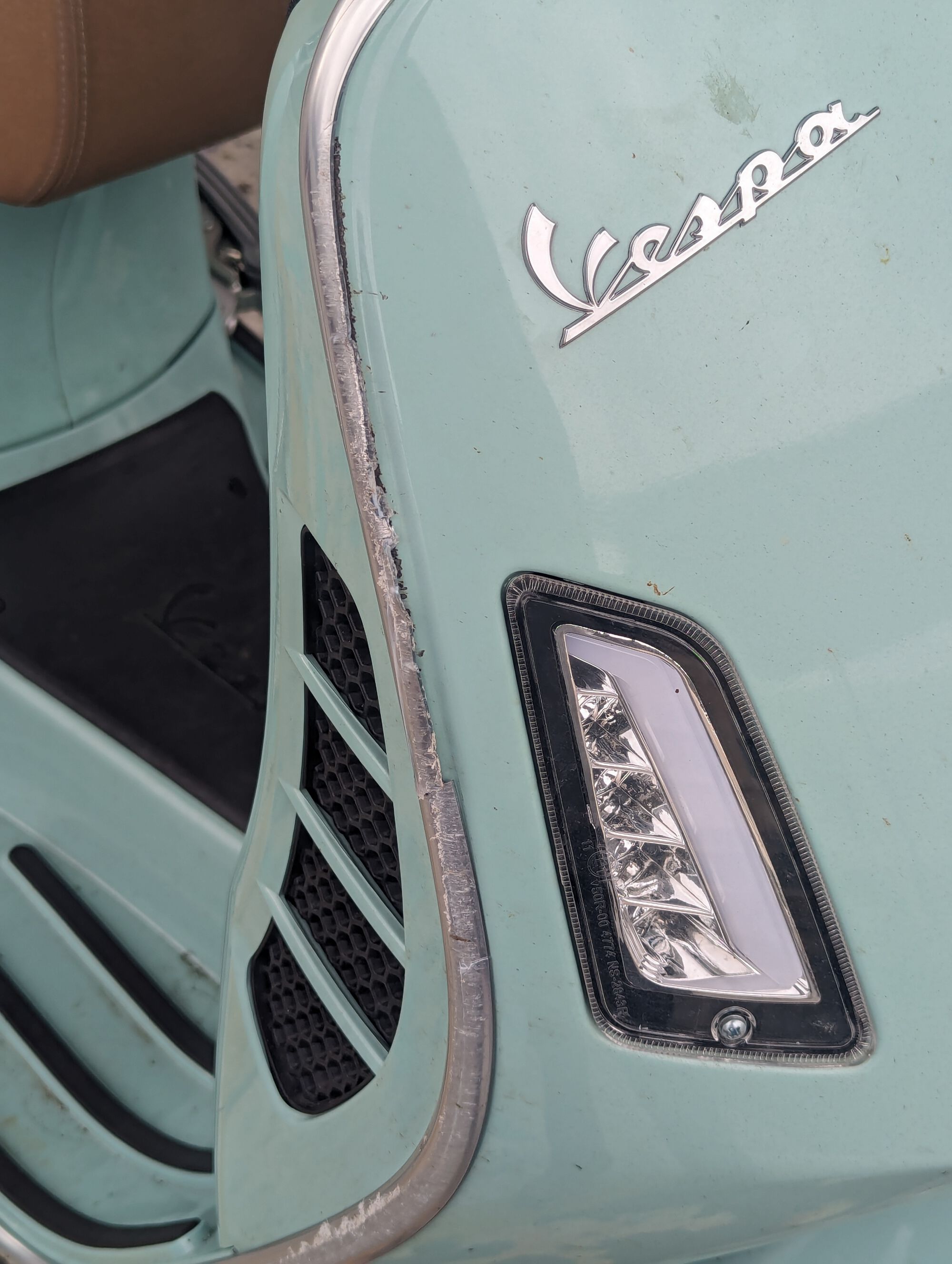

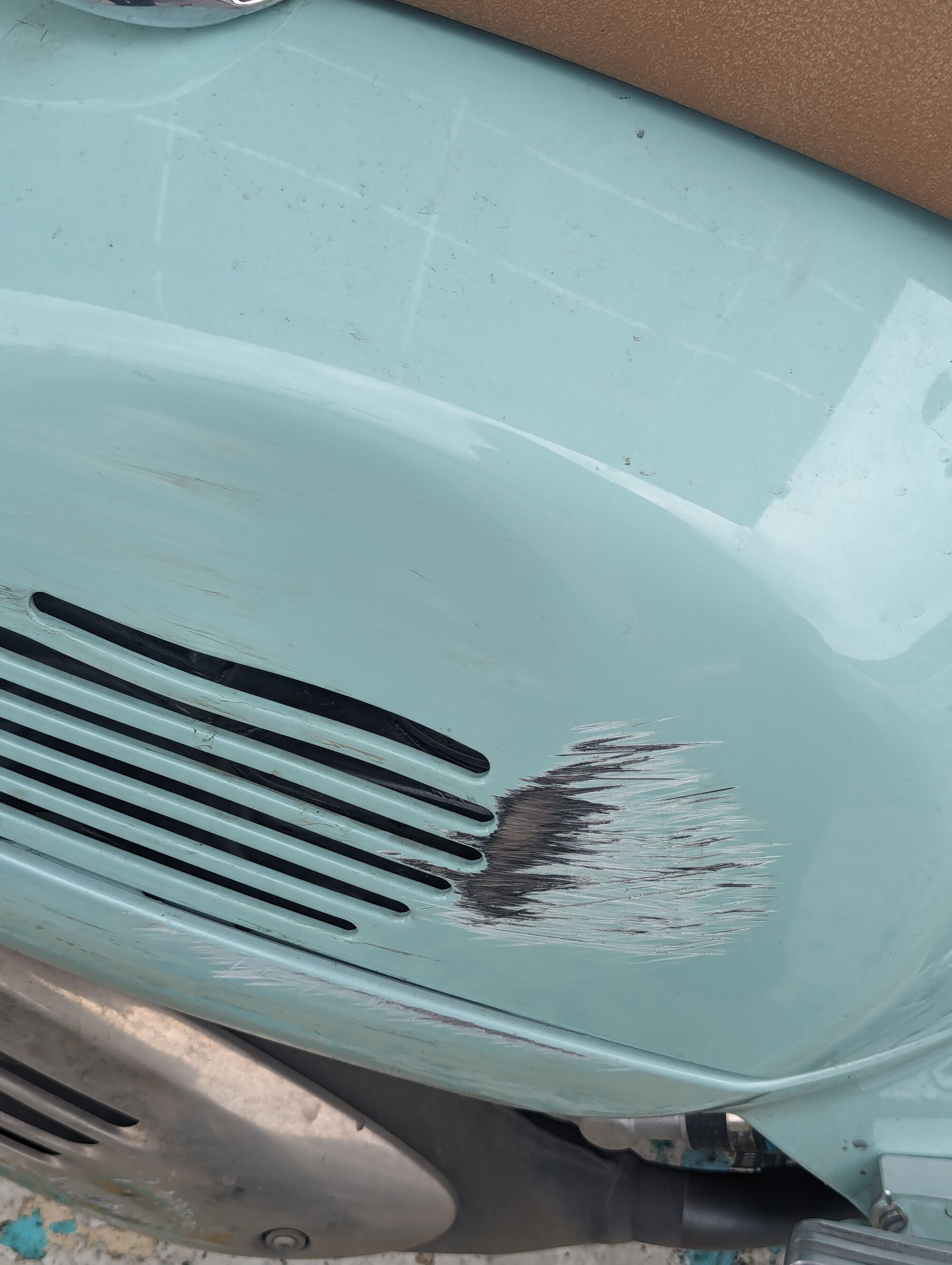

I'm wife... He can't take pictures because I took his bike to work today, to test how it was driving. Can't do the wet tire test b/c *everything* is wet right now. We're in CA, and doing some rain...
So, I'm used to riding my Liberty 150 - I don't usually ride his... But it handled well this morning. Engine was running a little rougher than mine, but I think I only noticed it because I was looking for it. It didn't seem to have any steering issues - balance felt good at a stop. (If anything, it was easier to stay balanced with feet up at a stop vs mine...) Brakes were good - I tested them on my painted parking spot, and they gripped fine.
We have a magnet that covers the big scrape - but it's for our kid's school, so I didn't post the pic with it.
Front right trim
Front right trim
Mirror/handlebars
Mirror/handlebars
Fender over gas tank.
Dent
Dent
Exhaust thingie.
Exhaust thingie.

Thanks for the pics. There was a comment about glove box not being attached? Can you post a pic of that area? Where there may be a gap between glove box and frame?
2021 GTS 300
Posts: 48
Location: CA, USA
2021 GTS 300
Posts: 48
Location: CA, USA
I'm about to go into a string of meetings, so I can't take the pic for a couple hours. You can't really see much though - it's maybe 1/4 of a cm out of alignment. If you don't know what you're looking for or aren't trying to pull the bits apart, you wouldn't even notice anything.

Based on the pictures you posted all damage seems cosmetic to me, not structural.
Posts: 39576
Posts: 39576
Yeah, that's largely cosmetic. The frame is almost certainly fine. That kind of damage is classic in a low-speed down.
It's up to you as to how much effort you want to put into fixing it. The legshield trim is replaceable, and if there's a small gap between the legshield and the glovebox, you can probably coerce the legshield back into alignment with some wood and a mallet, or even your bare (or gloved) hands.

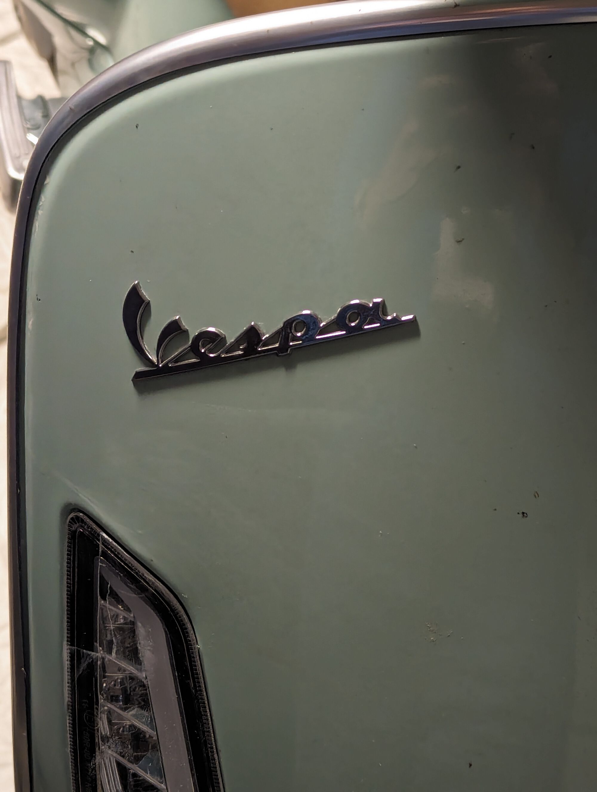

So, I wanted to update everyone! We did the wet tire test in a brief moment of dryness. Bike passed, so we declared all the damage as cosmetic.
Today, husband disassembled and primed/painted/clear coated the spots. It wasn't perfect, as it was his first time doing it... But it looks pretty good anyway!
He lost two screws, so I get to go to the hardware store to see if I can find replacements. (Wish me luck...) We also ended up with a couple extras (different sizes from the missing ones!) Based on my experience disassembling and reassembling electronics, the extra screws tell me he put it back together correctly.
Next project... Finding a heat source to release the loctite screw, to replace the breaks
Side panel repaint
Side panel repaint
Front corner repaint / new trim
