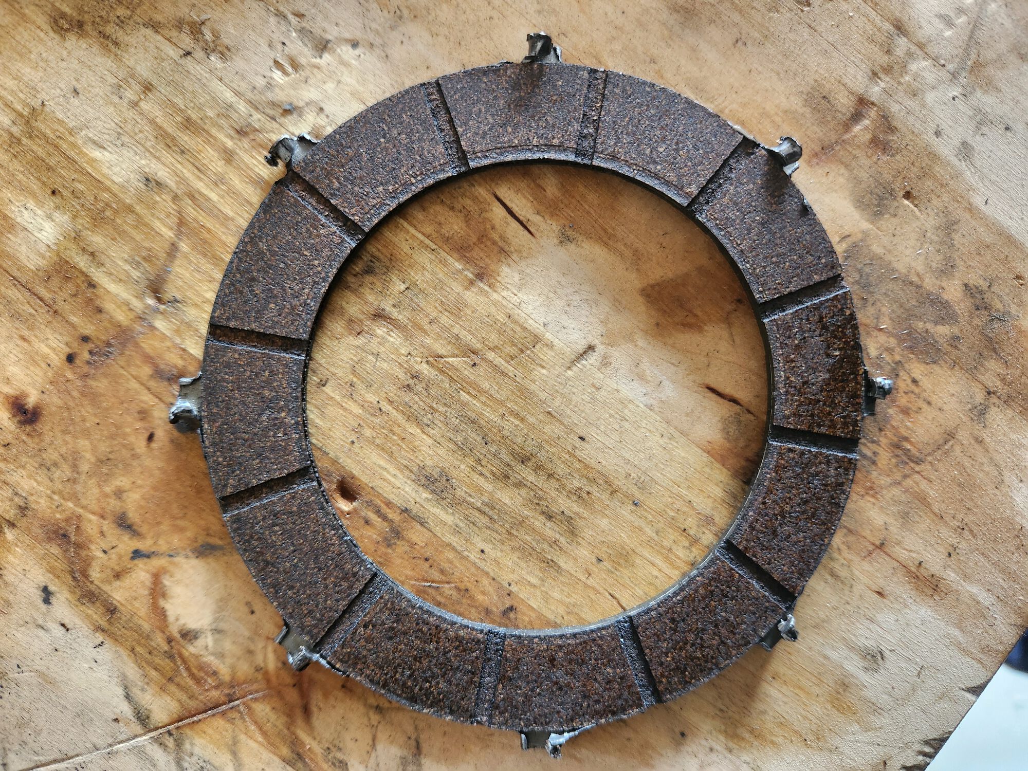

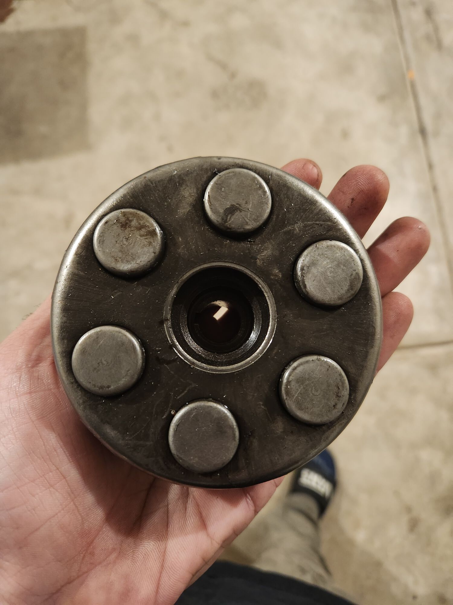

I should have listened to you guys and just got a better clutch (vmc molle) , I've been dicking with this SIP Cosa 2 sport banded clutch grabbing for days, and I'll get back it to it tomorrow to check the slot/turret depth AGAIN but it's pretty disappointing, clutches are simple things and vespas seems to have the touchiest most sensitive ready-to-break-any-mile, keeping my hand on the lever (not that it would work anyway) feeling.
I've got micro adjust levers, new cables, new hardware and the roller thrust bearing which I had to custom make into a +1mm, the cover clears fine , I can adjust till the Kickstart slips etc.
I just now saw a thread mentioning 20mm as the measurement for the turret/slot depth, has this been the fix for clutch dragging? Or do people just give up and go billet?
Also does anybody make an actuator arm thingy that has a better system? Maybe a small roller and adjuster that the cable can go thru instead of just metal on metal action all the time?

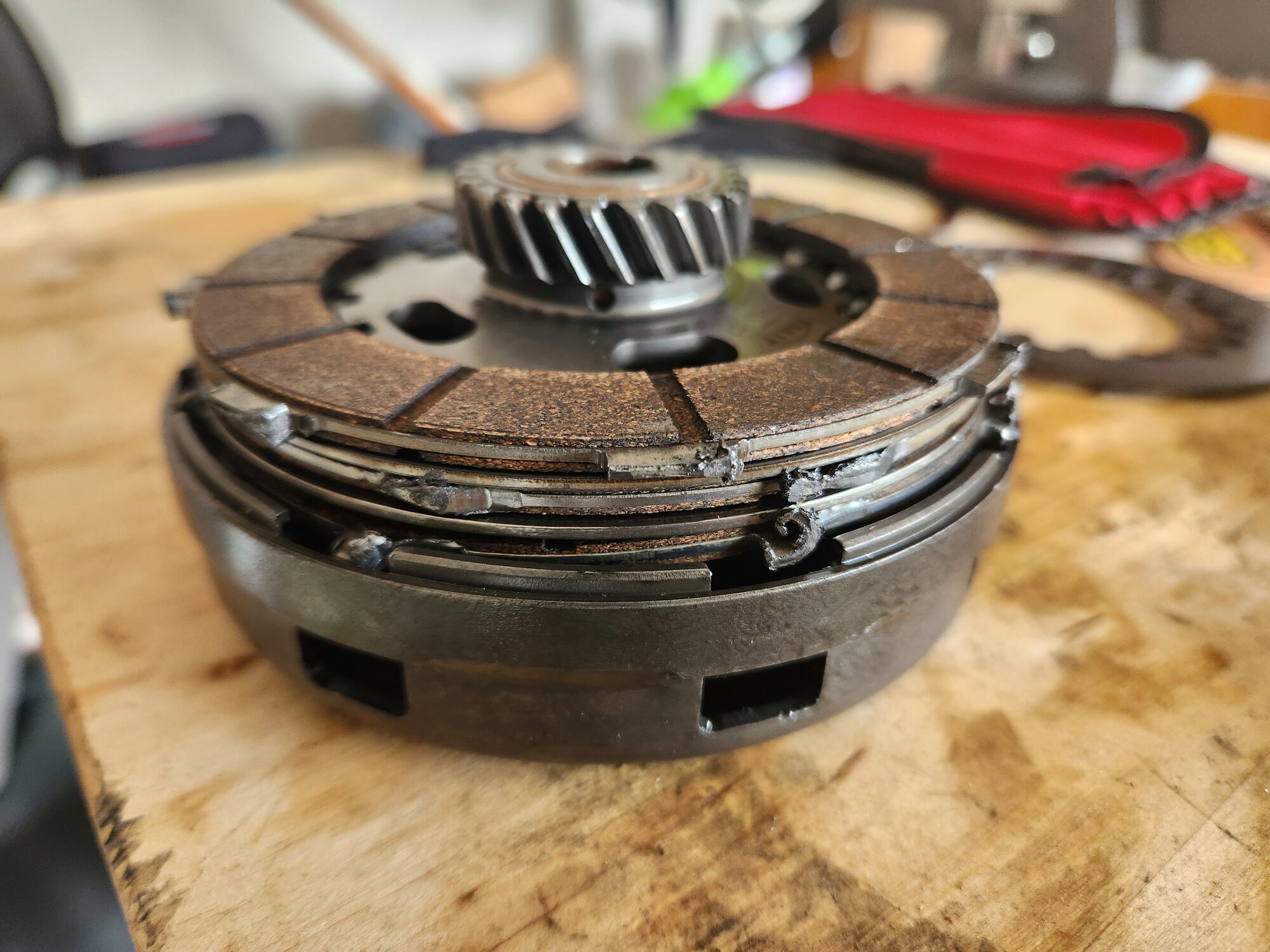

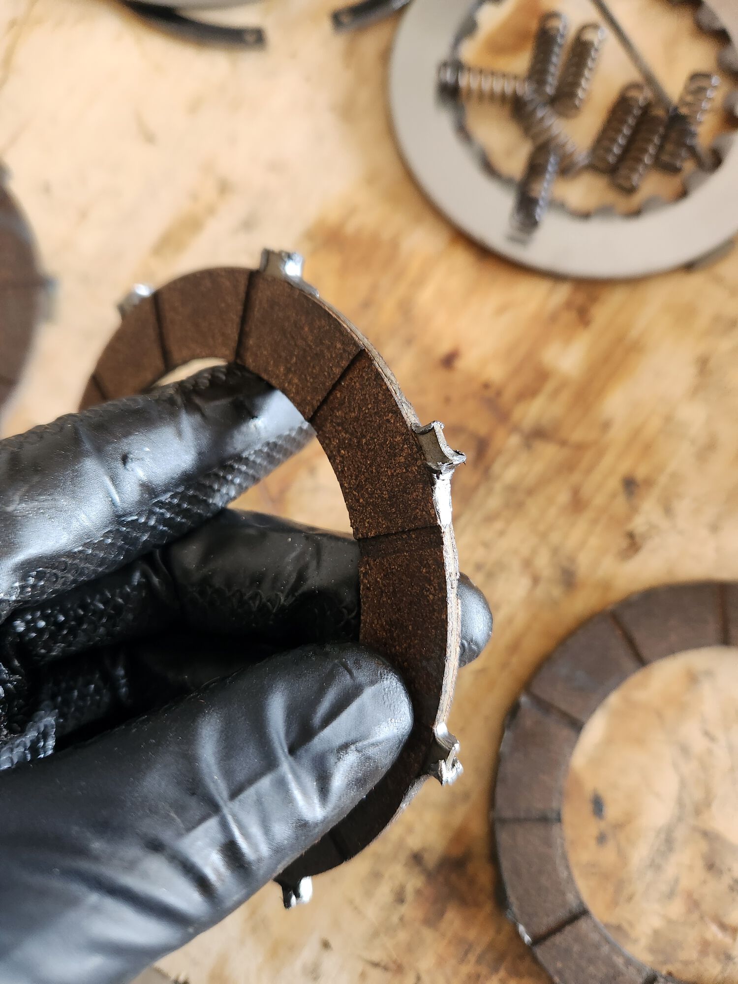

Checked baseplate to cog clearance and it's fine, disassembled the clutch, re-assembled with 4 springs to be able to actuate it easier by hand, took out washer and held it to the cog/ baseplate face and there is obvious clearance and no signs of wear on the cog face where it would make contact, I also made sure that it all spun freely within the basket, re-oiled the plates, put it all back together with all the springs, installed, adjusted via Kickstart method, and like every other time, it seems to be okay at first, ride off down the street and after a but it gets more and more grabby until you can't even get out if gear....I gotta say I'm pretty mechanically inclined, spent many years as a mechanic in the hot rod and marine industry. Never been stumped this easily AND by a scooter lol.
This whole operation worked fine with the stock tiny old style clutch, besides the exploding bit, I thought the Cosa swap would be easy as cupcake!! It's been a nightmare so far.

To be honest you absolutely don't need this fancy pressure plate with bearing.
Did you try with standard plate and push rod?
BTW there is DRT plates with +1 and +2 mm higher.
Is it possible that pressure plate touch clutch nut or thread on shaft when clutch is pushed?

Lemme start with a really basic question: Why did you install an upgraded clutch in the first place?
Assuming you still have the original clutch, have you tried installing it to see if the issues resolve? If so, maybe you just roll with that.
I have some pretty respectable motors (17-18 HP) that do just fine with a stock seven spring clutch. That thing doesn't get nearly enough credit, IMO.
I also have much much serious motors with BGM Superstrong clutches, which are COSA2 derivatives and cause a lot more of the sorts of issues you're struggling with, so lemme kick out some thoughts and suggestions in the form of questions.
There are lots of good suggestions in here already, but they don't seem to be working for you, so let's stop and reset for a moment.
You'd have to ditch your ball bearing pressure plate, or get the one that doesn't have the top hat integrated into it, but Crimaz make a pinion gear plunger set that might work for you.
I tried it in one of my bikes and it didn't press square on the plate, causing off-center contact and rapid failure, which was extremely disappointing, but I put it more on the clutch cover than their design.
So with that glowing endorsement, I'd suggest you go back to basics.
While it seems simple in theory, as you've noted, there's more complexity/ingenuity in the clutch system than one would think. Your issue seems to be that there's not adequate compression range for the clutch itself.
This gives you two options:
1) adjust the height of the clutch to better match the compression range of the cover. This is the route you've taken thus far, adding the millimeter spacer to the pressure plate (which was pretty genius, btw )
2) Increase the compression range by increasing the headset lever travel range or decreasing the clutch arm length. I'd suggest the former, as the latter is going be a lot harder to pull off successfully and will also reduce mechanical advantage and make the clutch stiffer overall.
This leads me to want to see comparative pictures of your old versus new lever. Is it possible that the new lever has less travel than the original?
If so, or even if not, you could also grind back the new lever to add more travel. I had to do that with the front brake on my smallie to work right with the disc brake's master cylinder. Works great and you'd never know it to look.
Alternately, I know you said you have new cables (and pretty much everything else), but...
Are you 100% certain that the clutch cable routing is correct, the outer is the correct length, the ends are fully seated into their housings?
They should naturally tend to seat themselves since the clutch arm provides constant pressure, but can't hurt to check. If you didn't measure the cable length, they are frequently 6-12" too long ("For a Grade A Repair," my ass) and need to be trimmed back for optimal performance
Can you turn the clutch arm easily in the cover when the cover is off the motor? i.e. is there any more resistance than just the spring?
Does the clutch compress and spin more-or-less freely in a clutch compressor tool?
Is the clutch correctly assembled with the plates in the correct sequence and alignment? If yes, how do you know?
Have you considered adding an even thicker base spacer/thrust washer?
Are you certain your existing thrust washer is not worn?
Any of these can cause the sorts of issues you're describing.

Alright fellas I'm back woth another clutch problem, this time I sploded' the SIP Cosa 2 sport
Well, more like shredded the tabs clean off the plates ☹️
I'm kindof confused here becuse previously I've blown clutches but it was the basket failing
This time the plates have completely torn the tabs off but the basket is fine
A) I'm a big dummy
B) these plates suck
C) not enough clutch for this engine
D) option a

B, they suck. CR80 plates don't break like that. Each plate will need filing to fit under a ringed basket but will last many years.
https://www.sip-scootershop.com/en/product/clutch-friction-plates-sip-performance-cosa-2-race-clutch-cosa-2_93081400

why are you fucking around with this clutch dude? Get rid of that junk . . . and that is exactly what it is. go- VMC and never look back.
