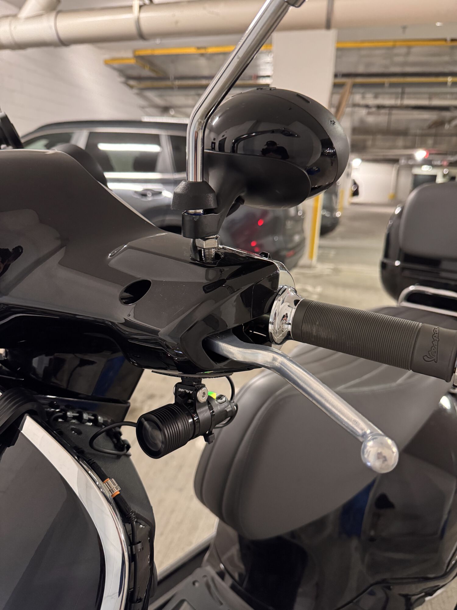

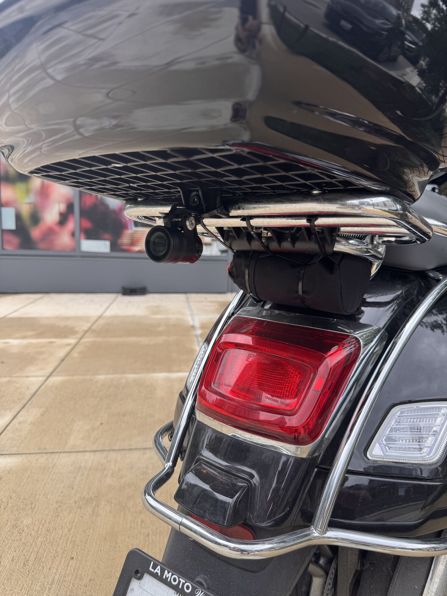

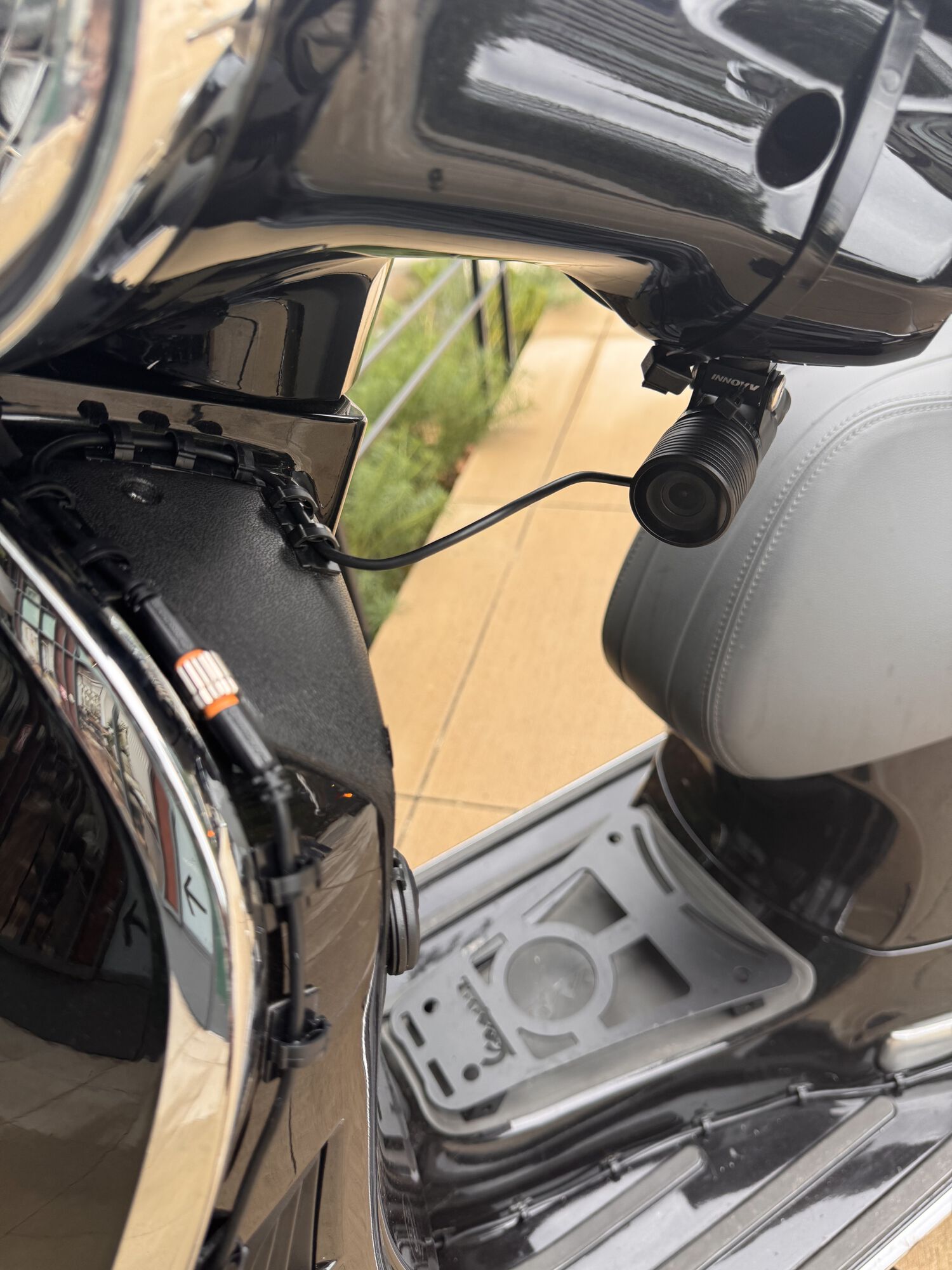

Hello everyone, allow me to share my experience too for those interested.
I bought the Innovv K6 2K+1080P Motorcycle Dashcam for my Vespa GTS 2023. It features a front and a rear camera with recording on a micro SD card. The recording starts and ends with the ignition of the scooter, and can be accessed with your phone via a wifi connection to the camera.
To install the dash cams you need to open your Vespa and plug the front camera (the rear camera is connected to the front one) to the battery and the fuse box. I watched that video from scooterwest.com to know how to open the Vespa and reach the electronics:
Plugging to the battery is easy, but the wiring to the fuse box is a bit more difficult. Basically, the connection to the fuse box allows the cameras to turn on and off with the ignition. For that you need to find a fuse that turns on with the ignition (like the lights) and add that small wire to it. I did not found the exact fuse box details so I just tried a few until it did the trick.
Once wired, you can use the provided kits to fix the cameras to the Vespa and small adhesive wire holders (like the SAISN ones) so that the cable between the front and the rear camera isn't floating around. The installation kit contains 5 or 6 clips but I needed around 25 to get something neat.
