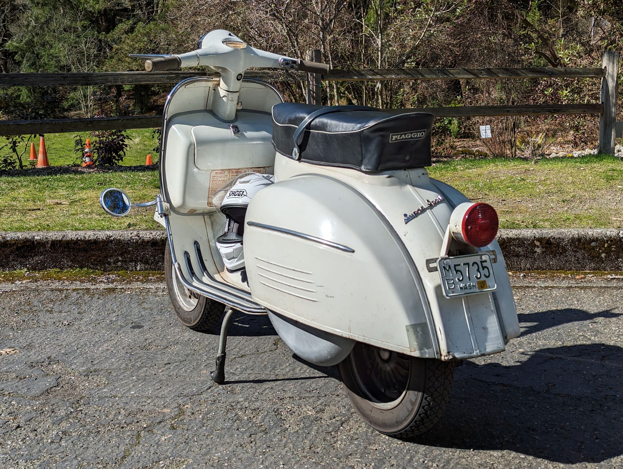

I have a U.S. model 1967 Vespa SS180 that is giving me trouble. The motor has been rebuilt, I have cleaned and rebuilt the carburetor recently, cleaned the gas tank and added a fast flow fuel tap. I added a Pinasco Flytech ignition system as well. My problem is the power starts cutting out, backfires, and eventually stops all together (very hard to restart right away) after I have been running it for some time. I had this problem with the stock exhaust and now with the SIP Road 2 I added, and yes, I did rejet for this exhaust.
The SS starts up easily and runs great for awhile, but once it gets going (sometimes for an hour or so, and sometimes not so long) this problem resurfaces. If anyone has any ideas, please share them with me. I am ready to push this thing into the ocean (not really).
My only guess at this point, as the motor runs fine when it starts, and there is not a fuel issue, it has to be spark related. I am thinking I need to replace the CDI even though the Flytech kit doesn't have that many miles on it.
Thoughts?
