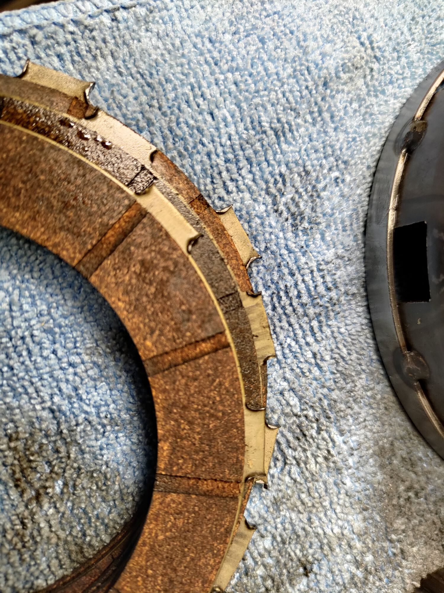

I have just taken the clutch to bits and the cork plate tabs are all mullered and bent. Proper hammered. It was a nightmare gettting the last plate out of the basket. I think this is defo the issue. Why are they only lasting a few months of riding? Any recommendations on some nice strong clutch plates?

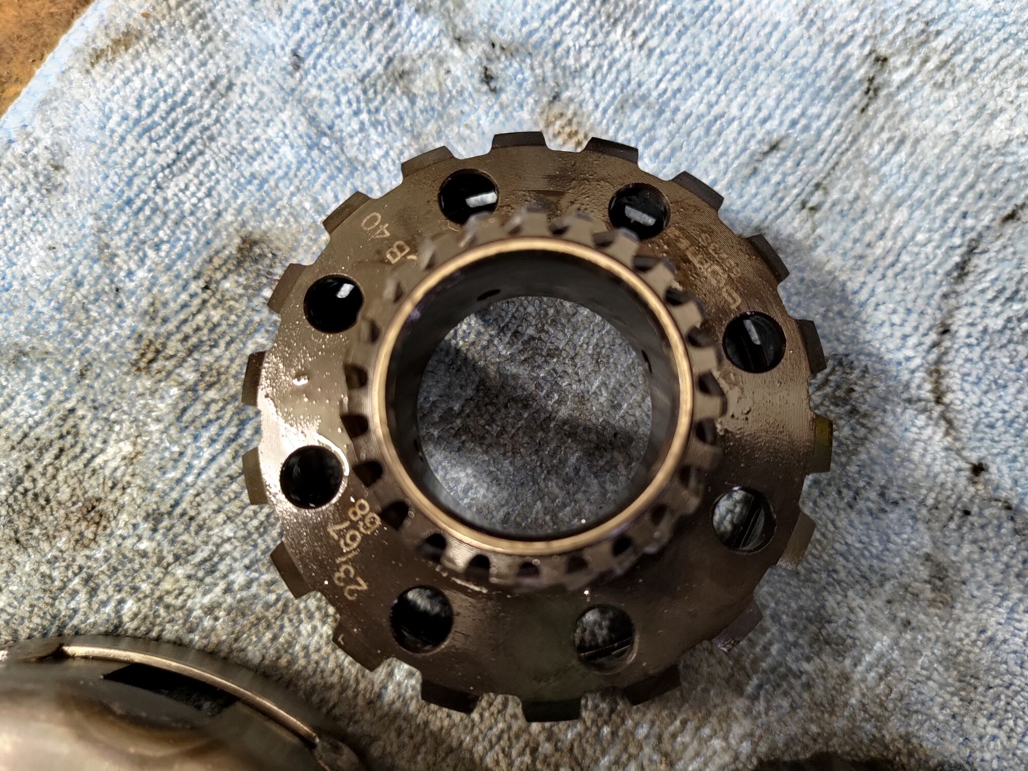

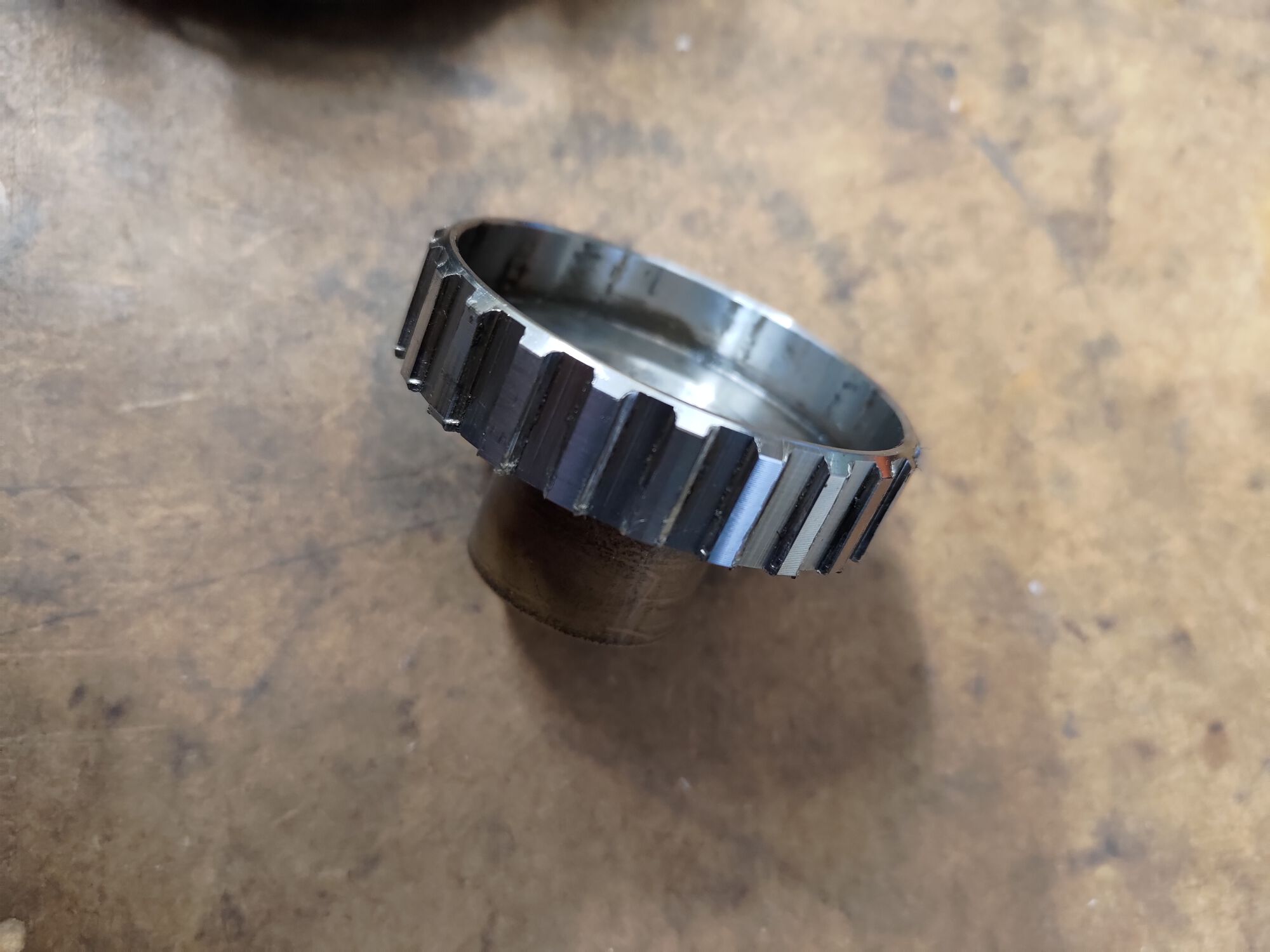

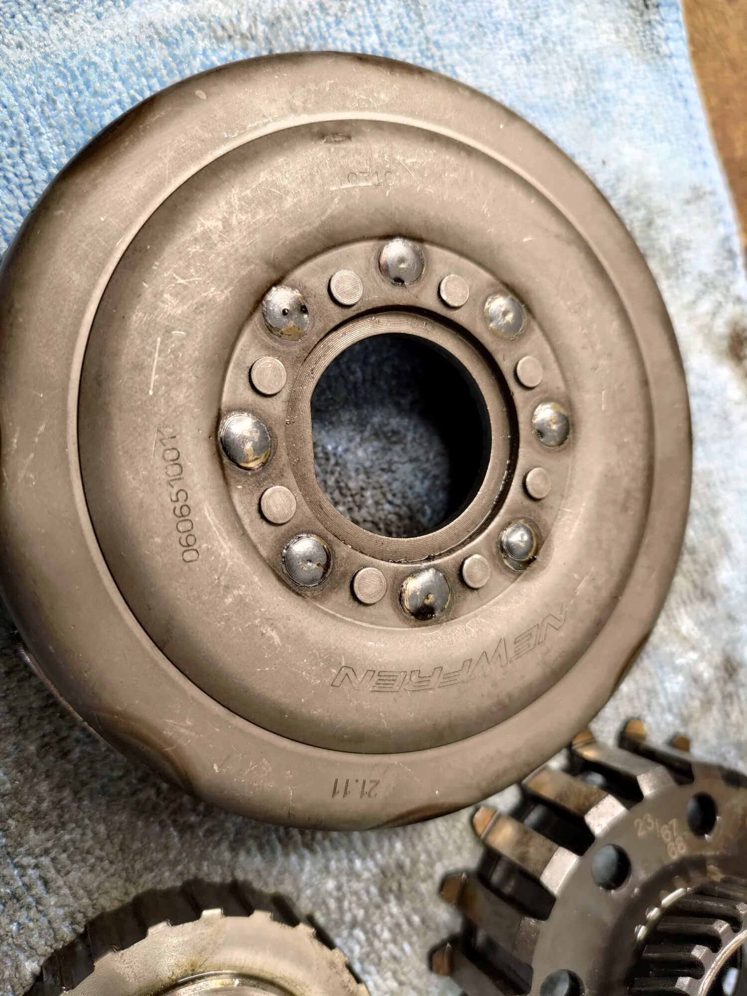

Pictures above. Using 8 slightly stiff springs. That's all I know.
Thanks.

take some photos of the of the baseplate; specifically the "teeth" where it indexes into the clutch basket. There is a reason why MMW/BGM/SIP/VMC/etc. has changed this designed. once these teeth get wear, then plate separation becomes a problem.

The clutch is all brand new in the photos there. Only been in since Aug last year. I will get some more phots later. I hope it's not worn already. Hoping it's just the shitty, soft friction plates to blame.

Pics:

roody76 wrote:
Pics:
look at the turrets in your clutch basket, the clutch plates have already started to dig into them.

I can't feel them so only slightly, slightly marked. I get at what you are saying though. What else would I need to buy with that VMC kit? It says no drive gear included.
Yup, that's true… I see the marks…
