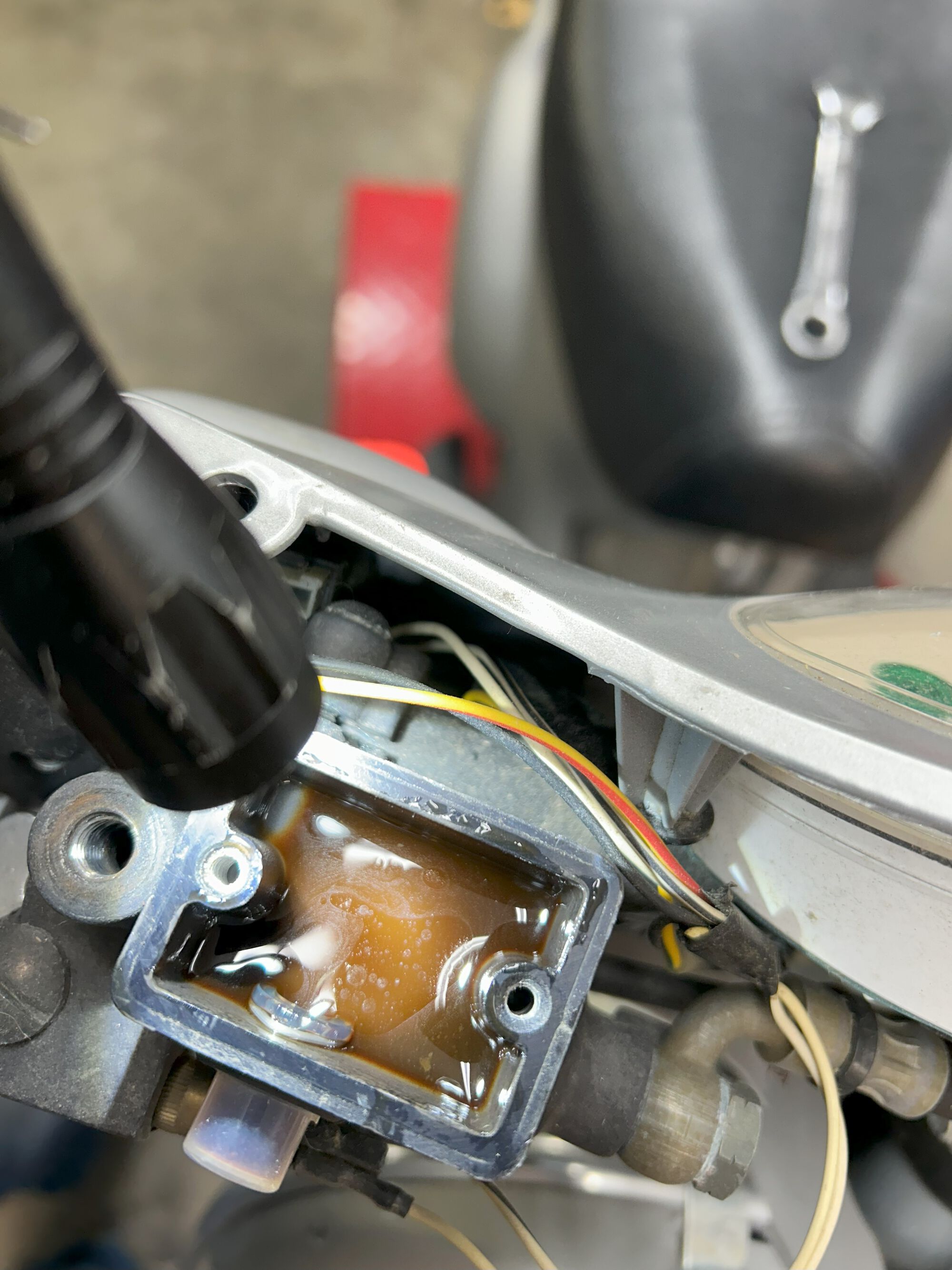

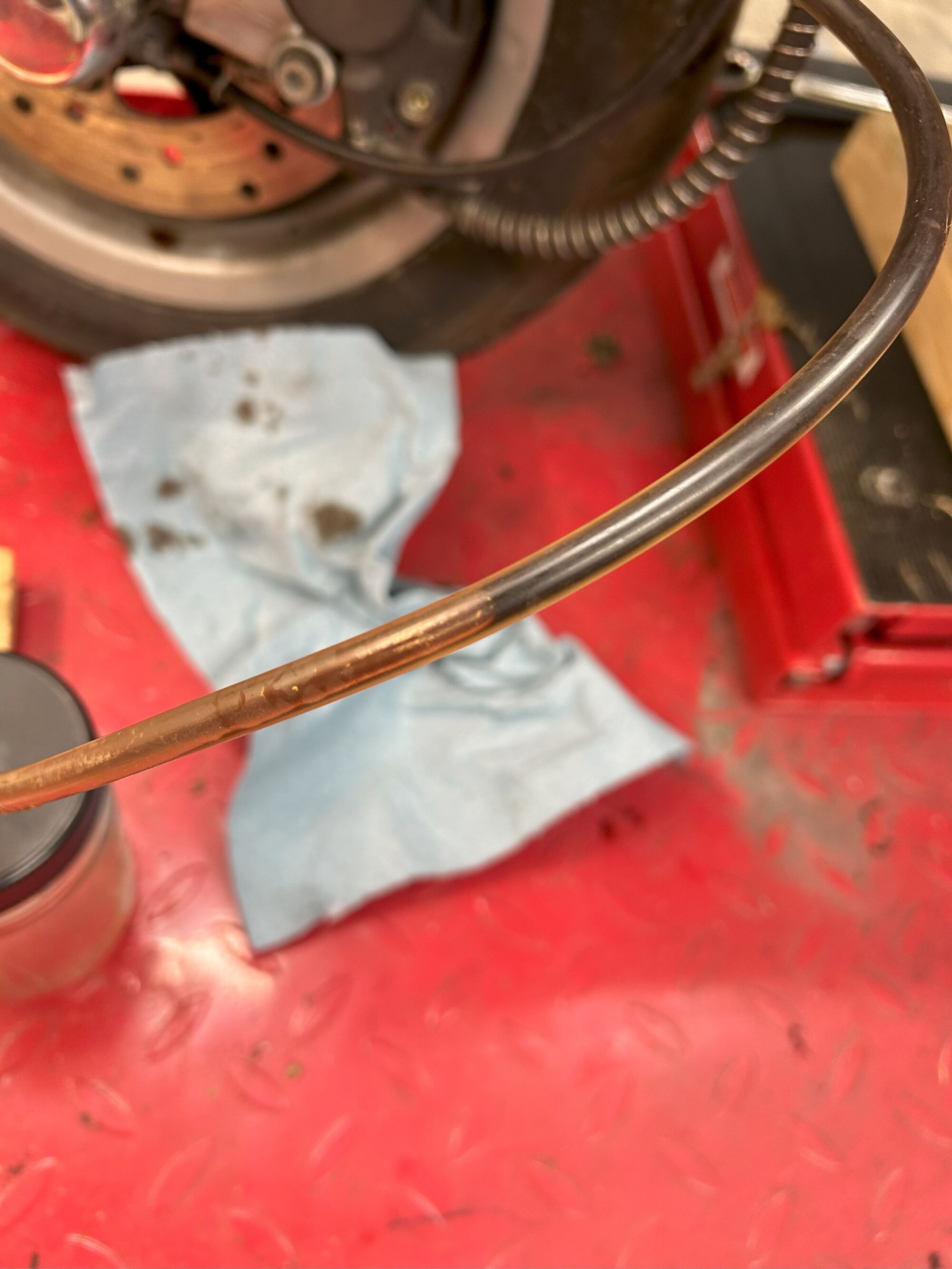

Brake fluid was interesting in that, I believe it is the original brake fluid so like 20 years old. Caliper not frozen as I was able to push pads back with screwdriver. Took pads out and sanded rust off. Here's some pics I thought would be interesting to share.

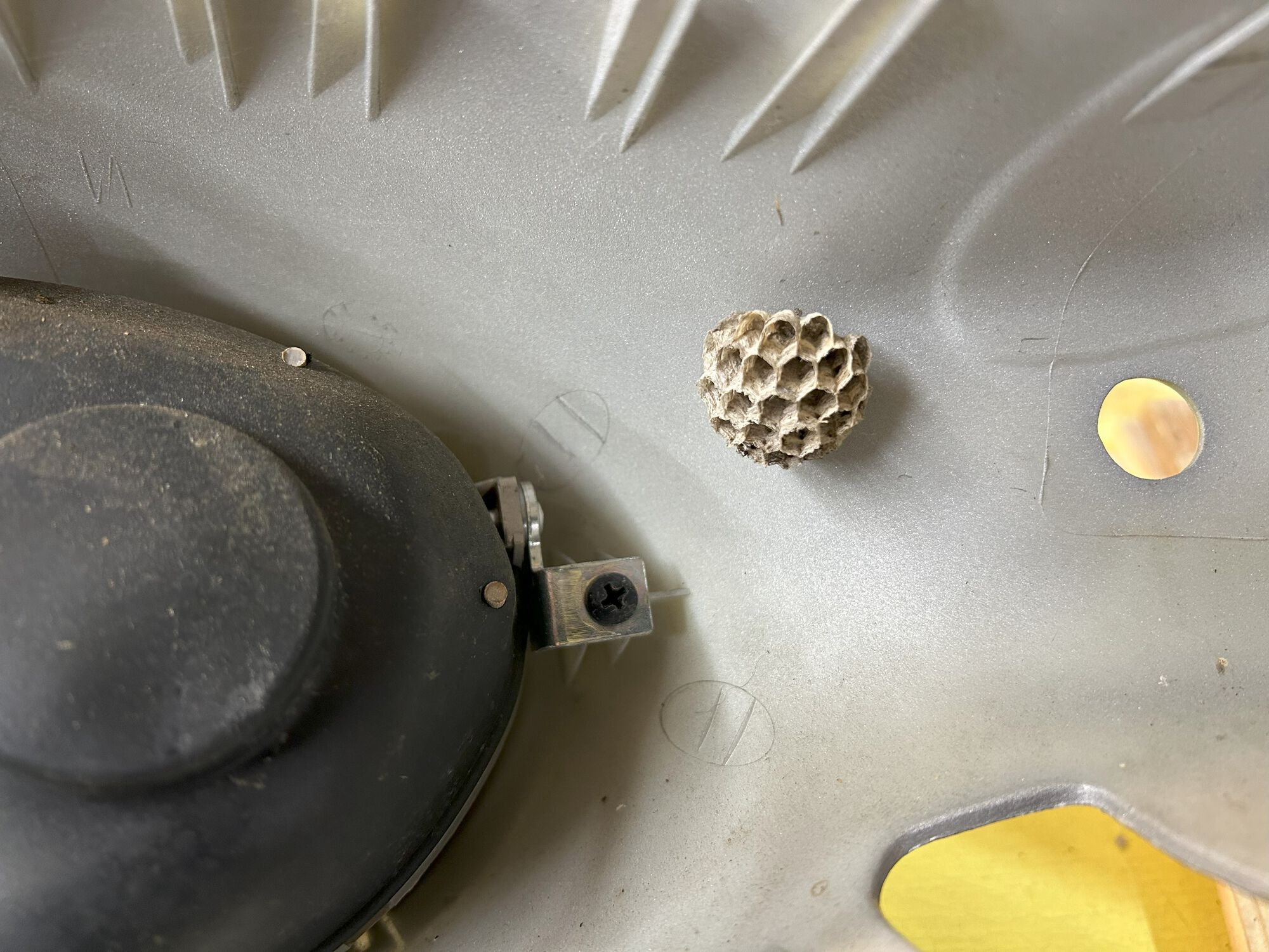

Headset wasp nest.
Headset wasp nest.
Master cylinder when opened
Brake fluid in drain line
Drained brake fluid
Drained brake fluid

I'm happy to see this being brought back! Clap emoticon
But that brake fluid... Bleh emoticon
