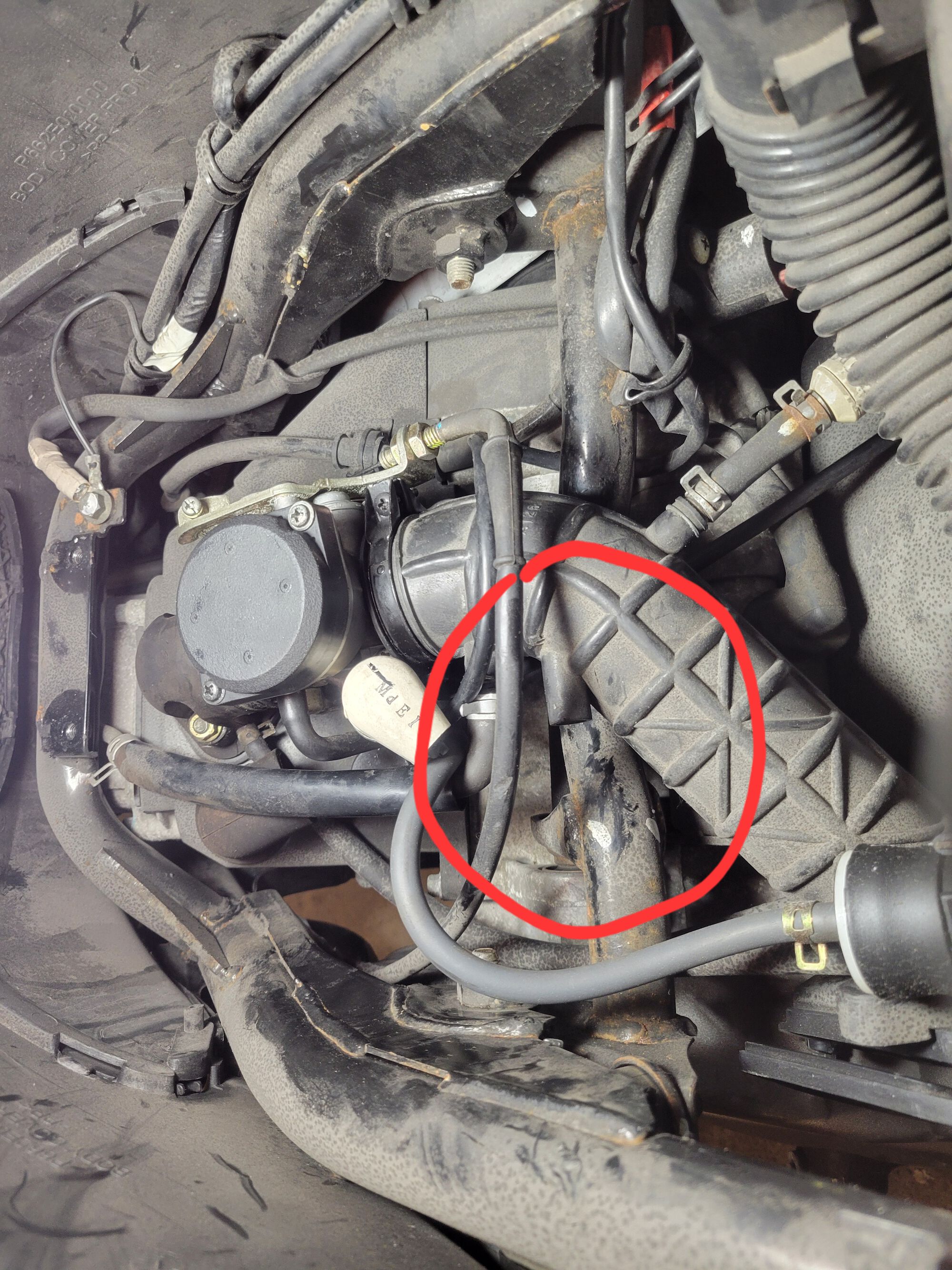

Just noticed this, something is missing, isn't it?

Nothing is missing there. I have the same setup on mine. It's got a bonded plug in it.

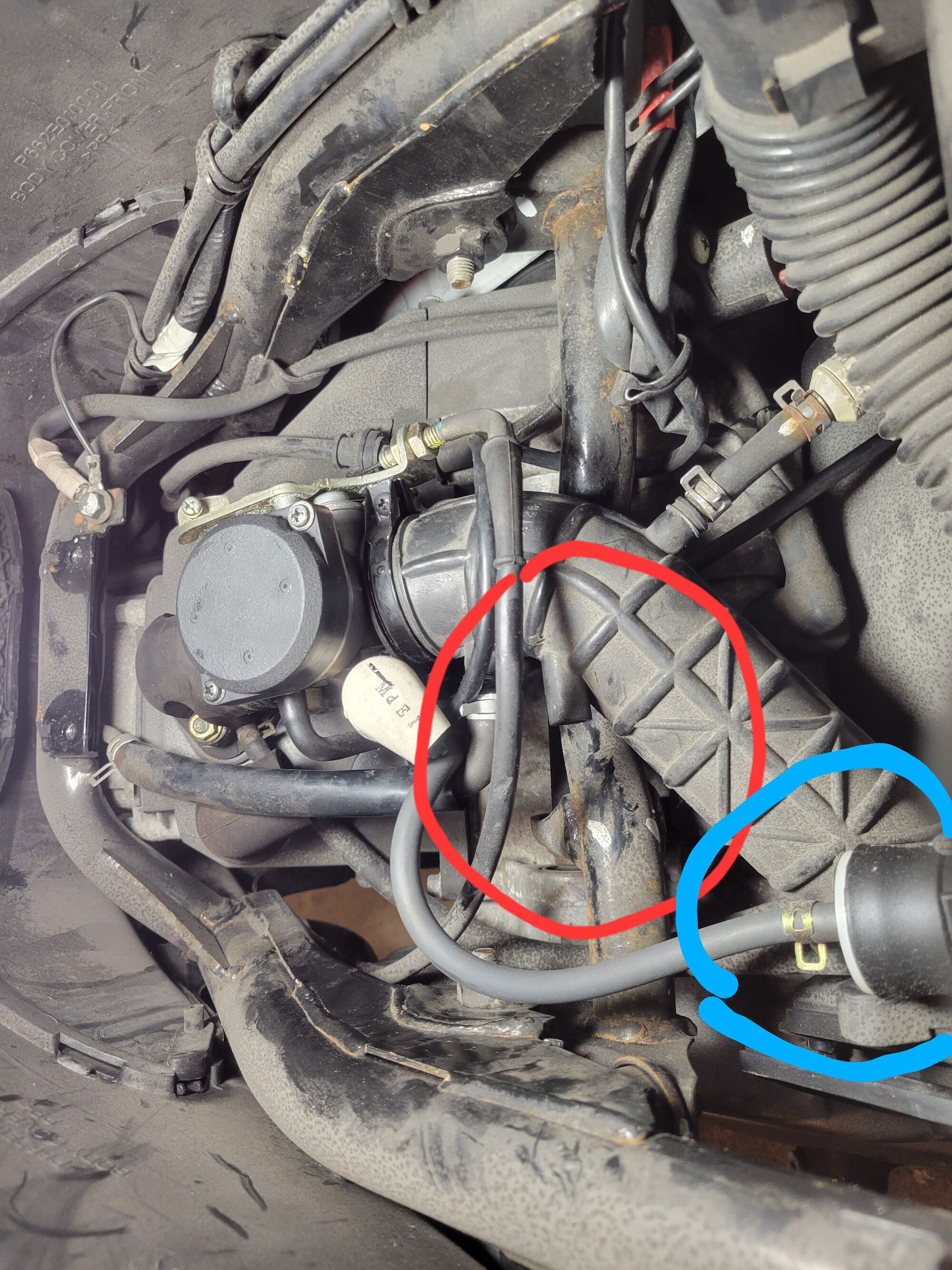

Pull your fuel filter (circled in blue) and try back flushing it with carb cleaner.
If you pulled the pilot jet, make sure you pulled the mixture screw (left front side of carburetor) and make sure to blast that area with carb cleaner too. Count the turns in to when the screw seats so so you can get it back to that spot when reinstalling it. Be careful, there will be a spring, a small washer and a small O-ring behind that screw

Regarding the mixture screw - I did that and it was just over 4 turns, which seemed very high. According to everything I've read and, there could be an exception for the 2013 model or something..., it should be 2.5 turns. I set it at 2.5 turns. Maybe that's the problem... will check the fuel filter anyway.

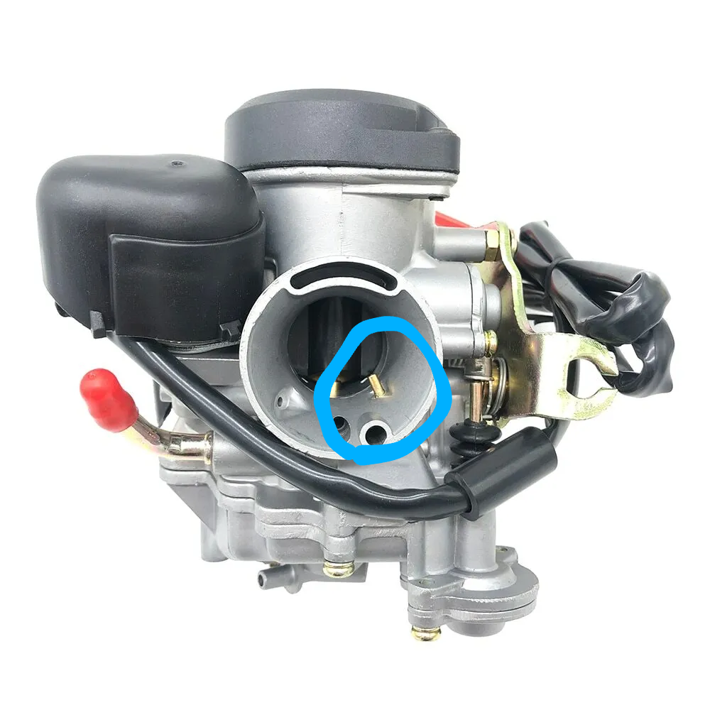

When you took out the main jet, you might have needed to push the emulsion tube down out where the main jet fits. There are multiple holes there (like a mixing tube on a Vespa) that need to be cleaned out. An Ernie Ball #10 or #11 string works well for cleaning these openings.
As for the throttle, did you clean the accelerator pump assembly? There's a diaphragm that draws fuel from the bottom of the bowl, that pumps fuel up to a brass jet on the venturi. You need to check the pump separately. Take the bowl off, add fuel to the brown and push the pump rod. It should squirt fuel out through the well on the side of the fuel bowl. If that works, check the hole in the carb body above that fuel well and shoot some carb cleaner up there. You should see some jet through the venturi onto the throttle butterfly.
Not an exact match carburetor, but this is the accelerator pump.

If there's fuel in the float bowl, you can try to get some into the intake by rolling the throttle open several times prior to cranking the engine. This actuates the accelerator pump. If it's clean and there's fuel in the float bowl, the brass jet in the inlet of the venturi will shoot a jet of fuel down into the intake side of the carburetor. You can take the air filter tube off the carb to check if it's operating.
Roll the throttle 3-4 times before hitting the starter and see if the engine tries to start.
Accelerator pump jet circled.

But, with the air filter tube off, I rolled the throttle a couple of times, and it's hard to see if the jet squirts but it definitely gets wet. I assume it's fine.
I guess I'm missing something.
There's fuel in the carb bowl and it's either not making it to the engine (hence the dry spark plug) or it's not enough or something. When I was able to start it with the starting fluid it would run really rough for 1-2 seconds and die.
What about the "choke"? I looks like someone serviced the carburetor as the rubber housing over the choke is missing.

MJRally wrote:
The fuel taps are vacuum operated. If you have a vacuum leak, your fuel tap won't open and the carb won't get fuel.
And this happens outside the carburetor? If the engine cranks it would "signal" the fuel tap to open?

nomadinsiam wrote:
There are too many hoses, filters, valves, and plastic moldings in the way. I would have an anxiety attack trying to work on that.
Tell me about it. Just last summer I got into scooting after I acquired a 1980 Bajaj (long thread here) and I tell you, I don't like this Buddy 125. But I guess I asked for it ie for a cheap scoot that I can service, maintain and in this case it would be nice if I can get it running
The fuel tap has a hose connection to a vacuum source, usually off the intake manifold. Engine cranking opens the fuel tap and when the engine stops, shuts off the fuel. Like an automatic fuel tap.
OK. So either it's not getting enough fuel, or the spark plug is not as good or the choke is toast.
What about the diaphragm in the carburetor? I checked it, it's intact. What does it do/serve?
@az_slynch avatar
Posts: 1942
Location: Tucson, AZ
@az_slynch avatar
Posts: 1942
The diaphragm is the "CV" part of the carb, or "constant velocity". When you roll throttle, it opens the throttle blade at the front of the carb (and fires the accelerator pump if equipped). As engine vacuum increases, the vacuum pulls the slide attached to the diaphragm upwards, affectively regulating the rate at which air and fuel are fed into the engine. It also provides some degree of altitude compensation, adjusting the air and fuel intake based on air pressure at a given altitude. Not as flexible as EFI, but a bit less altitude sensitive than a standard carburetor.
