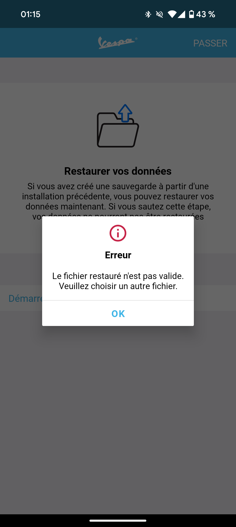

I'm resurrecting this post because I changed phones and I'm unsuccessfully trying to transfer my Vespa data from the app on my old phone to the new one.
I do have the JSON file, but it throws an error when I try to import it.
I also tried importing it into Snoop. That works but I'd still like to get my data into the Vespa app.
what is the error msg exactly?
did you switch between iOS and Android?
are you signed in with the same account?
Google Pixel 7 to 9 (Android)
Same account
The error message is in French but ils "not valid file try with another one" (see attached)
Same account
are you 100% sure it's the same account? The Vespa MIA app checks this. if you still have your old phone you can check the email address in the menu -> profile screen in the Vespa app.
how big is the file?
was it the same version of the Vespa MIA app that you used to create the backup json?

Hello
Same version 2.10.3
Same account (The only différence is thé driving licence not showing on thé New phone)
The json file is about 6.3Mo
Regards

ayman fyi,
I asked jicao to send me his file so I could investigate. Piaggio had put a null object into the array of trips (last one in the array). I removed that and then it imported ok. So I repacked the file and sent it back.
I'll probably add a button in to my app that can do this repair as more users will have this problem until piaggio notices their mistake.
note: appears to have been introduced in 2.10, but too lazy to check deeper.
So their export has the null object in it and their import parser doesn't like it? Facepalm emoticon
I'll experiment with doing an import on iOS and see if we have a similar problem.

I was able to reproduce the problem when simulating a Primavera Tech Elettrica and creating recharge events. I could not repro it simulating Supertech 300.
Button to repair is in the latest ver of my app https://steelbytes.com/vespasnoop/
Not asserting that it was the recharge events that cause it. You may ask how they could be relevant to a null in trips? It's because the array of "activities" in the json has both trip meta data and also recharges etc in it. The "trips" array is only the main telemetry+gps for the trips.
