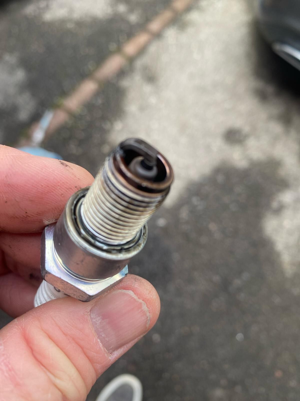

Hi guys, I think I'm getting close to the sweet spot, but not sure if I'm a little lean. Drilled air filter, my stack is now - 140/BE4/122 main jet with a 55/160 idle, 2.5 turns out on the mix. It starts great and ticks over well and goes like stink. I'm unsure if I should be using a BE4 or should I stick to the BE3, does this stack look ok, Is there anything else I need to do? Any advice on setting would be appreciated.
I've attached a couple of pics of my spark after a good run.
Cheers in advance.
Cheers in advance.
To test the main jet is near correct, hold the throttle wide open on the stand. How high does it rev? Fit a 128 jet, how high does it rev now? If the 128 revs at least 1k less, then the 122 is about right.
The atomiser is best decided with throttle response. Ride around at 30/35mph, open the throttle a touch. Did it pull, bog, cough, splutter? If it didn't immediately pull it needs attention.

I can't WOT it as I'm running it in, only done 50miles when I run at a steady 40 is pulls nicely if I open up the throttle and starts to slow if I pul the choke out.
