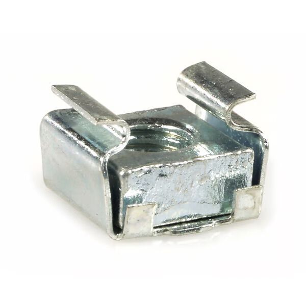

Back brake pedal overall as it is sticking.
After removing the two bolts on the brake pedal (engine side), the solo one on the other side is loosening but will not come out. Now when I try tightening it up, it won't fully tighten either. Is there something I am missing regarding removing the pedal?

The left bolts screws in an M6 caged nut. They tend to seize and then rotate in the cage. If it's not going back either, cut the bolt's head and then replace bothโ€ฆ
