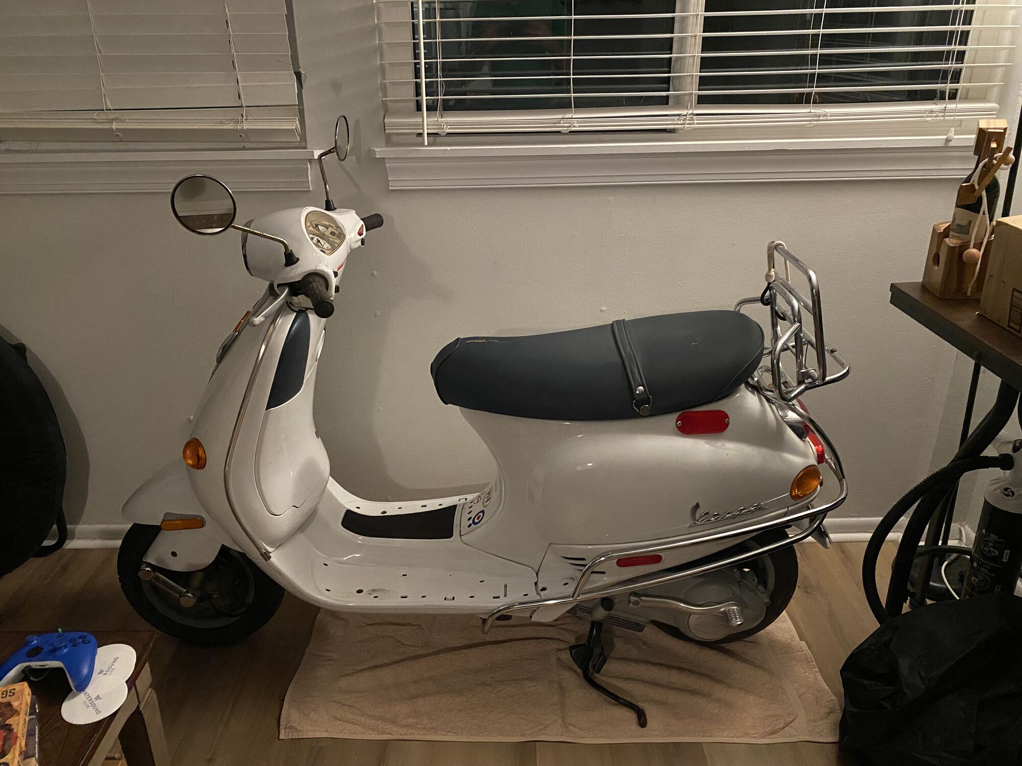

Here are a couple pictures of her - I've named her Perla. She's going to be a beach cruiser/commuter here in FL.
She got a bath and she's been moved into my living room (up three flights of stairs lol) and I'm starting her rehab.

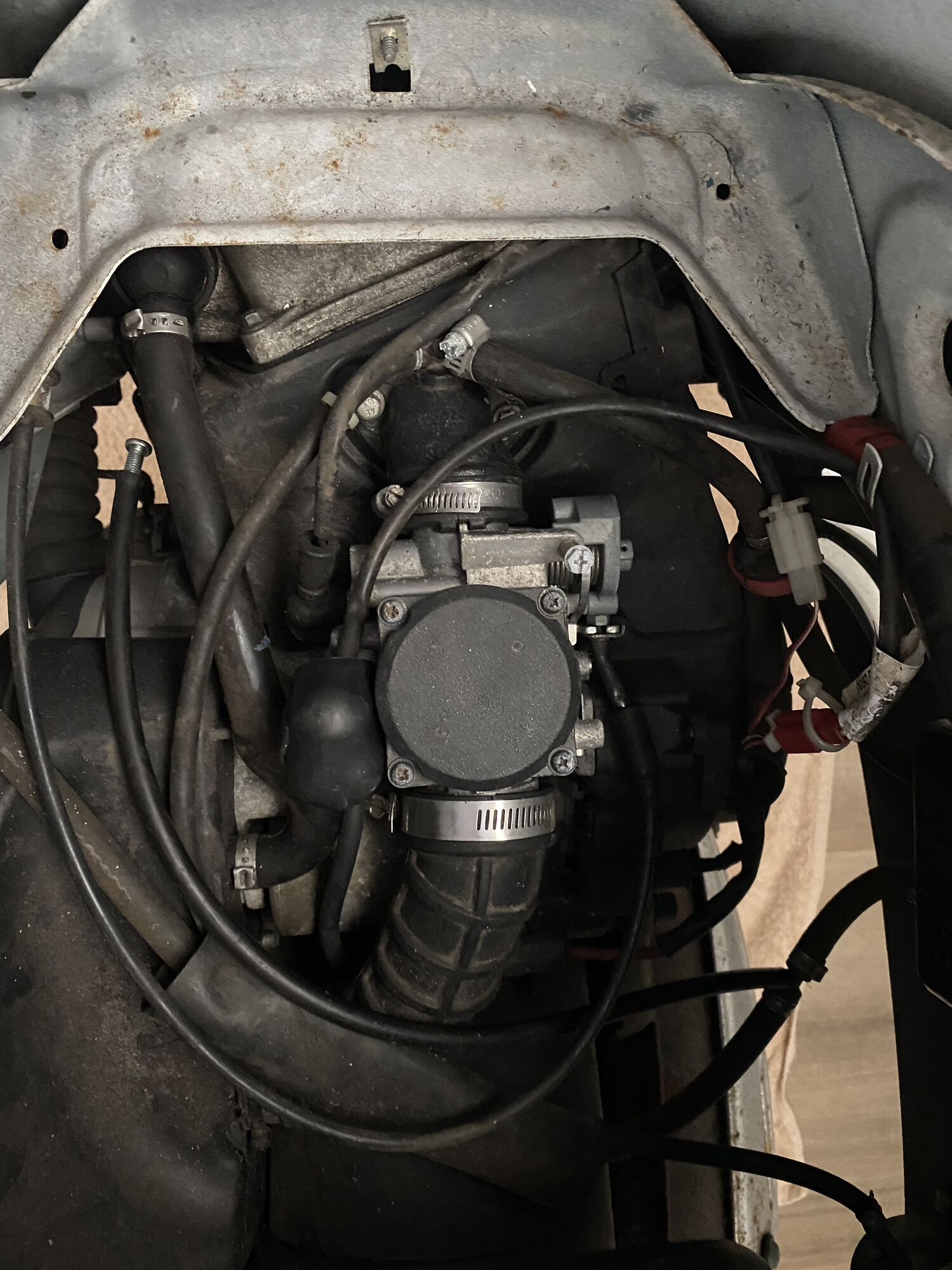

Getting ready to remove and clean the carb - any tips/tricks/things I should know? Why is the vent line(?) capped with a screw?
Somebody nixed the EVAP system. There are cleaner ways to do it, but if it works.....?
The fuel lines are 3/8ths, correct?
3/16ths fuel and vacuum lines. Remove the vacuum line and all the extra tees, etc, and run one line directly from the bottom outlet of the fuel tap to the vacuum inlet on the intake manifold. If you need a new Intake Manifold, consider getting the European one with only one vacuum connector. If you don't, go ahead and plug one of the outlets. Run the other line directly from the tap to the carburetor.
Make sure the fuel tank is vented. Sometimes people don't do that when they disconnect the evap system. If you are unsure, go ahead and put a straight pin hole through the O on the gas cap.

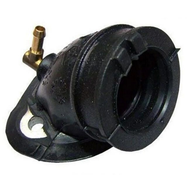

https://scooterpartsco.com/et4-air-and-fuel-c-3637_3640_3734/intake-manifold-for-vespa-150-single-vacuum-line-p-9213.html

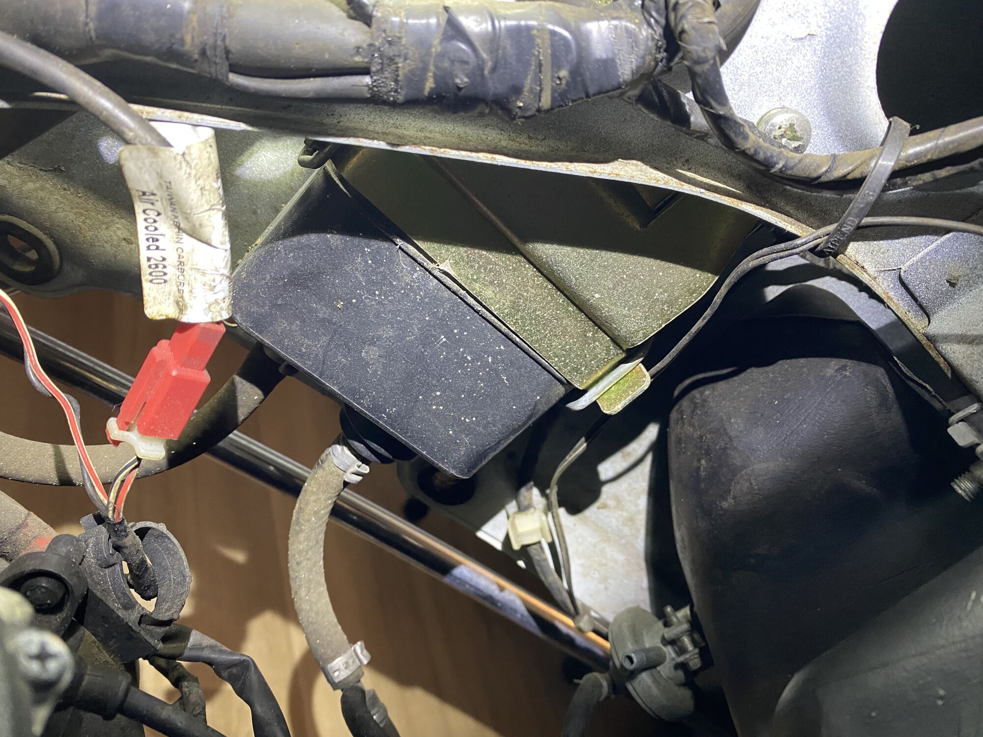

What is the big square box that has two hoses coming out? (See pic) can I bypass everything else in the evap system and just use the two lines described above?

the big box is the charcoal canister. one line runs up to the manifold, you can remove that and cap the vacuum port on the manifold fitting. or if you upgrade to the new manifold it doesn't have this provision, so you just have a small fitting to run the line to petcock.
correct, vacuum on the bottom, fuel on the top for the tap.
removing the evap line that runs to the carb and attaches just under the diaphragm cap eliminates all the evap stuff from the equation.

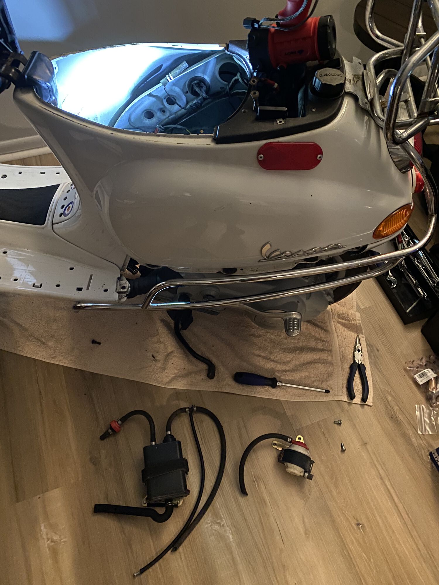

Well, I'm off to a rough start. Perhaps foolishly, I did not order a new petcock, I was hoping to use the one on there as it looks like it's very clean, and I was going to use a fuel filter to prevent any potential contaminants from getting in. I put on some fuel line to start draining the gas, and as soon as I did the petcock started leaking near the top.
I managed to get the gas all out of it, but now I'll need to replace the petcock unless I can somehow reseat that one to prevent further leaking.
Greasy125 recommended a new one, is there a reason not to use the old one (other than its old and might be gummed up)? Is there a trick to sealing/installing a petcock?
In terms of venting the tank, I saw something about drilling a small hole in the gas gap. Is there a better way? Has anyone plumbing in some sort of vent line? My dirt bike has a breather tube out of the lid that prevents stuff from getting in, how doable would something like that be?
Also, given that its a suction system, if I remove the evap and just do the two lines will a fuel filter cause me any issues?

Evap system is out!
Manifold comes tomorrow - carb clean, battery install, fill her up and see what happens.
I also pulled the petcock and cleaned what I could. No visible issues with the O-ring so I put it back in and am hoping for the best.
Fuel tank vent was cut off the evap system leaving the hose as long as I could, then the hose was zip tied to the frame rail that the evap was mounted to.
Unrelated . . . what's the best way to wash a gas-soaked tablecloth towel
I always recommend a new tap because the diaphragm is known to fail internally and then it's stuck in the "on" position. or, the "off" position or works intermittently and you chase your tail on a fuel delivery issue. the o-ring can also become compromised over time.
it's just good practice to refresh it when you do a complete fuel system rebuild.
as you found out the ET has a port off the filler neck, that runs down to the roll over valve. clip that and zip tie it up somewhere out of the way and directed so that it won't leak on something critical if accidentally overfilled. problem solved.

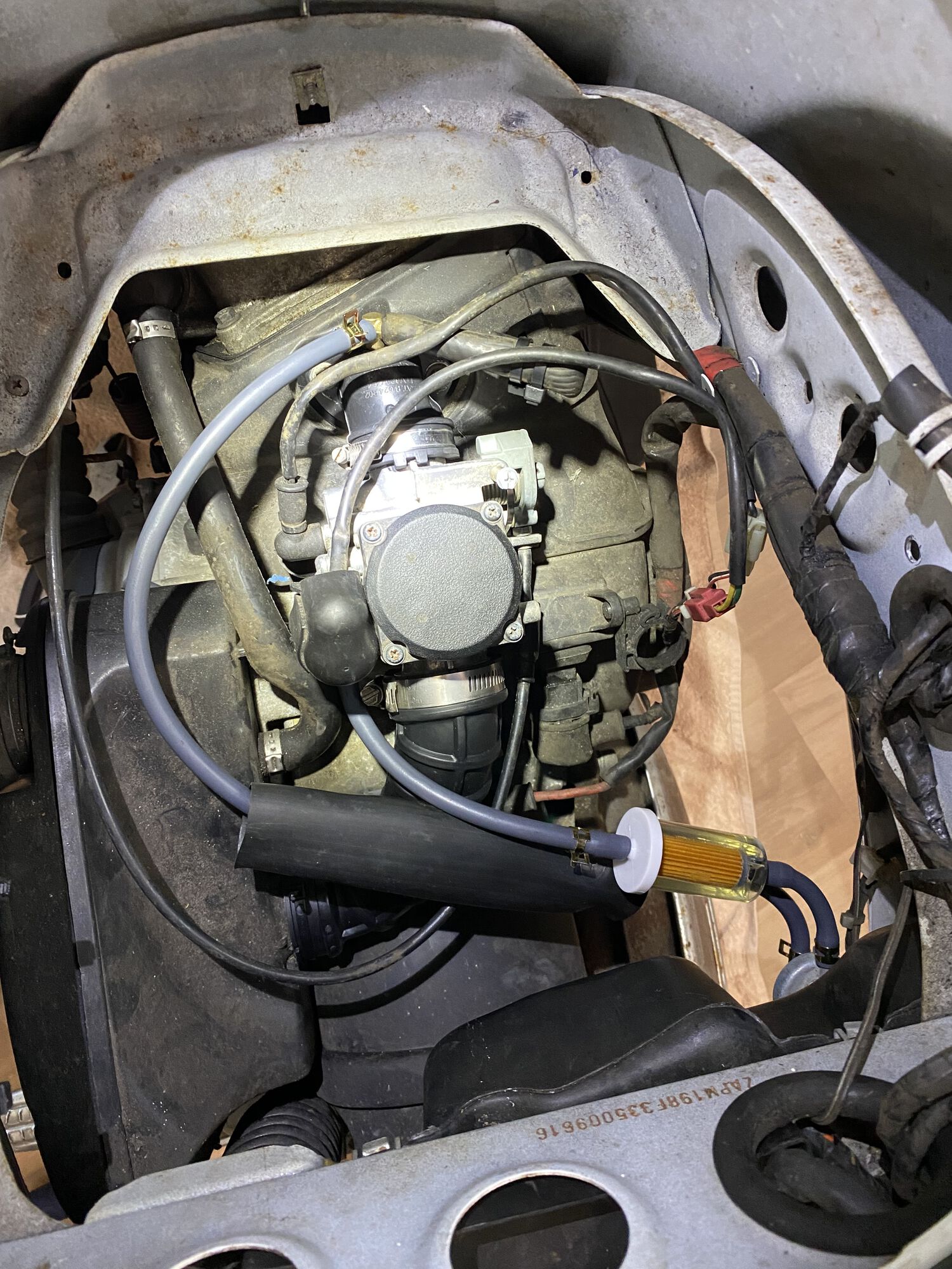

Yep, riveted reflectors all over her.

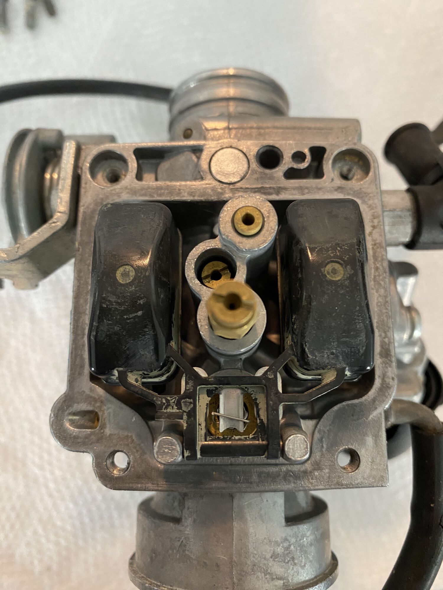

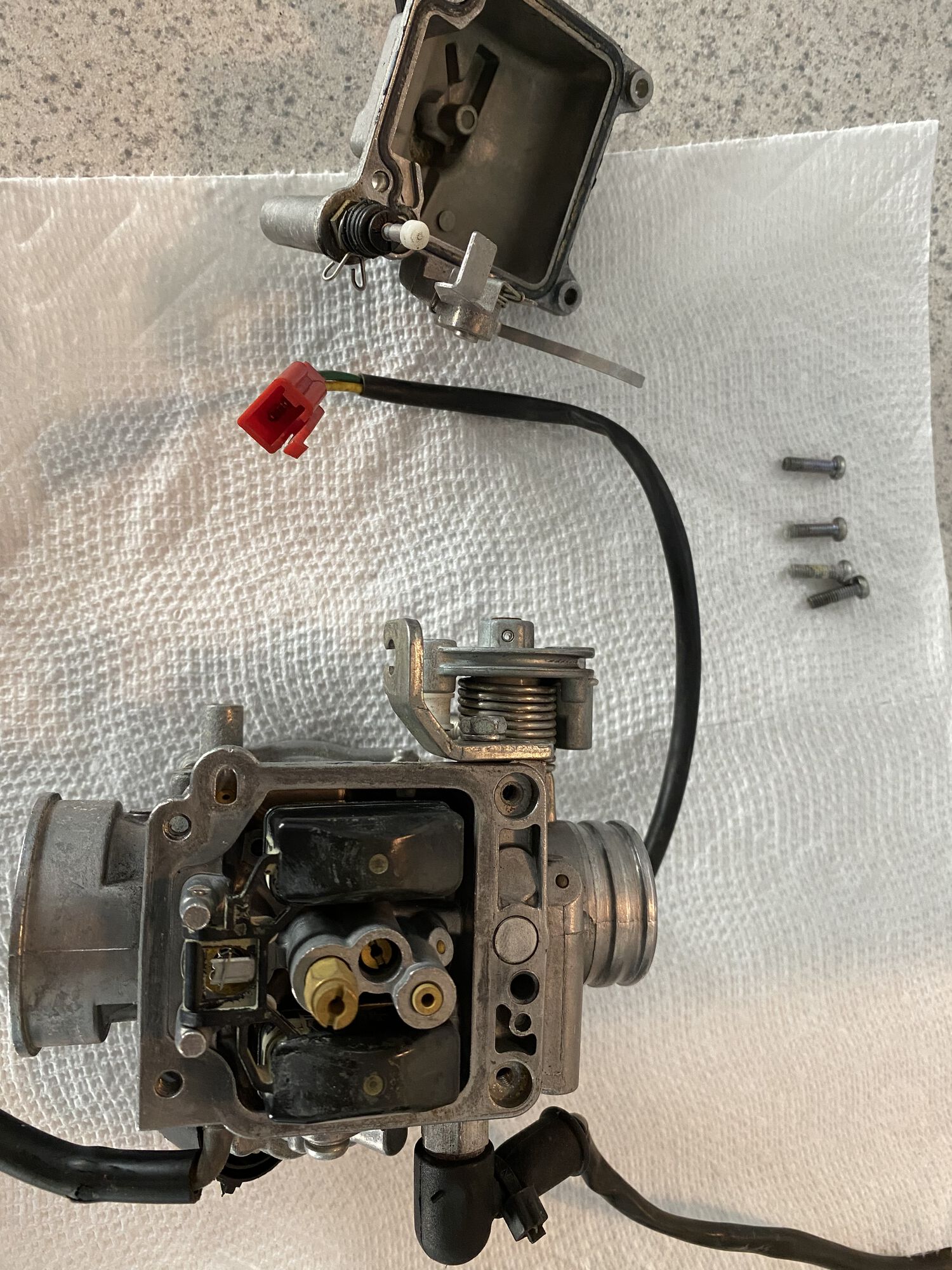

Carb was removed, air boot and manifold replaced (both cracked).
Carb was cleaned, was is pretty good shape. Wish I had a new seal for the bowl but unfortunately didn't. Pilot jet 34, main 82.
Fuel/suction lines plumbed, battery is on the charger. Time to see if rubber meets road.
Hoping I plugged everything into the right places lol

Two issues:
1. The 'Piaggio' light was blinking intermittently. From poking around a bit, this is not the check engine light (?) but the immobilizer, and it was indicating 'all is well' - does that light always blink? Even after its off/key is out?
2. The fuel filter was bone dry. I primed the filter and carb before I fired it up, but after the ride the filter was empty. I took off the vacuum tube and sucked through it and no gas would fill the fuel filter. What gives? That's how I originally primed it...
light blinks for 24hr after shut down. on start up, one blink only. any more than one blink and there's some type of ignition fault. (don't worry about it and leave it to be a bridge crossed later)
don't worry about it, the fuel will flow once the needle valve opens in the carb. it's not like a traditional set up where the pump is forcing fuel into the line and thus the filter. also, the fuel tap has a filter so I rarely recommend running a filter.

New tires are finally on.
However now the motor keeps cutting out. It starts right up every time, even after it cuts out.
I thought perhaps it was a fuel problem caused by the fuel filter I had on, so I took that off, but the issue persists. What could it be? Seems fuel related.
I did the evaporation system delete, so I only have one line, running from the petcock to the manifold, and another from the petcock to the carb.
I ordered a new petcock and it has a cover for the evap line. Is it possible to not have an evaporation line?
It is an intermittent but persistent issue where the engine stumbles at idle or while cruising. Always starts back up though.
It's also really hard to push - I feel like it used to glide and now it doesn't want to roll freely, even when it's off. The front wheel especially will not spin if I'm not actively forcing it. Tons of drag/friction. Could I have made a mistake installing the wheels?
Plz help

Are you running fresh fuel?
What do you mean about cap for the evap line? I can't see any reason why a petcock would have evap parts. They often come with ports capped to keep dirt out in shipping- could that be what you mean?
There is definitely something wrong with your wheel, as it should turn freely. I mean, some light dragging on the disc brake, but not a struggle to turn by hand.
2003 ET4 - 187
Posts: 12
2003 ET4 - 187
Posts: 12
Fuel is fresh, ethanol free 87.
Now that I think about it I wasn't having issues when I ran 93 at first. Hmmm.
I think the disk might be dragging but I'm not sure why that would've started happening after a tire change? The rotor isn't on the wheel or 'involved' in that process at all…?
