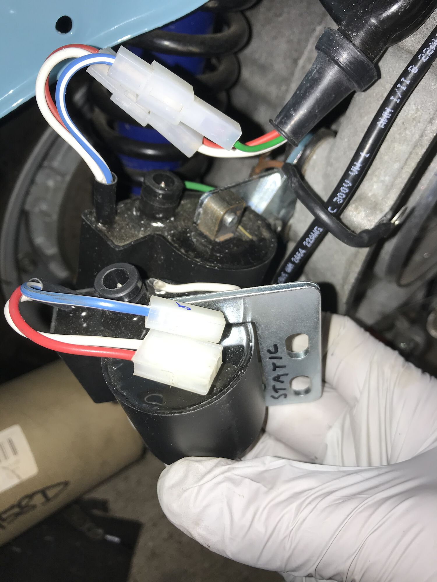

Just like the title says...VAPE ignitions, static vs variable timing. When SIP first introduced the VAPE kits, the variable timing version seemed to be the hot ticket for all engines (both stock and tuned). But for the past few years or so, it's appearing like the static timing is a better choice for most engine build applications. But at what point does one decide between installing a static or a variable ignition?
There's many different states of largeframe tuning, such as-
-stock
-long stroke stock (60mm crank)
-O tune (either with a 57mm or 60mm crank).
-Malossi 210 sport
-malossi 210 MHR
-Sito + type box exhaust
-chambered type box exhaust
-expansion chamber racing exhaust
Then there's smallframe tuning as well..
So at what point is a variable ignition beneficial?...or required?
Cases in point. Should i be swapping out my variable CDIs for a static version?
I have a P208 (stock cylinder, stock porting), 60mm crank, 24/24 oil injection, SIP zero squish head, JL right expansion chamber, SIP, VAPE variable.
PX210 Malossi Sport (non ported), SIP Viper exhaust, rotory crank, 30mil Dellorto carb. HHP variable CDI.
Pink smallframe (with a largeframe 200 installed), 24/24 oil injection, full O tune, SIP zero squish head, PM tuning Up and Over expansion chamber, VAPE variable.

So let's revisit my most current engine then...P208 (stock cylinder, stock porting), 60mm crank, 24/24 oil injection, SIP zero squish head, JL right expansion chamber, SIP, VAPE ignition.
I have both a static and a variable VAPE CDI in my shop. So it sounds like i should proceed to use the variable CDI then? If so, at what RPM should i set what degree of retard? I don't know too much about the JL right, but i'm going to assume that it will rev up to around 7500 rpm? The cast iron cylinder is has NOT been ported. I'm guessing there should be just under a 74mph top speed?
