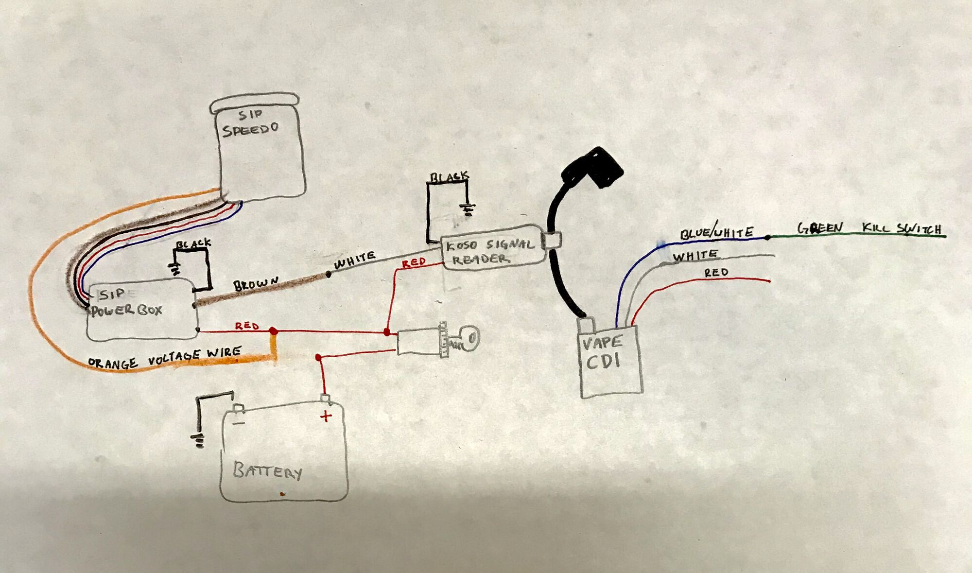

The included instructions that SIP provides can be a little difficult to interpret. I also used a Koso rev signal reader with my SIP speedo.

The "power box" is where the voltage power control circuitry is located. 12 volts into the box and 5 volts coming out the other side to the speedo unit.
