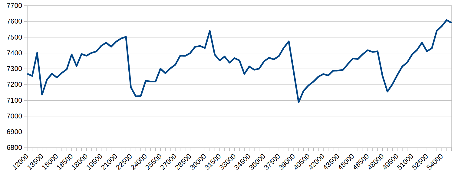

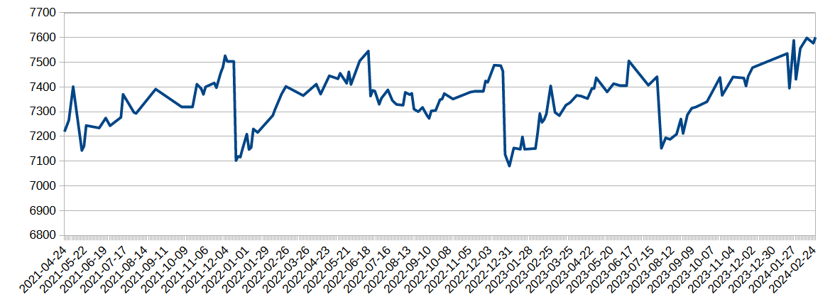

TL;DR Definitely time to order some new parts
Ain't this a fun graph of 42,500km of data recorded on my Supertech.
Graph is RPM @ 100kph (gps not dash) averaged over 3 day intervals. Filtered to only include above 105 as the variator should be fully maxed out by about then. EDIT: added 2nd graph which is vs Odo instead of vs Date
The distinct drops are replacements of combos of belts, rollers, pulleys. See May/2021, Dec/2022, Jul/2022, Dec/2023, Jul/2023.
I'll probably write some more about this later ...
vs date
vs date
vs odo
vs odo

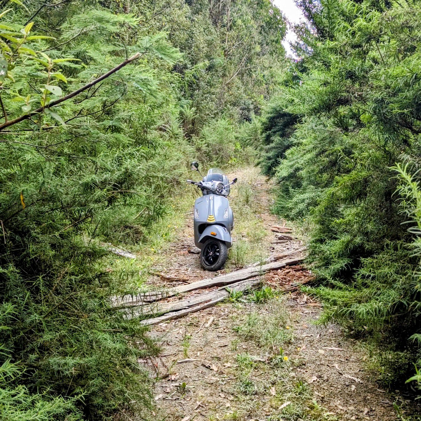

I am pretty hard on my scoot. I'm hoping it makes it until I get the new bits.
Mind you, I'm not always riding at high speeds. Eg a couple of days ago I was bouncing over logs and pushing though bushes.

Looks like belt wear over time. Belt get thinner so doesn't travel as far up the driven pulley.
Posts: 8390
Posts: 8390
Significant but don't underestimate the contribution of the rollers (flat spots) or the wear on the pulleys themselves (my front pulley current has .4mm wear on the var side and .3m on the fan side = .7mm wear ...)
Eg look at the mid 2022 drop - that was belt+ rollers but no pulley change

Very interesting. What does "filtered to only include above 105" mean?
RPM at 105kph, rather than 100kph?
That mid-2022 drop where the pulleys weren't changed CONTINUED to drop for a while. Then, presumably, the belt/roller wear "caught up"?
Perhaps sliders slow these effects a little bit?
Posts: 8390
Posts: 8390
Juan_ORhea wrote:
What does "filtered to only include above 105" mean? RPM at 105kph, rather than 100kph?
Although the filter is 105 the result is @100 because all data points are scaled.
Source data is 32 million rows. After filtering to only include >=105 I get 470,000 rows. For each row RPM*100/KPH is calculated. Then rows in 3 days buckets are averaged together resulting in 139 rows. This is then graphed.
In mid-2022 the service items are a bit more complex than the other intervals as during jun/jul I was testing 12g, 13g, 14g rollers plus belt change. the further drop in aug was replacing the drive pulley. Then dec was belt, rollers, driven pulley.
Regardless the trend of the overall graph vs service.
interesting thought.
Although it's the importance of the wear on the pulleys that I suspect many don't think about

So after a CVT service, the Vespa needs less revs (about 400 less) to maintain the same speed.
That must also suggest a change in fuel economy every time the CVT is serviced?
@madison_sully avatar
Posts: 7700
Location: Madison, Wisconsin
Posts: 7700
Not necessarily. Maybe, maybe not.
There is a change in geometry, sure. But does that change in geometry make anything more efficient?
I used to track my miles per gallon rather religiously on Fuelly.
Never did notice any change when a new belt was installed.

Looks like you ride a fairly consistent amount each week but it would still be interesting to see miles or kms on the x-axis rather than time.
Also it would be interesting to see this data with (1) one component at a time changed, so the contribution of each component to the rpm drop could be more specifically attributed, and (2) with tire changes marked on the chart - shouldn't tire wear have at least a little to do with rpms at high speed?
It is intriguing that the rate of the wear is so consistent across each period, and appears to be pretty linear each time although I suppose one might infer some convexity (ie, the rpm increase tapers off a bit). You used the same components each interval? Znomit's idea of pressing on and seeing if there was some indication before the belt fails is fun to think about as long as it's somebody else's equipment.
I'm guessing the variations in this data exist because your >105 filter captures some speeds that are barely above 105, and plenty of speeds that are well above 105, so each data point will reflect a different mix of >105 speeds. Would this look different if you further constrained the upper speed to <110, and/or did another chart of speeds between 110 and 115, etc.?
ok, will do.
yes ...
.. but the big drops were when changing cvt components which is not the same times as my tire changes (mostly not)
Juan_ORhea wrote:
I'm guessing the variations in this data exist because your >105 filter captures some speeds that are barely above 105 ...
no as explained above. the calculations are ratio of rpm vs speed. not absolute values of rpm.
done. added it to first post
