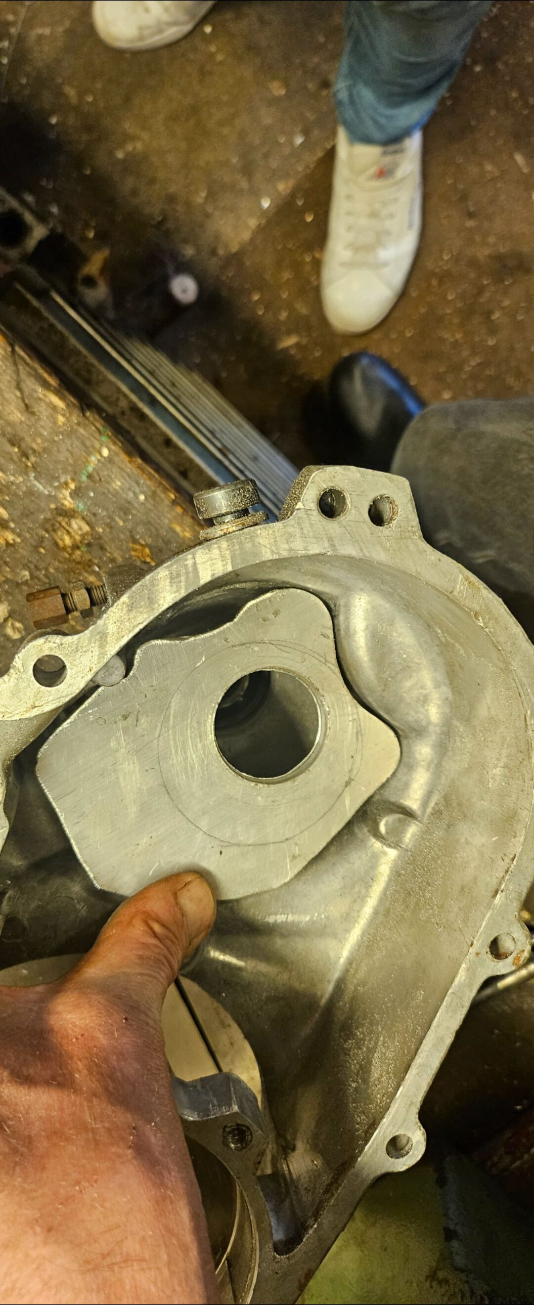

The DR, like most of the cylinder kits you see, has 3 ports. This 3rd port will possibly hang out over the engine casing and be unable to be sealed without a fair bit of work (usually welding).
Some cases are flat in this part and could seal, but it's been my experience so far that the earlier cases like yours usually only have a thin sealing surface.
If you have a 3 port base gasket, try it on your case where the cylinder sits. I think the issue will be pretty obvious.
The 2 port Pinasco is made for cases exactly like yours, and they do go well.

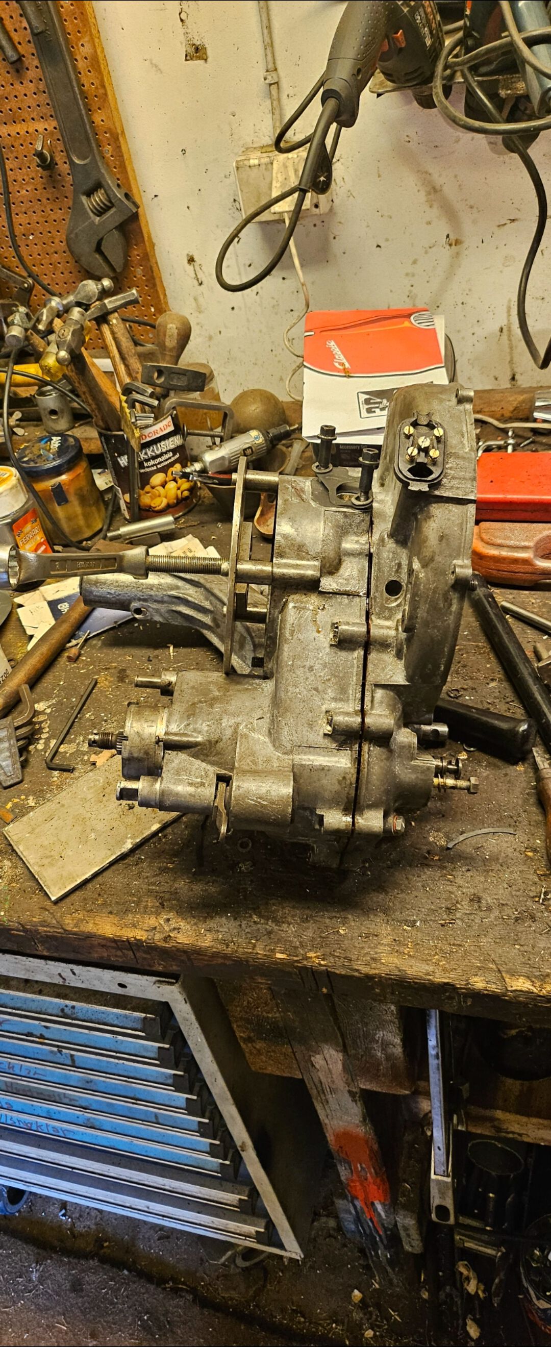

I fill up with another question, as we speak about the cylinders.
I read that some where speaking about the "squish".
I made my homework and understand the principle.
Some says that you got to much squish with the Pinasco, cast iron and that ideal squish should be about 1,5mm.
Any ideas about that?

The "ideal" squish varies from motor to motor and is dependent on lots of things... this below from Jack -
Jack221 wrote:
No right answer to squish clearance. Typically on an average area and turbulence head, it should be between 1 and 2 percent of stroke. On yours that's 0.6 to1.2mm. The variation depends on the angle between the piston crown and head, against the power delivery requirements.
This all only matters for the perfect balanced set up. Can pretty much bolt anything together and it runs ok.......for a good while at least.
My advice at this stage is don't get too bound up by the numbers, just try the kit and see how it goes. It's really a pre-squish era design anyway so the measurements won't tell you much.
On a basic kit like this there are a number of things you can do to improve performance, but to me it's no fun unless you know how much you've increased performance by. The head comes with the kit anyway, so give it a go.
Later if you feel you'd like to make some performance improvements - maybe after you've improved the brakes a bit! - then you could look at a head like this. It's a much more modern design and will give you the ability to control squish better to get a bit more performance from the cylinder.
At that stage you probably would have worn out your clutch and will be looking for an upgrade... and this is where the spare PX motor starts to make sense.
https://www.sip-scootershop.com/en/product/cylinder-head-malossi-mk-iii-177-cc-by-mmw-polini-dr-pinasco-177_38348610

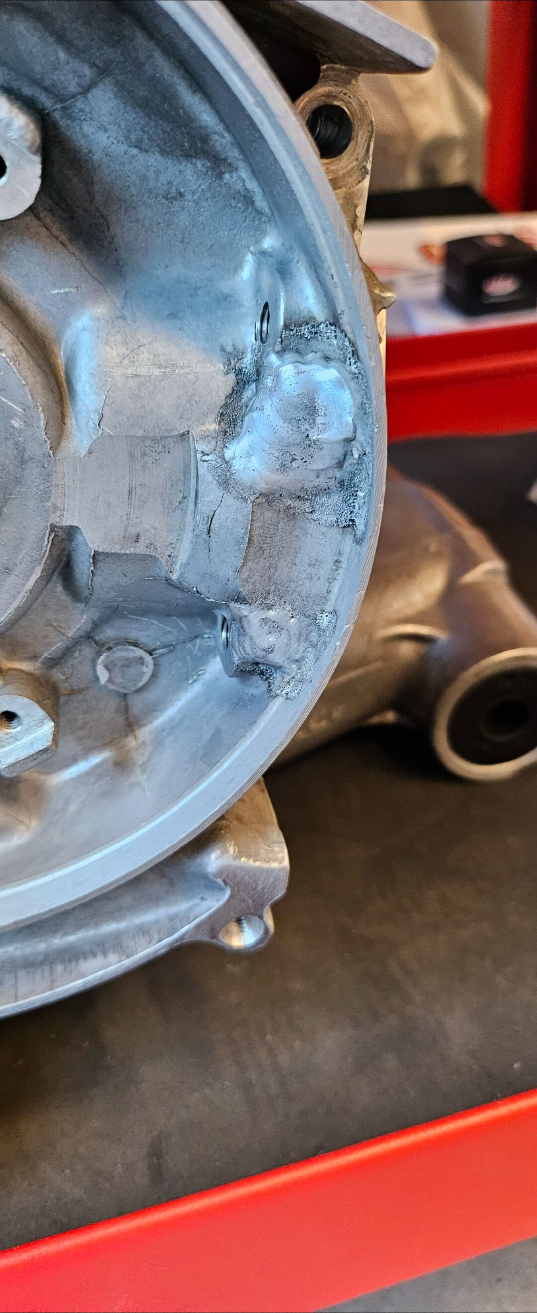

Thanks for the information!
I understand that the cylinder is older.
Seems like it has happen a lot over the years.
I am thinking a lot about my options.
I have a few alternatives as what I see it from.
Option one:
I buy the Pinasco, cast iron, cylinder. Combine it with my MAZZUCCHELLI crankshaft and a nice proper carburator and just go with that.
Option two:
I weld the engine case, so I get more surface and get the third transfer port.
That expands a lot for me with many more alternatives to choose from.
Option three:
I find a newer engine or just a crankcase from a PX.
I know Option one would be the easiest Option.
However, i think I would easily regret that alternative.
I most likely will strip the engine again...
I have been looking on ebay. I find a lot of PX crankcases for about 300usd.
They are however from india and I have no idea about the quality, or if my other parts from my old VNB would fit in a PX engine?
I would love to hear your ideas.
Regards 😊

Get off Ebayeeee!!
Open the engine and inspect what you have in there, next step.

If you want a lot more power, and changing crank anyway, the bolt on quattrini option applies to yours too.
Perhaps a question we didn't ask - what do you want out of this? Do you want to surprise motorcycles at traffic lights? Or tour the mountains? Maybe just pillion your partner around the coffee shops. All different answers.
The Pinasco will give you something that can (mostly) keep up with stock 200's. Possibly not a good measure if you have not much Vespa experience though. It's a good fit for your current motor and should be a reliable solid motor.
Jack's Quattrini suggestion is a great one, if you want pretty much the most power you can easily make on a 150 two port case. The old cases have good castings, but I think there will be a number of challenges to get everything working nicely in that case. I don't think it's a great starting point for a beginner in Vespas (although I'm going to assume that you have the skill and confidence to make it work).
A later case, or ideally a complete motor - for me - is a far far easier starting point. Parts can be sourced from pretty much anywhere, and you have choices about supplier. New designs improving Piaggio standards are being made to suit the later cases (I'm thinking Crimaz etc here). Setting up the gearbox on the VNA case to take the power is going to present some difficulties, but are not insurmountable.
I think your calendar should look like this -
- Rebuild VNA with Pinasco, finish it pretty soon.
- Ride it. Get to know it.
- Keep your eye out for a good deal on a later motor. Once you get to know Vespa people in your area, the chances of this happening improve greatly.
- Rebuild that as your really quick motor. You can fit up to (currently) a 260cc on a 150 or 200 case.
As to your other questions - no you can't use the VNA innards in a later case. Well maybe a couple of bits. Although they look very similar, early and late motors have a host of incremental changes.
Some people have had good luck with Indian cases, they made them there for years. However, I don't think that any have been manufactured there for some time now. Have a read of this as a recent example - Are these Indian LML cases any good?
LML made Vespas under licence, then started making their own design case which had a reed valve as standard and was quite good quality. They continued to make OEM parts for Piaggio until the 2000's.

Use my original motor with a pinasco barrel and then, after a while i will try to find a newer engine.
Is rhere anything else good to know about the iron casted pinasco cylinder?
Can i use a dremel to shape the transfer port in the engine case, or is it better to just leave it?

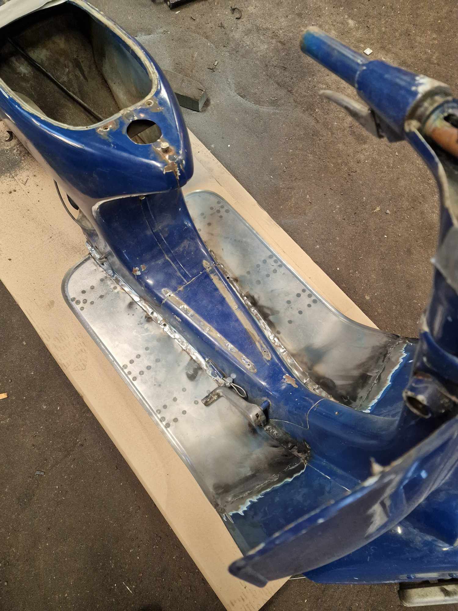

A little update!
Floor board are getting welded to the frame.
Looking really good 🙂

Looking good!

That looks great!
I just did a floorboard replacement and it was a lot more work than I was expecting. You knocked it out like it was no big deal.
