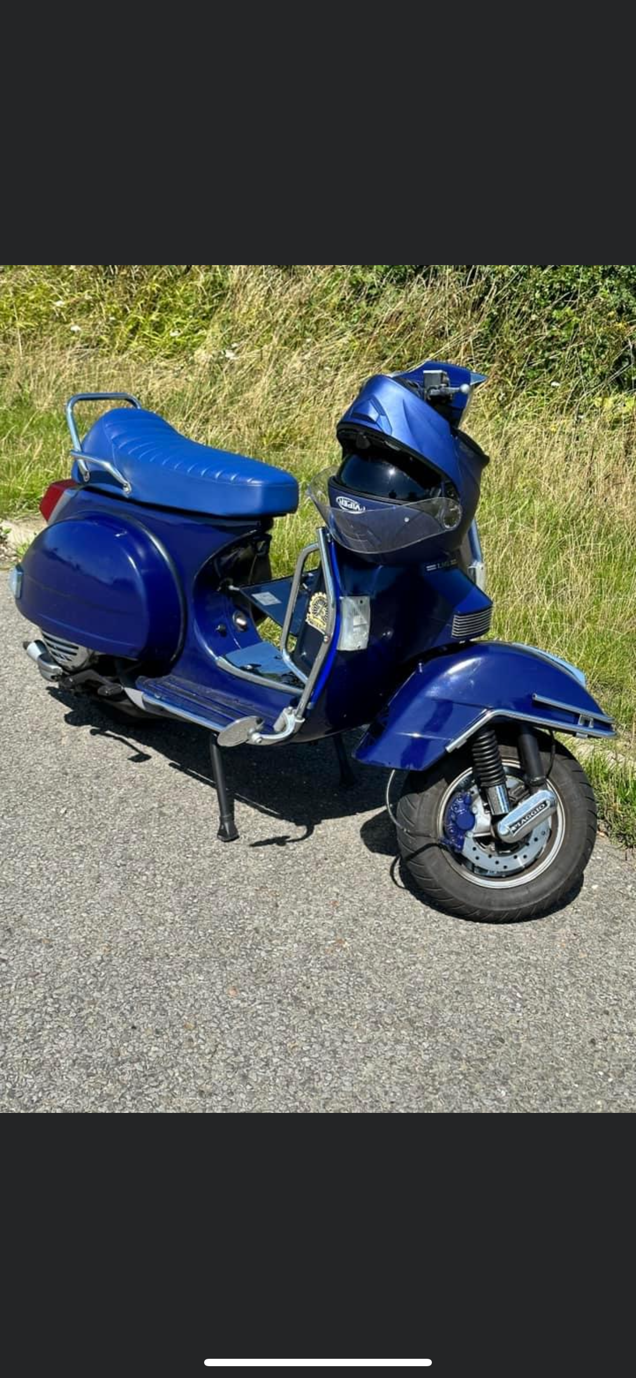

Hi all just inquiring, on my vespa every time I turn it on all the lights are flashing an indicator buzzer going constantly then stops an when I turn the handle bars it goes off again head light flashing indicator buzzer going off, I've taken horn cast off an taped up wires an taken head set an repaired wires but it's still doing it, I'm lost ?

What model Vespa is it? You have an LML in your profile...

It's a LML 2T star galaxy deluxe
Take off your switch cover on the clutch side and the throttle side look at the back of the switch. These bikes are notorious for sheering the rats nest of wires that accumulate behind the shift and throttle tube. If that isn't the culprit, take the headset top off, turn the ignition on and start jiggling wires. Since you have an audible buzzer going off you have a built in short indicator.

The wiring harness has worn through in the neck of the headset. It's shorting the positive across multiple circuits.
The LML's have too many wires jammed into the neck and wear through as a result.
You'll have to remove the horncast and headset to get to the wiring harness, then find and replace the bad wire.
I've replaced pretty much every wire through the headset on my Stella. It's the nature of the bike.

LML seemed to change the switches to opposite side of handlebars, but didn't extend the (crappy, overcooked spaghetti) wires, so they're under tension.! Complete crap!
