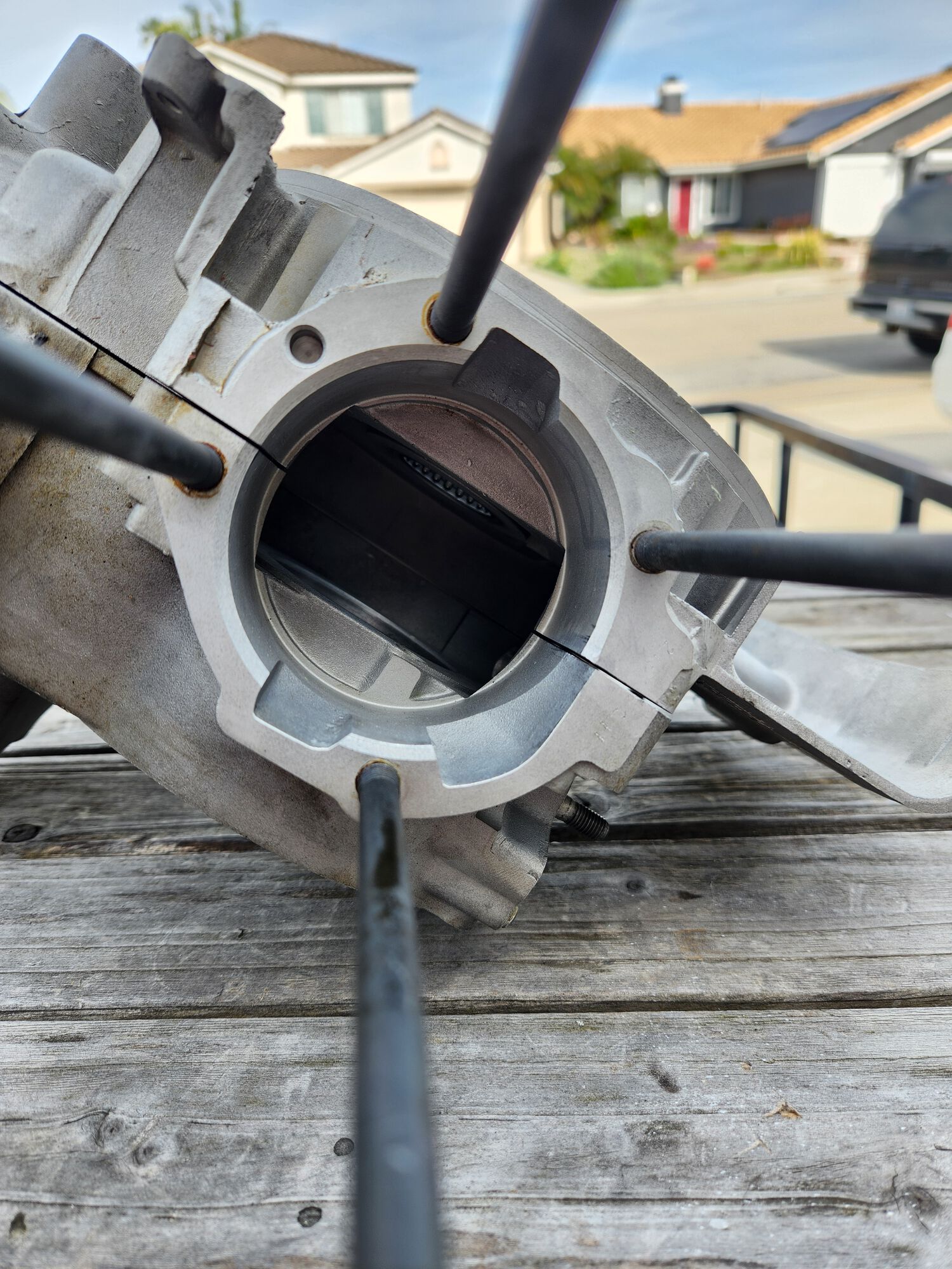

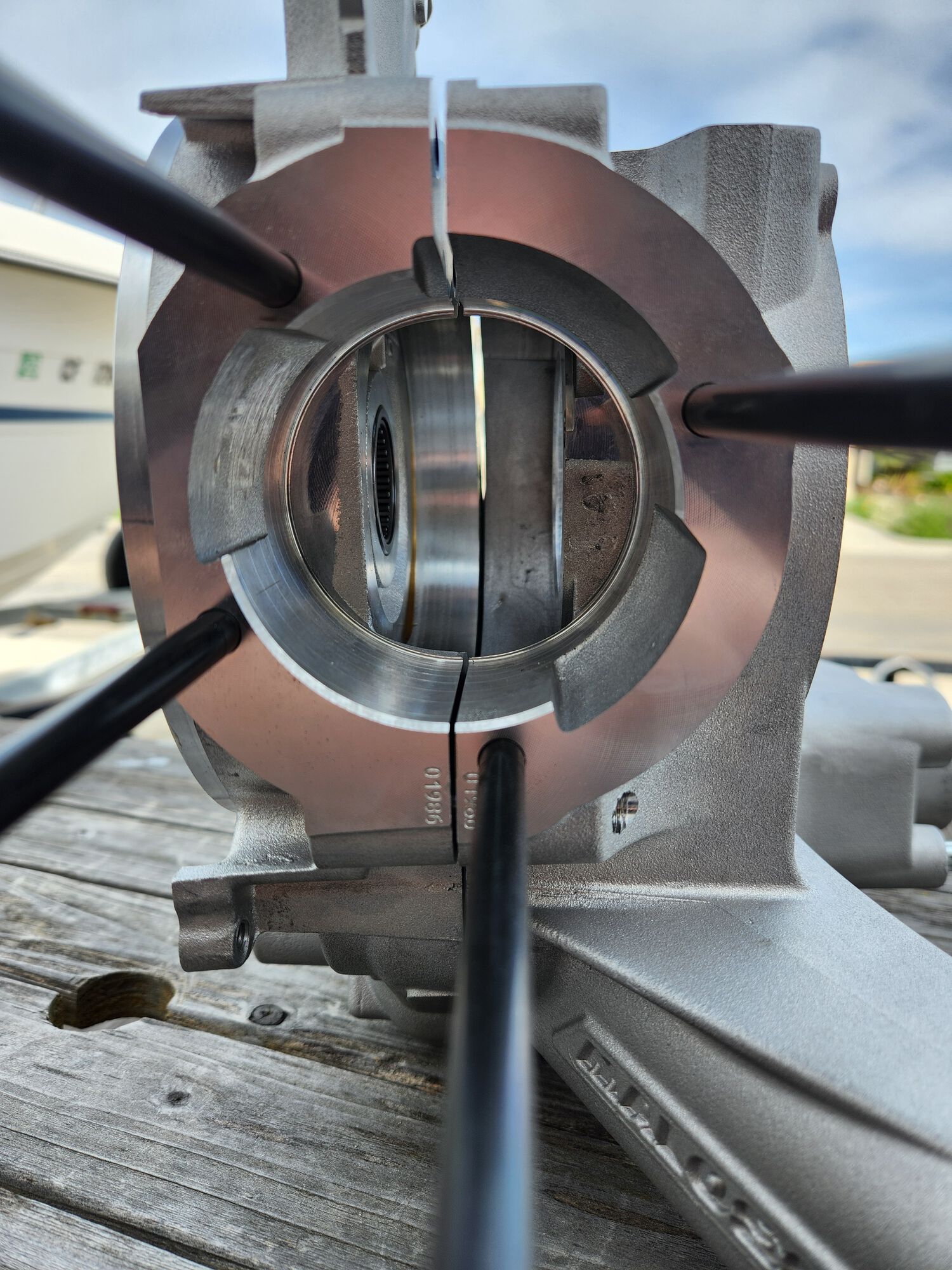

@bajarob avatar
Posts: 2212
Location: Ventura, CA
@bajarob avatar
Posts: 2212
I was also going to start another thread about what the P200 cases mouths look like.
[/quote]
Here you go, stock Piaggio 200 case.
Malossi V1 case for comparison.
