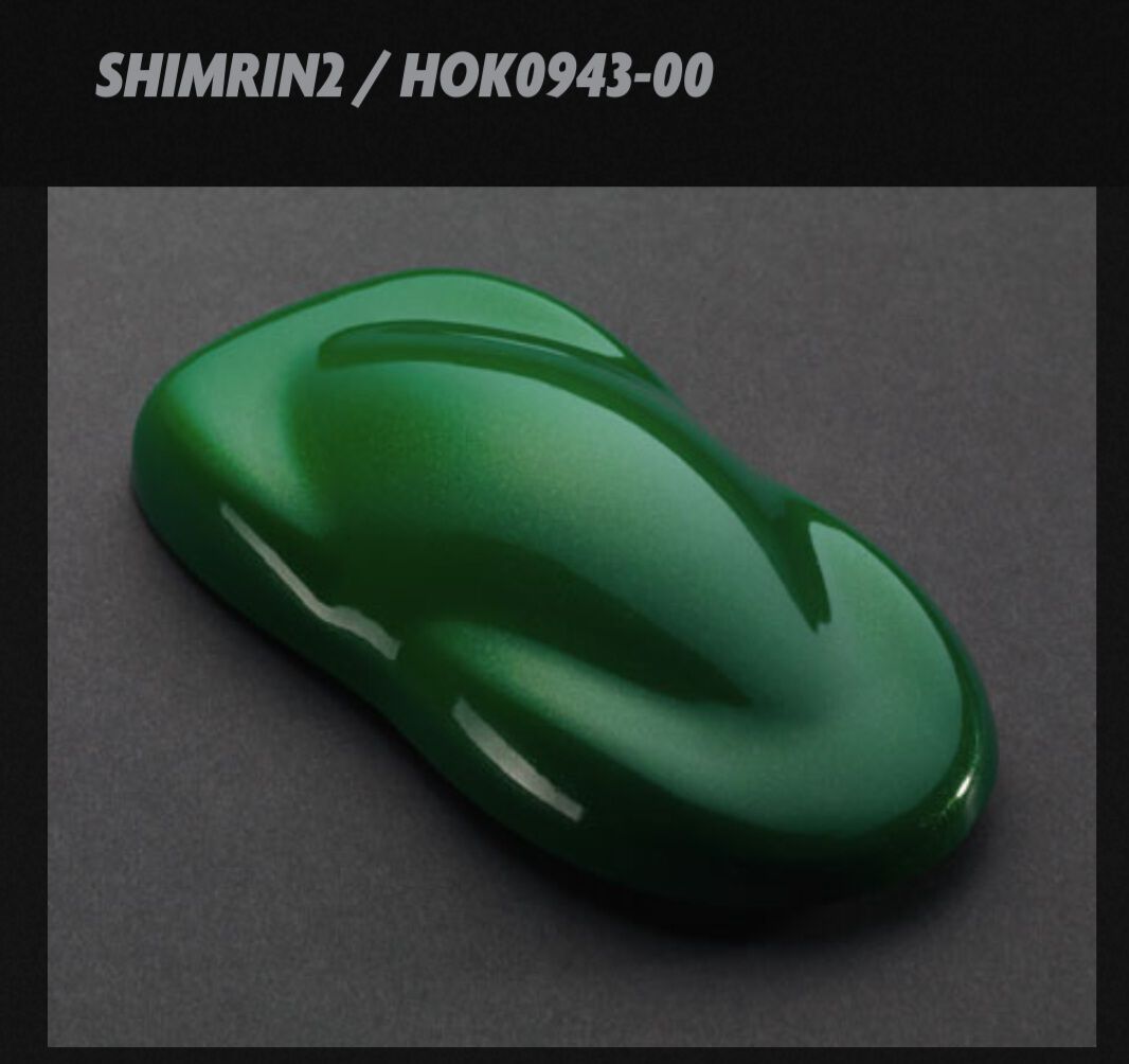

Here's some metallic greens. Last one seems too bright, leaning more towards the first one.

Thanks Ginch and Ray, I'll mod the stock breather fitting and turn it down on the lathe for the hose.
Everyone feel free to comment on the greens I posted. Your opinions matter to me. The solid green is definitely out after I showed my wife and she was right of course. She's the one who introduced me to Brian, been cutting his hair for years. She didn't like the gold hue in the second green that much.
Whodatschrome, she liked the green on your Box pic!

it's hard because it seems like the background changes brightness, making it harder to judge the difference of the greens
but it looks like it's going to be killer, based on those samples

It's never the same till you have it in hand and see those samples in the sun. Those test pieces try to give multiple different angles to help with the educated guess at least. The website pics look a little different from this posting too.
The 1993-94 Honda Del Sol was offered in a Samba Green pearl. It's kind of a bright color, and probably wouldn't look that good on something small like a scooter. There was a guy in the paint shop that painted his personal truck (late 80's toyota lowrider) with that same green...except that he decided it would be a good idea to use something like 1.5 bottles of extra PPG green pearl powder in his paint blend. It was around 10 ounces of pearl that he used, which is an ENORMOUS amount! You could paint 10 cars with that much of it. I remember looking at just how thick his cup of paint was. Needless to say the paint didn't come out that great. Mainly because he wasn't a very good painter.

the samples above are way more to the flashy than the stock P olive green, it's really about how flashy was your friend? what would he pick? keep that in mind and you won't go wrong.

🤣🤣 Brian was a plastic surgeon and didn't like anything OEM! If he could Gucci something out his credit card was smokin. I would tell him sometimes if it didn't improve performance or user friendliness maybe you should pass on that. Sometimes he'd do it anyways, regret it, remove it and we'd laugh about it. He wanted to do an outrageous red paint scheme on it. I'm not the all red type of guy but he'd love the Pickle and the flake. He would've also put the huge Bfa 306 in it if he knew that existed!
Whodat, love the pearl story! I could totally picture that. I had a friend named John who had a Del Sol like that and it seemed almost neon. He was a lumberjack sized guy and made that Honda look like a clown car.

sounds like you know the flash is the right direction, it will be an awesome tribute
