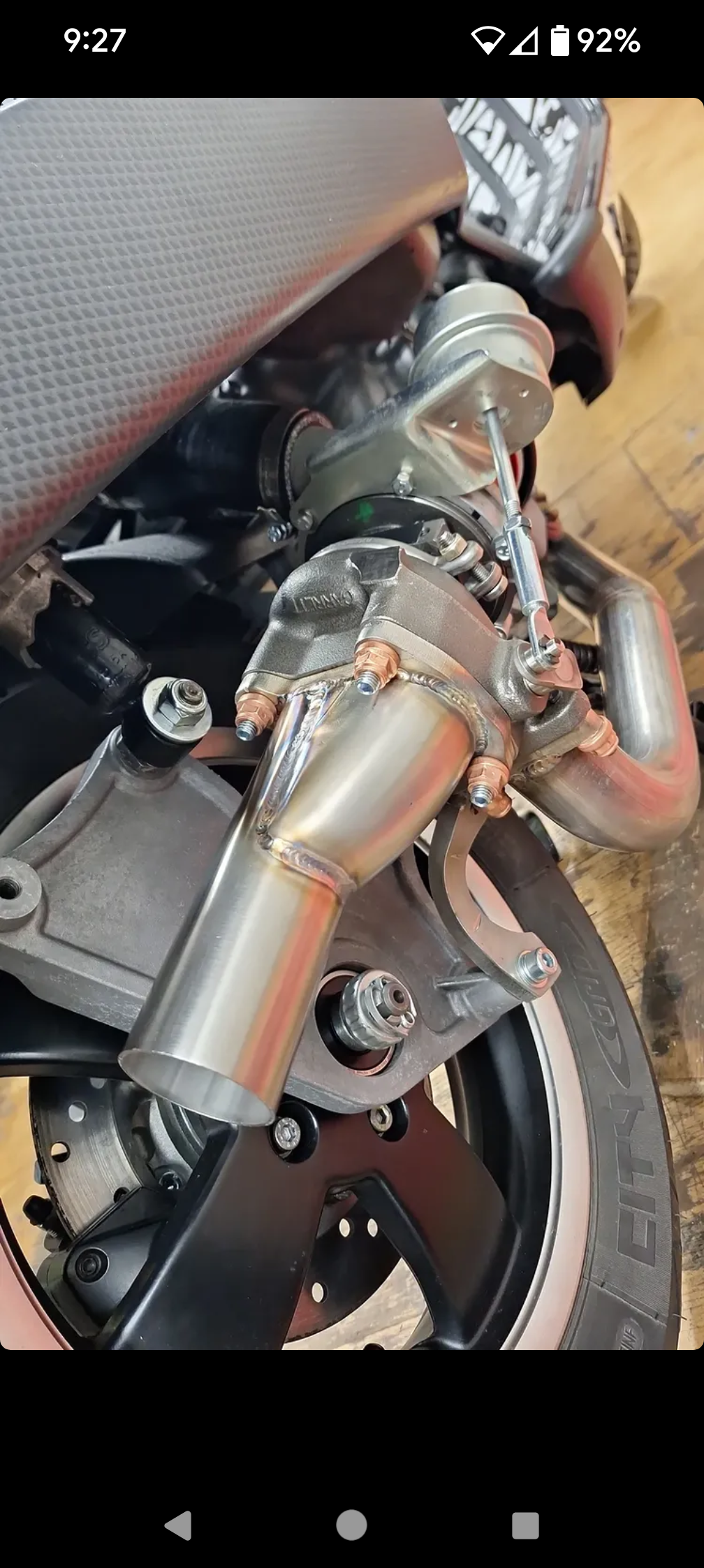

2019 GTS 300 HPE SuperTech 71,000km
Posts: 7147
Posts: 7147
Same person adding a turbo ...
(pretty sure this is on their 450 and not on a stock)
