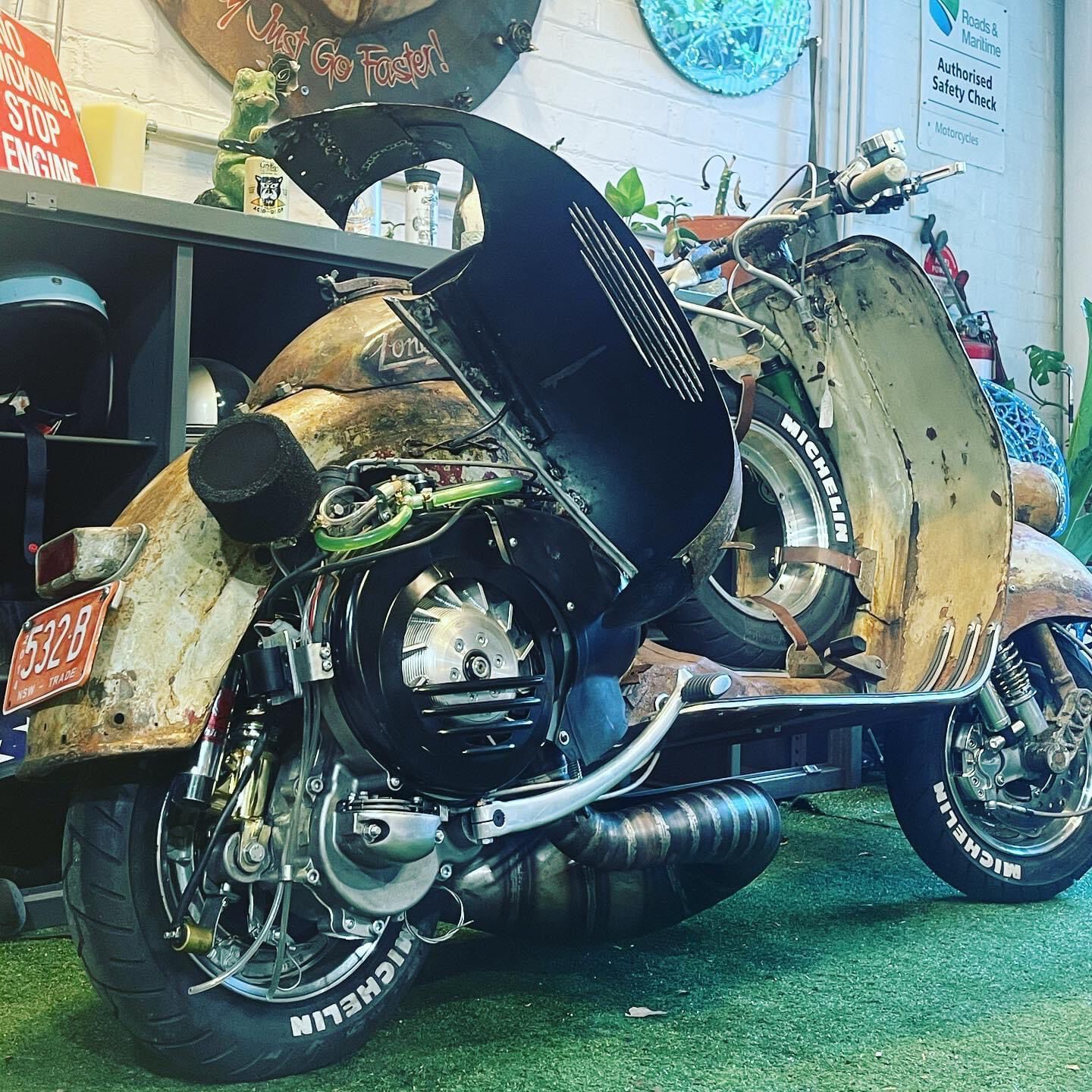

Each to their own mate. I put 10s on mine to complement my somewhat crazy 221 MHR motor. I kept all the 8" bits and bobs, so it can go back to factory at any time in the future.
One thing to note: the Super mudguard does look weird with a 10" front wheel, weird enough to make me want to swap in a Sprint or Rally mudguard, or to go the whole hog and get a set of PK forks with disc and one of those PLC Corse mudguards. Not sure I can be bothered through!

I know, I know, and if it had it's original VBC motor in (which I do have), it would definitely be back on 8s. I have fond memories of taking my daughter to school on the 8" Super, more than 15 years ago, but in recent years I had an itch to scratch.........powerful motor in sedate looking 1976 Vespa. The 200 case was already reed and had damage to the swing arm. Enter the wide wheel conversion (actually an 11" x 3.00 rear), which meant cutting back the swing arm and losing the damage in the process. Keeping an 8" on the front would have been rather comical

Cheers swa, like you say, to each their own. Love your bike btw.
