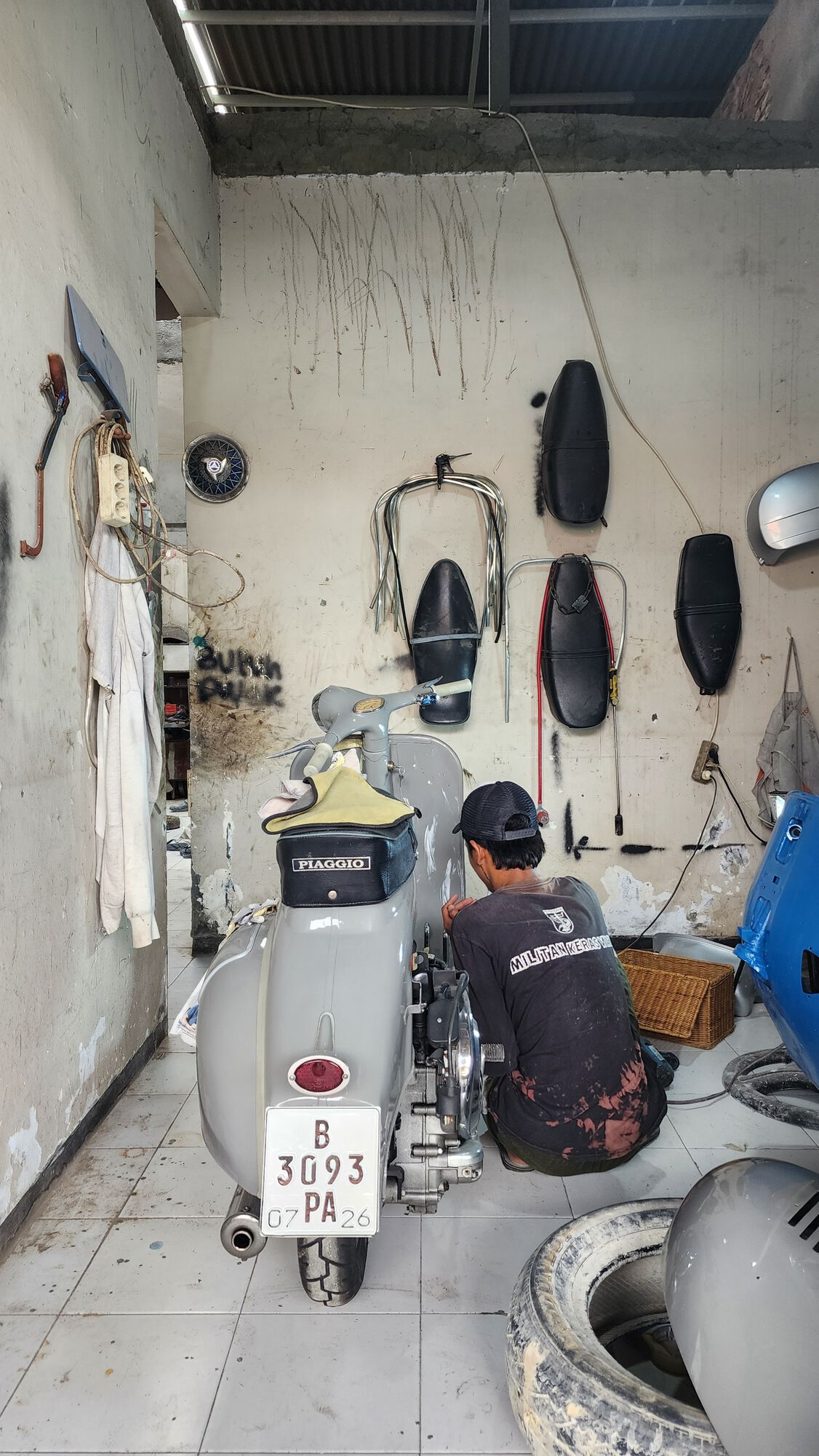

Hi guys, im building a vespa VBB2 and am currently building a vmc crono 187cc engine for it. So far ive got all the parts, custom reed valve crank case, vforce 3 reed valve, 30mm smart carb, sip ignition.
But the one thing I dont have yet is a crank shaft and con rod since vmc discontinued theirs. And im new to engine building so I dont really understand cranks all i know is i need a 60 stroke but I don't know the difference between full circle, bell shape and all the other shapes.
Someone out there please enlighten me on what crank I need haha
Heres my baby
