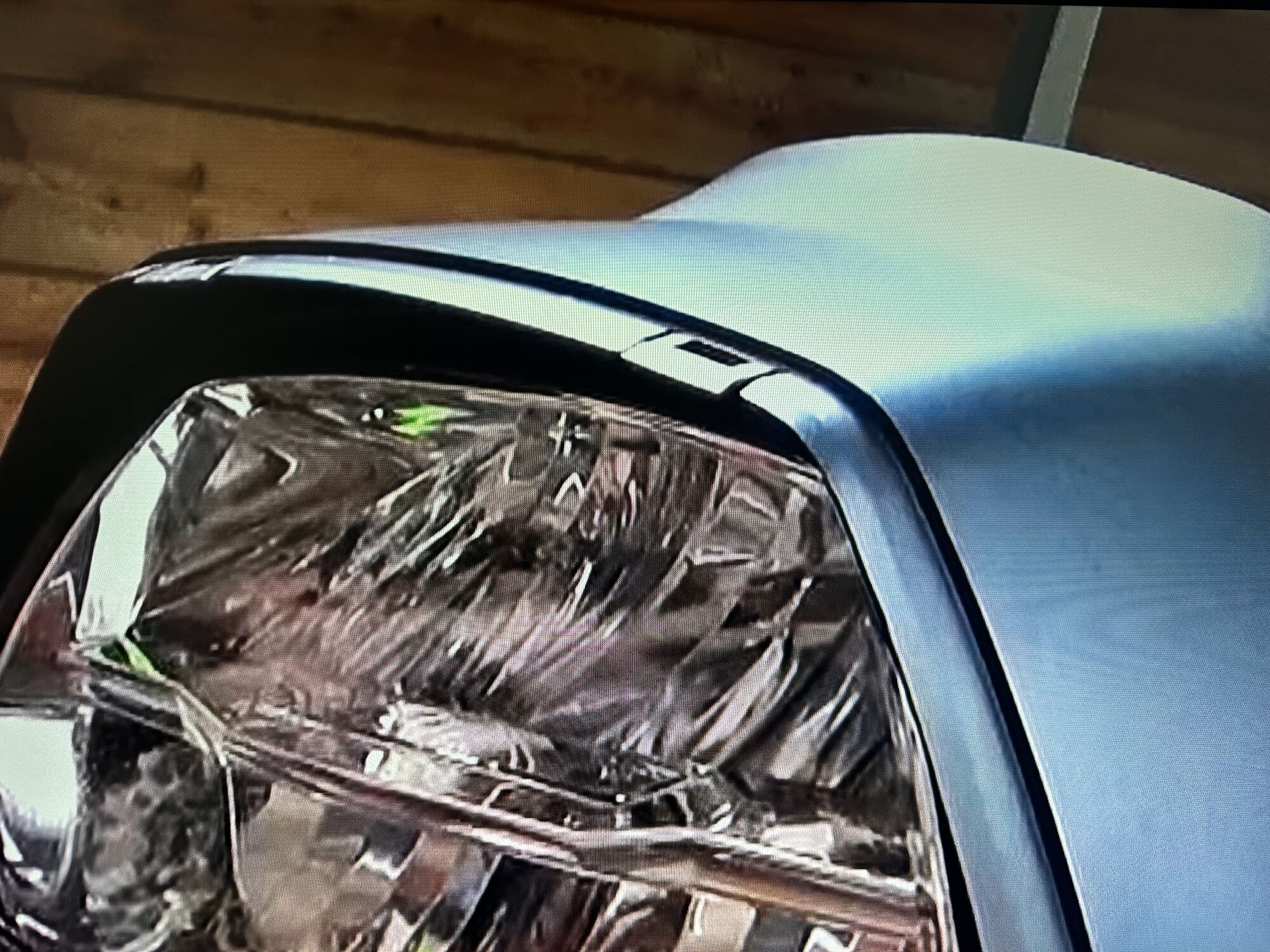

I accidentally snapped off one of the plastic tabs on the headlight that holds the headlight cover on.
I lost the piece that snapped off so gluing it back is not an option.
Can anyone recommend a workaround as the cover is being held on by one tab and shifting while riding.

It might be worth posting a picture of your dilemma. I recast broken tabs with JB-Weld. See if this helps: LX150 - New cover or can I fix this?

This channel might help
Build up the baking soda and super glue then shape the part to fit

I have attached a photo of the broken tab on the headlight to hold the cover.
