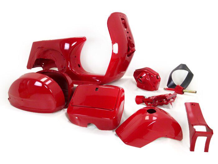

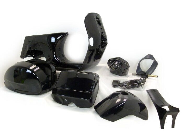

They have them in red and black...
https://www.scooter-center.com/en/frame-lml-select/t5-motovespa-t5-sport-tx200-including-mudguard-side-panels-tool-box-handlebar-horn-cover-red-767frt5rd
https://www.scooter-center.com/en/frame-lml-select/t5-motovespa-t5-sport-tx200-including-mudguard-side-panels-tool-box-handlebar-horn-cover-black-767frt5bl
