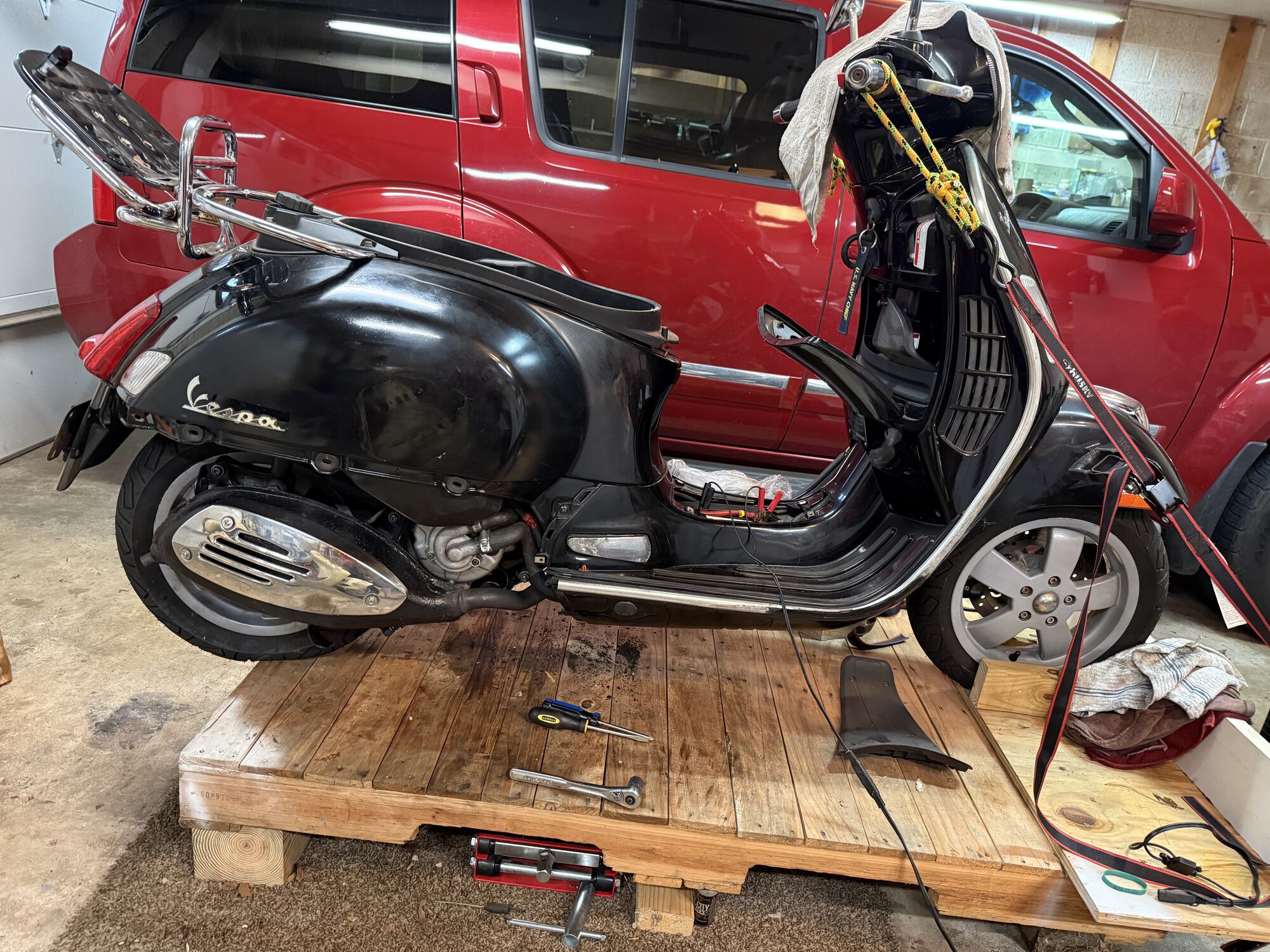

I picked this up for, what I felt was cheap enough.
New tires, battery, included variable belt and some seals, etc.
It runs nicely but has a water leak.
While I wanted an older model, this came up. I have other Italian motorcycles and some Japanese also, but after having a Yamaha Riva, and making a few trips to Italy, I longed for a Vespa.
The problem could be a water pump seal, Head gasket, cylinder, case? I don't know yet.
The metal was 'freshened up' with '#120 paper and a rattle can' in some places.
JB weld was used in others.
It's complete, save the side stand. All electrics work.
It's not terrible. It's a decent "20 footer". (Looks great from 20 feet)
I realize there's no such thing as a "free (or cheap)" boat, car, motorcycle. I like tinkering and enjoy projects so this will do.
I'll add details as I get going.

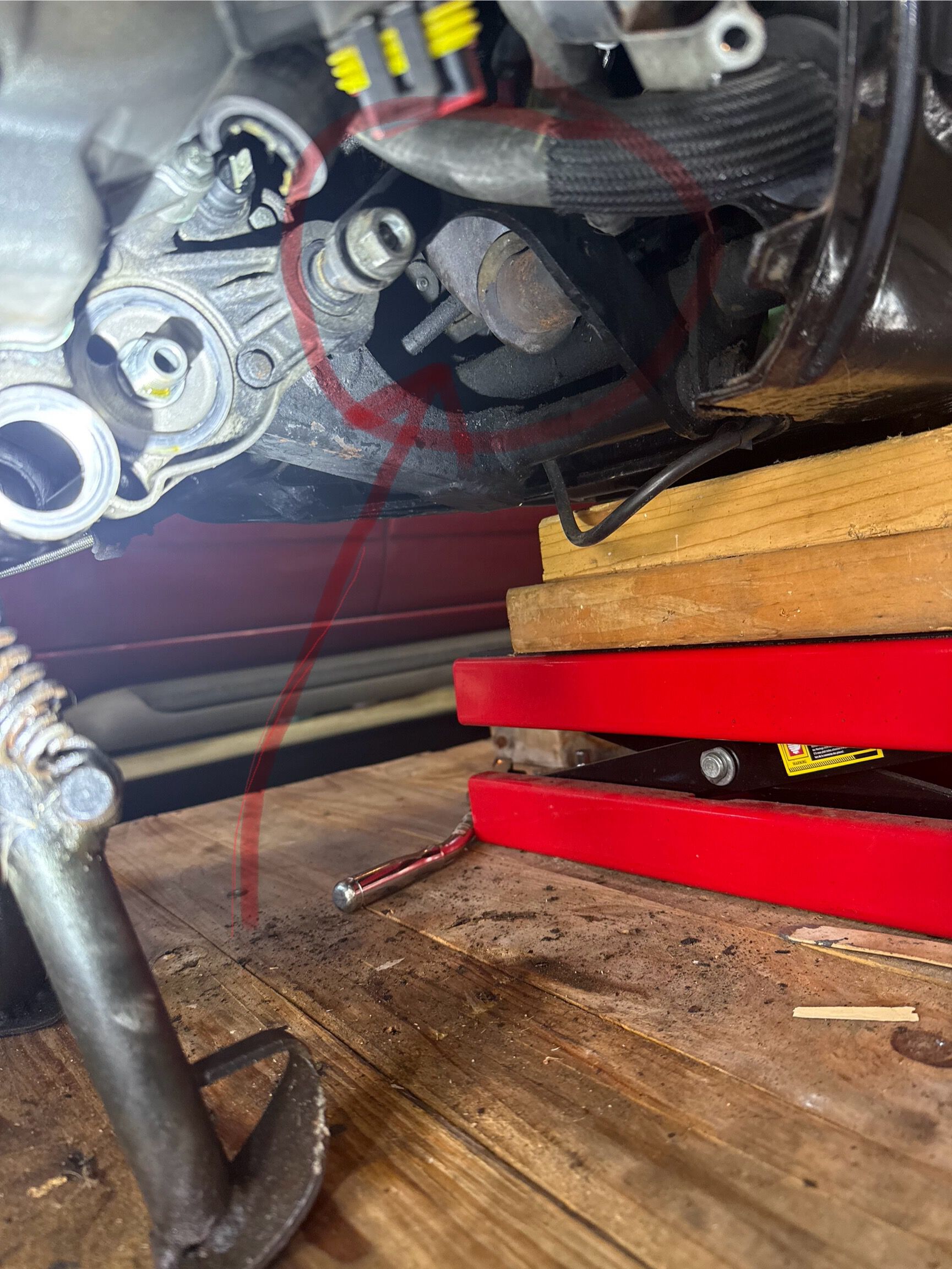

Feeling bolstered and optimistic by mr72, today i wriggled the wheel/engine back into place.
The pivot bolt was tricky by myself.
However, the exhaust head pipe isnt clearing the bend in the frame.
It's as if the engine is too far forward, but how can that be if the pivot bolt is in place?
I'm opening a super Tuscan now and will look tomorrow.
Underside of GTS, frame concealing exhaust lead pipe

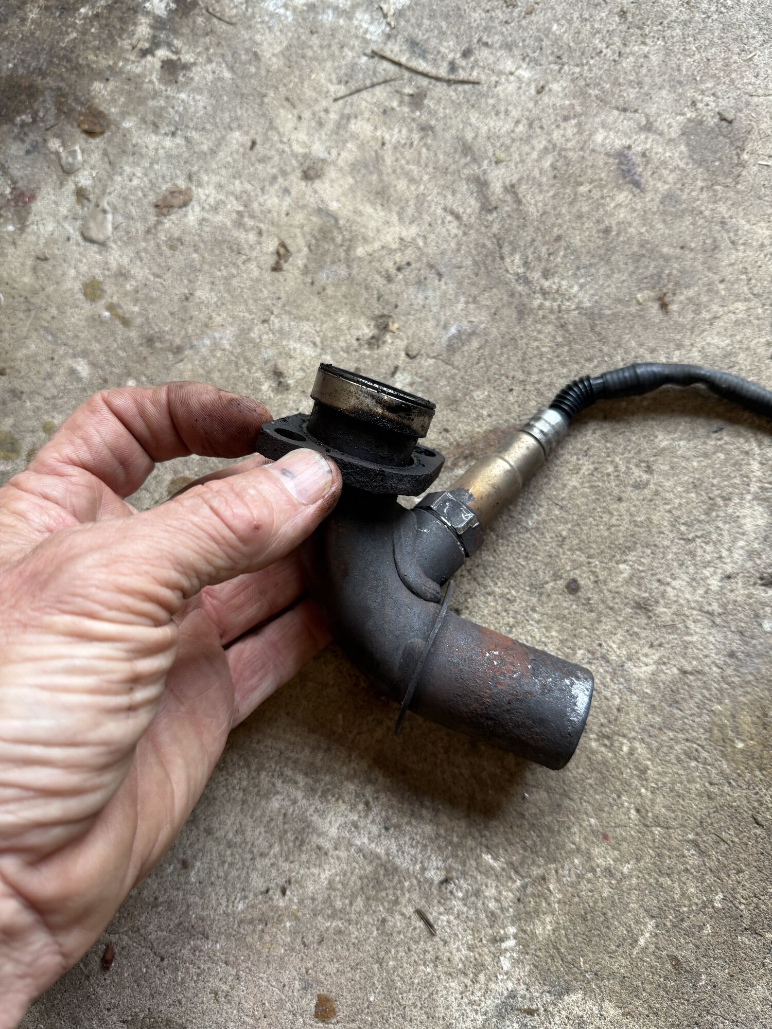

Ok.. not being one to give in, completely, i pulled the engine again.. waited a couple days, looked at a Robot guide and got back to it.
Any idea why the header doesnt clear the frame?
The pivot spacer is in… the pivot bolt is in, the shocks are loosely attached.
I'm leery of just ham-fisting it.
Underside of GTS250, right side, looking at header downpipe

I see now.
For the next person. Because I did not know…
The header pipe can spin and the collar locks it onto head. I thought it was a solid piece.
Haynes book and even Robot's vids didn't mention that.. I couldnt find it anyway.
I removed the engine.. AGAIN.. and unbolted that collar.
Here I go again…
GTS250 exhaust collar removed

2007 GTS250ie almost ready to roll
