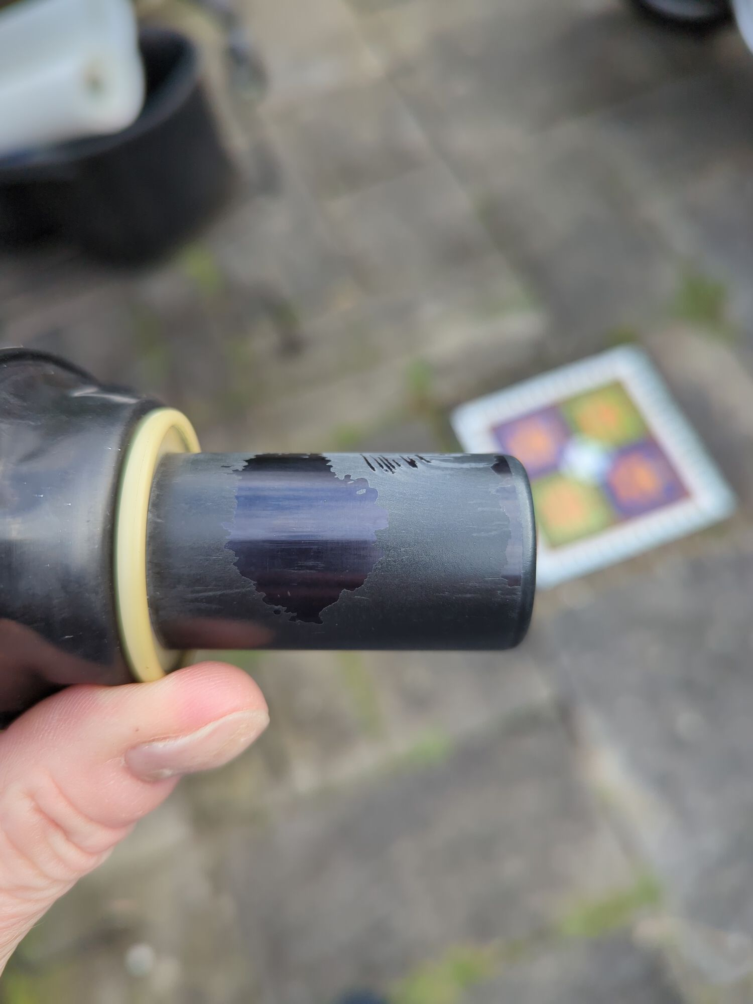

Have checked the air lines with the carb spray check, and they seem alright so looking at the carb. Have taken it apart and it is indeed very dirty with a yellowish gum over a lot of the inside.
Question about my slide though..this seems to have a matt-ish coating with in places shiny metal showing through.
Can anyone confirm the coating is gum rather than a coating that should be there but has worn through?
Carb slide with coating
