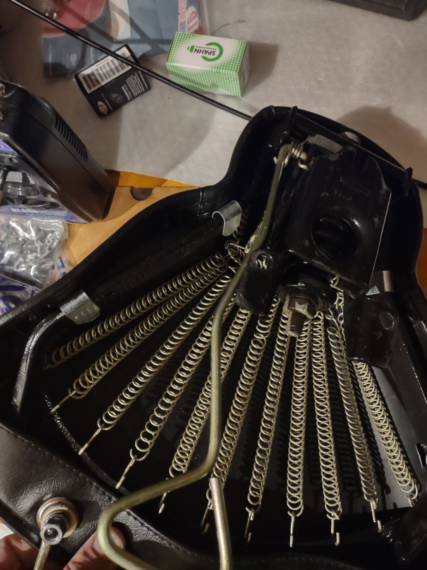

Has some welded on this bracket? Id this the right cable ?
@gickspeed avatar
Posts: 2788
@gickspeed avatar
Posts: 2788
Someone welded a tab onto the lever. Remove the tab.
Also, wrong choke cable, that is for bikes using SI carbs. It will NOT work for your VNA.
