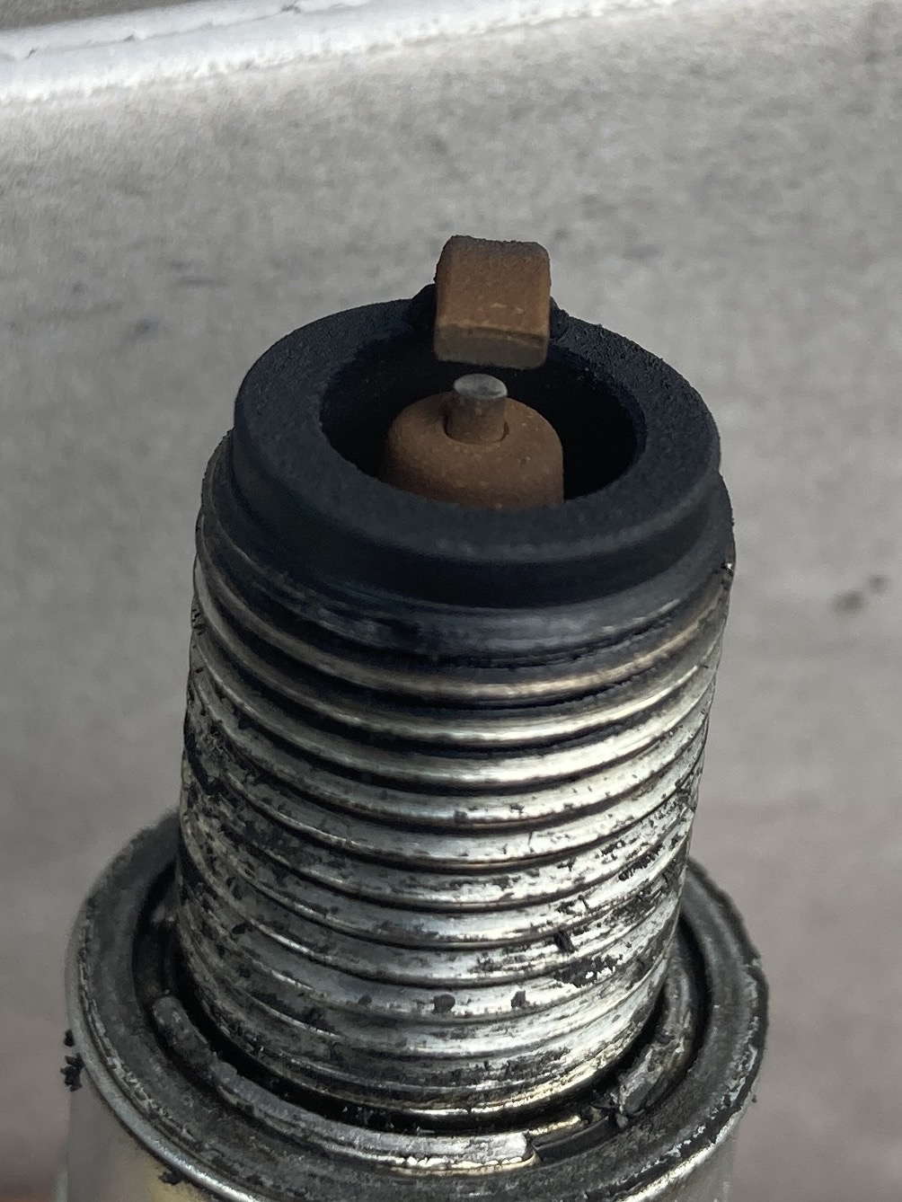

First the back story, I rode across town and lost the actuating lever for the shift cables, therefore I was stuck in 2nd and rode about 8 miles or so home in 2nd gear at a pretty high RPM. I decided to look at the plug right after killing the motor. I am a bit confused at the readings, some say it's rich looking at the outer ring, some say lean looking at the insulator, some say just right looking at the electrode. As for the ground strap, mixed feelings. Any insights?

IMHO lean.
Here is right color.

There is lots of info on " tea coloured being right" but a plug chop test is just that, NOT what you just did. You just looked at an old plug after a random hi rev run.
For a plug chop you need a new or very clean shiny plug of known condition , and a rag and wrench
Warm the engine up using an old plug.
Fit the clean plug.
Select a nice flat road ( no lugging up hills or flying down them) .
Set off accelerate hard through the gears and hit wide open throttle and wait till your scoot hits the speed for WOT.
Then hit the kill switch and pull in the clutch, NO THROTTLE.
Roll to a stop , let the engine cool a little just so you dont get your fingers burnt, remove plug then read the plug colour.
Hope this makes sense 👍

It's an old plug, by the looks of it, so kind of an average reading of its life in the motor. It would be helpful if you at least stated what kind of plug you are using.
The strap says it's too hot, the ring says good jetting overall, the electrode suggests timing is a bit too advanced and the porcelain says you use oil without too much dye, or maybe a lean oil mix on a hot plug that is staying clean. Either way, the porcelain is not super important as long as it doesn't show blistering. On four strokes you wouldn't even bother with the porcelain colour, on two strokes it mostly displays oil mixture strength.

As for the plug, B7HS, as for the oil, I round up a bit, 3oz per gallon of premium fuel.
Posts: 8352
Posts: 8352
Is this on a stock VBB 150 engine or are there any mods that have been done? What carb? Jet stack and idle jet?

Bone stock motor
As for the carb, see this previous post:
Carb Model?
Jet Stack:
185 Air Corrector/Main Air Bleed
E1 Mixer/Emulsion Tube/Diffuser (could be BE1, but stamped E1)
100 Main Jet
60 Starter Jet/Choke Jet
40/120 Idle Jet
My goal was to run as rich as possible during the first few hundred miles break in period with my box of assorted jets. By the looks of it, I might be pretty lean.
Posts: 8352
Posts: 8352
100 main is stock on the 20/17 carb, so you may want to go to a 102, 104?
