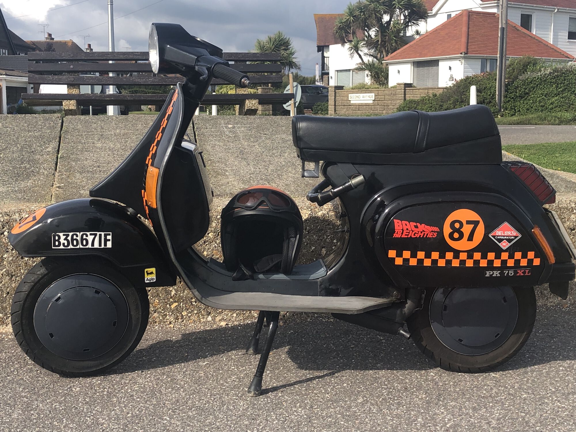

Posts: 992
Location: Planet Earth
Posts: 992
If i can interject, i have the PK75XL, the motovespa cousin of your 125XL. As standard mine uses a 20L carb. Book speed for the 75 is 80kmh and for the 125 90km. I could hit over 80kmh with a sito plus, but lousy on hills and wind so I bought the often overlooked BGM box pipe for small-frames; its relatively inexpensive and gives you complete access to rear wheel. I lose about 2KMH top end, but the pulling up hills and maintaining speed into wind is far better as i have far more torque. Im not sure of the original jetting for the 125 xl but having a 90 jet seems awfully high to me. The XL uses the same carb as the ETS; doesnt the xl also have the same engine? Standard factory is 10569.1 Slide
76 Main jet
50 Idle jet
60 Starter jet
Float 6122.2 3.5 grams . My scoot in pic, BGM box pipe.
As for the plug, yes it should be using a 19mm long reach, as confirmed in the manual pic attached. Malc
