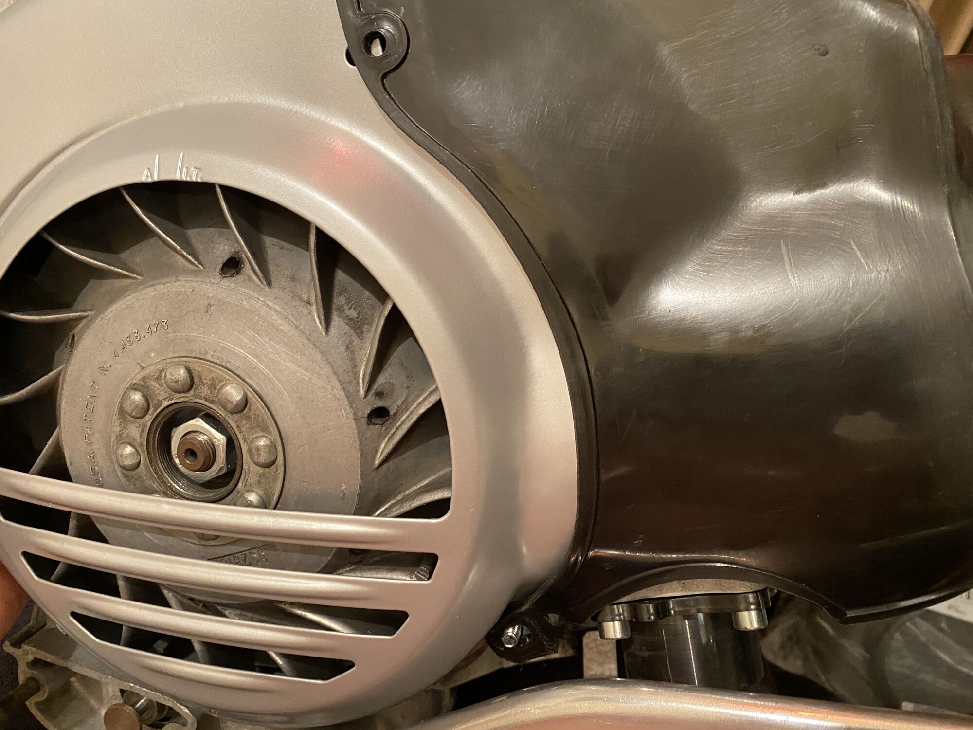

Try as I might, I can't persuade the cylinder cowl to stretch over the flywheel cover now I've fitted a longer crank. This leaves a half inch gap where the cooling air can escape. Is this a problem?

Correct. I've managed to secure the cowl satisfactorily using the suggestions in the other thread, but I would like to know if I should try and do something to cover the gap between the cowl and the flywheel cover, or maybe it doesn't matter.

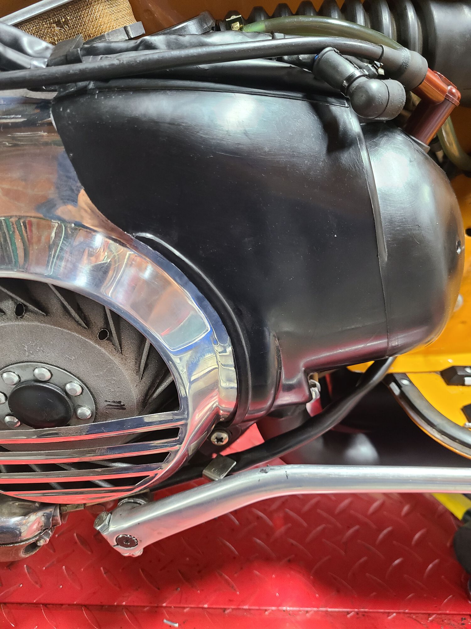

No, that space isn't ideal.
I've had to persuade a 200 cowl to fit over a bigger-than-standard cylinder head (mrp) on my P2, and that was mostly done by using a screwdriver as a lever and a heat gun. The hard part is getting the plastic hot enough to stretch, but not so hot that it just melts and gives. I've also had to cut out and patch cowls for centered spark plugs (soldering iron and heat gun used), and it seems to hold. Maybe you could try making one with 2 cowls; just make sure the finished cowl isn't under too much tension in either direction: that will be its weak spot.

Problem solved! I ordered a genuine Piaggio black plastic cowl (part no. 843530) to replace the original grey LML one, and it fits perfectly. The screw near the exhaust stub lines up without any shenanigans and there is no gap between it and the flywheel cover. Even the sparkplug hole is in the right place (I had to oval the LML cowl to fit the plug). The only thing I need to find is a 20mm or so M7 bolt to replace the standard 16mm one that goes into the extended cylinder nut.
