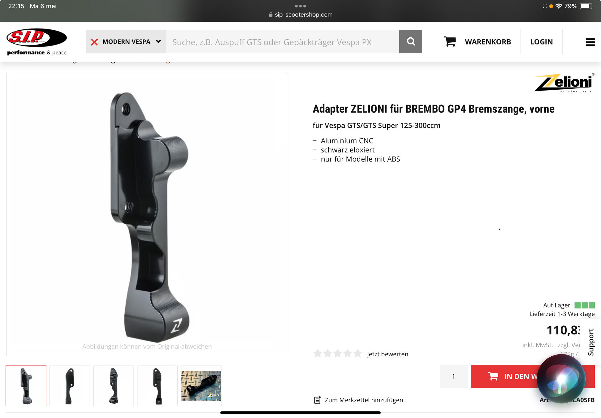

You know that calliper is used on pre 2000 Ducati's ( it is an old design)
If you look at the Sip site it would fit with the adapter
I think a radial calliper is nice and you can pic up a secondhand one for about 125€ and use de zelioni bracket that is on the sip site
You get something like this ,I would ask the guys at SIP if it fits

It should fit , see last line

etipi22 wrote:
Supertjeduc what kind of brake and adapter did you use?
About the same adapter as on the second picture ( i have a GTV )
You can buy the one from the SIP site
Brake is a secondhand one from a Ducati , all Ducati callipers will fit
